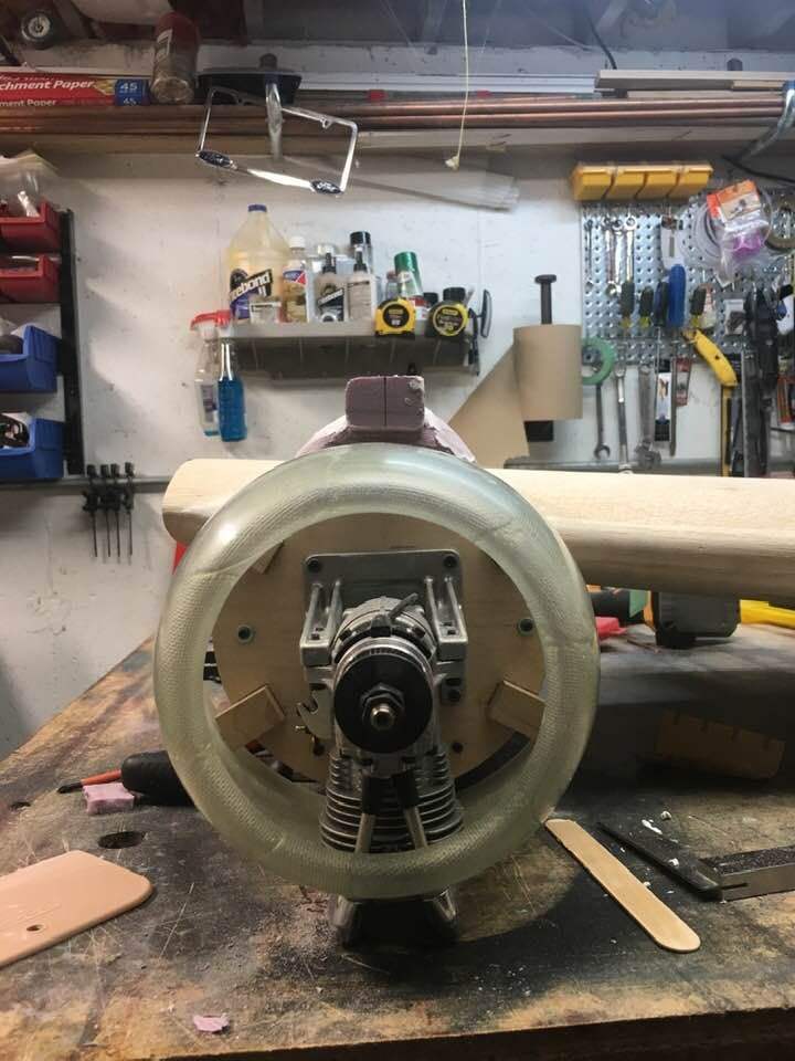

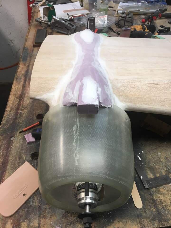

Alrighty, been a while since I worked on this plane, and today I decided to try to mount the NGH 38CC 4 stroke. um yeah, about that, these are rather large engines, and it appears I will have issues with the cowl in that the head is right at the edge of the opening. The mounts are pre-tapped setting the engine an inch forward of plans. I was going to make my own cowls, but found I just don't have the proper setup to turn the blank without making it egg shaped, so will more than likely get the ones from Ziroli.
Now I have a question, the cowl on the plans are only 6", but the cowls on the web say they are 8", so if they are 8" then these engines will work.
Another question for anyone who built the 101, engines head down, or at a 45? At 45* the exhaust shoots straight down, right onto the landing gear.

After some research discovered that the NGH38CC is more suited to the P-61, so they will be used on that instead, so instead found a $25 off coupon for A Main and got a pair of Saito FG-30B for the B-25. While I was at it, ordered a pair of cowls for the B-25 and the parts for the P-61, cowls, glass, and nose. The plastic parts I wasn't sure I wanted to use, so did not get those.
Today I got some work done on it. The right side foam for the top of the nacelle is on, and started shaping it, the left side is nearly done, but need the cowl to finish the front part of it. Once I have both shaped, I have the inner flap on the right to finish, then a final sanding of the nacelles and wing surfaces, and then I will glass it and start on making the gear doors. I have not cut them out nor will I until the glass is done. I plan to make a mold of the gear door area and then make gear doors out of fiberglass, and then cut the opening and install the gear.

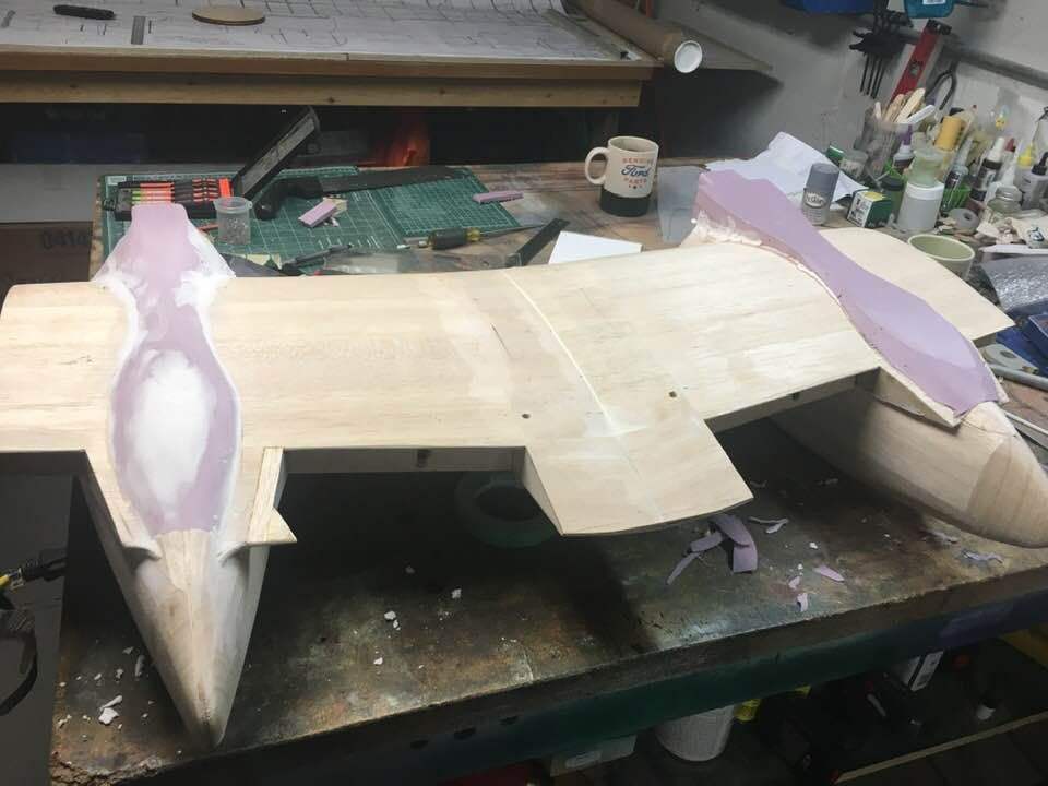

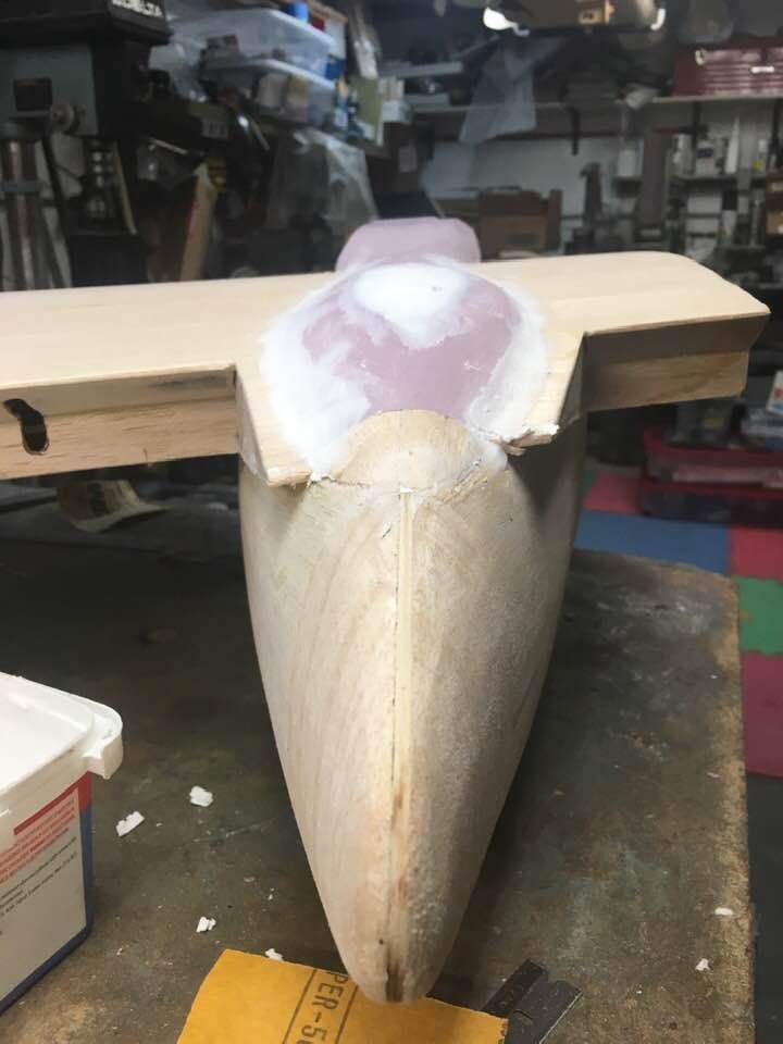

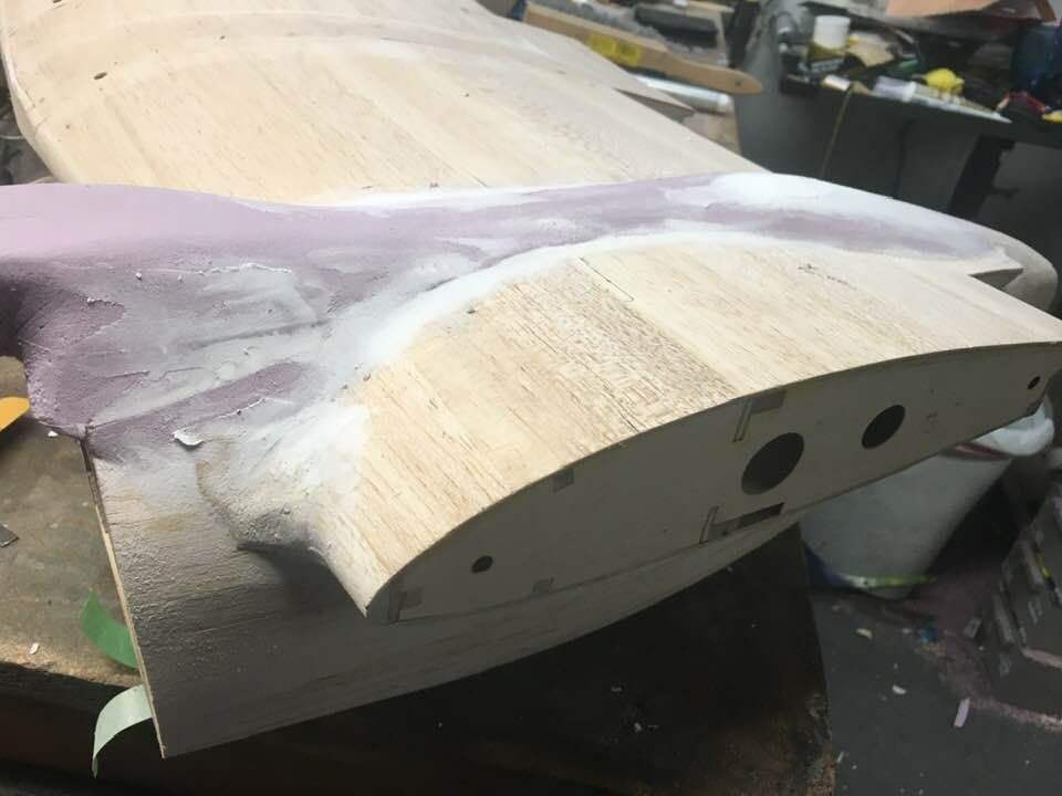

Got more work done today, first time in almost a year too.
Before I started, what it looked like
After a couple hours work, what it looks like now. Just waiting on the filler to cure. Pretty much on hold for the front until I get the cowls.

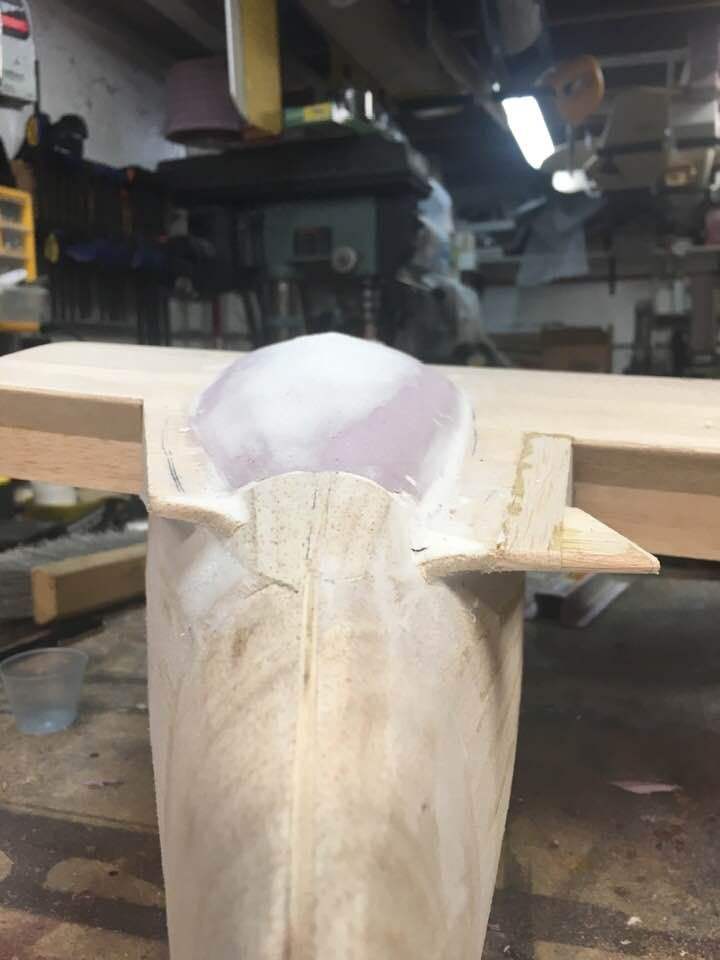

Last thing for the day, got the right inner flap aligned.

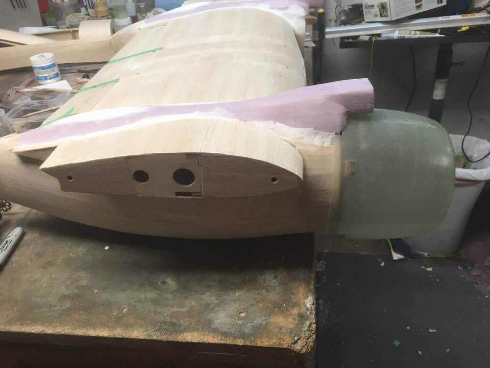

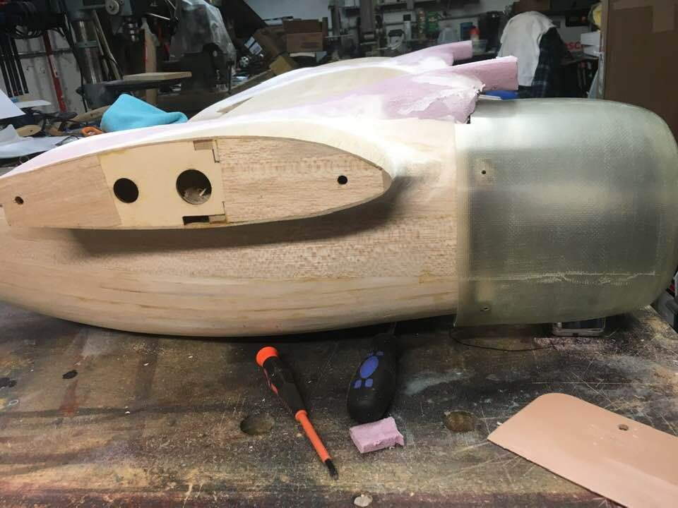

Started fitting the cowls. Need more filler to finish the fairings too.
I also got the FG-30 engines, and trying to decide how to mount them
Muffler it a bit tight.

Engine Pod. One down, One to go. After getting the engine fitted, I kept staring at the nacelle, trying to figure out the best way to mount a servo for the throttle, and have room for the tank. I finally just thought, why not make it a pod. So I did.
Slides right in, no interference, and keeps the weight forward of CG. Now to make the other side, and come up with a way to mount the ignition. The optikill will be on the back side above the tank.

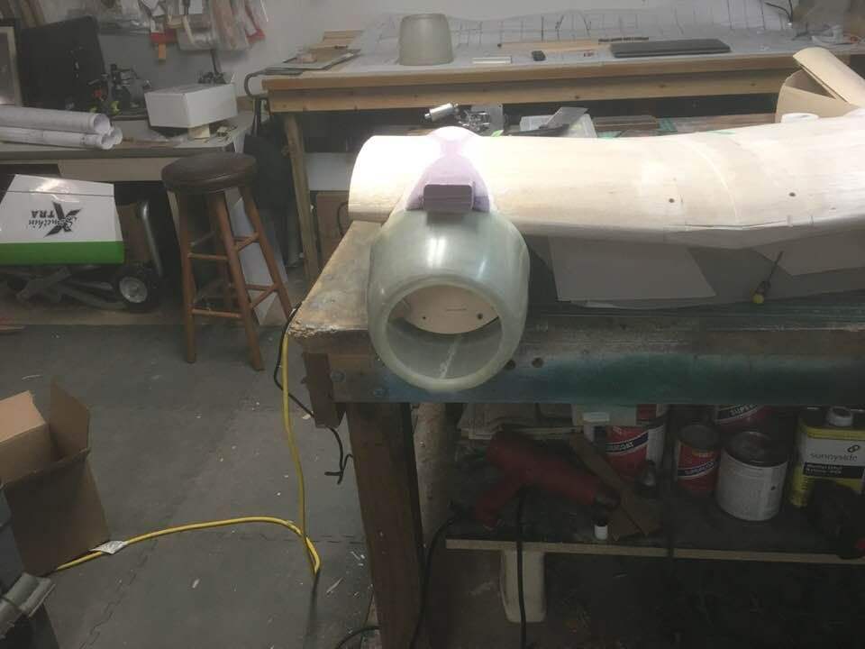

There's ,ore. Got one cowl mounted and finished sizing the cooler intake. Some final smoothing and I will glass it, then I can flip the wing over and work on the bottom of the nacelles.

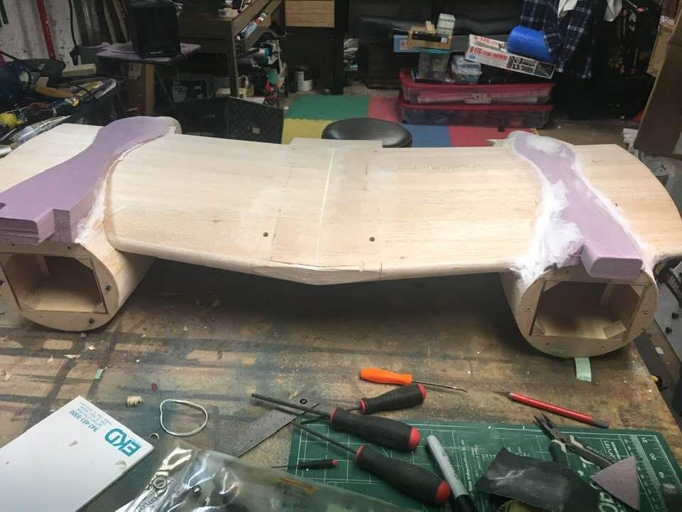

I got the two nacelles glassed at the top to help protect it while I work on the bottom. Just waiting on the poly to cure and harden, then apply a second coat for additional hardness. The flaps are fully glassed now, and getting a second coat applied to them later. While waiting for the poly to cure I am going to finish up the leading edges where the air scoops go so I can glass the outer wing panels. Few more weeks and should have the wing done and can move onto the tail gunner position. Still not 100% sure how I am going to tackle that, I have a block of foam glued up ready to carve, but want to make sure I can attach and detatch it easily since there will be the elevator servo located under it.

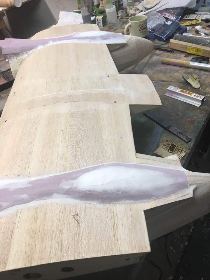

Left outer ready for glassing. Got the landing light all prepped, need to form a lens. Not as bright as I hoped it would be, but it is. 20 YO led.
