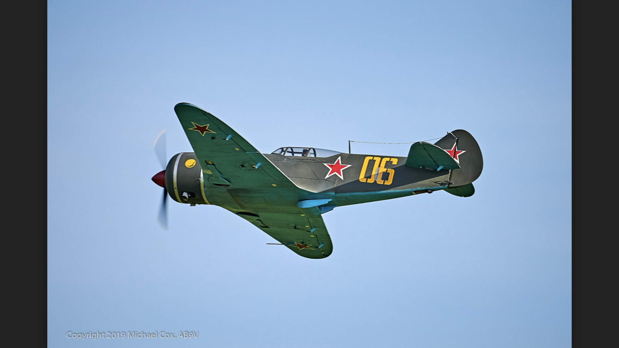

Some good shots of my La-7 and Ricks at the Indiana Warbird Campaign at Muncie last weekend
