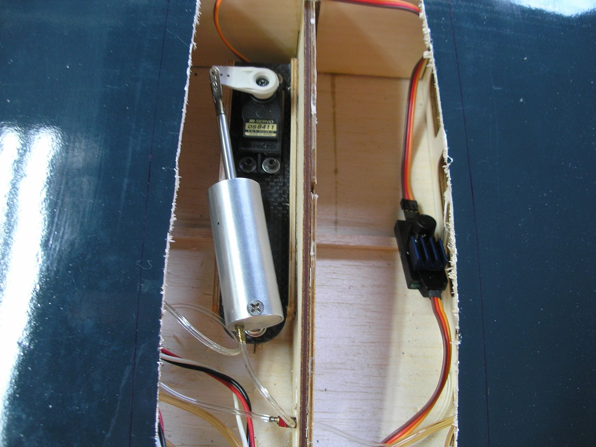

Got tied up with business but i have made some progress.
Solved the issue with where to mount the batteries. Two Gens Ace 5S 5500 for each motor.
Gear has plenty of room to retract.
Didn't like the servo mounts in the kit so i fabricated my own.
Had to add shims to let the tire clear the top of the nacelle when retracted.
It took six 1/8" ply shims to adjust the clearance.
Bob Violet brake valve actuator for the brakes.
