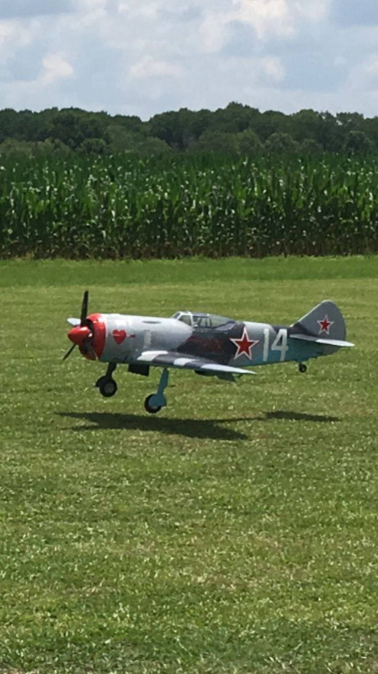

Attended the Indiana Warbird Campaign in Muncie last weekend and met some new friends....a few shots of Rick Patton’s La-7 and me getting some formation flight

Thought I would add my pics to my thread

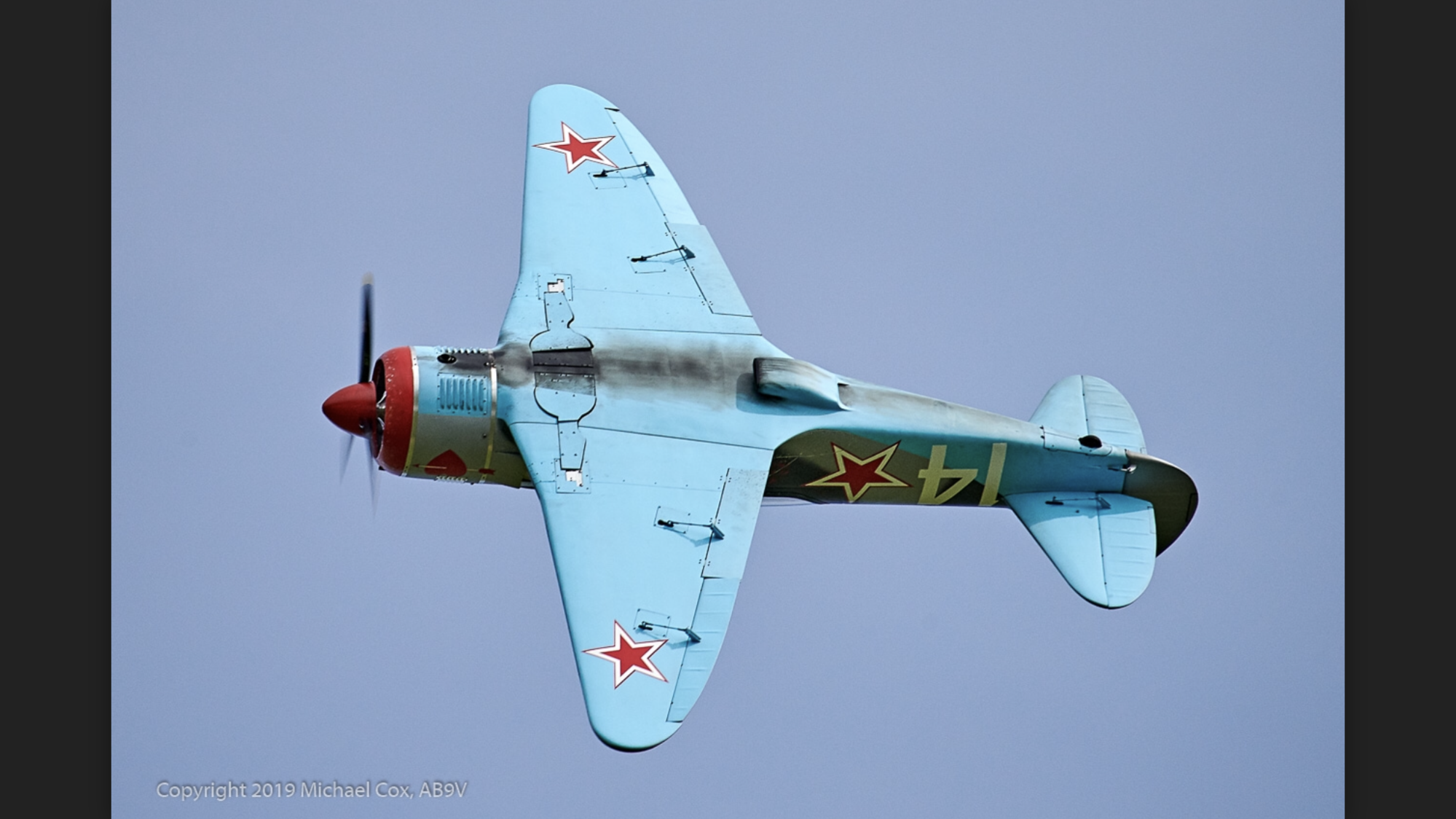

Rick Patton and I at the Muncie warbird event
