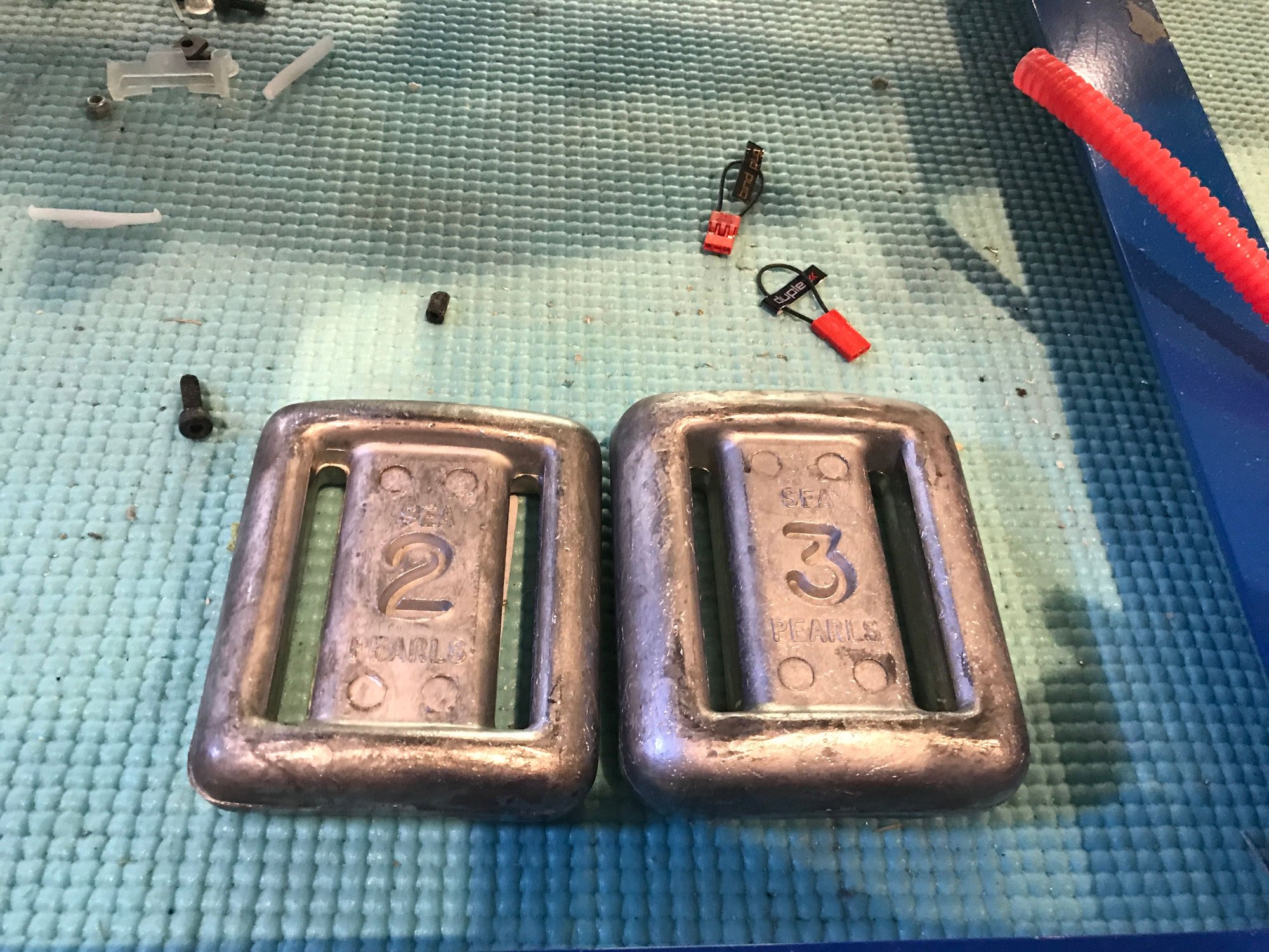

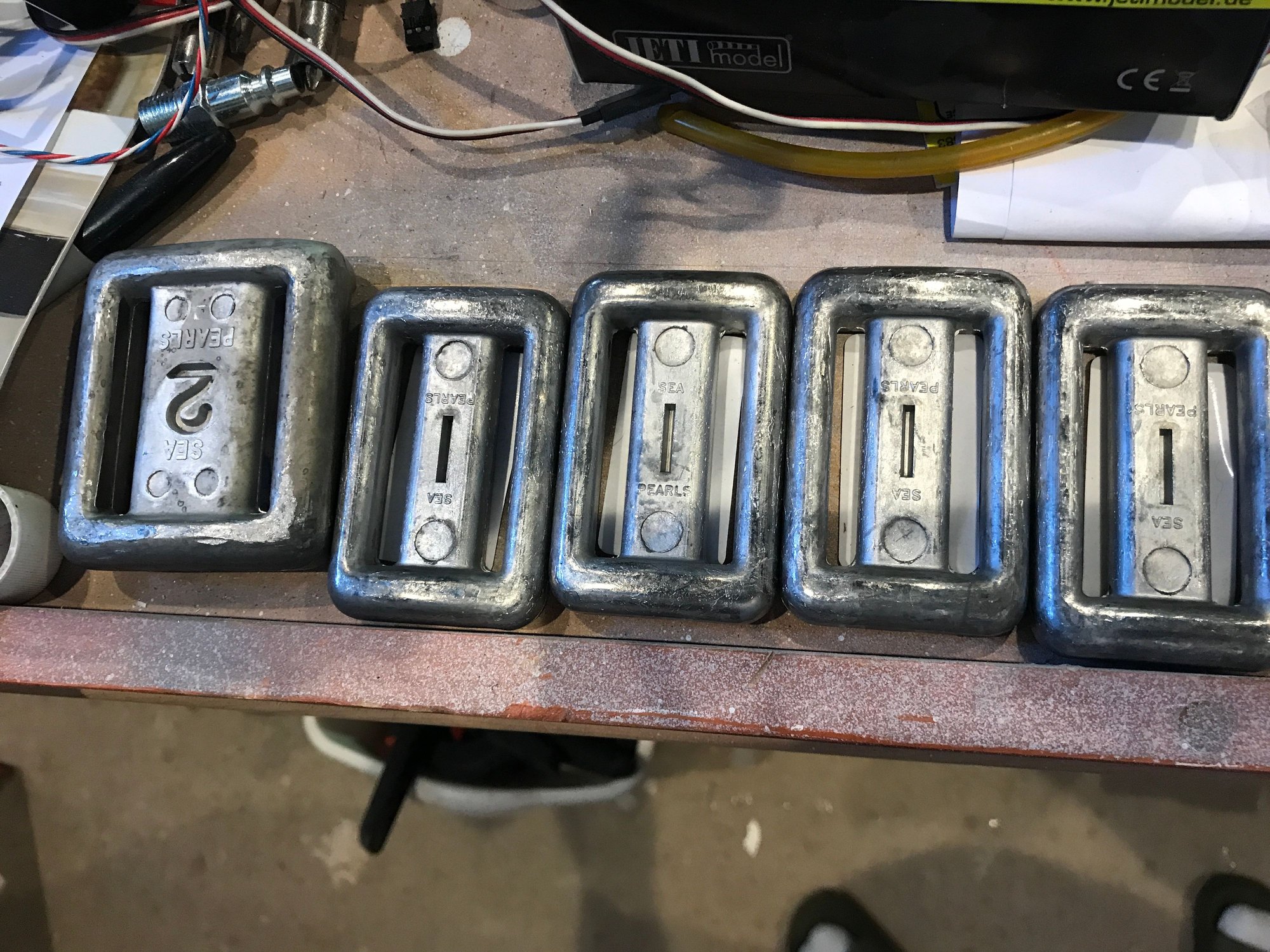

this is what I had to do:
purchased this from the local SCUBA diving shop/
i got several 1,2, and 3 pound lead weights.
I made this tray so that the weights can be fixed to the plywood tray.
this is the front end of the aircraft. Black zip ties. this is the area between the front former and the firewall for the DA 100 inline. I used a single 3 pound weight plus a 1 pound weight.
White Rose propeller washer, 6.6 ounces
it is balanced at the 6" mark with 4 pounds.
6" mark from root, using the EZ balancer
