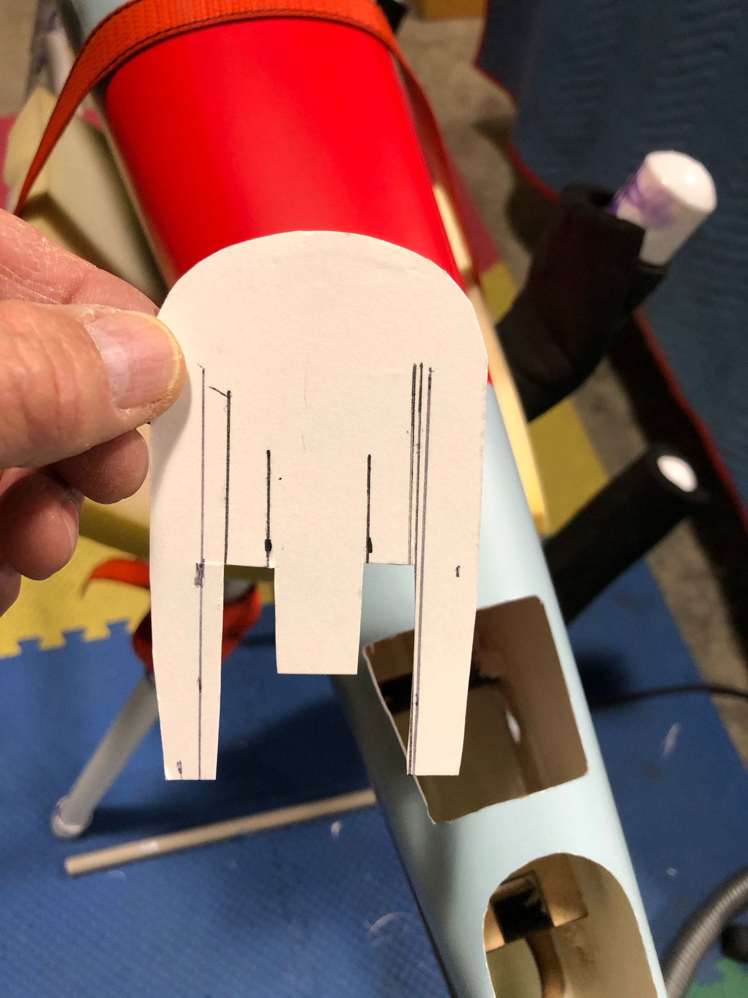

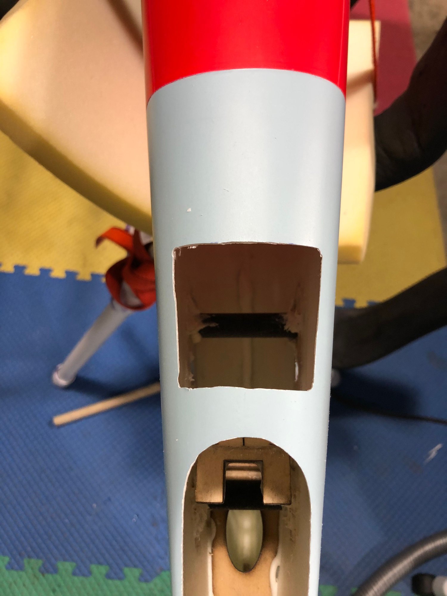

I'm too am in the mix. I'm installing the Sierra TW in my plane I completely took out the bulkhead and did several mockup test pieces to determine the geometry for the TW steering.
I opened up the belly a bit more and did some reinforcement as there is some weakness around the tail.
I used the steering linkage setup from the TF Giant Scale P-40 by installing the ball link posts on the steering arms and loop wire around the posts. I am doing my info on RCSB.com
Sparky
Sparky

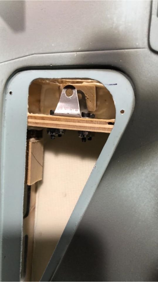

I am installing the sierra TW in my FW as well. I am making the pin at the top removable. If you have the 4 screws at the top Im not sure how to remove it for maintenance if it has problems. I've been warned the air cly is problematic and i will replace mine when it becomes a nuisance but "Ill fly to failure" Screw the mount to the wood support then pull the circlip so the pin can come out then put a small shim at the inside of the door so that it holds the pin in place with the access door in place,
Sparky
