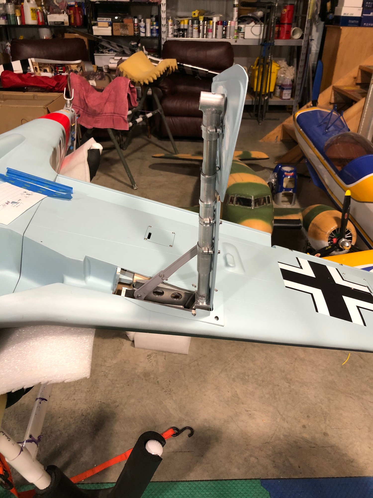

Right main is finished and ready to move to the left

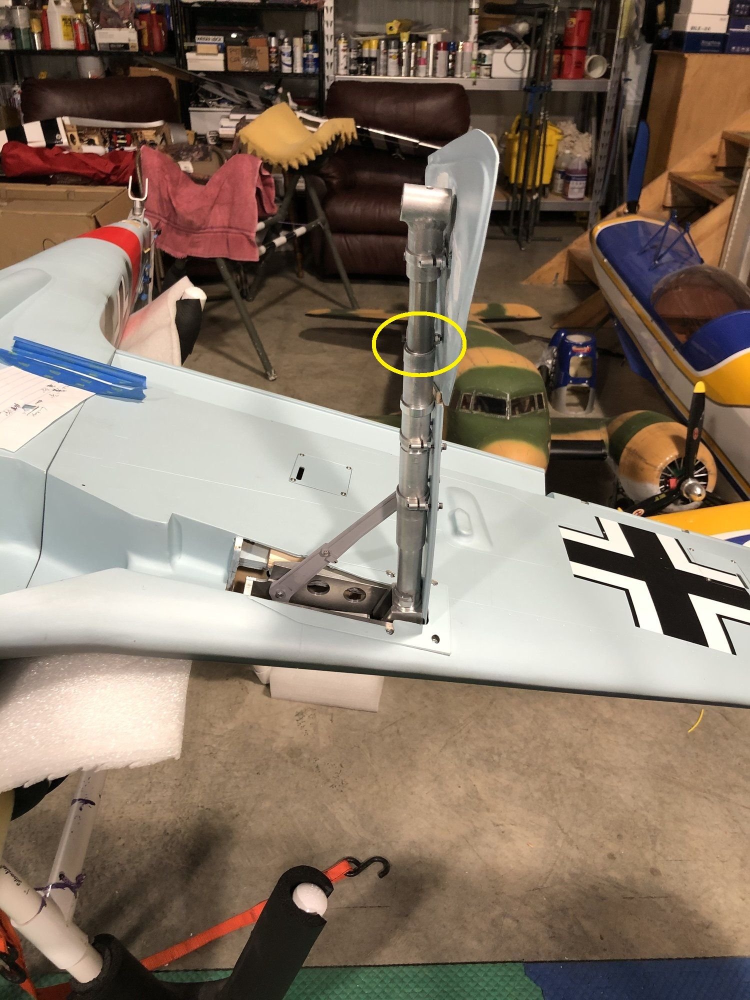

Gear done now in to the ailerons and flaps

Two-two-Tango,
How does that strut compress with that socket head cap screw through there?

Originally Posted by V35BFLYER
Two-two-Tango,
what I did was measure the stroke length then I determined where my mounts could be....hope this helps
Two-two-Tango,
actually, the area you circled is irrelevant to an movement of the struts

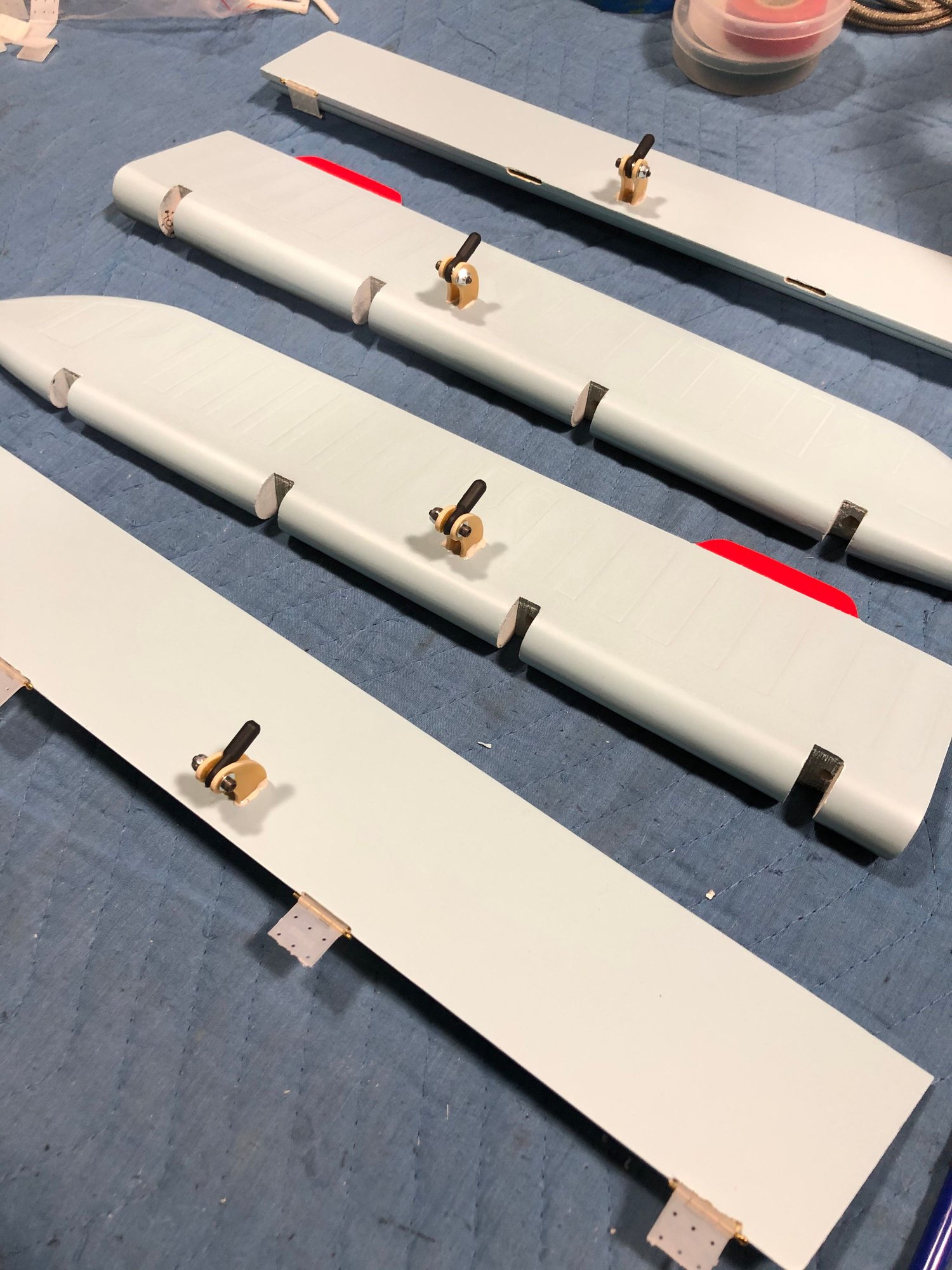

Working on flaps and ailerons...swapping all the hinges for Dubro

On the flat hinges I like to take a hole punch and put a large hole in each section . About the size of a paper punch, (I actually used a proper punch) that way the epoxy will flow then bind through the hole and lock the tab in place!

Horns are in now to get the servos mounted
Sparky
sounds good...I use a different method with tite bond. Cleans up with wet paper towels and very easy to apply. I use it on point hinges and flat hinges both and have never had a failure after 15 years use. The flat hinges always get drilled and toothpicked after the glue cures
