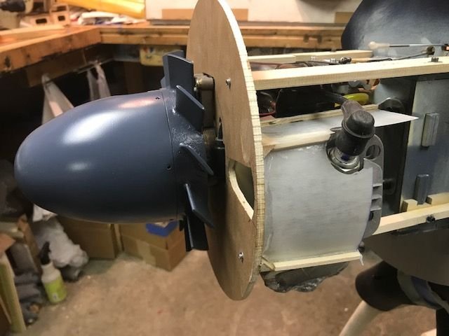

Default 3D Printed fan
Originally Posted by Hurri Driver View Post
Does anyone know a company who produces 3D printed parts for the FW. I am after the spinner fan particularly but interested in an other bits on offer
There is a guy in Europe that sells them pretty reasonably priced. I bought one and discovered I had a Valley metal fan and spinner in my stash so I sold my 3D fan. Sorry you will have to look through the posts. I think his handle is Reverend. You might post what page his info is on for others when you find it.
I haven't heard anything negative about his product.

Curious how many RPMs people have lost using the Fan?
Old 10-01-2020, 06:19 AM
  #1059
elmshoot
Join Date: Dec 2001
Location: Nashville, IN,
Posts: 1,609
Received 17 Likes on 16 Posts
My setup will not allow running without the fan. I'm spinning a 24x10 WW2 Falcon prop in the low 6K range on the ground with a hand held tach.
Until this discussion I never considered the fan was costing any loss of RPM but I guess there is some.
I can't seem to get the RPM readout to work on my telemetry otherwise I could tell you the inflight RPM. I do have a temp dielectric wrapped around the base of the right spark plug and it is in the 250F range which validates my cooling system. Since the Spektrum will only give one temp read out next time I have the cowl off. (And i remember) I'll move the temp loop to the left spark plug just to make sure everything is Kosher. I don't expect any surprises as I have over an hour of flying without a hint of engine issues.
I do know it will twist the prop to supersonic during flyby's!
Sparky
Old 10-01-2020, 12:43 PM
  #1060
ForcesR
Join Date: Dec 2009
Location: Ottawa, ON, CANADA
Posts: 809
jraycut, IAW Reverend the manufacturer of the fan I bought for my FG90R3, the fan will rob approximately 150 RPM from the engine.
post # 4346, TF FW190 GIANT ARF
very legit question. The temp`s of the cylinders was 20 lower at idle. I have telemetry in my Focke Wulf and the Cylinders cool down a lot quicker in flight after hammering throttle on longer passages. I do however have the engine baffled very well.
The (small) downside is you will be losing about 150 RPM. But for me its worth the cooling effect. Especially on the ground.

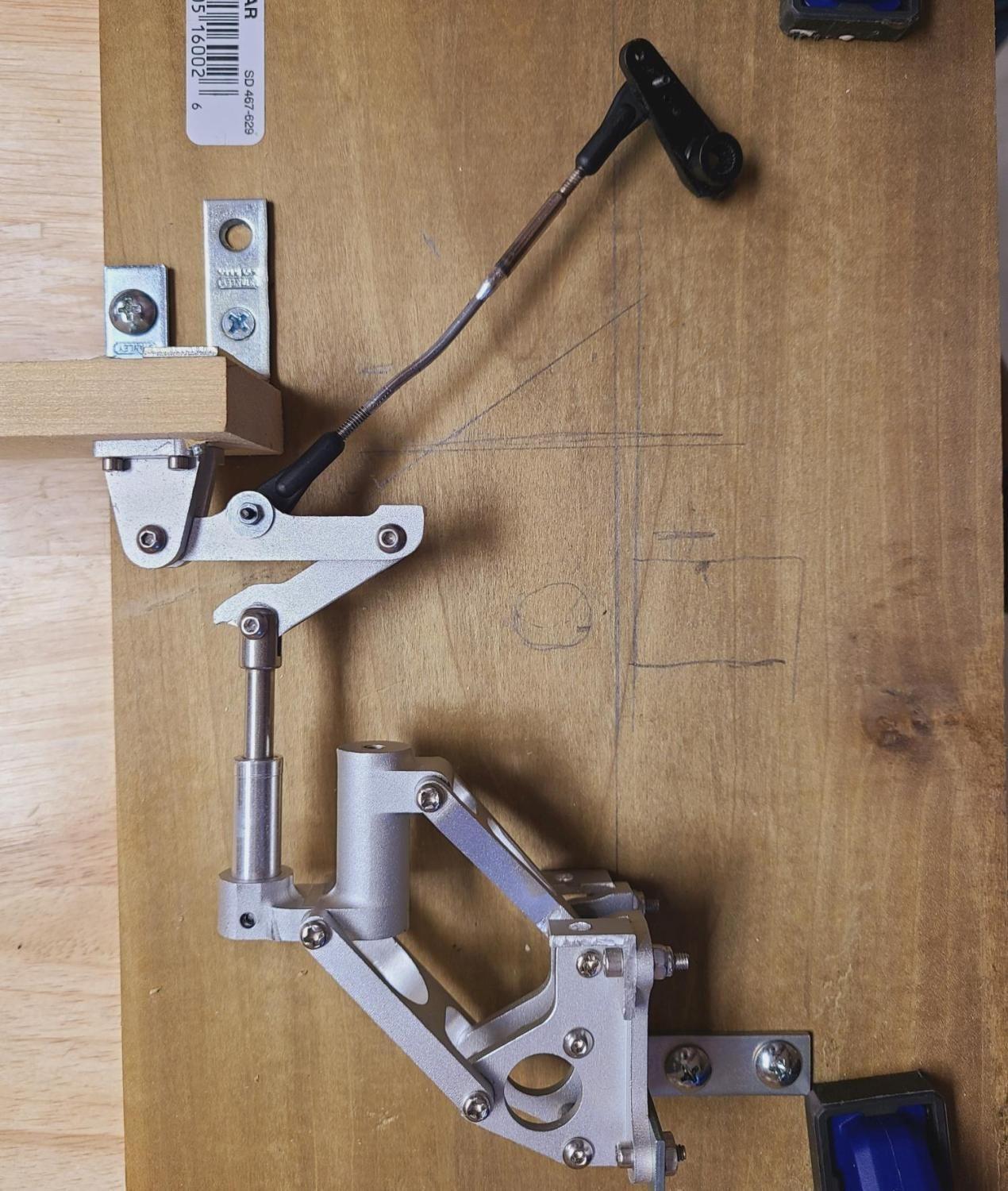

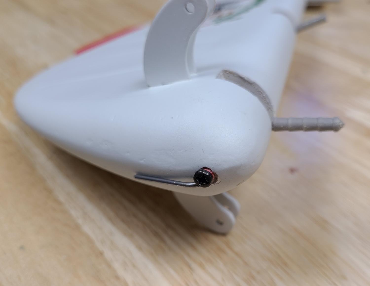

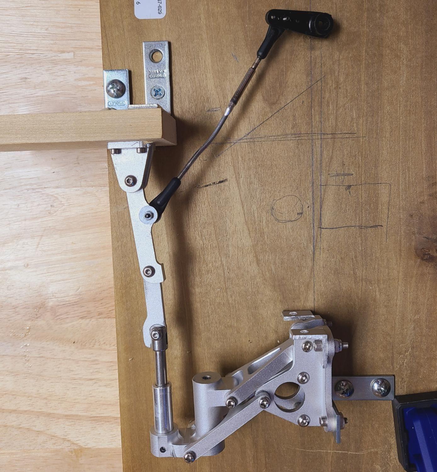

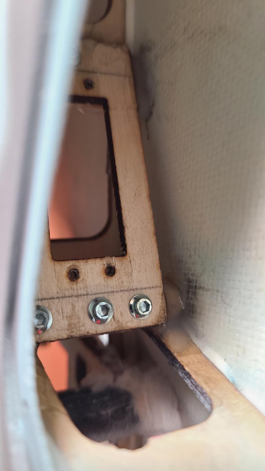

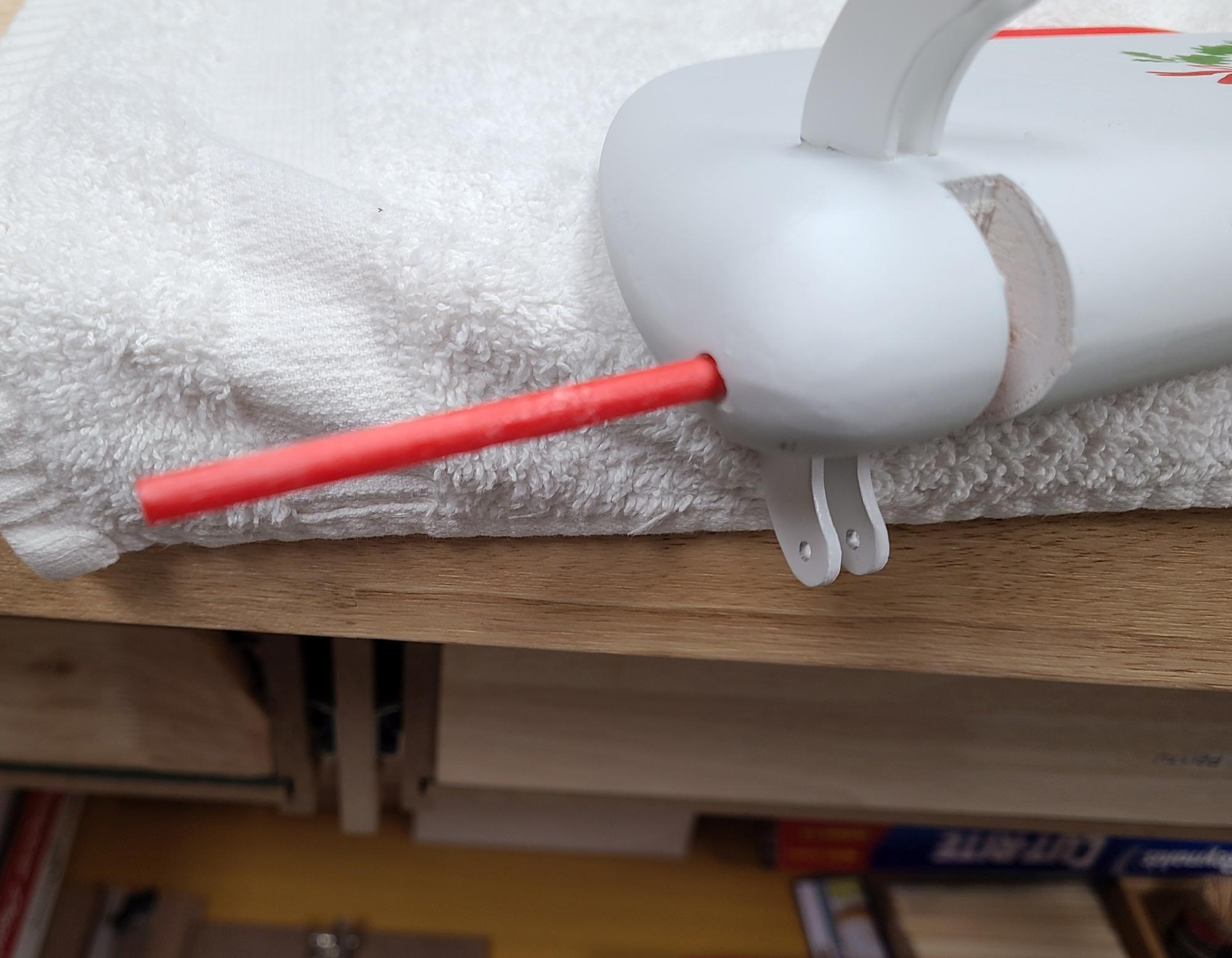

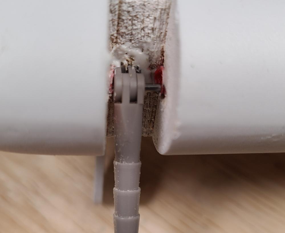

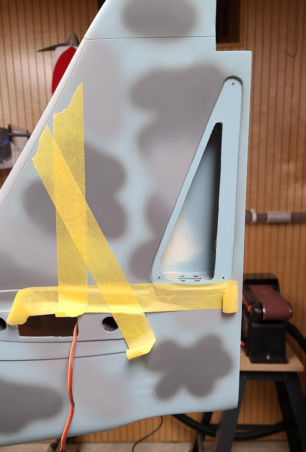

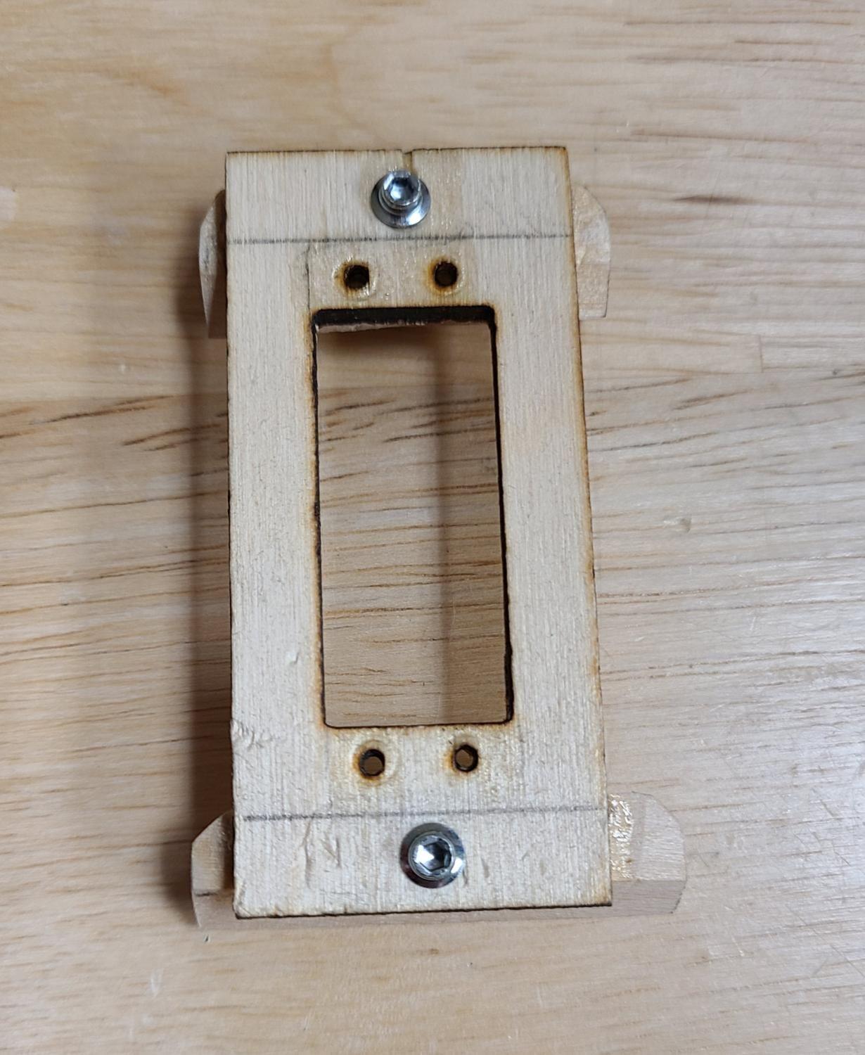

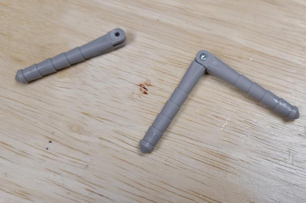

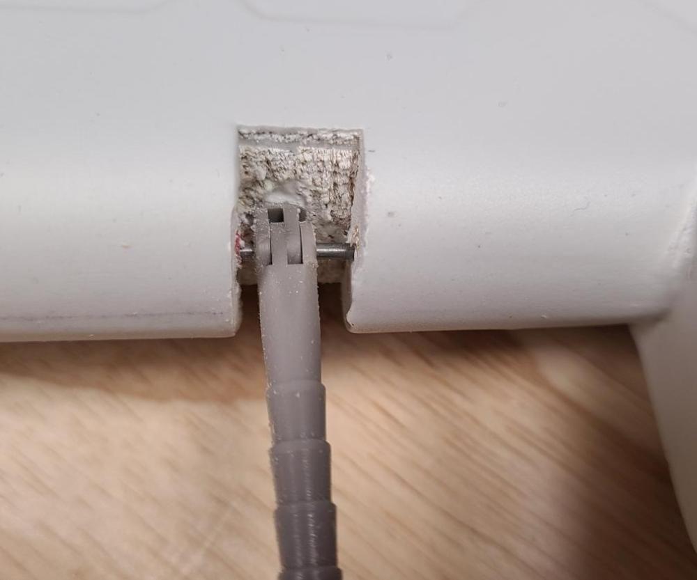

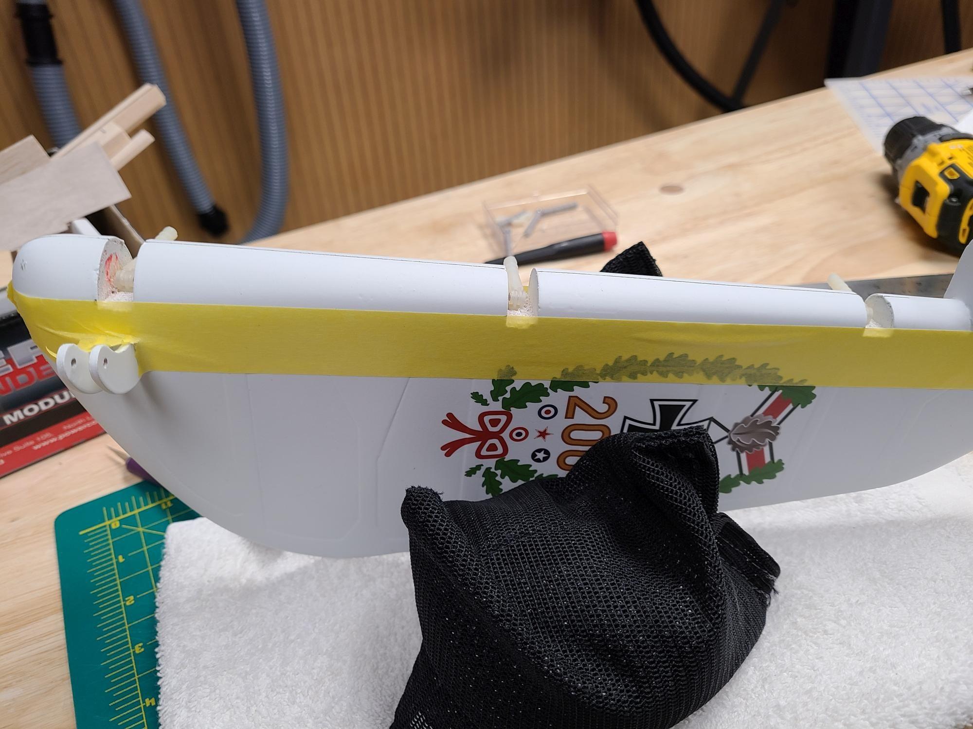

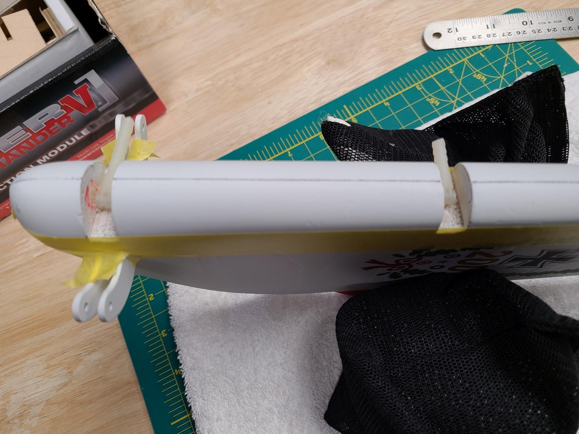

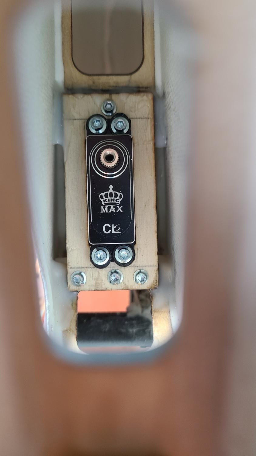

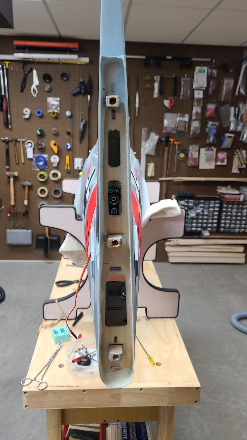

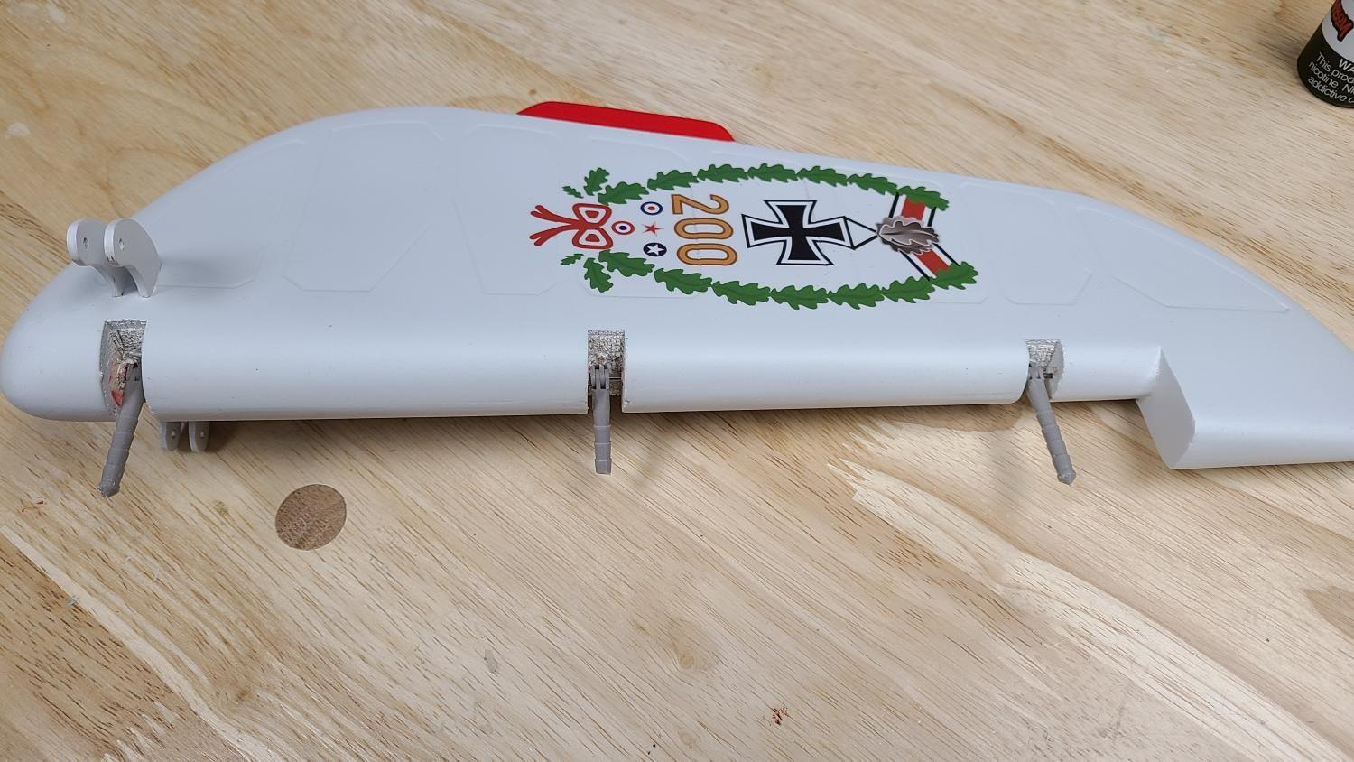

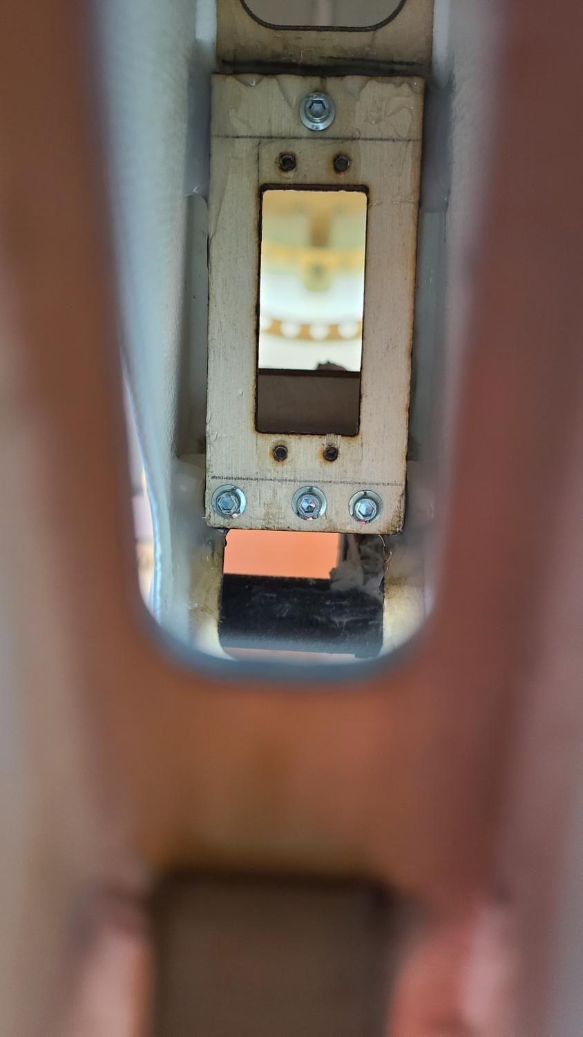

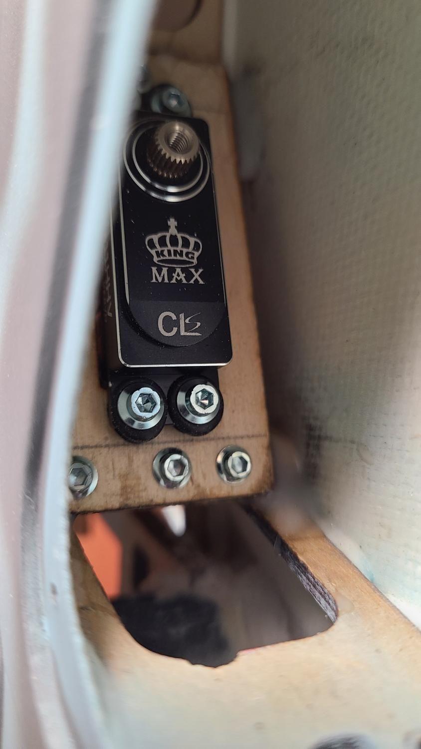

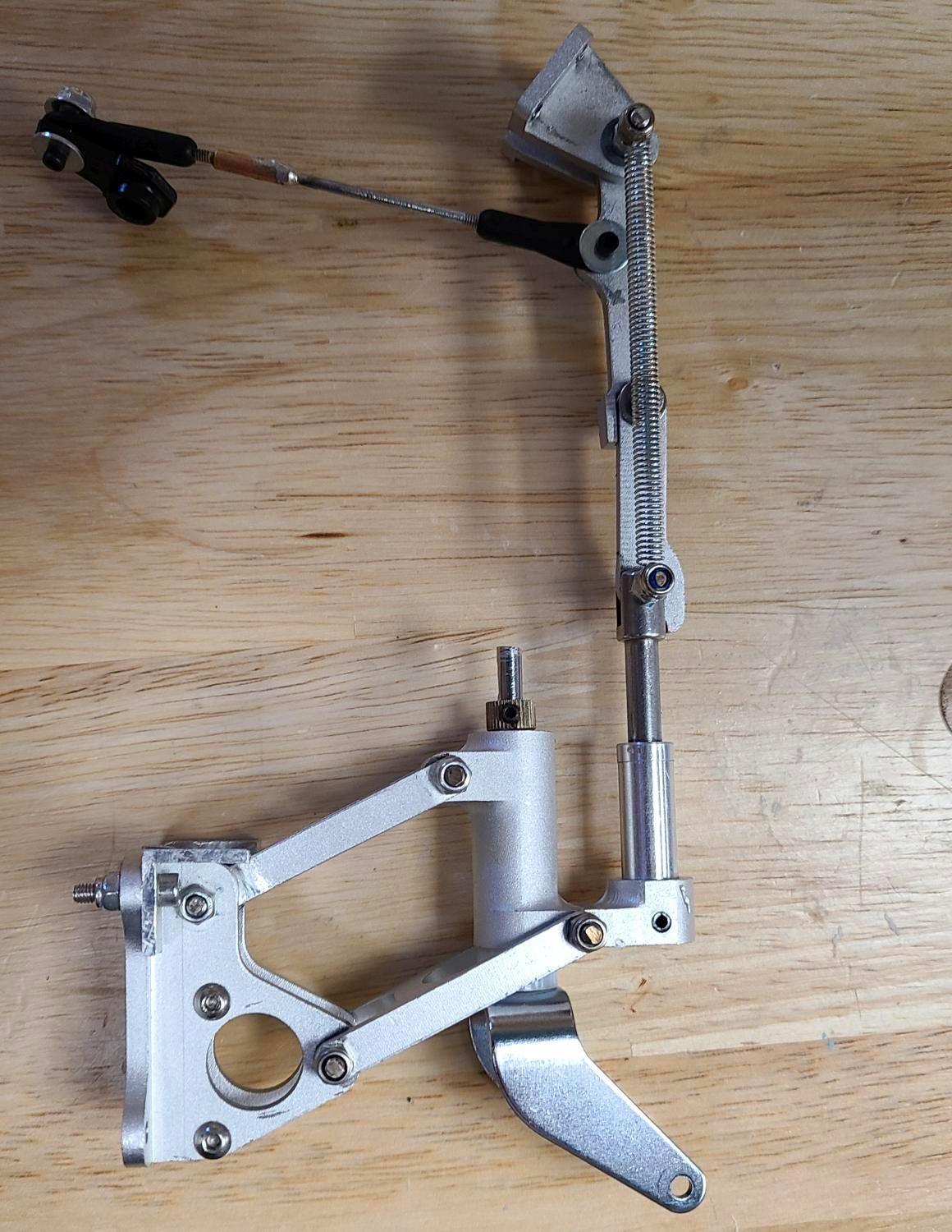

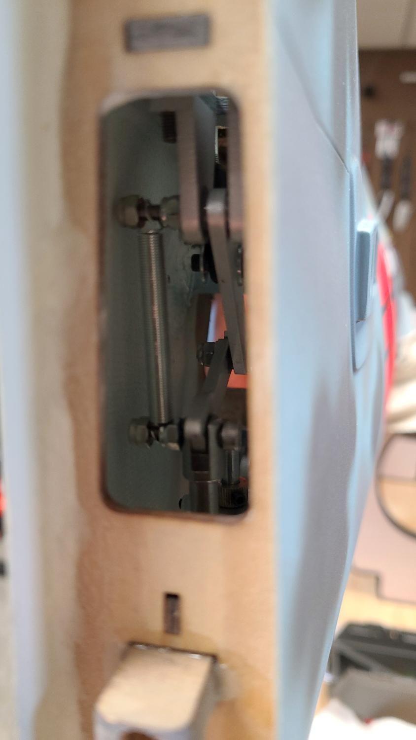

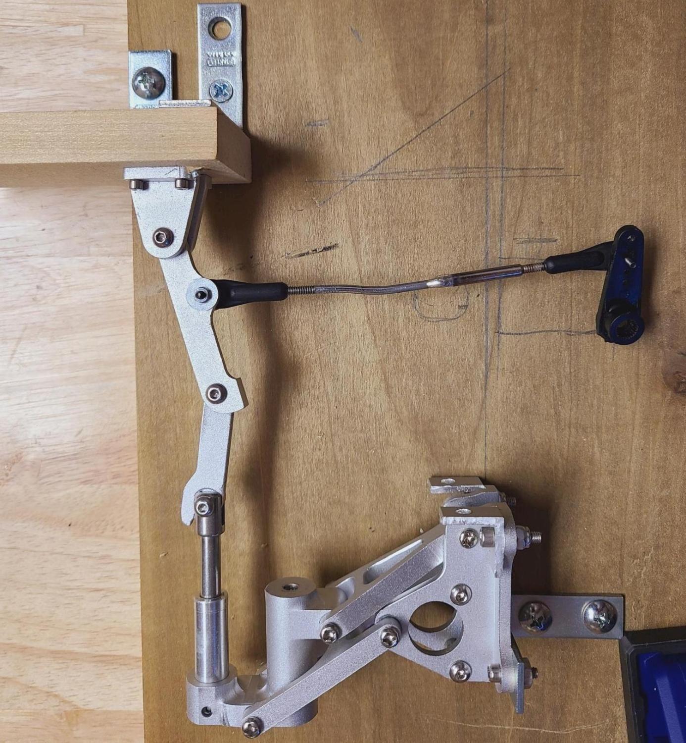

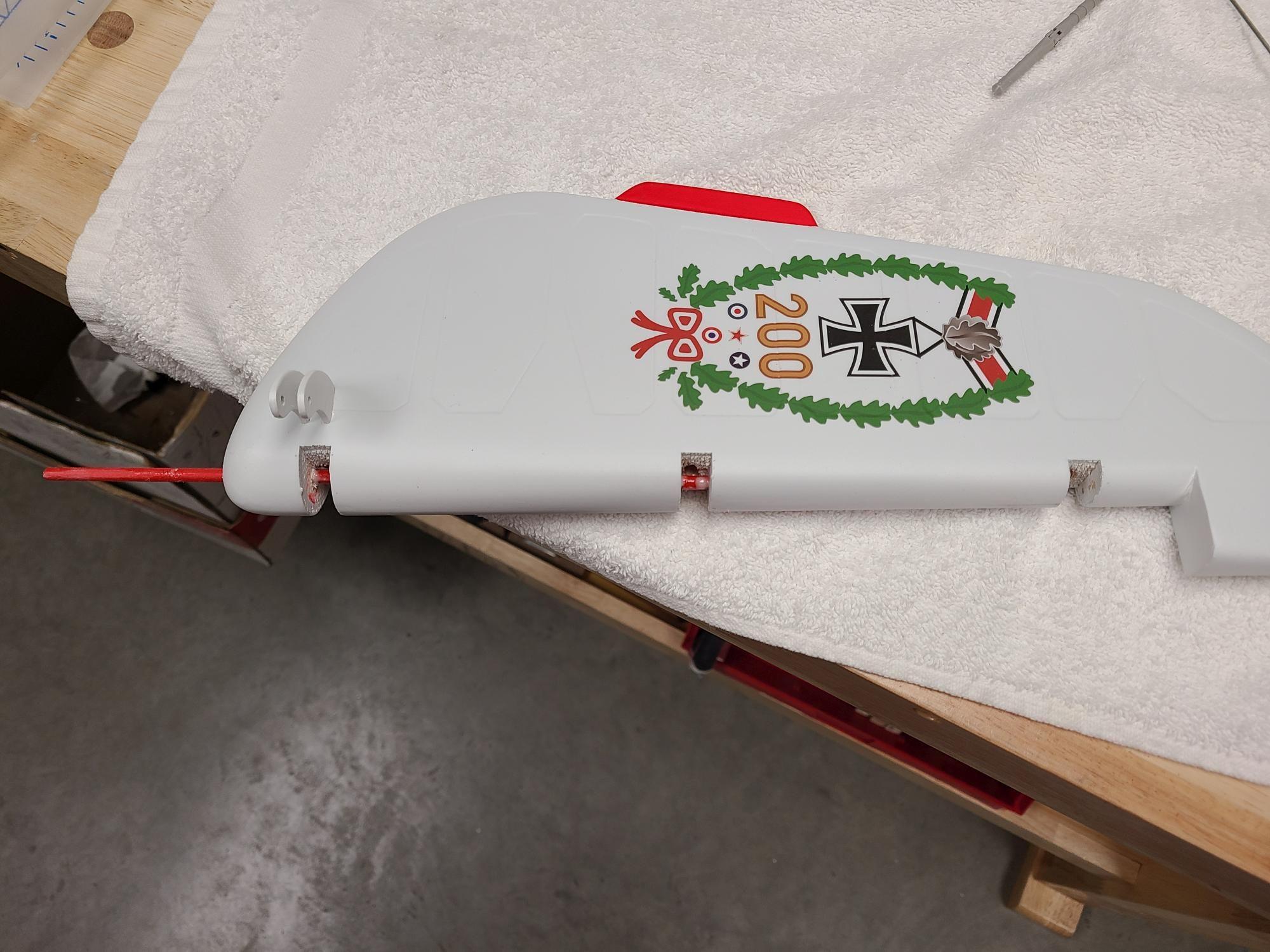

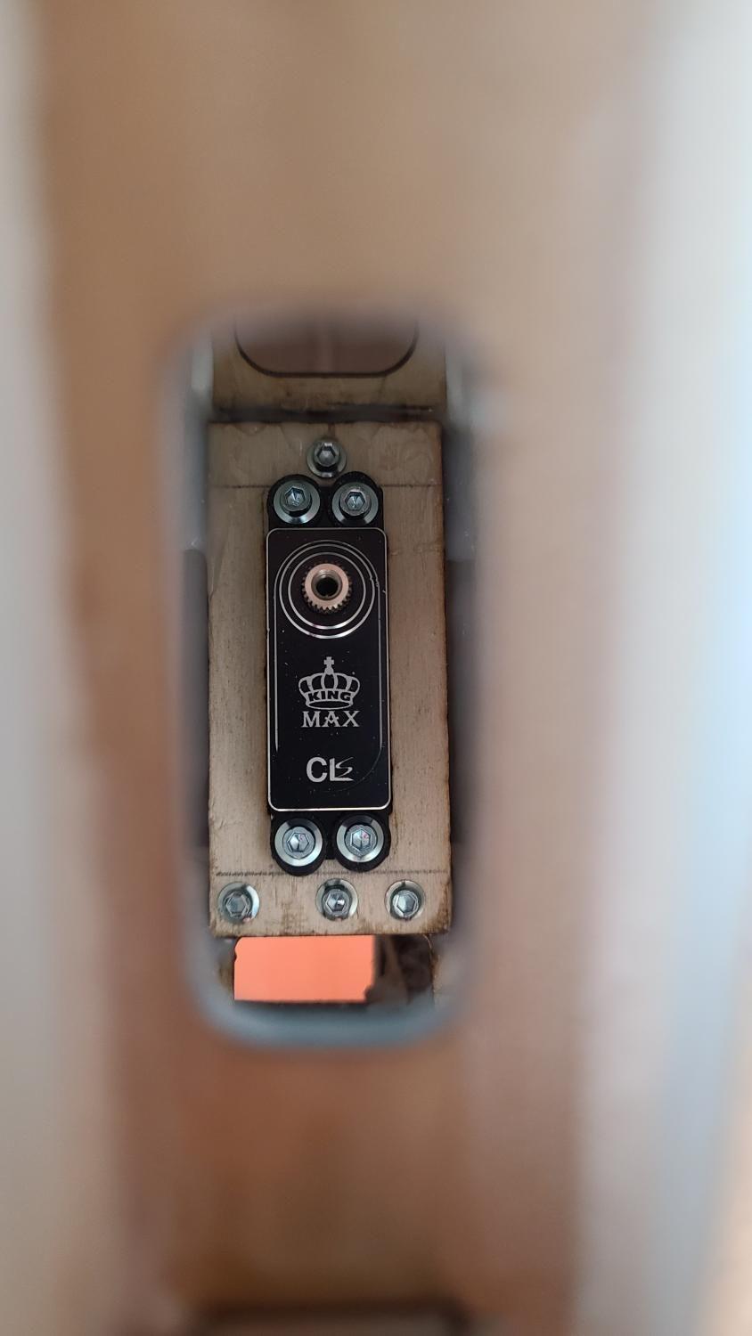

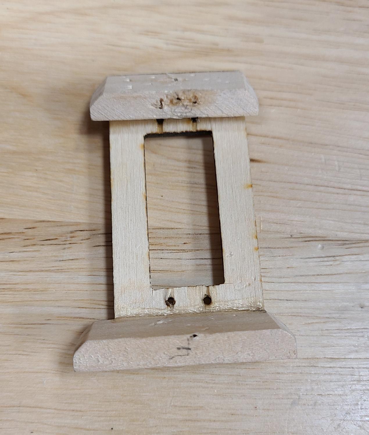

I am not 100 percent certain if this issue had been made public as it relates to the Top RC brand of electric retracts, namely the tailwheel. For those that are not familiar let me clue you in. The supplied placement of the retract servo will NOT function - ever. I addressed this issue with Top RC in China and they essentially told me I was full of it. I asked for advice from a friend who is significantly smarter than me and he agreed.
After pondering and looking around on Fakebook someone else encountered the same issue. His idea and execution mirrored ours. The retract servo needs to be relocated inside the vertical fin, this represents a 45-50 degree relocation. The catch however is, and this applies anyone that plans on servicing the unit after installation. Once everything is assembled and the rudder installation is complete you will never be able to work on it again, unless you hack of the rudder.
This issue was addressed in two fronts; relocate the retract servo and make the rudder removable for when servicing is needed.
the rudder needs to be removed in case servicing is needed.
Let me add this; it was not the easiest project I've ever tackled but it did turn out better than I expected.
For the rudder I used Robart hinges and ground of the rivets to create two pieces. We used a 12" x 1/8" drill bit to create the pilot hole through the entire span of the rudder and re-drilled with a 3/16" to finish it up. I inserted a 3/16 Sullivan pushrod tube with epoxy to create a pathway for the music wire to pass inside. Once that was complete I epoxied (3) Robart hinges into the rudder while using music as a guide. After the epoxy dried I removed the music wire and mated the other (3) Robart hinges to their mates. This allows for an easy method of removal for if or when.
For the retract servo I believe the photos are self explanatory. If you examine the first photos (our benchtop mockup) you can clearly see why the original placement simply wont work along with the concept placement we needed. Lastly, when everything was installed I soon realized once the servo was in the retract position and power was no longer to the servo the retract would begin to sag, due to the geometry and weight. I added a helper spring to keep it up. This is / was a test and I will make a determination if it needs any modifications. From the photo you can clearly see why the rudder needs to be removable.
This is the OEM placement - will never work
Concept placement
Helper spring - collapsed
Helper spring - extended
Geometry for proper placement
Helper spring installed

If you would have asked I could have saved you some time. I'm using Robart hinge pockets.
https://robart.com/collections/contr...e-point-pocket
Also if you wanted to pull the pin on the hinge use these.
https://robart.com/collections/contr...8-hinge-points

Hi mgosson
I am not sure whether you are referring to my post on Facebook, but I designed it so that you can access everything with the rudder in place. I did however make it possible to remove the rudder if necessary. I will post some pictures of how I made the rudder removeable - a little more simple than your design.
Once you get the tailwheel to retract, you will have to reroute the tailwheel control cables to allow the rudder to operate when the tailwheel is in the retract position. Please let me know if you would like to know how I did this.
Everything is working perfectly now
