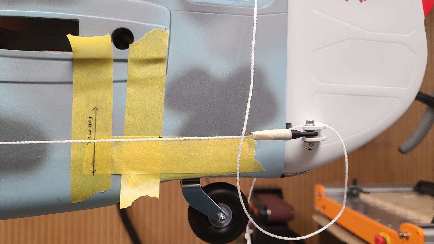

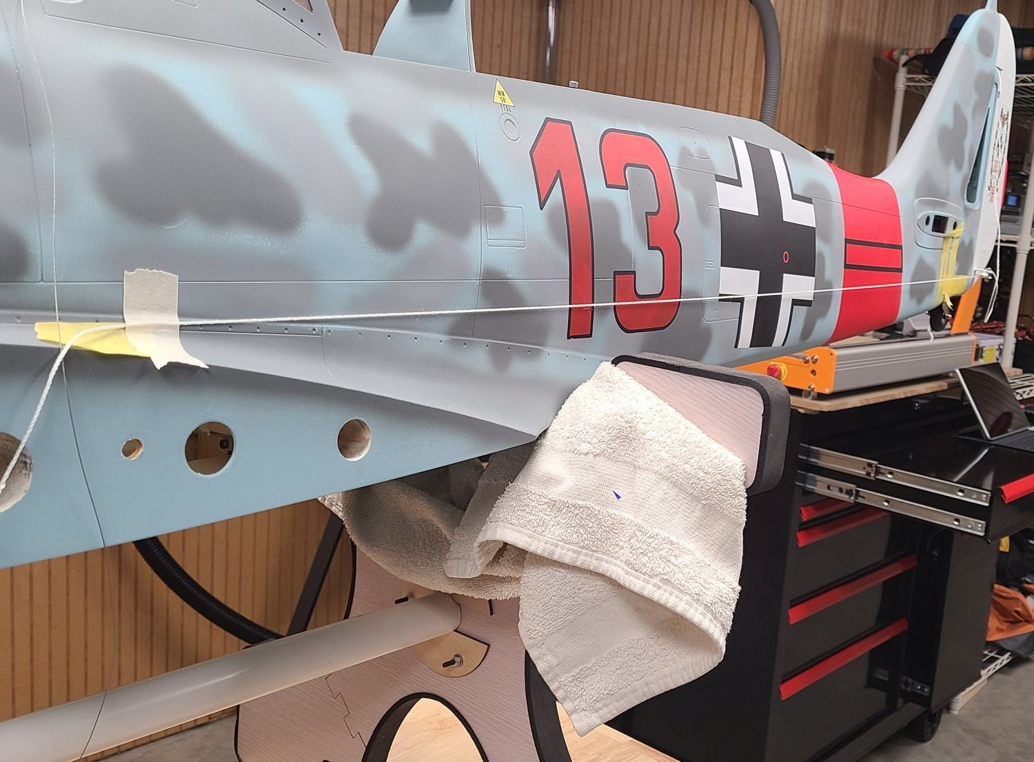

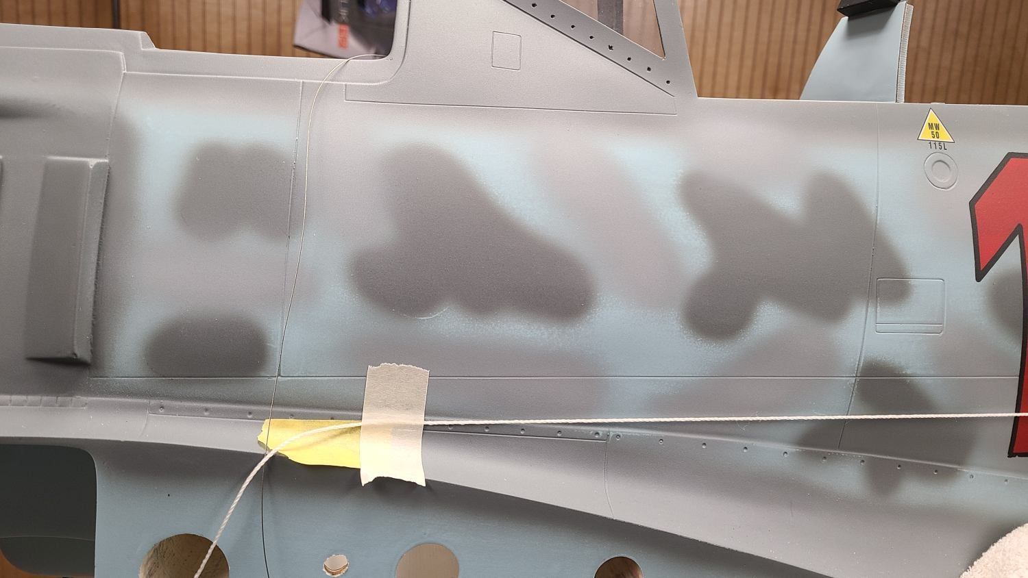

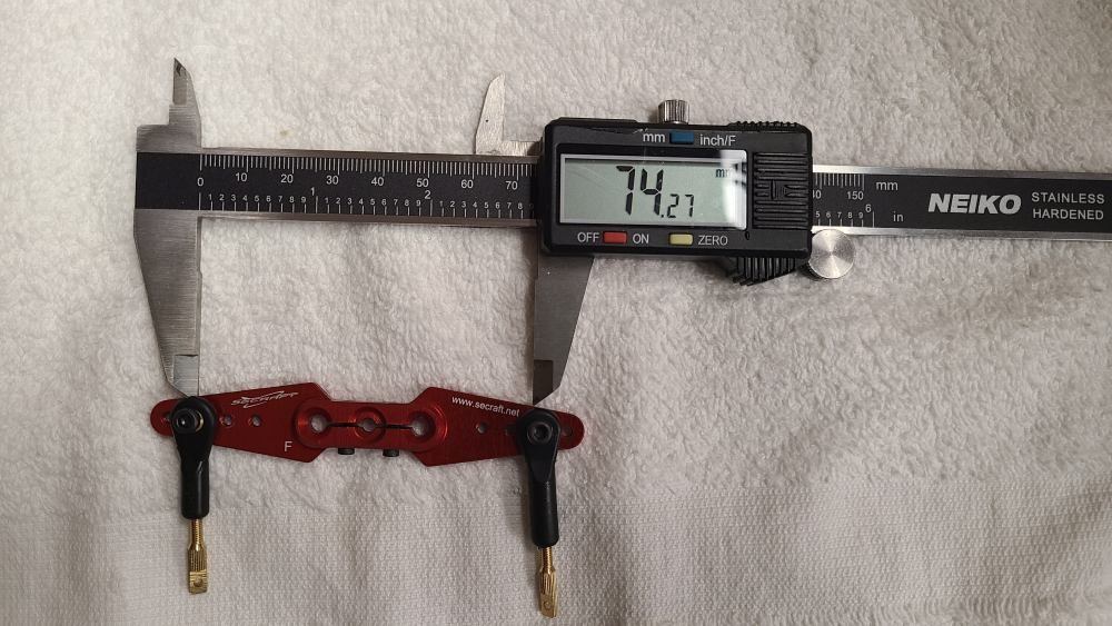

I am at the point of installing the rudder cables, and in my quest to reduce the work required to mark and drill holes I searched several forums to determine what everyone else was doing. For the most part many have used Top RC's recommended placement. I layed out tape lines on the fuselage as a guide. The vertical black mark is the internal former where the retract mounts, and the small black mark is the recommended spot where many have used. I was almost convinced to use that mark until I looked at Sparky's, His cable exits appear to be further ahead by approximately 30 mm from the photo I saw.
My rudder servo arm is 47 mm wide and the rudder horns are 47 mm wide as well.
What are your thoughts on placement?

I matched the servo arm width to the Width of the Rudder horn. If you understand the Ackerman effect that isn't terribly important I could have gone with a shorter on the Servo arm. As I think I posted a picture I attached the tailwheel hook ups using a ball link on top of the arm. So far its been satisfactory. My tailwheel has too much throw and it I usually overcontrol on pavement although it hasn't been an issue on grass. I need to do some more fiddling with the main gear toe as it has lots of drag when pushing and pulling and i think this may contribute to the overcontrol. Ill work on that in the spring. I still need to fly a few more times this fall to burn up all my mixed gas.
As i recall I did the cuts for the rudder where I computed the would penetrate the side of the fuse, and i think I too noted that it was different from the instructions. This might be attributed to using a longer servo arm or they crossed the wires on run to the tail.
Sparky

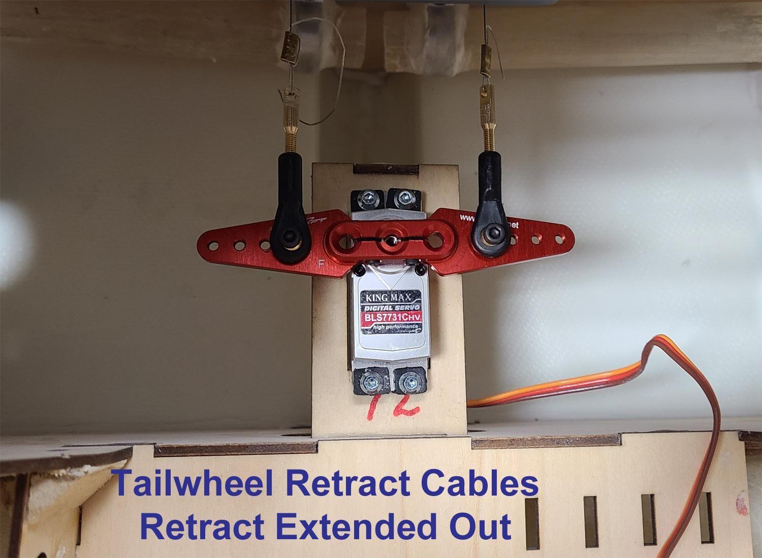

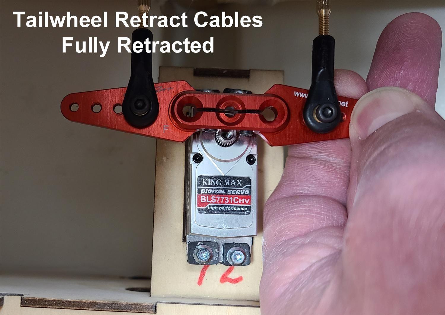

Posts: 127
Default Retract Tailwheel Cables
The saga continues with Top RC's electric retracts.
With the retract servo relocated most everything appears to function properly with the exception of the cables. Once the cables are routed through the supplied guide tubes and connected to the rudder servo the problem begins. With the retract extended out fully the cables have slight tension and allow for tailwheel steering to work correctly. The problem is when the servo begins the draw the retract into its up position the cables get tight, very tight and will allow the retract to pull up only but half way.
I removed the servo arm to see how much movement there is when you activate the retract. With the arm of off you can see the cables draw about 1/4" - 3/8" more than what's available to give.
Has anyone encountered this issue or come up with a fix?

Yes it is describe in my post 20 pages ago. Tim Evans uses another method as well.

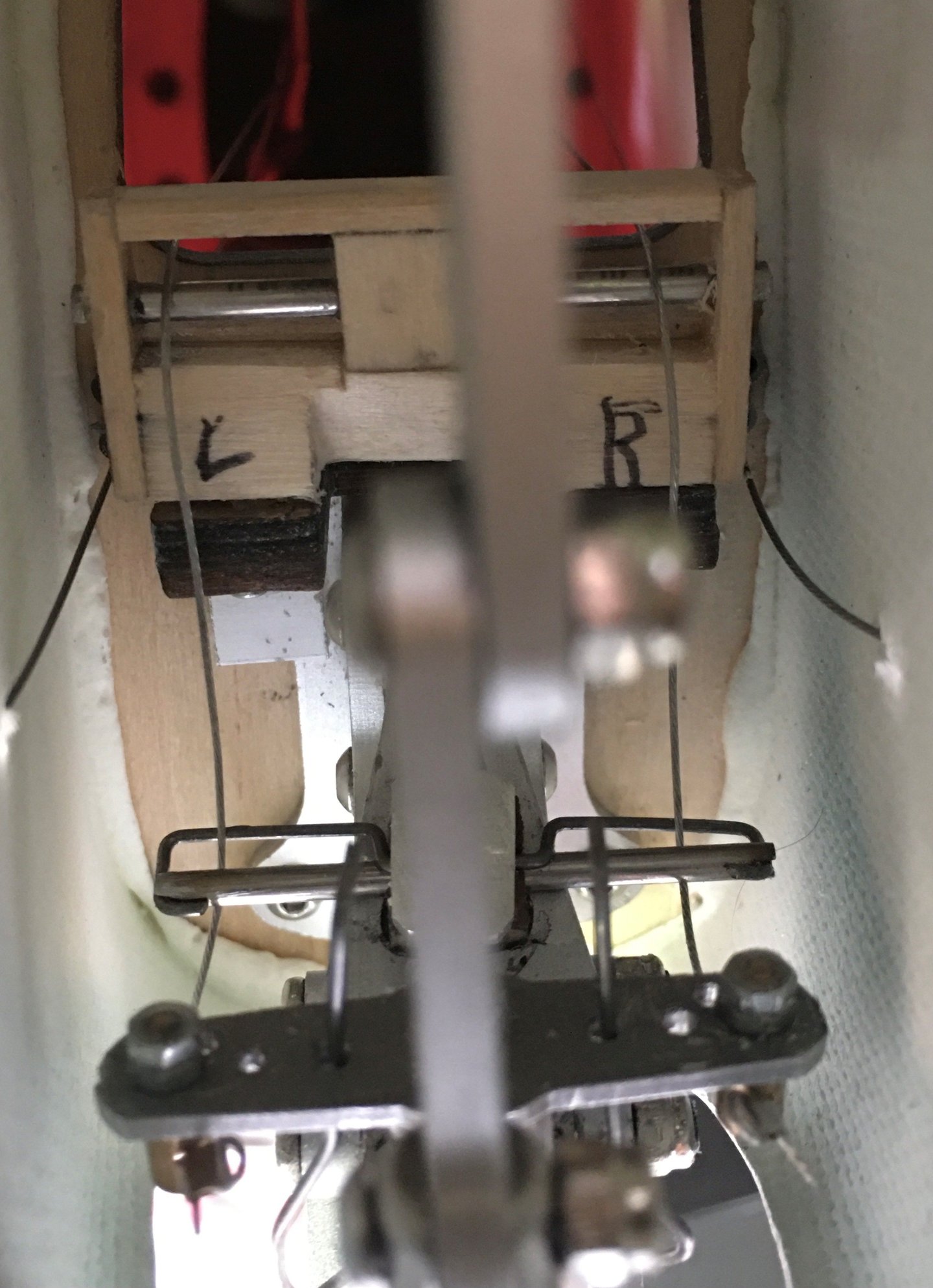

unfortunately you have to re-route the cables to give you enough slack in the retracted position. I will include a to show you how I managed this.
Stephen
Made 2 sets of pivot points to allow enough slock once retracted

I understand your design and will my best replicate something close.
The cable guide you used appears to be a piece of aluminum tubing affixed to a wood frame.
Once the gear is fully extended I assume the cables has some tension and when fully retracted during the transition no additional force is exerted to the rudder servo.
Thank you for posting the photo.

Hi Mgosson
You are correct - the cable guide on the fuselage was raised to the same level as the connection to the tail-wheel, when in the retracted position (to give the shortest distance to be able to give enough slack in the retracted position). The guide on the tail-wheel is mounted far away enough from the tail-wheel pivot to allow for enough movement to allow the tailwheel to turn fully.
The guides are made of servo pushrods (quite hard steel) - I recommend not to use aluminium, as it will be too soft, and the cables will cut into them over time.
Hope this helps. Stephen
