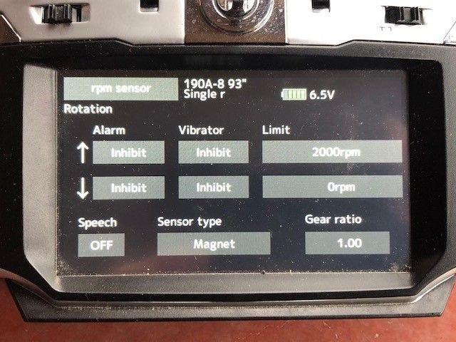

Not sure about Futaba. I have the Saito FG90. I use a y-connector off the ignition box tachometer cable for my in-air telemetry with a Spektrum transmitter/receiver.
One Y-lead plugs into this: https://www.horizonhobby.com/product.../DLEG5525.html (for monitoring on the ground)
The other Y-lead plugs into this: https://www.horizonhobby.com/product...r/EVOA113.html (for monitoring in the air)
This Evolution Adapter then plugs into the RPM port on my Spectrum receiver.
Pretty easy.
Does Futaba have a RPM port? Could these parts be adapted?
Just a thought.
jim

I checked out the manual of my transmitter, seems that on the T18SZ is a parameter to set the ratio of the rpm, It value was 80, I modified it to 1, now the rpm is ok.

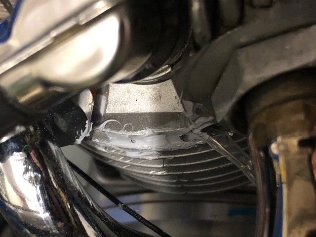

The engine runs great, however, at full throttle for about 1 minute, the temperature rises above 300°K
I hope the baffling will work and cool down the engine during flight.
Carlo

300K? as in Kelvin? On the ground or in the air? What are you measuring and where is the probe? I don't have the Kelvin scale handy so if its C as in Centigrade that seems high depending on the previously mentioned points.
I see 250F on my sparkplugs on the ground. In the air slightly lower in flight from what others who look at it tell me. I almost NEVER take my eyes off the plane when I'm in flight. From what I see of your ducting I'd tighten up the gaps. Its ok for it to touch the engine. especially the radiator fins between the cly.

300° Kelvin or 150° Celsiuson the ground.
The probe is at the backside of the top cylinder, it is mounted with high temperature silicon between the ribs.
I will try later to measure with another device to check the temperature.
Is it possible my prop is too big?
I run a Ramoser 23.8" prop, the pitch is adjusted to 12"
Max. rpm on the ground is about 5800

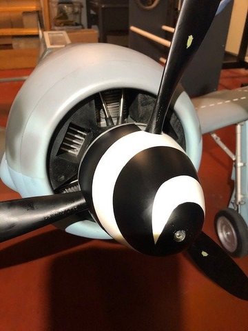

Got mine out yesterday for a couple flights. My good friend Wayne Matthew’s accompanied me along w his Leonardo jet.
This time I flew it for the first time with the SEP 26-16 two blade and cooling fan on back of the spinner. Overall the plane flew great, but I don’t think I have the engine dialed in as yet. It looks like I’m going to invest in some telemetry to get me some real time RPM’s in flight.
Joe

Carlo,
150C seems a little high to me. But I'm not familiar with that engine. Tighten up your baffles as previously suggested. Go down to 11-10" pitch if you can do the adjustment.
Jaycut,

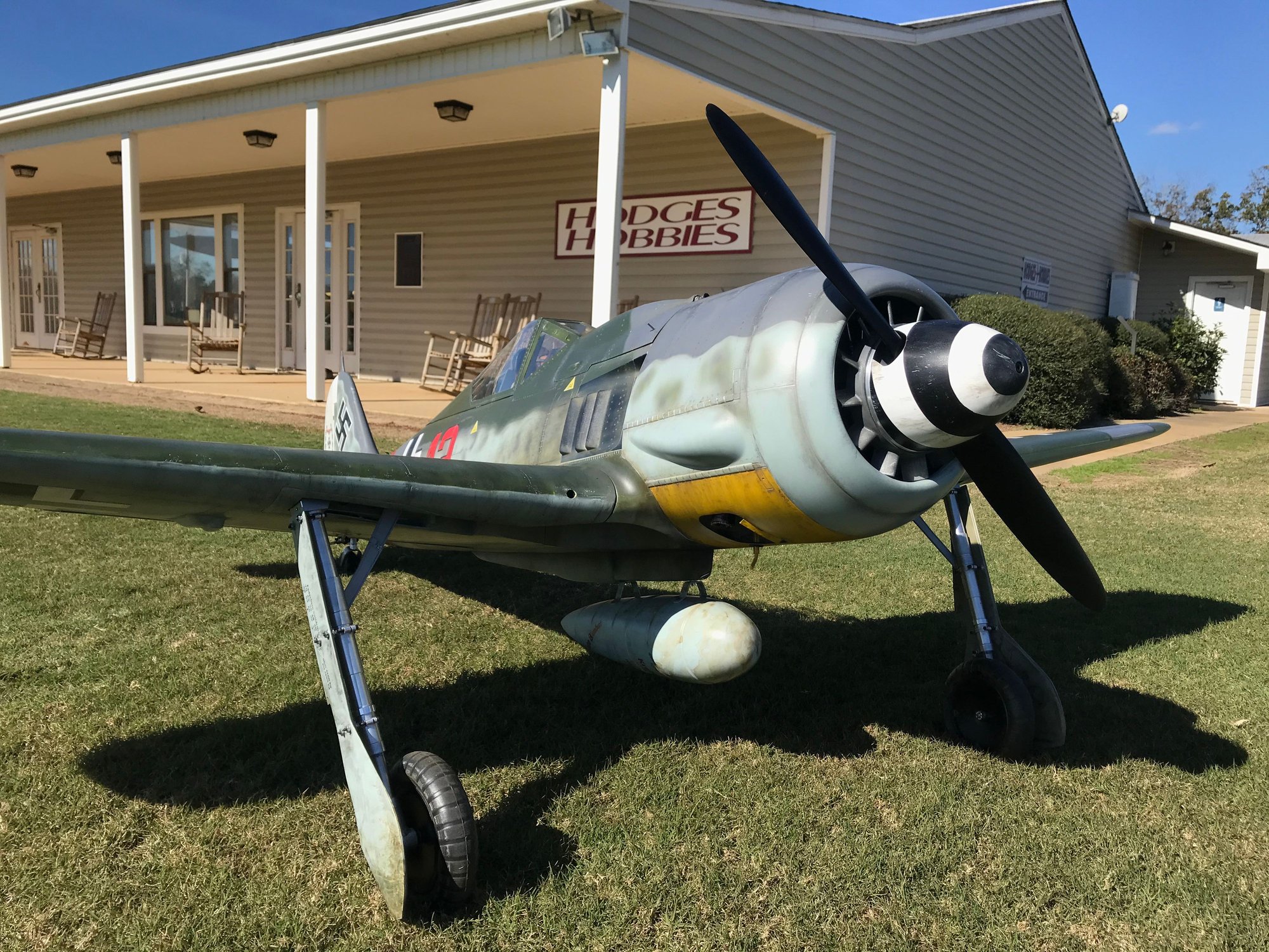

I'm glad to see Mac Hodges flying field I only visited once about 15 years ago, the hobby shop was in the process of shutting down. I remember the check out was what do you think the pile of stuff is worth and that's what I paid. Some amount less than retail but all fair prices. Your plane looks nice.
Sparky

Thank you for the compliments guys!
Yes, Mac is a great guy. He was flying a couple of his home builts while we were there. The hobby shop is now a great big hanger
I had gotten the fan from a fellow member here in the forum as he had come across another style fan to use. The fan was made by, Rev.
I did open the bottom of the cowl up more than what I had before as well as adding some air deflectors on the bottom to help pull some of the hot air out.

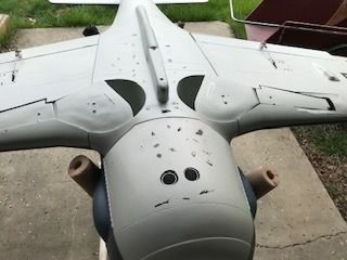

I didn't cut any extra holes in my cowl just the two scale exhaust on the sides and maybe about 1/8" clearance around the exhausts pipes that sit flush with the cowl. Before you add holes in the cowl do reduce the pitch on the prop and tighten up the baffles.
I found this view of the exhaust exits. Ignore the globs of oil paint as I am documentating the weathering on my plane it got a lot dirtier from here!
I've previously posted pictures of my engine duct work.
Sparky

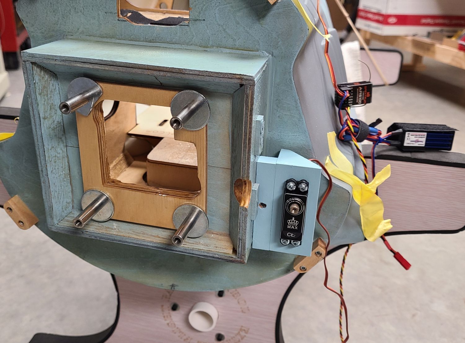

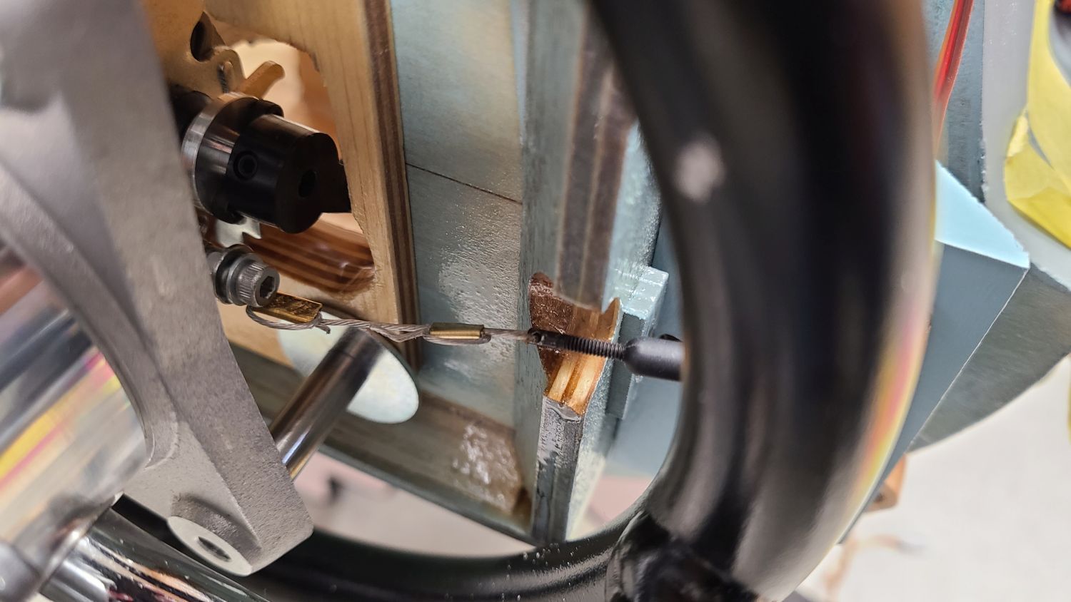

Default Remote Choke for Saito 90

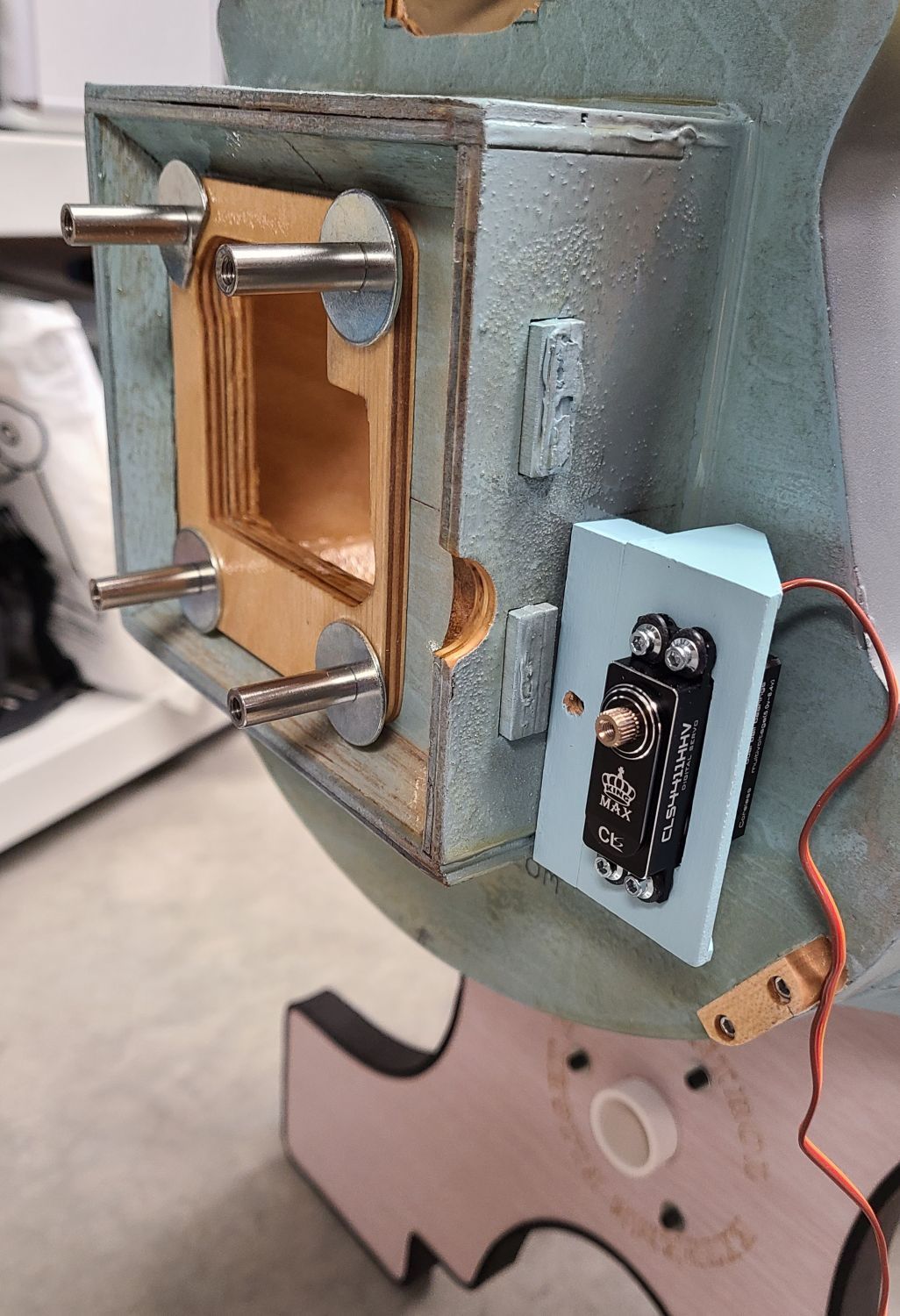

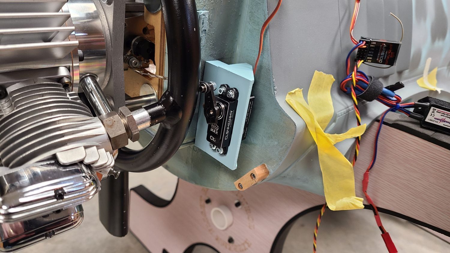

Good Day,
After performing a test run / break-in on the Saito FG-90 mounted to a test stand my friend said "you need a servo operated remote choke". I thought about and decided the 190 needs added weight in the nose anyway, why not try it.
I made a hardwood mounting block that attaches to the engine mount (T shape) along with a servo tray that screws into the hardwood block. Mounted a mini size servo to the tray and used a piece of pull-pull cable to connect the throttle arm to the servo arm. The cable offers free movement through the rotation of the carburetor with no binding. At the closed throttle position the servo will pull on the carburetor barrel and activate the choke. It's pretty slick.

Great idea - well done!!

I see the carb intake is inside the fuse. My 60cc motor is similar. I am using a 3 line fuel system. During fueling I discover the carb will dribble a few drops of fuel out of the intake.
That isn't good to trap raw fuel inside the airplane. I also learned that over driving the carb all the way closed will stop it from dribble Move the throttle stop screw out as far as possible. It will stop the fuel dribble. But it is a position I never use in normal engine operation. I have it set to failsafe to that position so after engine shut down I turn the RF off on the TX and it goes into preset failsafe and overdrives the throttle way closed.
YMMV
Sparky

Advice taken, and will be implemented.
Thanks Sparky
