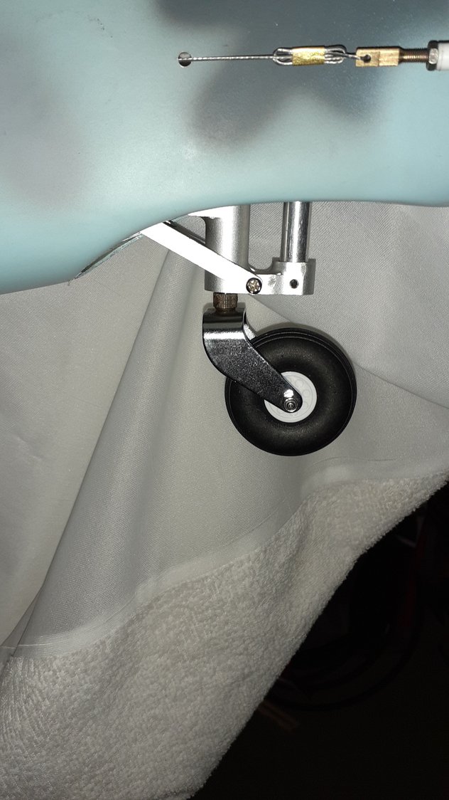

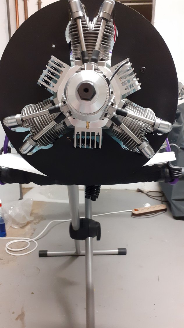

hello Jim. The plane has a saito fg90 with a two blade fiala 24x12. 6600 rpm at the ground. I have baffle.

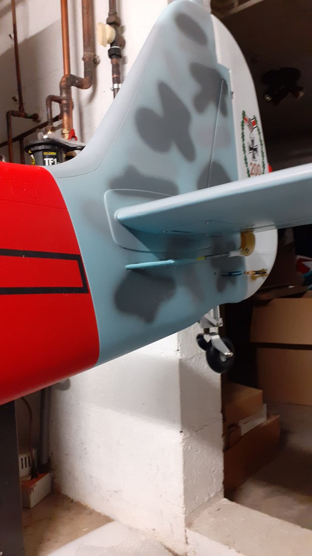

The weight 16.4 kg (cg 172 mm). But the servo are not in the tail. I put it in the fuse. The command beetween servo and tail are steel wire of 3mm.

I change the rear wheel and the wire off the wheel and rudder 0.8 or 0.9 mm. The wire off the kit were too small.

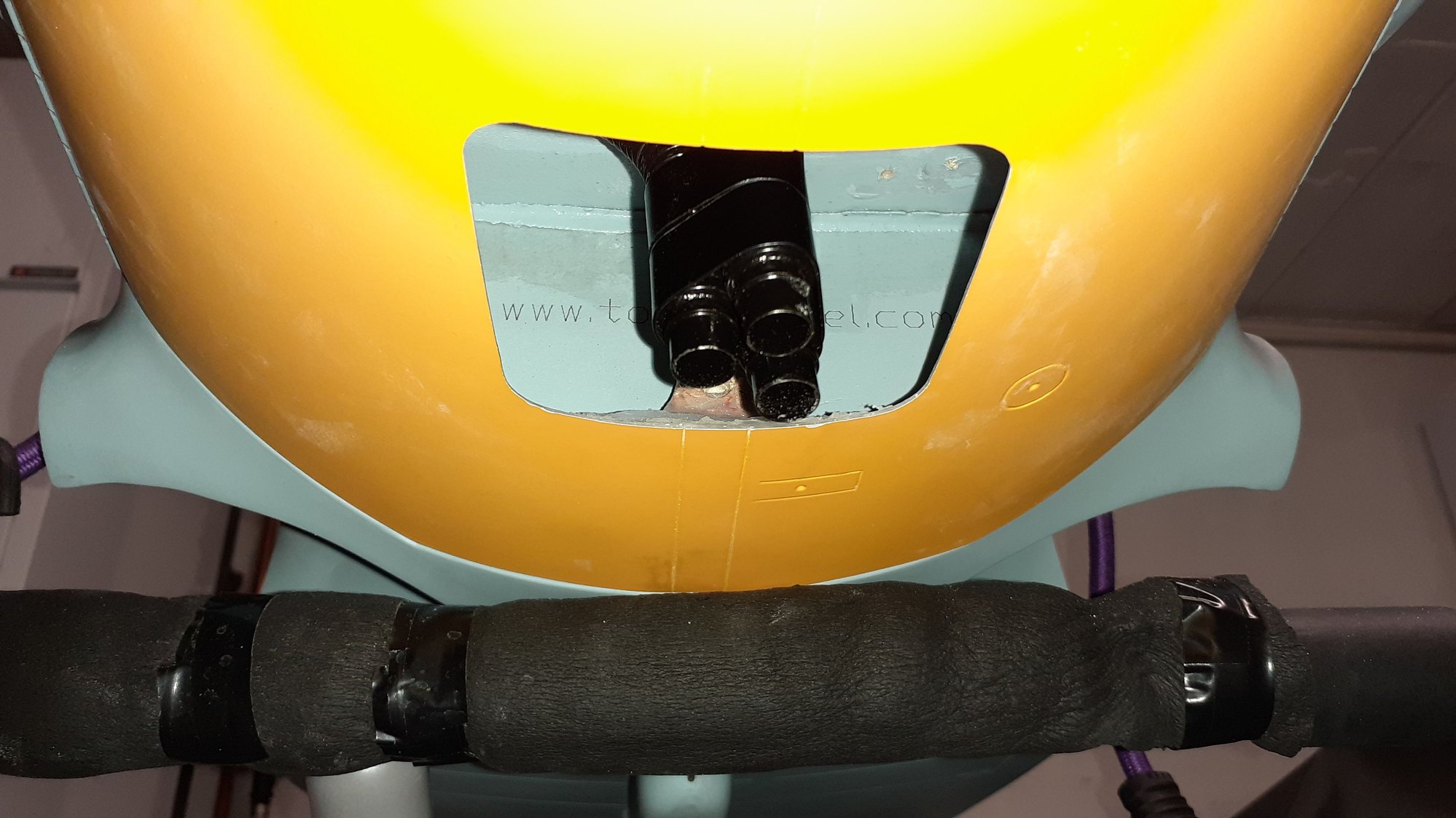

No overheat issue with this size of the hole with standard exhaust pipe.
