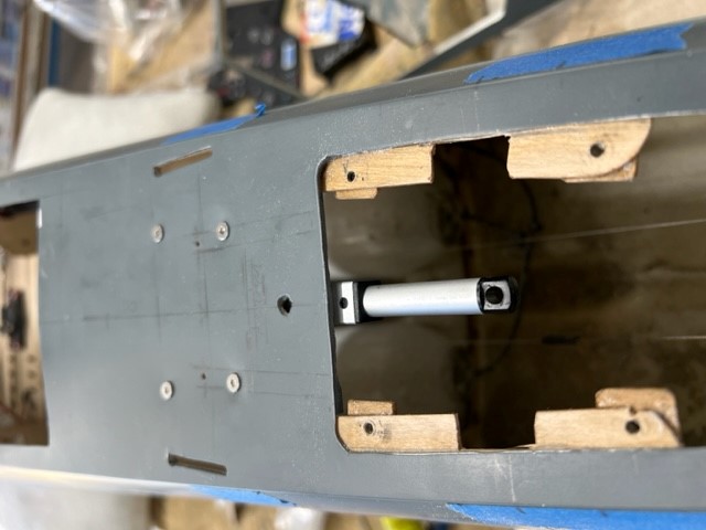

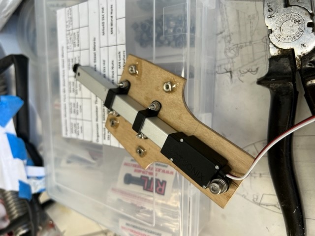

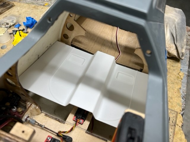

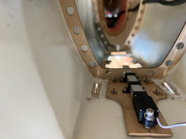

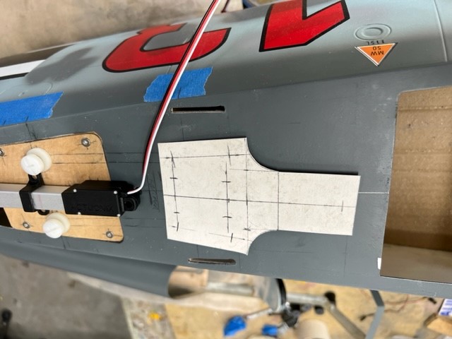

Sliding canopy pretty much done. Some scale details and painting to do in it before the clear glazing go back in.
Front cockpit floor needs a little trimming but is very close. It is very flexible and the idea is that I can easily remove to access the wing bolts.
Waiting on new cockpit kit to arrive, a 1/4 scale one. The 1/5th seemed a bit small. Anyway I will have both to pick and choose from if need be.
Might even get some painting done tomorrow.
Cardboard template of actuator mounting bracket
Actuator and bracket
Actuator mounted with 4 x 3mm counter sink screws into blind nuts.
From the top.
Works !!
Front cockpit floor. Will pretty much just sit there and be easily removable to access the wing bolts and leads.
Just a little trimming to do.
