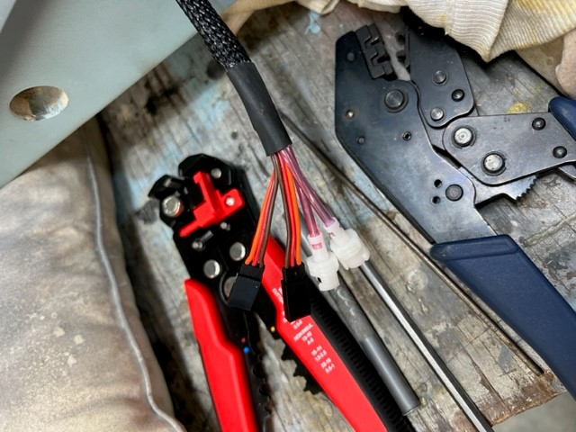

Added a decal to each of the main wheels and terminated the wiring for the elevator at the rear, still to do the front of those cables.
Of course you need the correct tools, wire strippers that strip to correct depth and crimpers.
We had similar but much better tools when I was a techo in the RAAF.
Critical to cut the ends perfectly square
Voila!

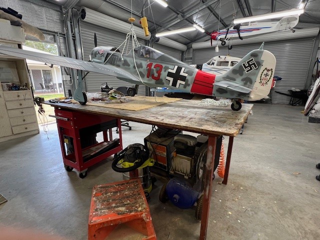

No flying Sunday as it was blowing a gale cross strip which is a shame as I had the Typhoon to fly, no pun! Name:  smiley8.gif
Size:  530 BytesName:  smiley36.gif

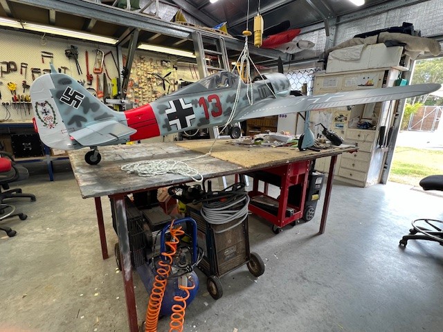

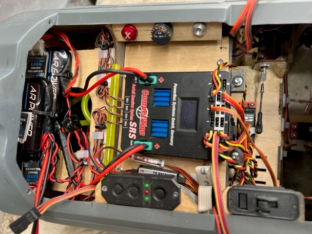

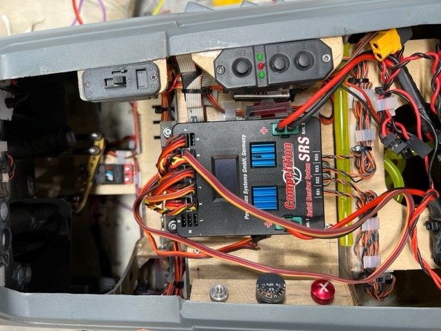

Big day in the shed Saturday 10 hrs doing wiring. Due to me stupidly fitting a great planes 24 oz tank instead of a dubro I can't remove the tank without removing the rear former the powerbox mounts to. That will be a lot of work as a lot of wiring has to then be undone.
Anyway I am leaving it for now. When it has to come out I will fit a tank that can be removed simply by remove gear servo then sliding it out!!
A lot of wiring is done but have run out of hitec connectors and the crimp pins. Will have to order some more. Also needed to make up an adaptor for the kill switch to connect it to the ignition battery which has a XT-60, luckily a mate in my club had some so dropped into his on way home and he gave me 4 pair. Nice!!
4 more hours spent this afternoon but not all on the FW-190, did some work on the BH Typhoon, need to sort out the axles to prevent them coming loose and causing massive tow out. Last landing it was like the brakes got slammed on, up on its nose, balanced on its nose for several seconds then slowly over on its tail. No damage and the expensive biela 3 blade prop is ok.
Need to get some M5 50mm bolts, nuts and washers and hopefully I can sort that problem.
Short Youtube of pilot's head that is slaved to rudder.
Wiring progress and working out how to program the powerbox
More wiring. The long look has to be shortened then a new connector terminated, I'm out of them. Other lead only has one pin terminated.
Right hand loom started out of the fuz side.
Right hand loom completed
Telemetry stuff to be fitted someplace, its times like this I wish I had a more upto date Tx such as a Spectrum ix20 which has the telemetry already. On the upside this iiSRI system allows me to have 3 x cylinder head temps, RPM, altitude, speed etc via a GPS.
Later lurkers
ID:	2273275   Click image for larger version
ID:	2273276   Click image for larger version
ID:	2273277   Click image for larger version
ID:	2273278   Click image for larger version

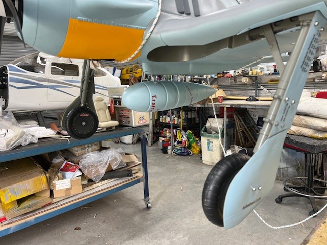

Back on wiring, my good mate Dennis came through with some connectors and pins he had and wasn't going to use. Did a couple of hours fiddling in the shed after work and got the 2 cables done near the power box and the left side wing loom done as well.
Next jobs will be cables from ignition - tacho and input lead then the 3 cylinder head temp thermocouple sensors.
From there I need to install the telemetry stuff.
Set throws
CG & weight
ground runs
then ....

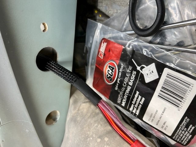

Felt like doing some of the engine cabling last night after work. Couple of hours work.
Drilled a 15mm hole in the firewall to run cables through into the inside and have a rubber grommet that will be glued in there with silicon sealant.
All ignition spark plug leads have spiral conduit on them and cable tied to stop them flapping.
Instead of making a heat shield out of aluminium (al oooom in ummm for the yanks Name:  smiley36.gif
Size:  486 Bytes) I used some left over muffler heat bandage I had from when I put the fokker together.
Cable tied in place and will do the job. Simples! Name:  smiley17.gif
Size:  493 BytesName:  smiley2.gif
Next job is the 3 x cylinder head thermocouple probes then will bundle all leads into some spiral wrap and pass through the grommet.
It's progress!

entry point into the fuz for the cables coming from engine bay. Those red/black wires do not pass through there, they go to the battery balancer cct.

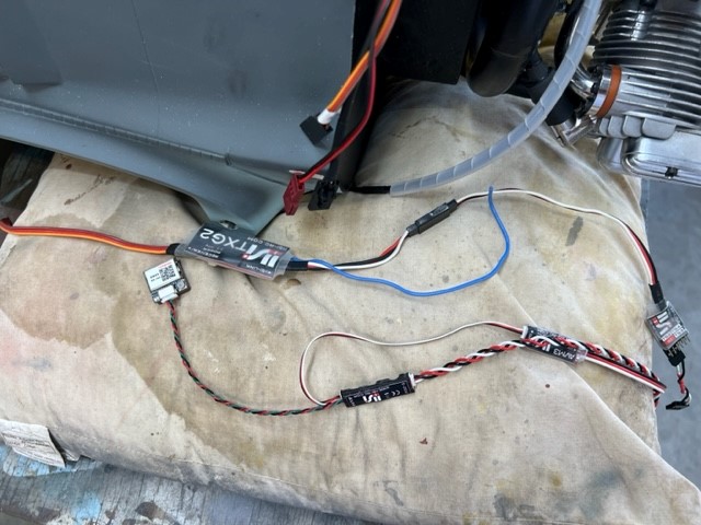

Some electrics are ok, elektron are supposed to be very good. I have Sierras on mine as well.
So the FW-190, been a frustrating day. The iisi cockpit v2 unit will not power up. It has not been turned on for over 12 months and was dead flat, put it on USB charger and it eventually came to the charge process and charged it self was sliding bar graph and 100% full indicated.
But would not turn on, tried reset and all I get is a white screen. Occasionally I get SD card error, pulled and reseated that. Tried another micro SD card with same result.
Have emailed iisi to see if they can assist. Still under warranty so may even get a new one sent.
The devices need to be paired to the iisi Tx unit TXG2 and another couple of modules. As I need the cockpit v2 working to do the pairing there is no point doing final install of the gadgets and associated wiring.
Anyway I get all three temp sensors fitted and all the cabling through the grommet.
Kill switch is connected to the ignition module.
As far as I can go with that side of things and really want at minimum temperature readings to do ground runs.

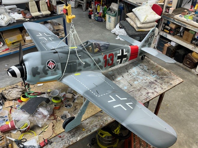

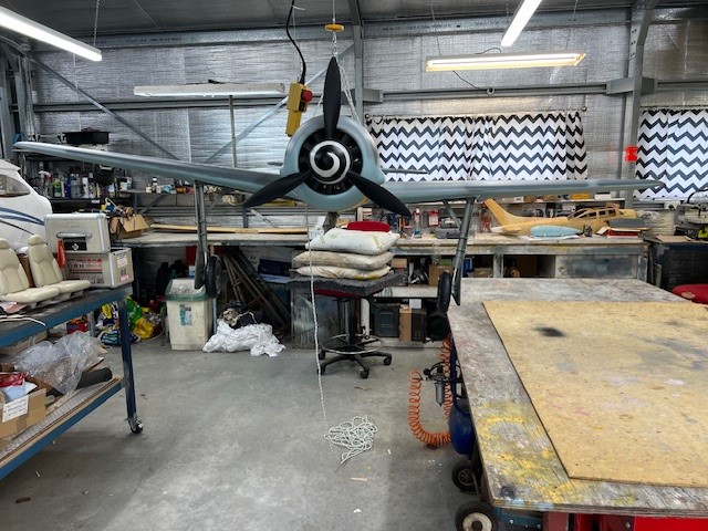

Prob fit the baffle, cowl, hook up the wings and do a swing test then CG.
had enough for today though and stupid dog next door is annoying the heck out of me. Pomeranian, who the fxxx has a stupid dog like that Name:  smiley7.gif

More programming done, have not yet reduced down travel on the ailerons but everything else is pretty much done.
Though as I type this I need to also set the failsafe on the powerbox. Main failsafe from the Tx seems to work fine as the throttle goes back to idle if I turn off the Tx.
sprayed red the markings on fin/rudder, elevator and stab that indicate the clamps they put on those moving parts to leck them in place. Still to do the little red stripe they put over the cowl latches. Forgot about those when I was playing with the spray gun.
Needs a little weathering and some exhaust staining.
Got the wings on and battled getting the baffle bolts in for over 2 hrs, as they are fine thread if the bolt is slight off centre it won't start was a right PINTFA to get them in but I did after much swearing and sore hand/fingers. Name:  smiley7.gif

I then hooked up the vanessa rig. I am so pleased I have electric hoist on a gantry!!
Set the model into flight attitude which gave a zero bubble of spirit level when placed on the gun hood.
I measured the 166mm back from root of the wing at leading edge and marked that on some tape on the wing.
I then calculated 33% of the MAC which is 470mm or 155.1mm. This was done at the point in the wing before the outwards taper then that point transferred to the tape.
As it worked out the 33% MAC is 176mm from the wing root at leading edge.
I would suggest the TopRC nominated CG location will be very conservative and the model would be nose heavy at that location.
According to the vanessa rig the balance point is right in the middle of those 2 locations at 171mm from root leading edge.
I am calling that as suitable for test flights.
No additional weight required to balance which I am **** happy about.
Next job was to weight it. 19.05kg or 41.998 lbs, let's call it 42 lbs. I expected it to be around 40 lbs.
Was going to do a retract swing test while it was in the air but forgot. Will do that today.
Then to get it on its wheels!!

Happy with that CG @ zero bubble.
19kg or 42 lbs!! Name:  smiley3.gif

Got it on its wheels for the first time and did retracts test. All went well as you can see from the youtube clip.
I got nervous about the CG, it is rare to have a model balance. I want to do it with model upside down but will need to get a mate to come over to give me a hand as the model is too heavy and awkward to do on my own.
I'd rather double check things than not!!
Also fitted the drop tank to see how it looks. Need to get the additional nomenclature for it as the ones I got were not everything.
Bit of mild weathering to do yet.
First time on its wheels
and a clean bench again ...

I kept thinking about the CG and not not needing additional nose weight and even picked up the tail and thought this is not right, inner voice kept at me about it.
This afternoon after work I re-checked it after I had watched a chap on your tube using vanessa rig.
He took a zero bubble measurement on his stab so I thought I would do same and for good measure I checked if zero bubble was on the panel line going almost full length and it was - ka ching! Name:  smiley20.gif
I checked where I had marked the locations for 166mm from root LE (TopRC manual location) and my 33% MAC, I was about 8mm out so remarked the locations using a large clear triangle on said zero line.
Ok onto the vanessa rig, set zero bubble and it was about 10mm rearward of the 33% MAC so add on the other 8mm or so and it was badly tail heavy Name:  smiley11.gif
Size:  397 BytesName:  smiley22.gif
Size:  498 BytesName:  smiley3.gif
Size:  593 BytesName:  smiley5.gif
Size:  498 Bytes oops!
Added 4 round sinkers, reset zero bubble, check, repeat till I am just slightly forward of 33% MAC.
587g or 20.71 ounces, 1lb 4.7oz
New AUW dry is 19.64kg or 43.3lbs Name:  smiley3.gif

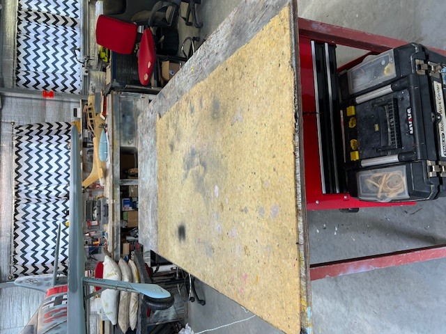

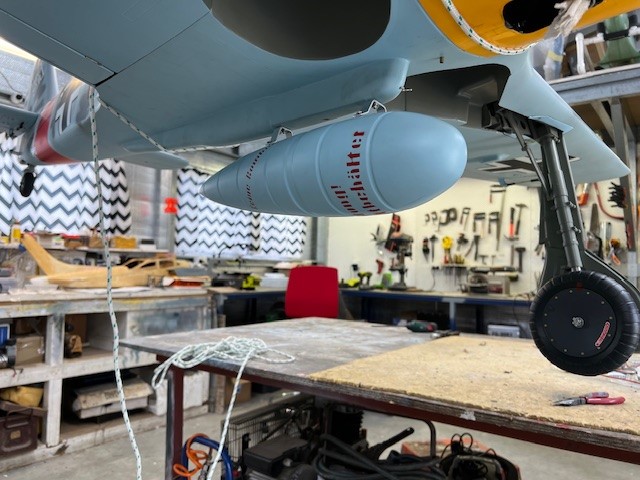

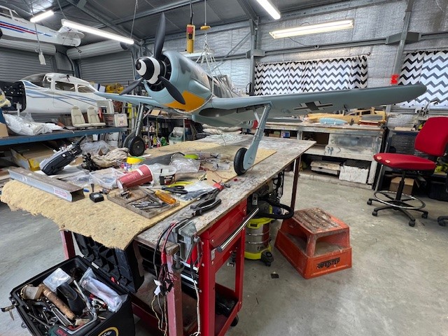

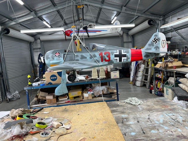

Anyway to satisfy my OCD, you arent the only one with it I decided to follow my gut instinct and pull the model apart, rotate the fuz upside down, refit wings and do the balance again.
Was easier than I feared to get it apart and upside down.
Marked the 166 & 169mm points and set out to rebalance. Used same datum reference for zero bubble.
I have now removed 807g or 1.779lbs, for a new AUW dry weight of 43.585lbs or 19.773kg
Quite happy to have had to remove weight.
Helps having a 50kg electric hoist on a gantry.Name:  smiley2.gif
upside down miss pat (aussies will get it)

Sizing went awry, oh well. You can see the starting location before adding any weight.
Vanessa the undresser strutting her stuff Name:  smiley36.gif
Size:  486 BytesName:  smiley16.gif
Size:  462 BytesName:  smiley2.gif
Lead removed from where I had it yesterday, 807g, 1.59lbs
Weight to be added now, 723g
In ounces
1.59lbs to be added, big reduction.
New AUW dry
