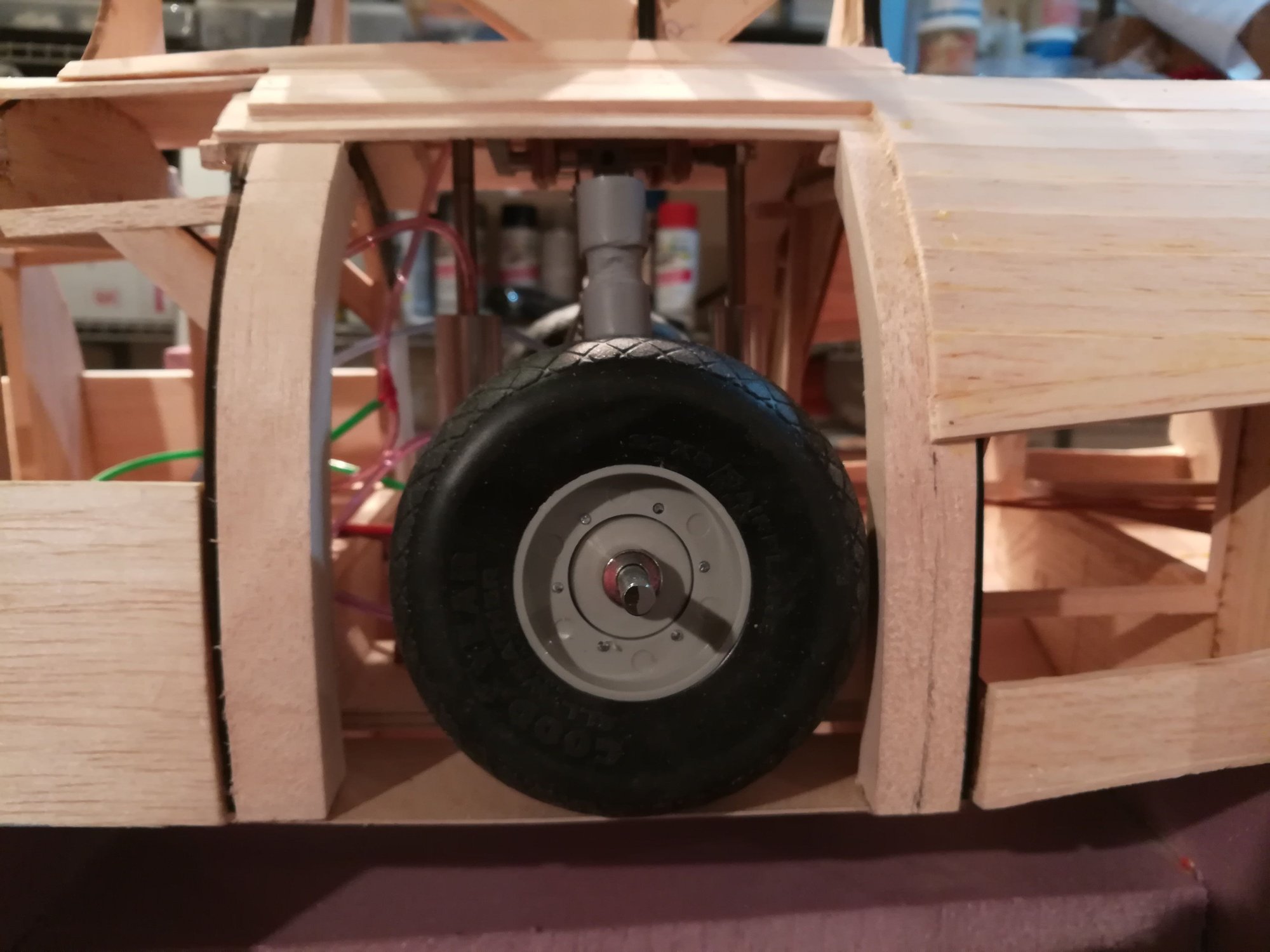

But there's been some progress on the plane too. I have started to fill in the area between F5 and F8 where the landing gear are. With nothing to follow in the plans, I have been making it up as I go. I started by adding 1/2" wide balsa formers to the inside edges of F5 and F8. These will support the planking when it goes on and give me enough wood to work with to cut a removable section out later. The removable section will start about 1.5" above the water line and go to the bottom of the pylon. This will provide access to maintain the retract system. Here's some picts of the work so far.

Nice build. I really like the retracts. Are you going to make the wing tip floats retract too?

Jdolomount - yes, the wing tip floats will retract. Absolutely!
I've finished closing up the wheel well area and continued the planking. Will post picts soon.

When planking around the wheel wells, it was important to keep track of where the opening is, to know where to cut!! So, i'd put dots on every plank that covered the opening.
