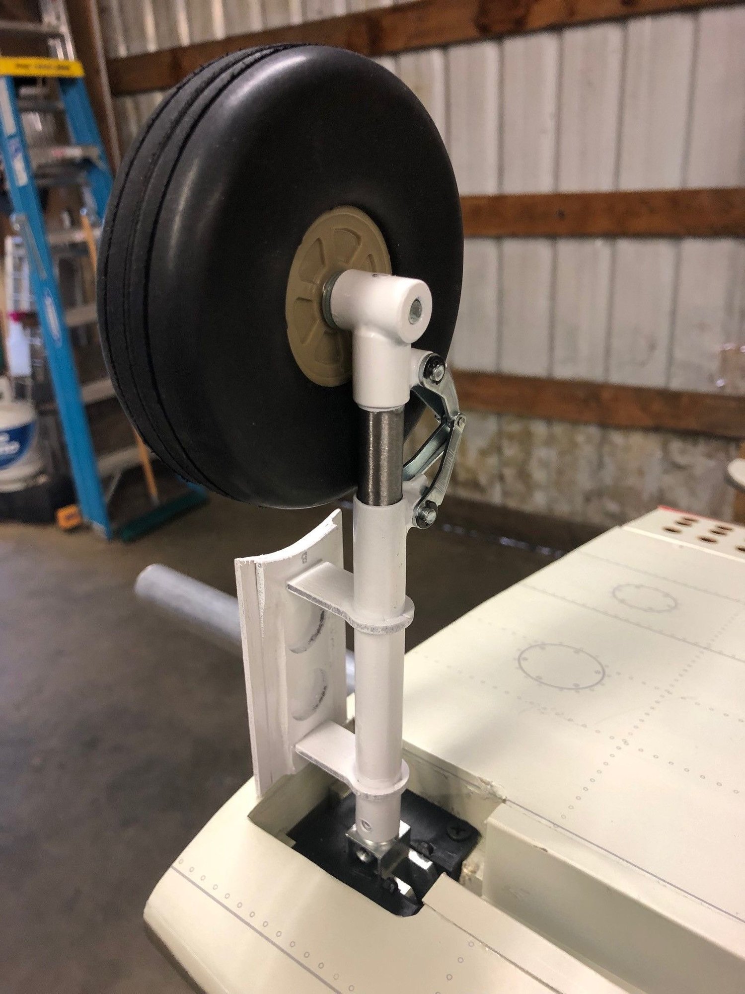

Ok, started on the wing/retracts, still waiting for the servos to get here. So doing what I can until then. I did get the EME35 Auto Start, cant wait to mount that up too!
First thing, take THIN CA and run around everything you can reach, just something I do that doesnt hurt.
Then, I put the struts on the retracts, hook the retracts to a rx, cycle them, get the gear legs up, I had to file the slot for the set screws down closer to the retract, *you must have the struts touching the retract! Otherwise the rod will bend with any load on it.
Drill out the wheels to accept the axles, I used a 13/64" bit, and had to put two washers between the wheels and the strut for clearance of the tire to the strut.
I used my dremel to sand a groove in the wing opening for the strut to fit in, Ill have to clearance it a big more when I get the doors mounted to the struts.
Thats it for last night, these are big beefy retracts, felt like they had alot of power. * Be sure to drill a pilot hole for each of the retract screws, otherwise youll split the wood.
Slot needs to be filed closer to strut
Sand the slots for the struts to fit into

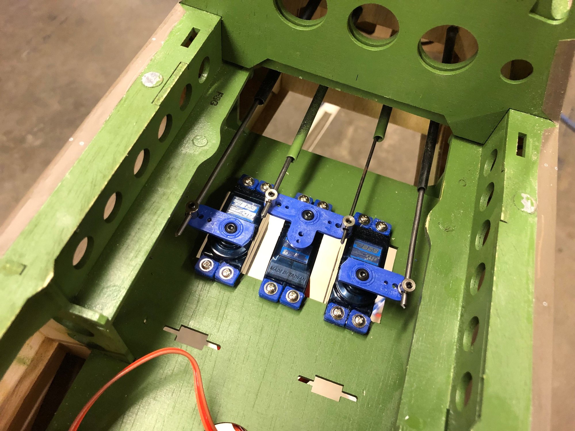

Busy weekend, still waiting for my servos to get here, hopefully today.
Elevator is glued on, I had to do a little shaving in the fuse to get it square to the wing, but it all went well. I had to do the same to the bearcat. Once its all glued in you can go in the back bottom of the fuse and drop some glue in there too.
The wing center section, I took a pen and marked on the fuse where the colors line up, to help with lining it up in the future.
I got everything hinged, they call for epoxy so I did that, and they say to pin the elevator hinges with tooth picks, I did that and the ailerons too, for fun.
I always cut the covering out of the way under the control horns, and glue the horns as well as screwing them on.
The rudder control rod, just like I did with the bearcat build, I added some ply pieces to take the slop out of the bottom. Also, the little eye you thread onto the rod for the rudder control linkage to hook to, drill it out, mine split..
The tailwheel linkage, the black horn, I had to sand mine down for a smooth fit, otherwise it was too tight, then I ground a slot for the collar set screw outside of the tire to keep it locked on there. And a touch of blue locktite.
And I glued on the filler piece on the front bottom of the wing.

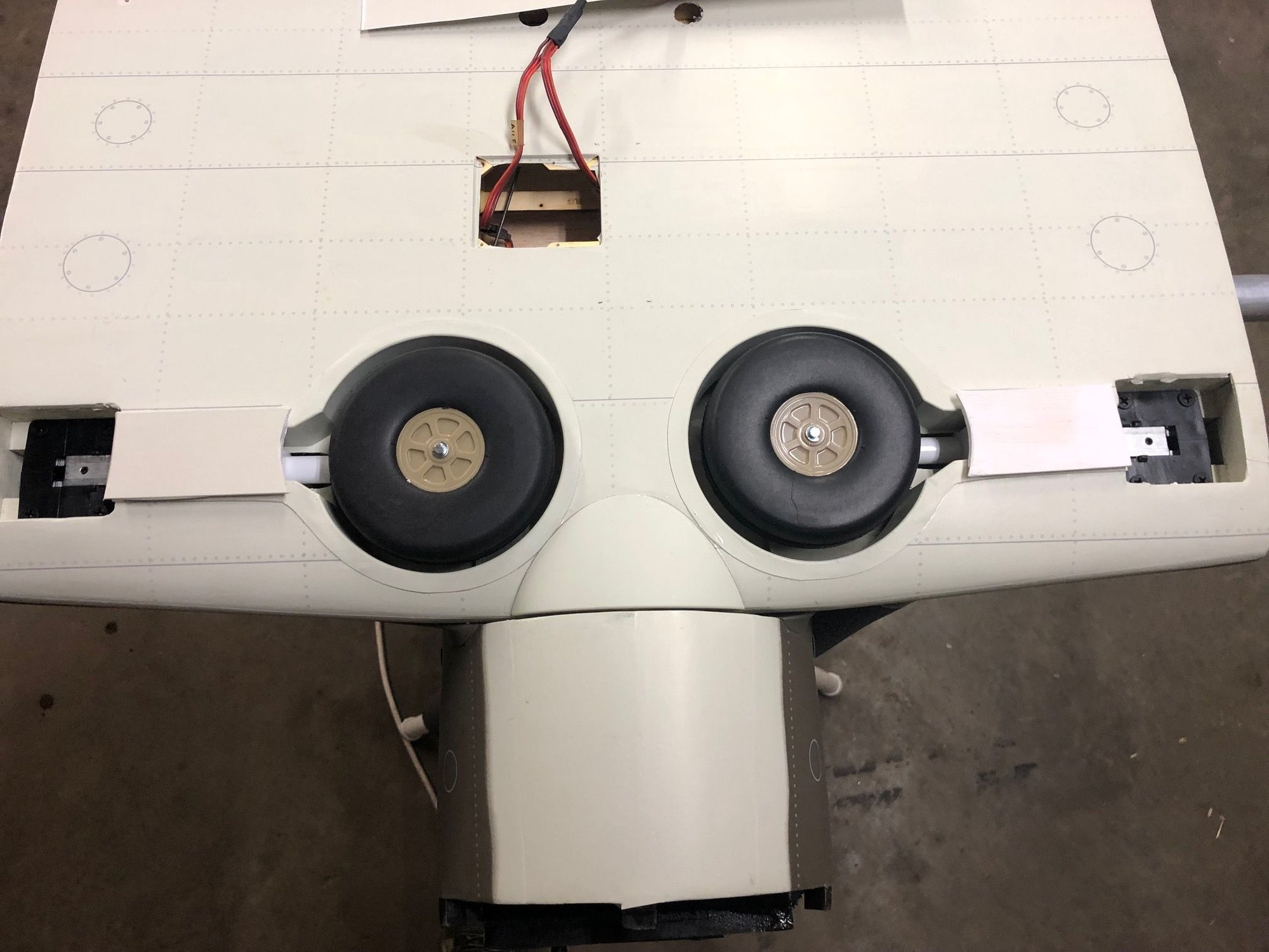

Retracts and doors. With the way the gear is on this, you have two options for the 'doors', one is to space them out beyond the tires so they dont run when the suspension works, or like I chose to do, get them to fit the wing right and trim to clear the tires when compressed.
Also you should file where the little fillets are under the retracts, once you screw the retracts in place once, youll see where they go.

The pushrods for the elevator. Trying to make them free moving, put a slight bend in them on the forward end, seemed to help alot for mine.

Things to note: Make sure you leave adequate clearance between the gear doors and the wing, and tires. I made sure I had alot of space from the tires, but not enough up at the wing, so when the gear leg moved back from the grass they snapped off. Also, add more magnets to the hatch.
