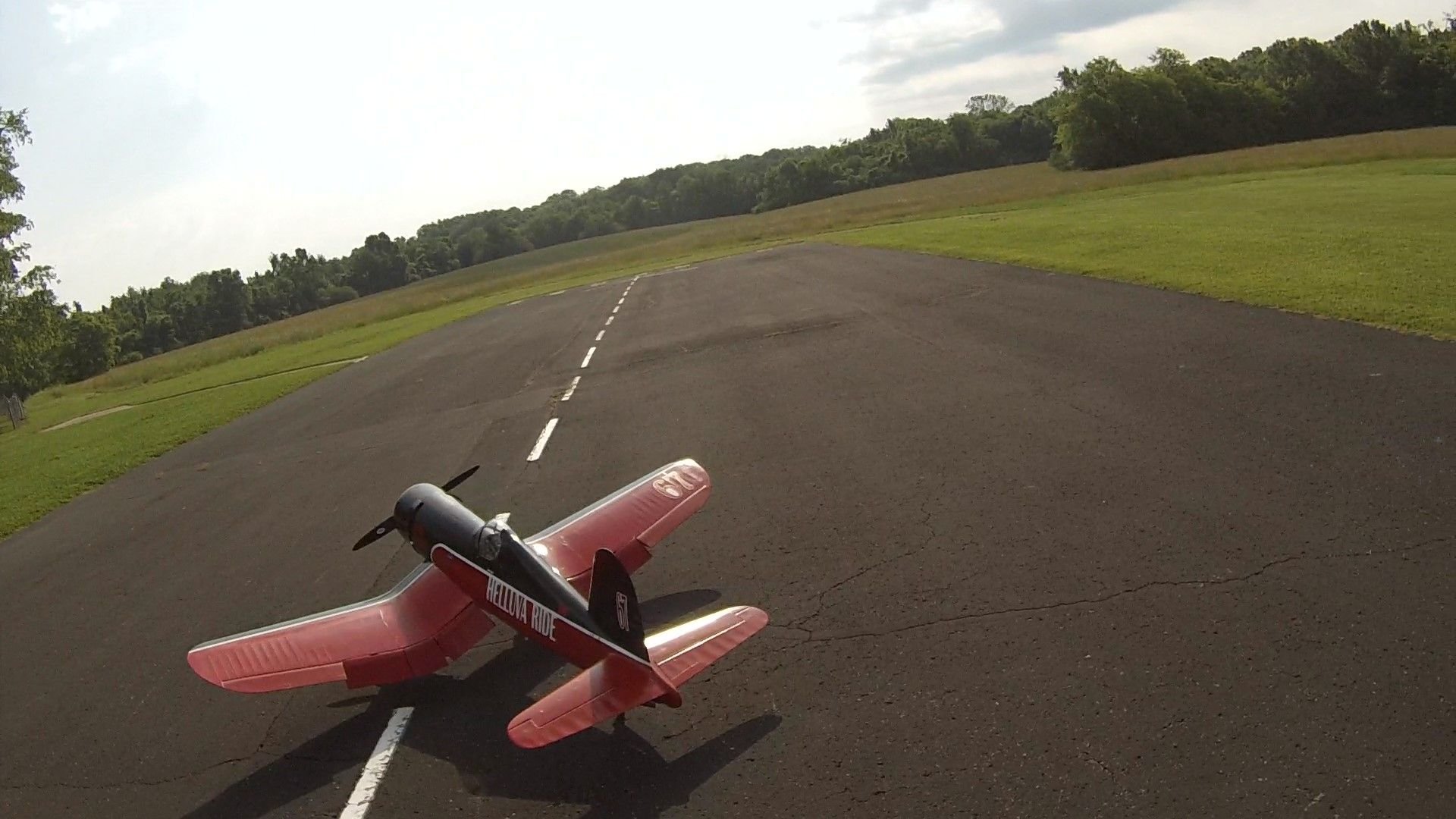

Completing a Carf Corsair with a Moki 250. Just curious, is it best to balance the Carf Corsair inverted with the gear retracted?

You will for sure want to have the gear retracted ; inverted or upright will not matter. Just whatever method is easier to achieve.

Thanks for the information. I've built two other corsairs (1/5 scale and 1/4 scale) from different kits/plans, and in one manual, balancing the model was with the gear down. Must have missed the specifics for balancing the Carf corsair in the literature provided for the model. Anyway, did maiden flight on my corsair today, it was easy maiden flight I've ever done.

Moki 250 with a Fiala 32x20 two-blade prop. Decided not to do a scale representation of the corsair with all the detail, and was able to keep the weight of the model to 52lbs with 40 oz of fuel.
