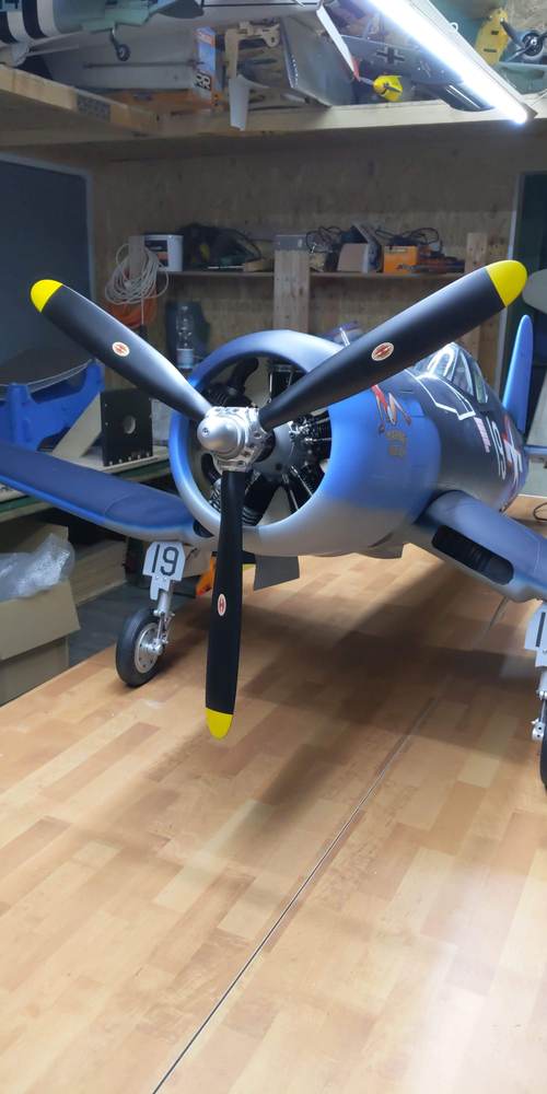

I finished the assembly of my Corsair with a Moki S180. The propeller arrived today. The plane weights app. 16 kg without fuel. Therefore, Take-off weight will be around 17 kg. This is not too far away from the 16.8 kg specified in the manual. The website talks about 13 - 15 kg, which is unrealistic. Even with a smaller engine, you need to add a lot of nose weight to achieve the correct center of gravity. I prefer to carry a larger motor instead of lead .

Now that I made ten posts, I can finally share some photos. For an ARF warbird, the level of detail is very good.

As previously mentioned, I installed a Moki S180 engine. This made mounting of the cowl a bit challenging because the ply cowl frame will not move over the engine. Instead of clueing the frame into the cowl, I attached it to the fuselage and used five threaded rods to connect it to the air guide for the engine. The air guide was then glued to the cowl. Aluminum tubes ensure the correct distance.
The cowl frame and the air guide
Mounted to the fuselage without engine
... and with engine
The air will flow close to the cylinders for a good cooling effect.
The air guide was glued into the cowl. Aluminum tubes take care of the correct distance.
Everything mounted together.
