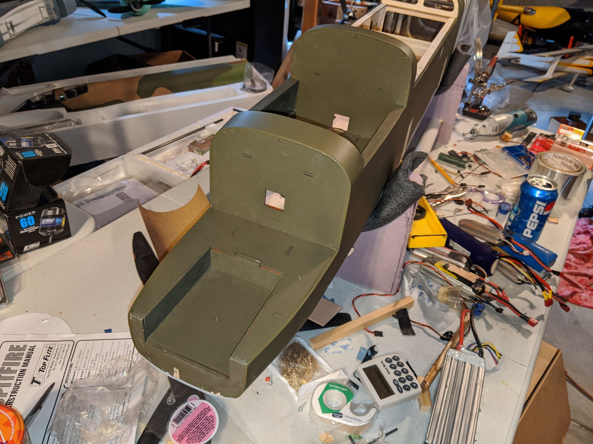

Couple of photos....
Good size cavity for batteries or other if fuel

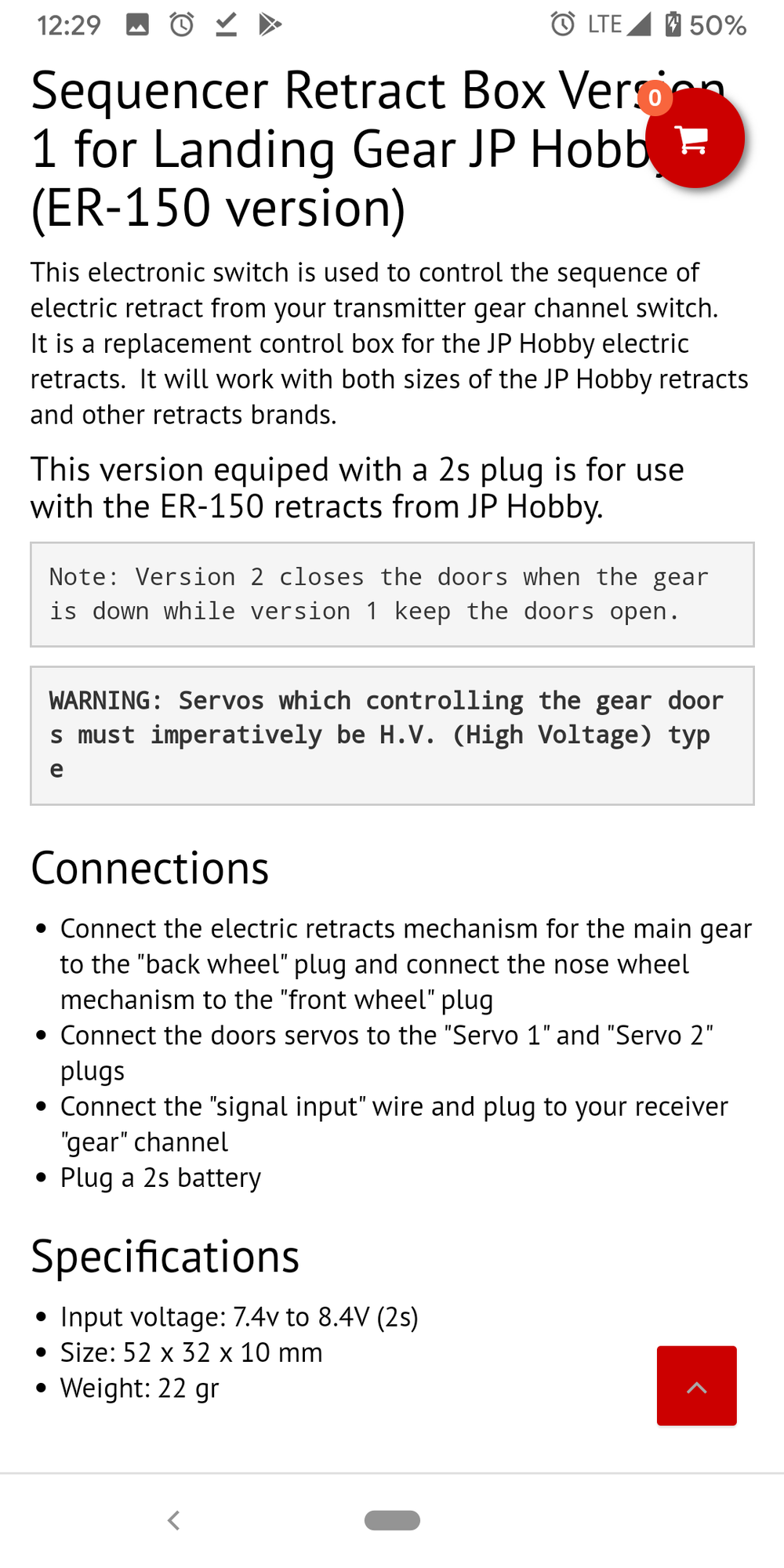

This is the data sheet from JP Hobby for the retract controller. There is no information provided with the gear, except a picture on the side of the box.
Maybe it was an oversight when packaged, but no manual for the gear was included.
As it's a bit specific, it's pretty important.

The rudders and gear doors all require a servo of the hs225 mini size. They can be digital or whatever. The recommended servo is listed for the nose gear in the manual...i think it's an hs5245mg.
The retract controller from JP hobbies is powered by a 2s lipo separate from the rx.
I will be using a 2s LiFE pack instead of lipo so I can use Hs225mgs instead as the digital high voltage servos are $40 each.. not at all bad, but already had hs225mgs
