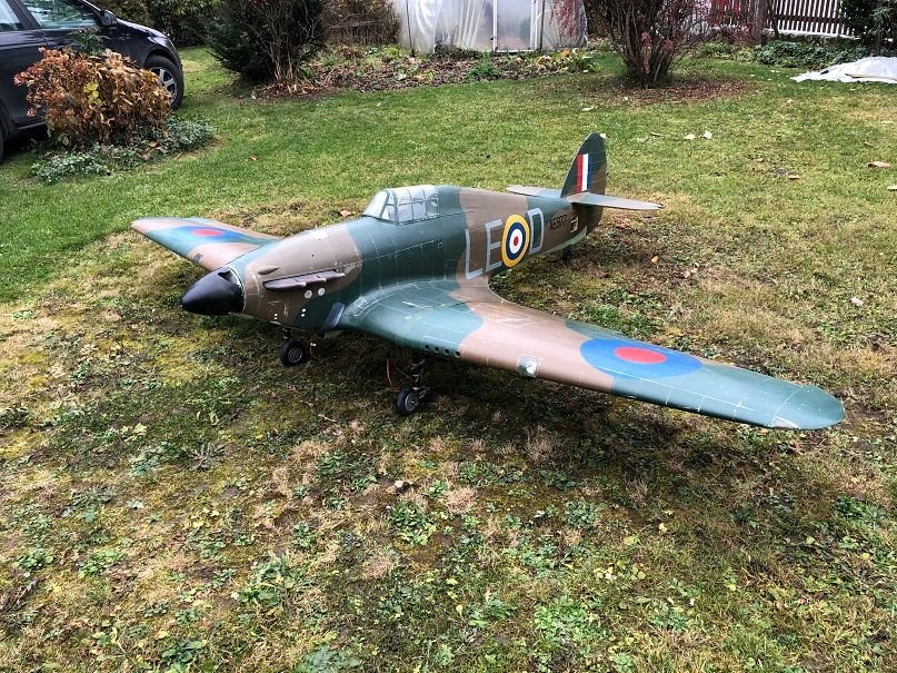

Hey guys,
i got this Hurricane from france. It was build out of an upscaled plan and has 3 Meters wingspan.
The model and all the details on the surfaces are insane, this is why i wanted to do a refit to is. spezially because they are so rare on the aitfield.
it was equipped with an 3W150 inline. as good as the wood build was done, as bad is everything that has to do with the RC stuff. so i started to redo everything to make it really airworthy

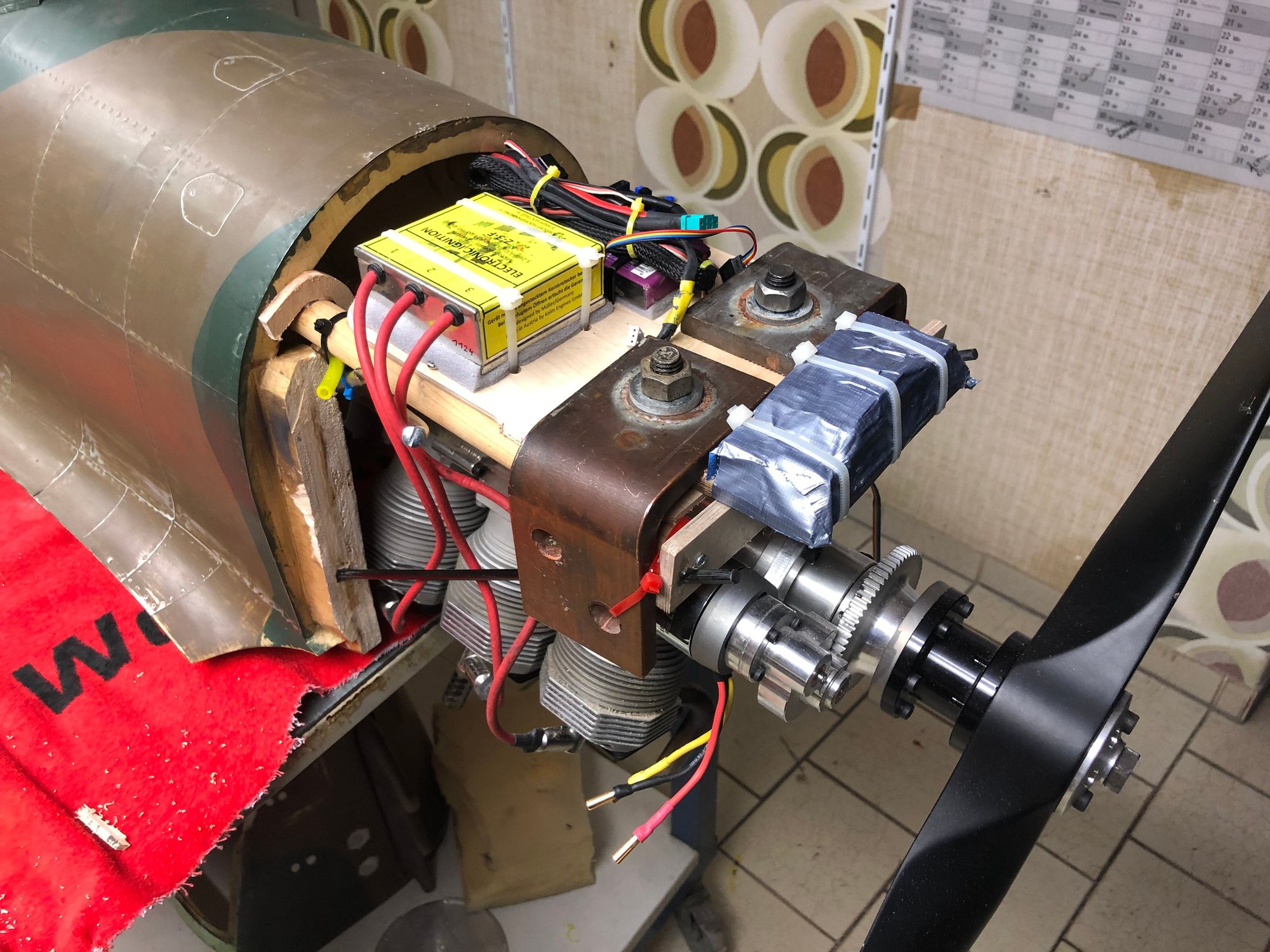

first of all i start with engine install :
cut the firewall and make enough room for an serious engine

Place the new firewall:
measure the engine lengh back and take care on the angles given on the cowling. this will give later a similar gap from cowling to spinner backplate

this is the way to place the engine at the right spot. its too heavy to hold it by hand while finding the perfect place....

if you are lucky, it will look like this :-)

the 3W150 needed nearly 3 Kilos lead i the nose. so i decided to go with an heavier engine.
The IL150-3 fits totally unter the cowling.

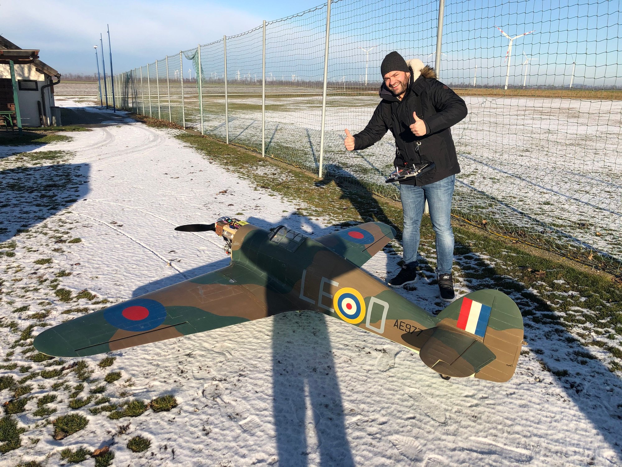

To find out if the plane is all the work worth, i decided to do a quick test flight.
installt all the rc quickly and flew without cowling (no baffles so far).
lot of weight was needed in the nose, so i builded quickly a rack to carry that :-)
was a cold winter day, but the result was very good. decided to go on.
short videos you can find in my FB- account.

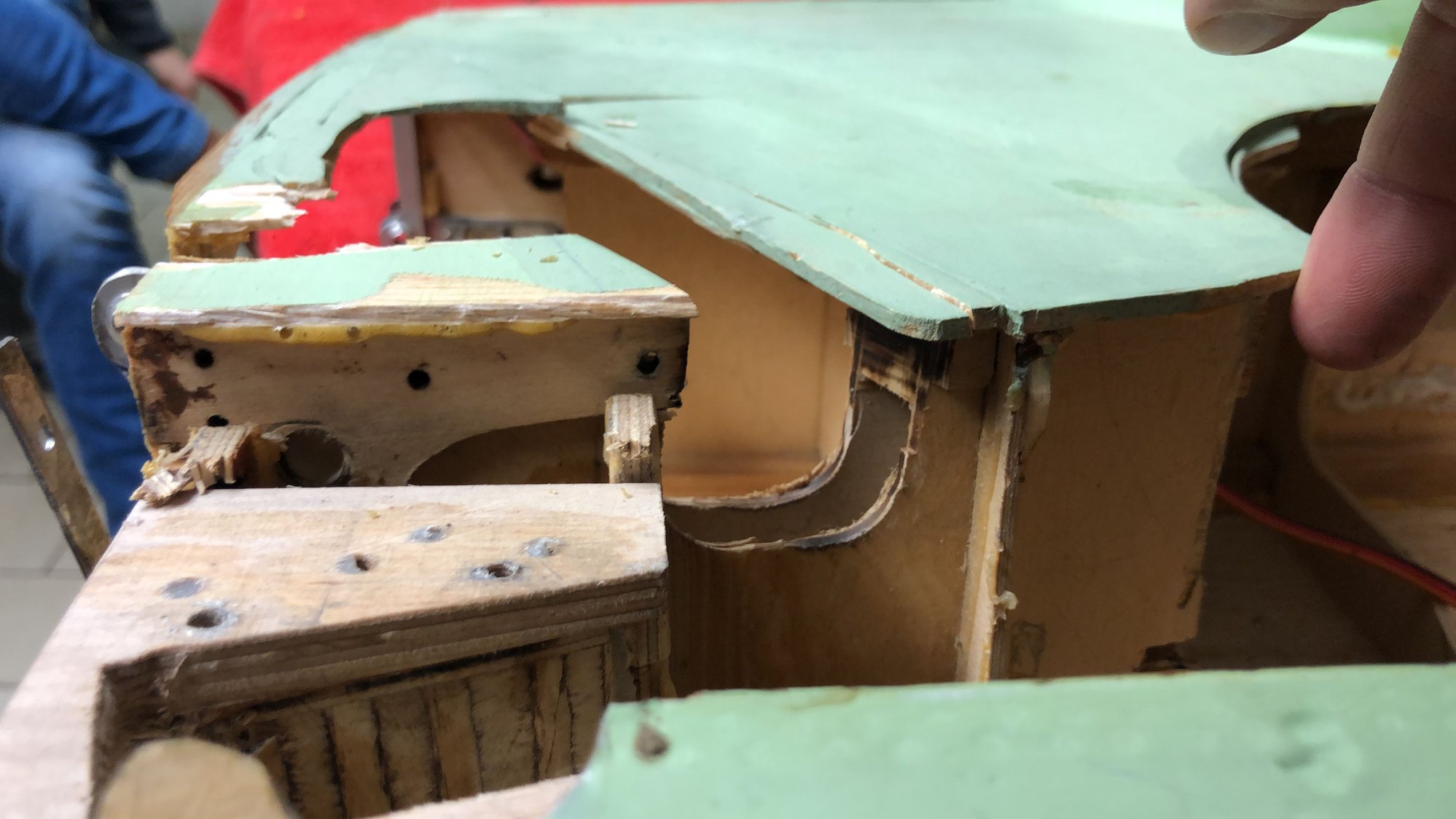

next step was the center section of the wing.
Someone tried to build this plane with less then 25Kilos (law regulation) and installed the mounts for electron ER40.
Way too small for a big bird like this. also the carbon fiber struts broke both at the test flight first time they touched the ground.
and for some reasons (scale optic gear) someine cuttet a very important stringer. had also to replace it.
Old 02-11-2020, 02:44 AM
