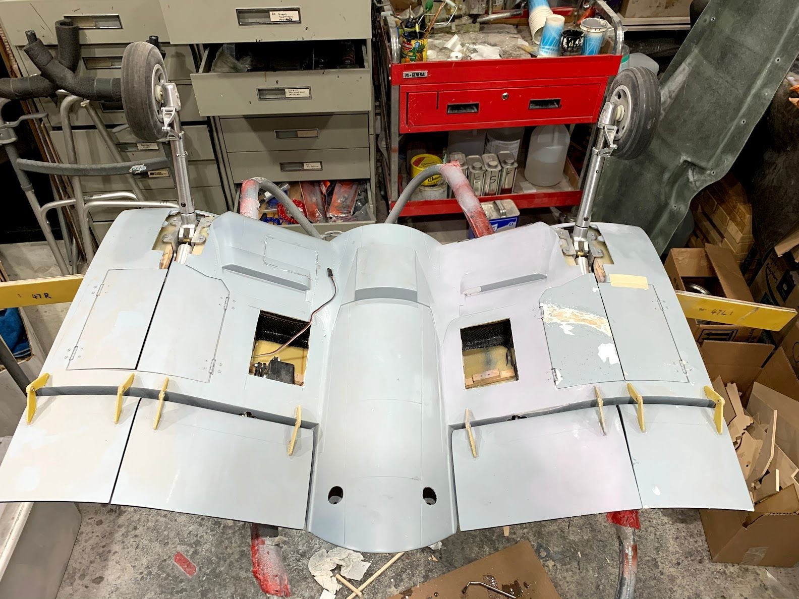

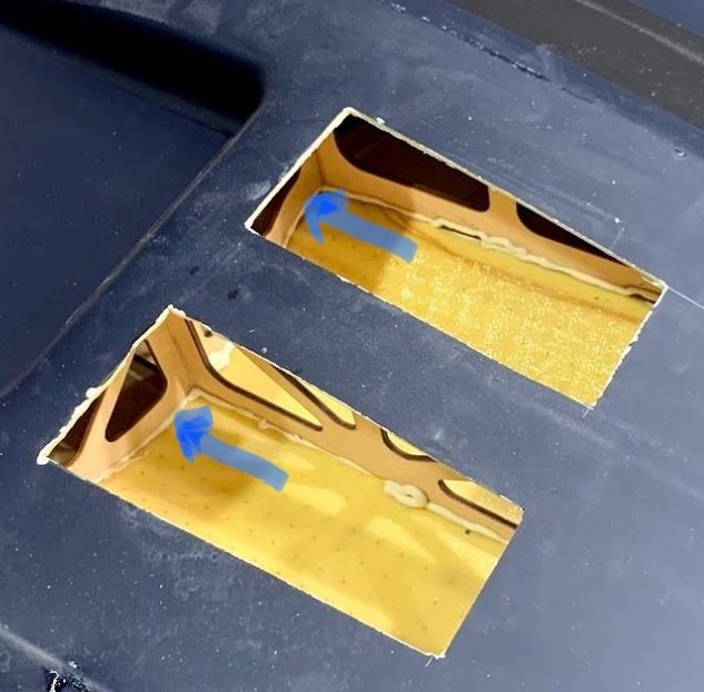

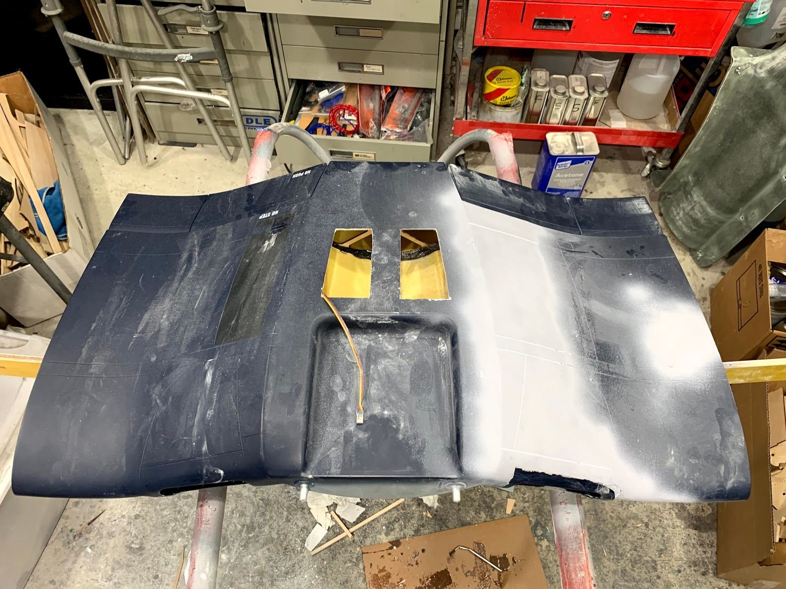

After reading about the center section and looking at the structure myself, I feel that to fly the model is an accident waiting to happen. Just so you know, the actual “spar” that goes from one side of the center section to the other of this 40+ pound model is a single 3mm former that has lightening holes from one end to the other, there is a second parallel former to it, but on both sides this former ends on the “shoulder” of the wing, so it lends no support as a spar.
I stole the pic below from member FW190 so you can see what the actual “spar” is like at the center of the wing. The blue arrows show what the actual spar is
In my opinion the wing design is weak because of:
1)the thickness of the wood used for the spar
2)the lightening holes on the spar from one retract box to the other
3)the reduced size (width) of the spar under the retract strut area to allow space for the strut to rest and the retract actuator motor to fit
I refused to allow this model not to be finished and flown, so I developed my own set of formers and performed surgery on the center section.
My set of formers provides dual (parallel) 1/8” birch ply spars from one retract box to the other, joined by lamination on the center with 3 1/8” joiners, reinforcing the whole wing structure while absorbing most of the spar loads limiting the spread to the rest of the wing. 2 additional formers will work as doublers on the retract area for the outer wing spar receivers, as a requirement for these to work properly, the outer wing spars have to be glued in their receivers on the center wing.
In my opinion, even those who have these planes flying need to perform this “repair” and for those who thought the was no remedy, I believe there is.
To fix the problem the wing had to be cut into, yet nothing is visible from the outside of the wing, no refinishing was necessary.
