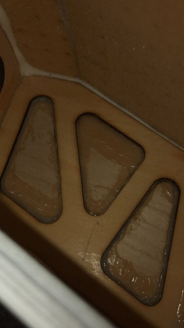

Do'nt worry on the new Corsair models, the central part of the wing is reinforced with a layer of carbon fiber and a carbon plate on both sides ; the old generation of corsair are solded at the moment do not buy them! mine is from Bigplanes.nl.
the new top-rc gear was modified, the springs are different, the motors too and the rotation is more precise.
That’s good news! Yet no carbon fiber will compensate for not using a proper spar, if the carbon is in the spar, and a proper spar has been redesigned, that’s great! If the carbon is on the skin, it is useless to correct the problem, wing will still break in the center.
For anyone interested on CNC cut set of formers to correct the deficiencies on this wing, I will be selling them with installation instructions. Contact me through PM

hello
The new spar in the middle of the wing is less openwork, I did not stick the wing keys the adjustments are much better !
I can send you a picture on your email address

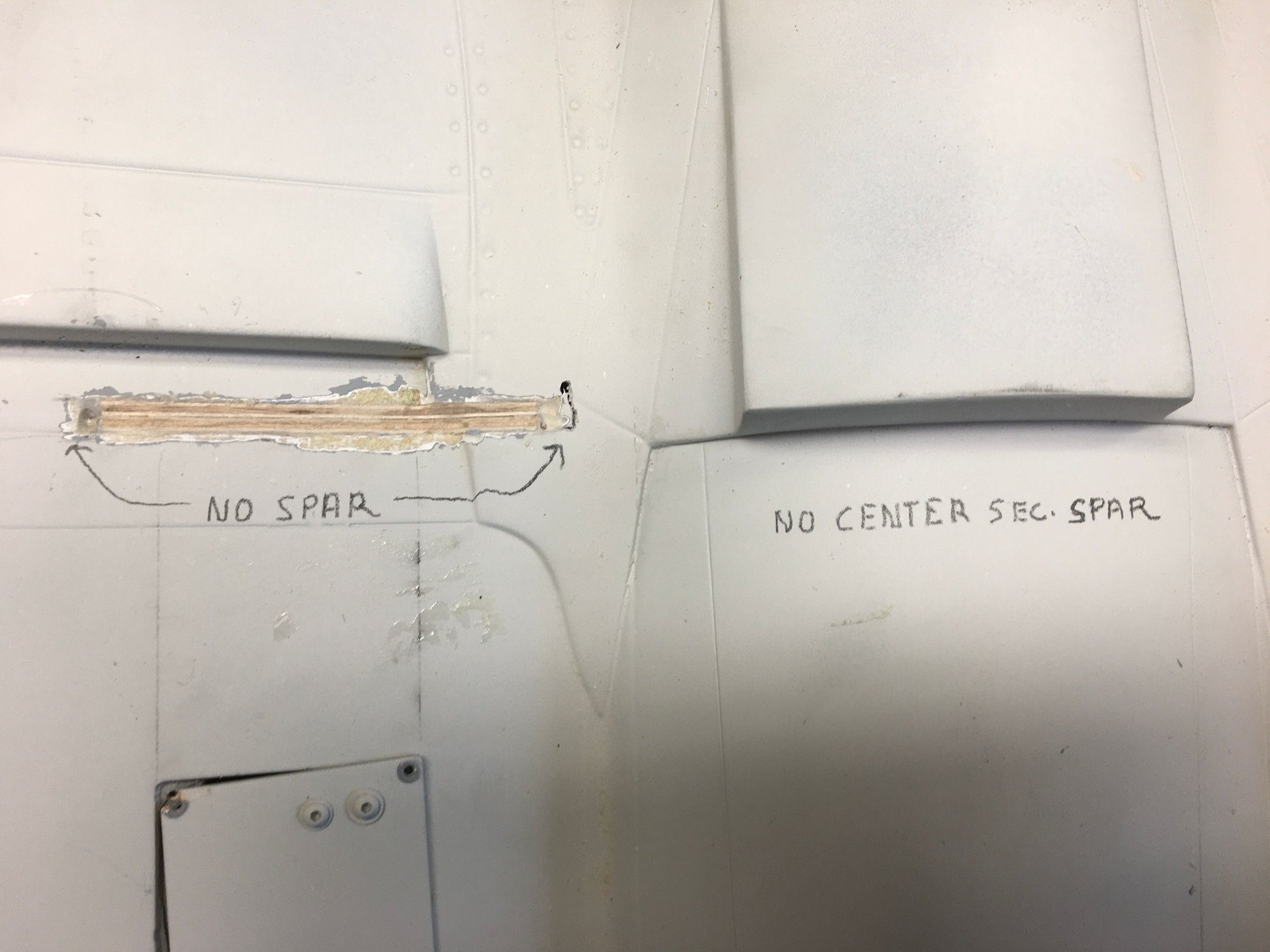

That is not where it breaks easily, it breaks closer inside of the wing as it meets with the fuselage. Is it possible to take some pics from inside of the wheel area? It will be stronger if they do away the lightening holes on the spar. The composite foam structure is also easily compromised, I can even cut easily with an xacto.

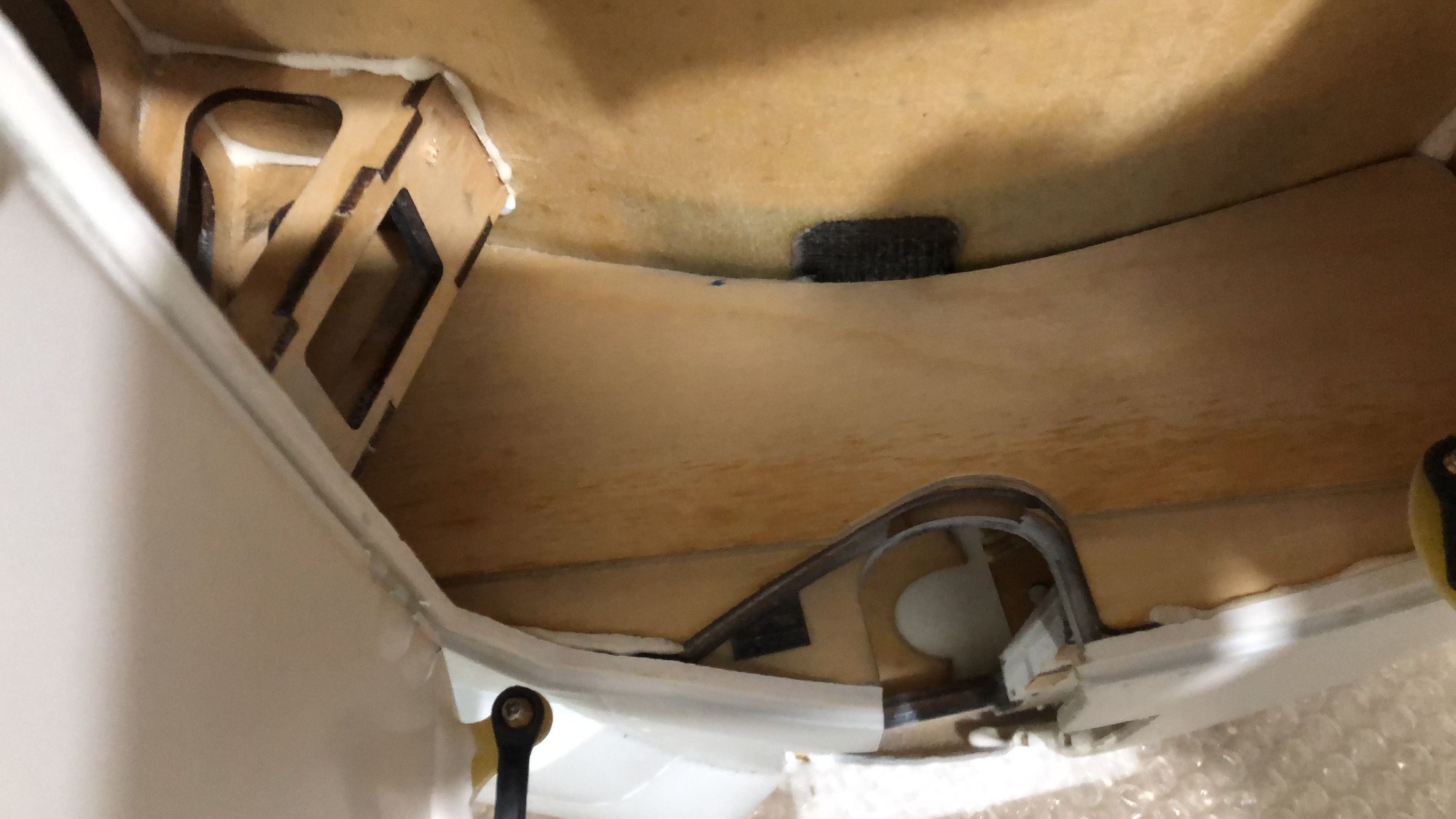

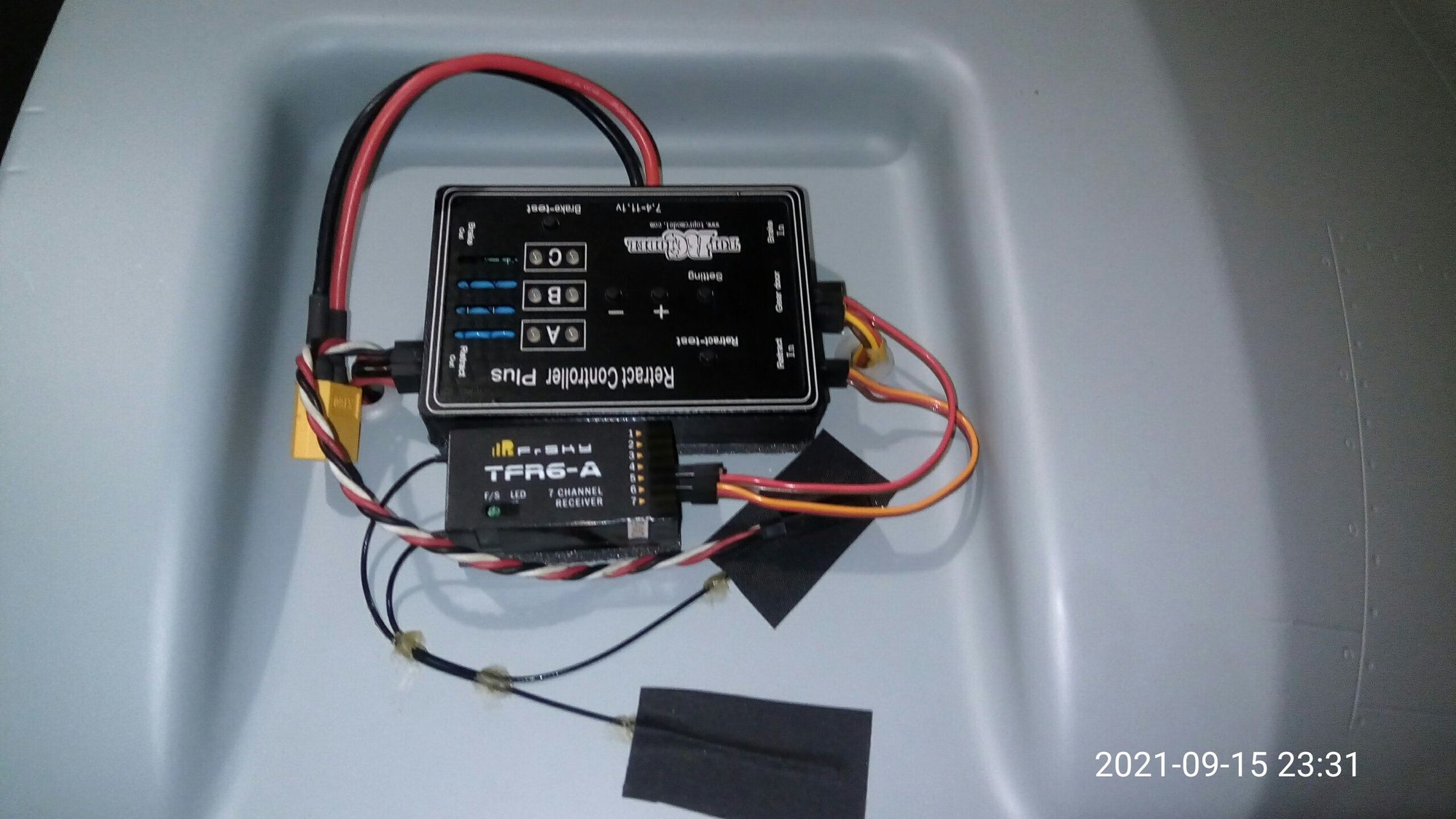

The new spar in the middle of the wing is less perforated, difficult to pass the servo extensions.
With the carbon fiber reinforcement, it is necessary to scrape the glue,otherwise the engine of the landing gear will not pass.
The composite foam structure is the same on my fw 190, the plane will be 3 years old.
Installation of the retraction module

You trust the FrySky for this big plane? Your Antenna is so close together, that can be easily masked out from an engine or a carbon plate.

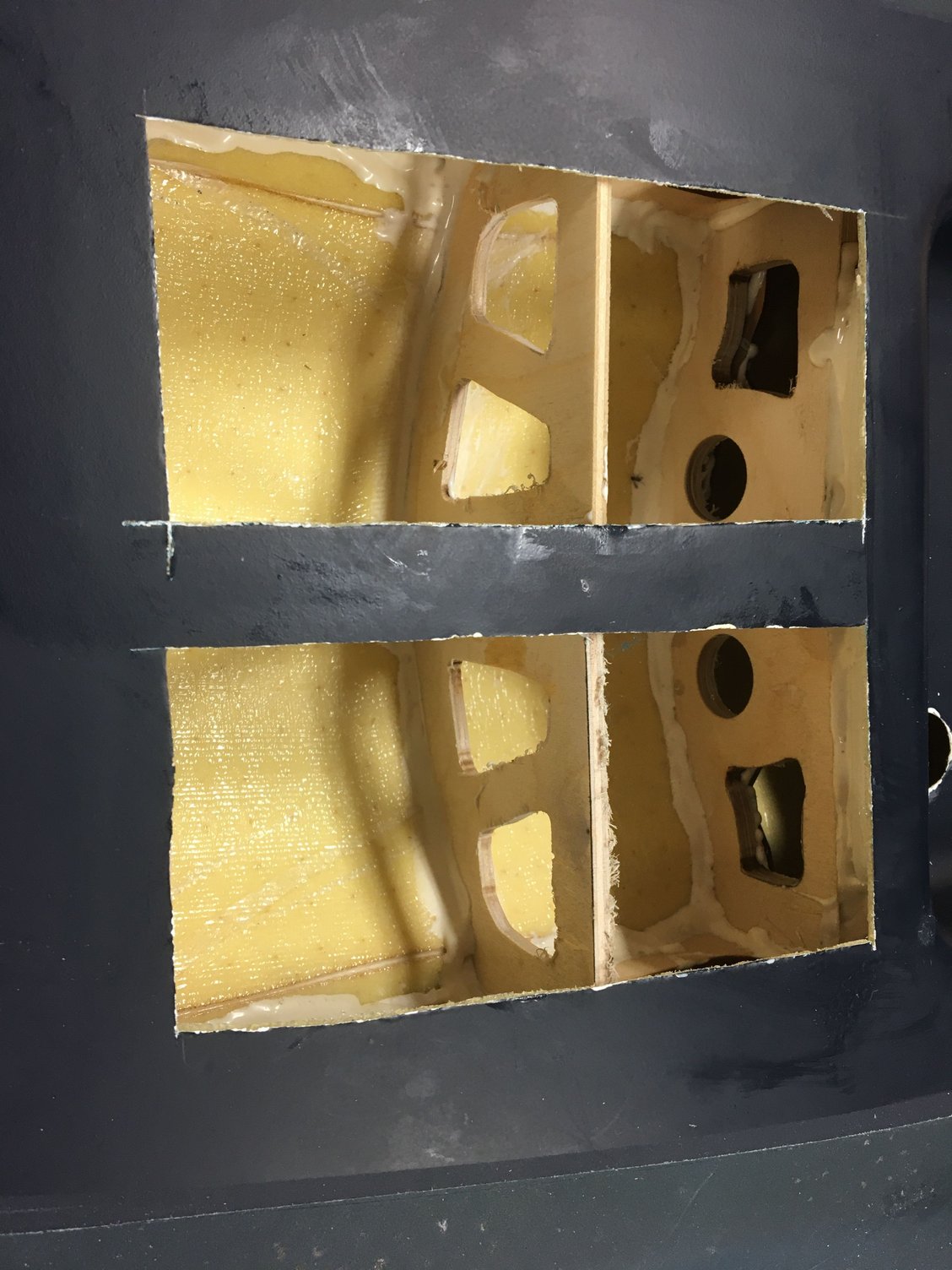

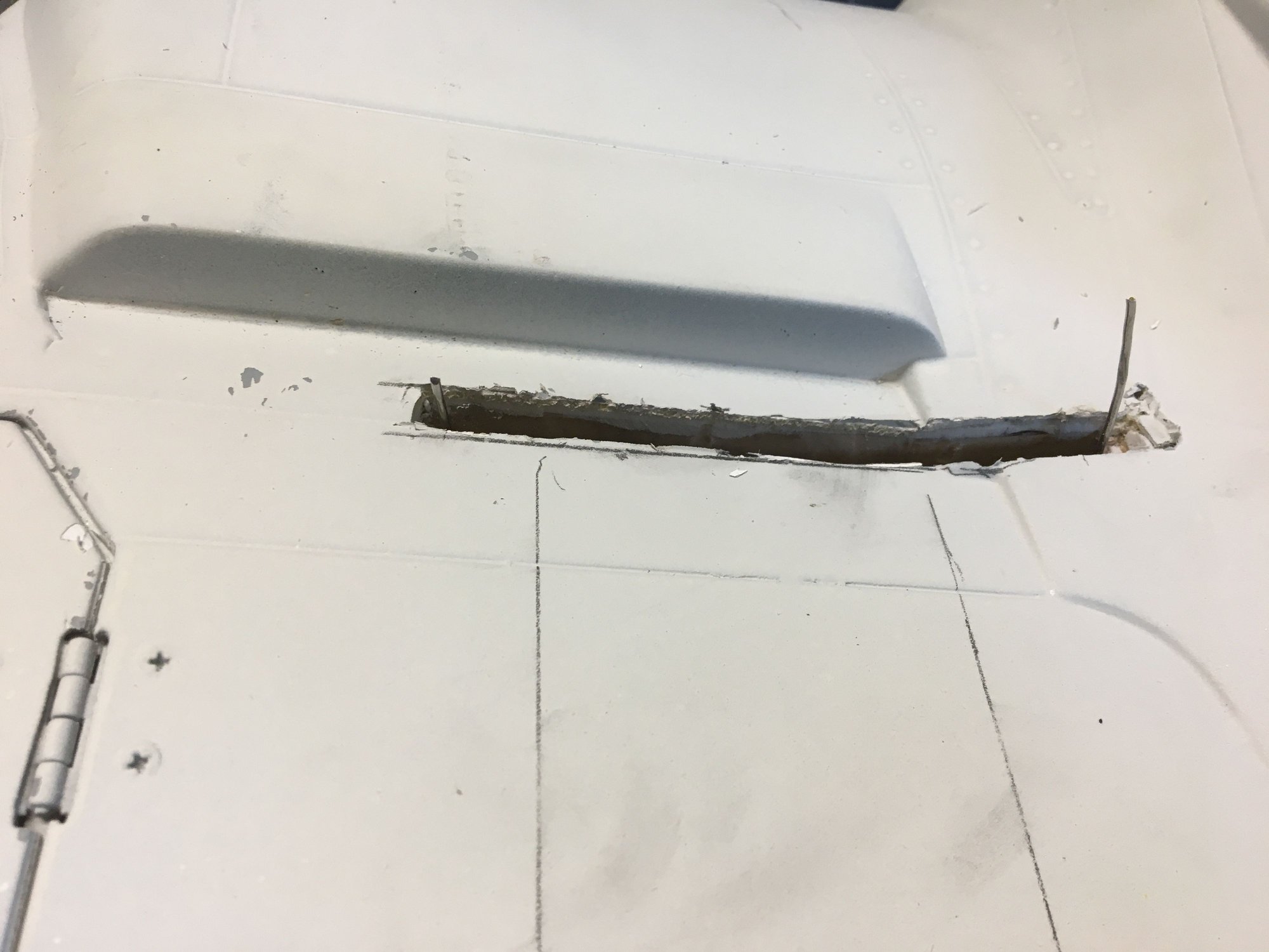

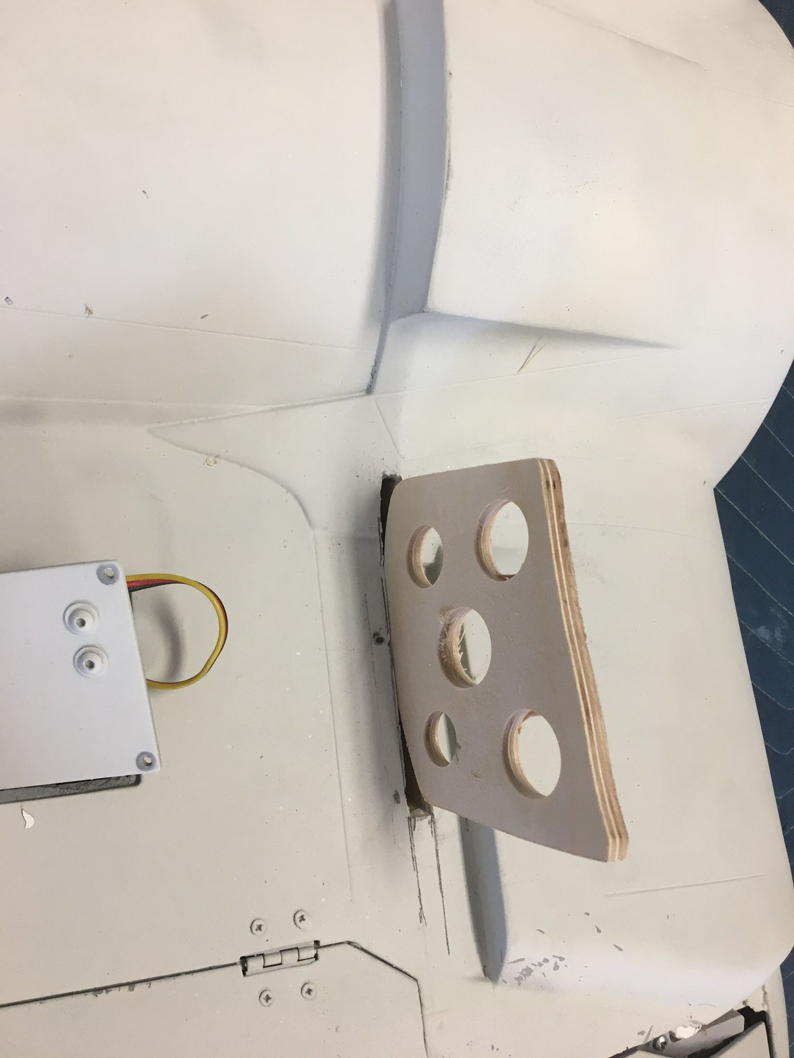

Good that it has carbon fiber, yet the spar is only 5/8” wide between the holes for the retract actuator and the strut clearance, unless this is a 3mm solid carbon plate, I don’t think it will compensate for such a small spar area.
mine is reinforced and widened to 1.5” as I did away with the retract actuator clearance hole on the rear spar, both front and rear spar are reinforced.
also my complete wing, from retract box to retract box, has double solid birch spars
see picture of reinforced rear spar on “shoulder” of wing where there has been documented failures, spar is reinforced like that from one retract bay to the other, both front and rear spars
As commented earlier, I will be selling the Corsair wing fix former kit for the spars between both retract bays. The retract bays have two options.
a) dual (front/back) 5/8” wide birch reinforcement doublers (this can be supplied by the user, so no parts will be included on former kit, only instructions)
b) rear 1.5” wide birch doubler + front 5/8” wide birch doubler (this option requires modification of the retract actuator housings, this can be done by the user or I can offer the service for an hourly machining rate) the doublers for the retract sections will be included as an extra option on the former kit
Solid rear spar visible through servo access opening, this is one of two parallel solid birch spars that go from one retract bay to the other bypassing original weakened poplar ply spars
Rear birch doubler for retract area, hole for actuator is eliminated to offer a wider spar for better distribution of loads reducing criticality of the original spar weak point

That is correct. There is no spar beyond the end of the wing spar that is glued into the wing and and fuselage only the thin formers. There is also no spar in the mid section as seen from above.So, most of the midsection has no spar at all. I measured and cut out the bottom of the wing to add a spar as shown in the photos. Also added a sort of spar to the mid section.

Received 6 Likes on 6 Posts
Hi! I initially was going to do exactly what you did, until I saw the middle wing single spar and the ribs that cross the spars perpendicularly. The only solution is to bypass the complete spar system as a whole!!! Be watchful about your solution just increasing the risk at the next weak link which is where the ribs cross the spars (the rib right before the wing downslopes away from the fuselage and the rib right before the retract bays)

we don't care it only controls channel 5

hello ruizmilton
In the new version ( july) 2021 it is 3mm x20 mm carbon plate on each side in addition to carbon fiber on both sides of the spar, the spars are much less perforated, there is a spar in the middle of the wing (I looked through the opening of the gear doors) .Now it's at least as strong as my fw 190.
See updated july corsair in this picture by bigplanes.nl, It is mine ,no worries for new models
have good flight

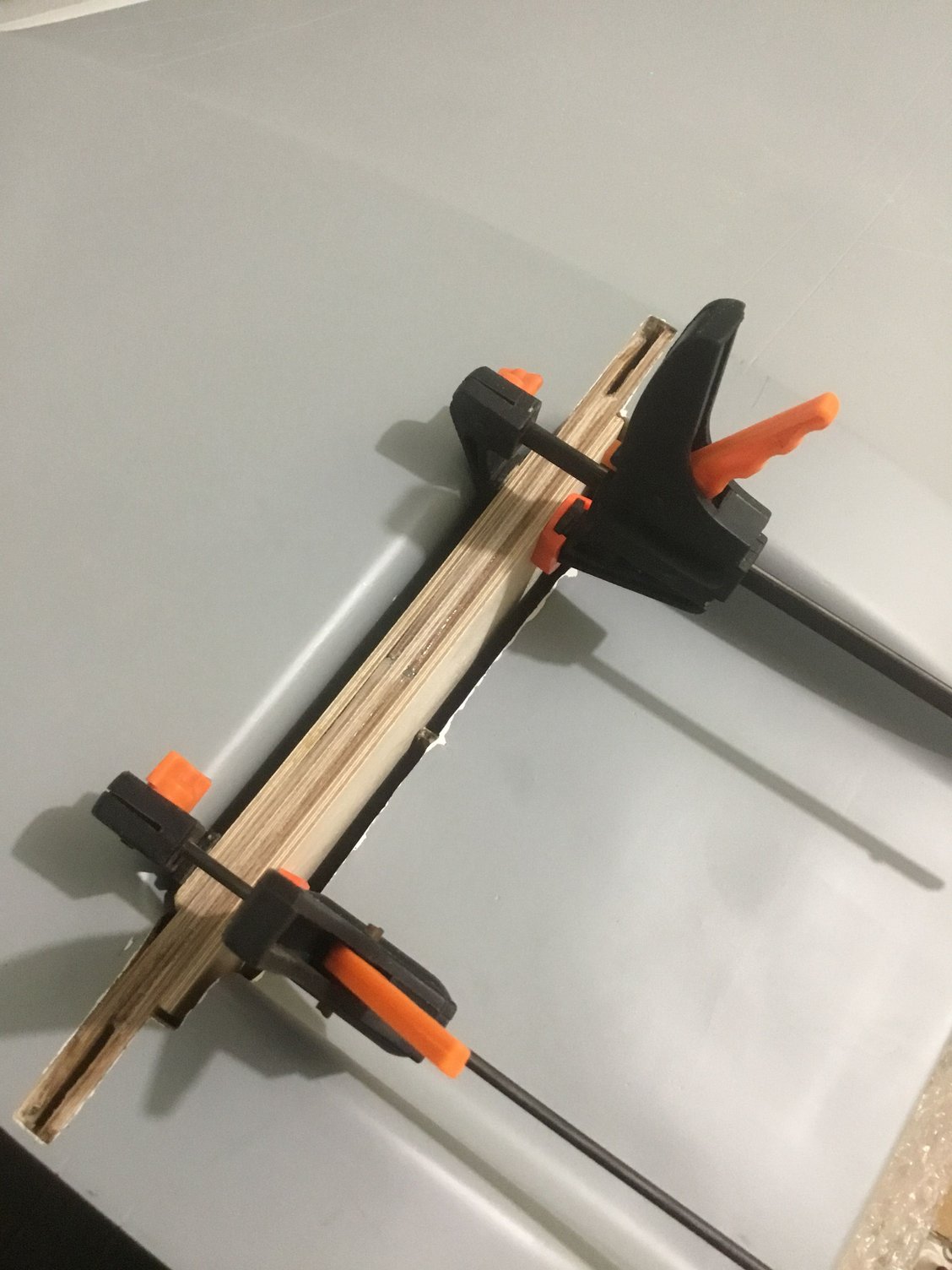

Originally Posted by LtMash1A View Post
Your point is well taken.You can chase down weak links forever, but until they make the wing with one continuous spar, it will never be strong enough.
We totally agree on that, so yes I opted for the complete one piece/continuous spar approach.
here’s my center section while being glued, yes, that’s 5/8” on the wing center, then it’s about 1/2” total up to the inboard retract rail doubler, and lastly, about 9/16” thick total from the rib right before the retract bays up to the end of the center section, these overlap with the sections coming all the way from the middle of the wing effectively making it a continuous spar.

Ruizmilton
the 3mm x 20mm carbon plate is here behind the carbon fiber
