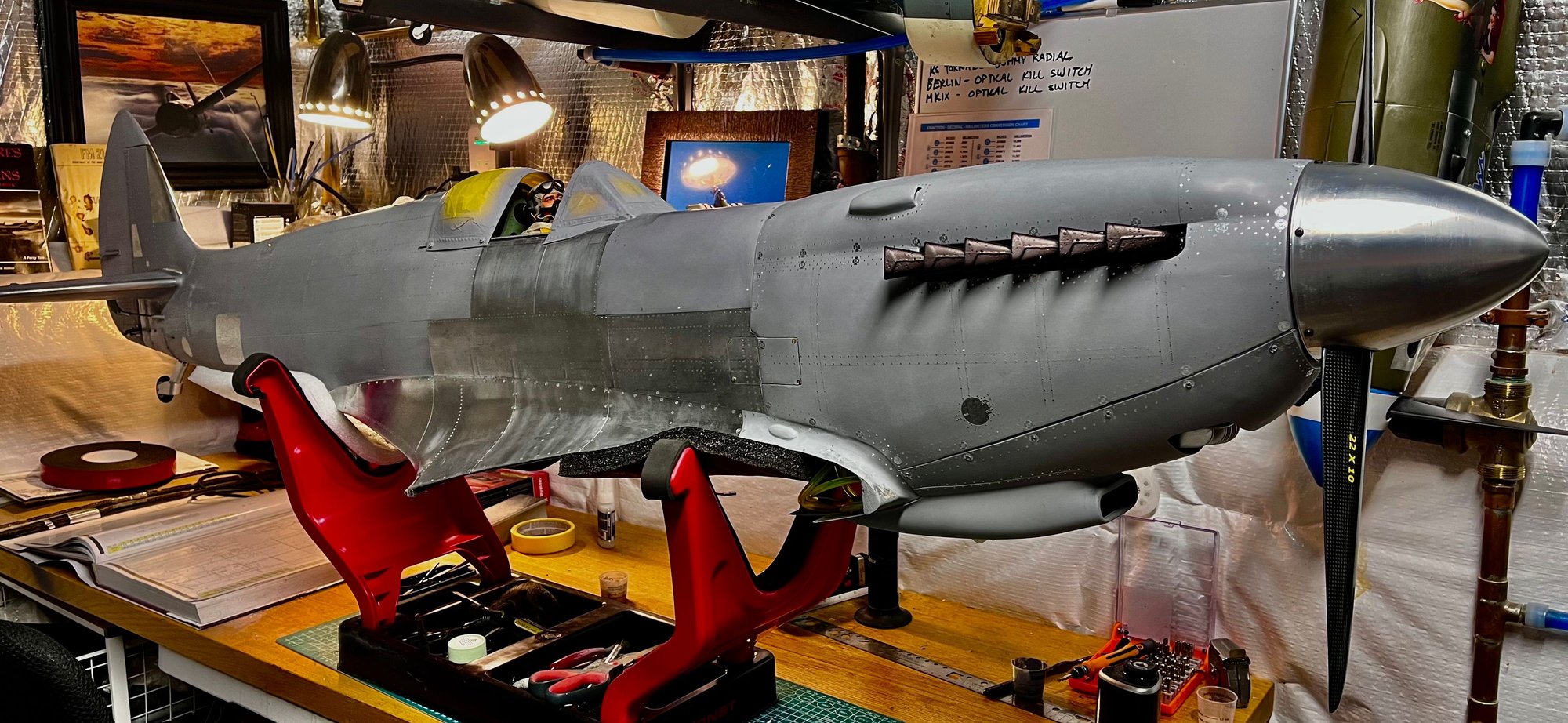

I began working on the interior yesterday, the engine was hard mounted, ignition and fuel tank was installed, throttle and choke servo plate was cut out of g-10 and all installed. Still need to solder pushrods to my clevisís and install the fueler port as well as run baffling for the engine. There is not a lot of room in the fuselage box, so I spent a lot of time working on space management as I still have a receiver, retract controller and 3 life batts to install(which I want as forward as I can get). I need smaller hands!
I wanted to see how she looked with spinner/prop and dummy exhaust stack installed, so a few pictures of that as well.

Thanks Jiri, And right back at ya! Your details sure help bring life to a model. I still have a few more levels of airbrush to run on the exhaust stacks, but even with the base alclad they really come to life!

Thanks Rumen! Now to match it with the wing, hoping to have everything paint ready before flying weather hits here, and I should be painting by early summer Iíd hope.
