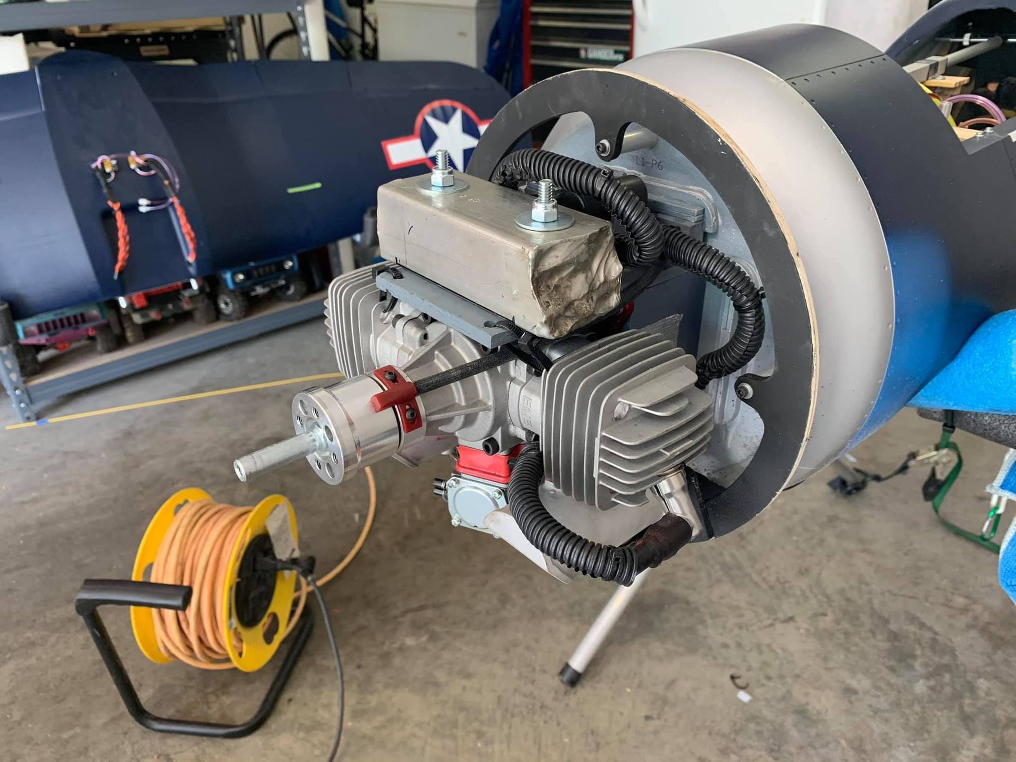

. As far as weight of the TopRC Corsair , yes it is heavy but not much heavier than my Byron Corsair. My TopRC is 38 pounds and my Byron was 36 pounds . I account for most of the weight difference is the needed ballast in the nose of the TopRC as being at nearly 2 pounds more than the Byron

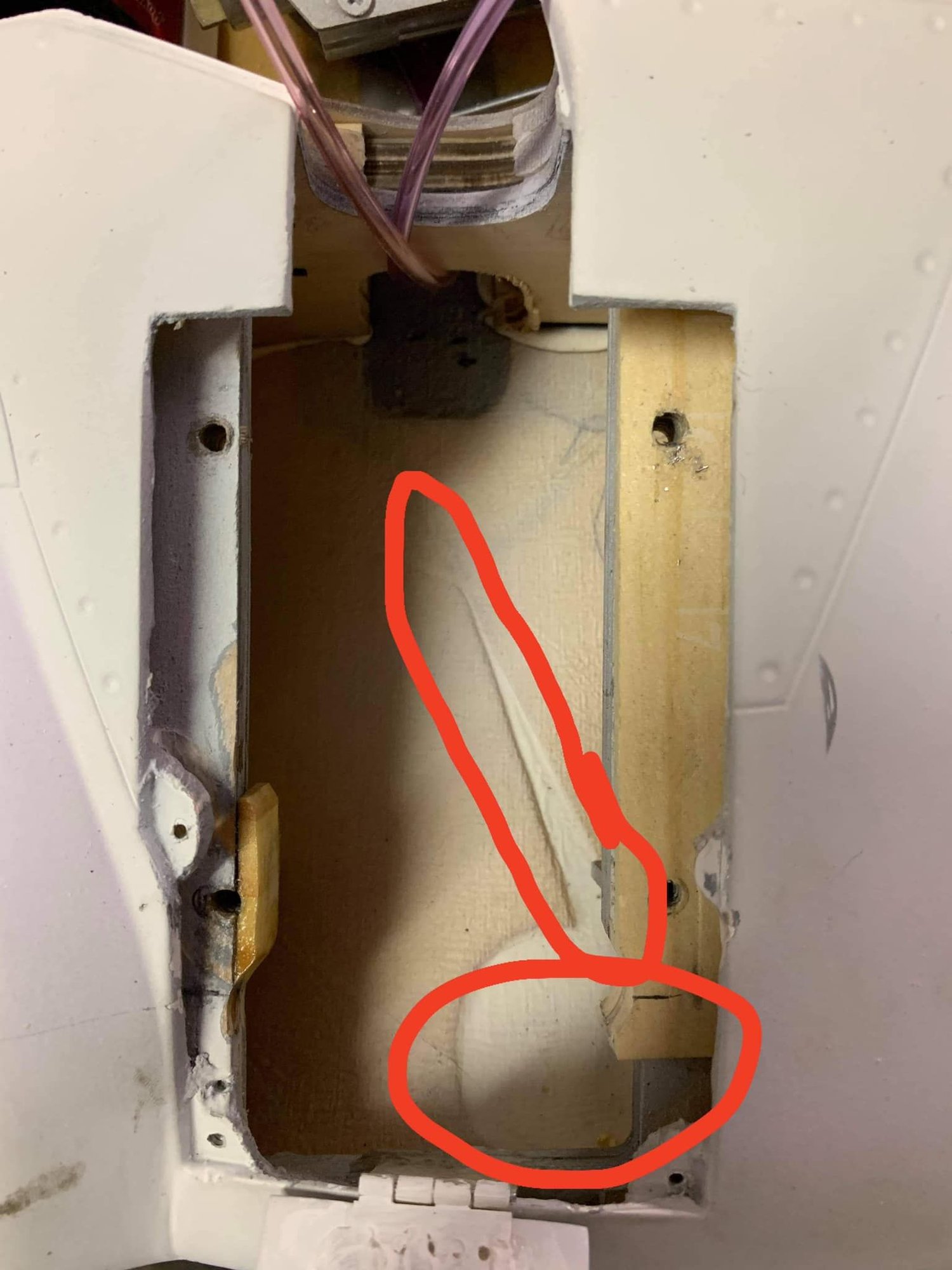

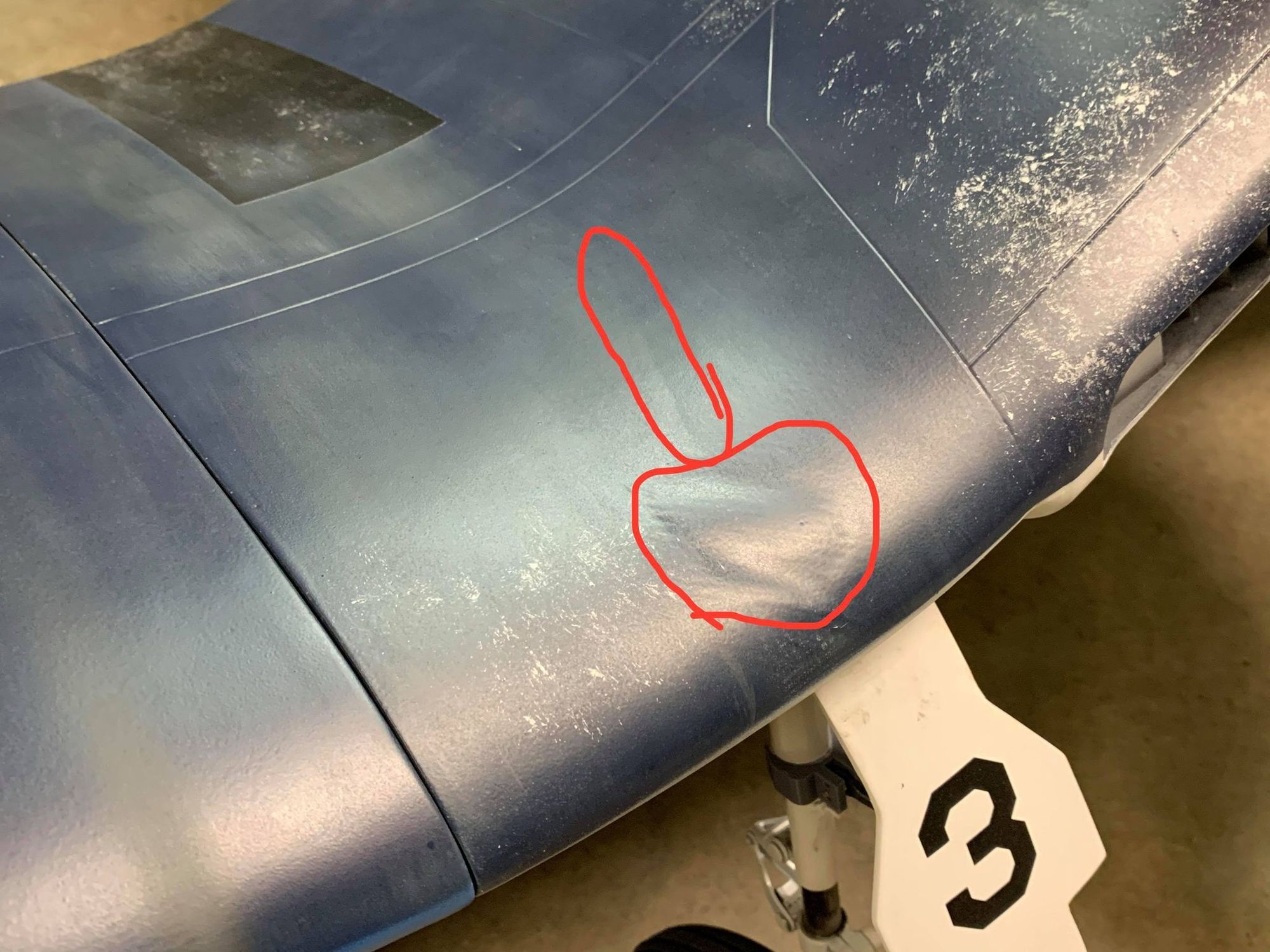

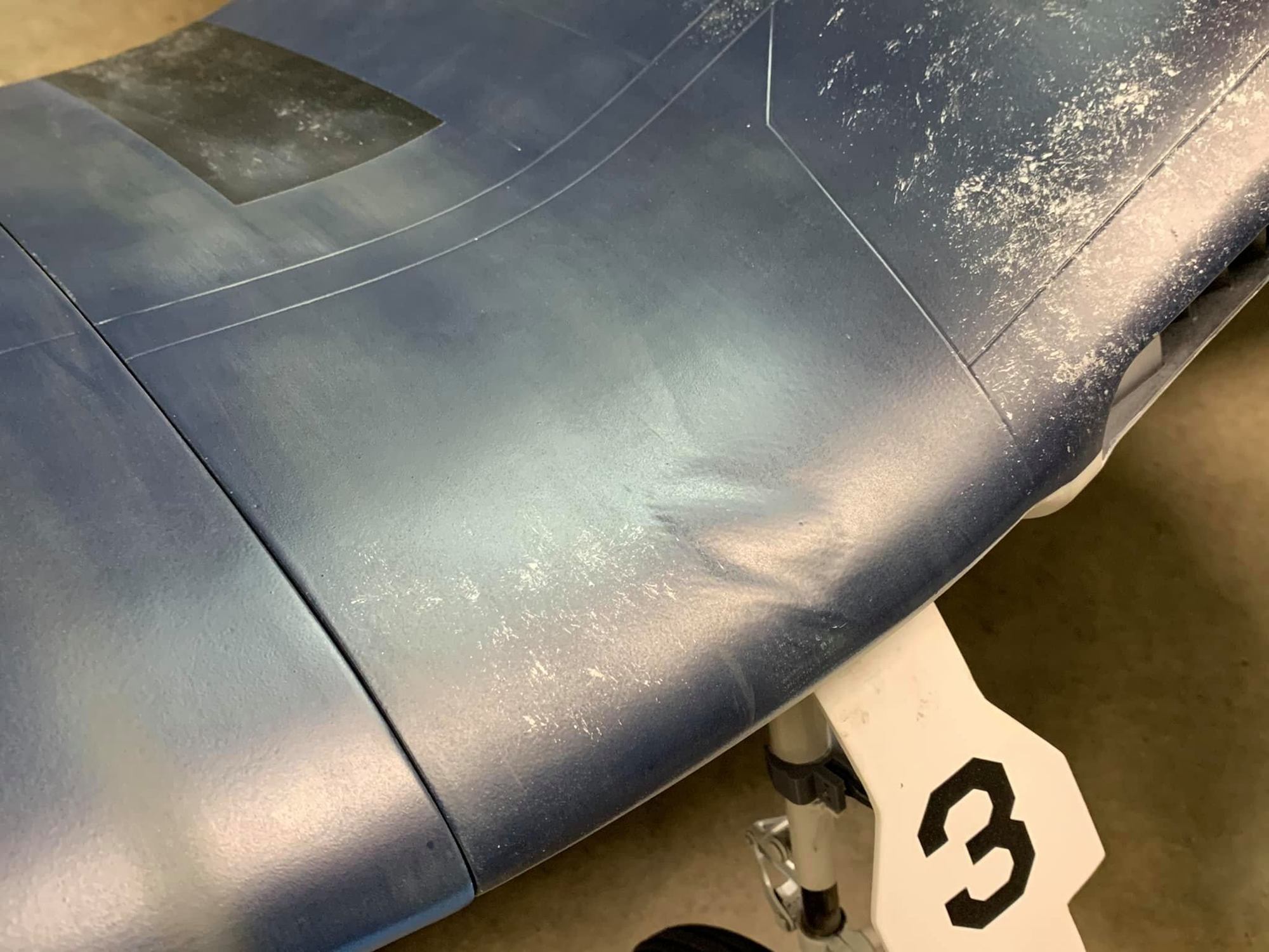

I talked with Derrick. Weight of his Corsair 42lbs.
There are some damages of fibreglass after some minutes on sun.

That's the type of issue I'm concerned about . I already know that the bonding agent used is not adhering well to the fiberglass /foam composite and also that there is an excessive amount of flex in the center section . On my Corsair if you attempt to lift the plane by the wing tips you can see the gull section flex near the area that you have highlighted . I wonder if that area is attempting to delaminate because of movement in the apparently weak main spar system .

This is not Corsair, but also TopRC. I suppose, that there was another fibreglass issue.

I have the Zero also and had heard of main spar failures and I have already reinforced the main spar and wing tubes with 6 oz fiberglass cloth along the spar and also wrapping the tubes . It appears that the engineers at TopRC didn't do their math correctly when calculating the shear strength of design and materials of the main spars .

Wow that i a lot of weight, can I ask what motor is in this picture above ?
