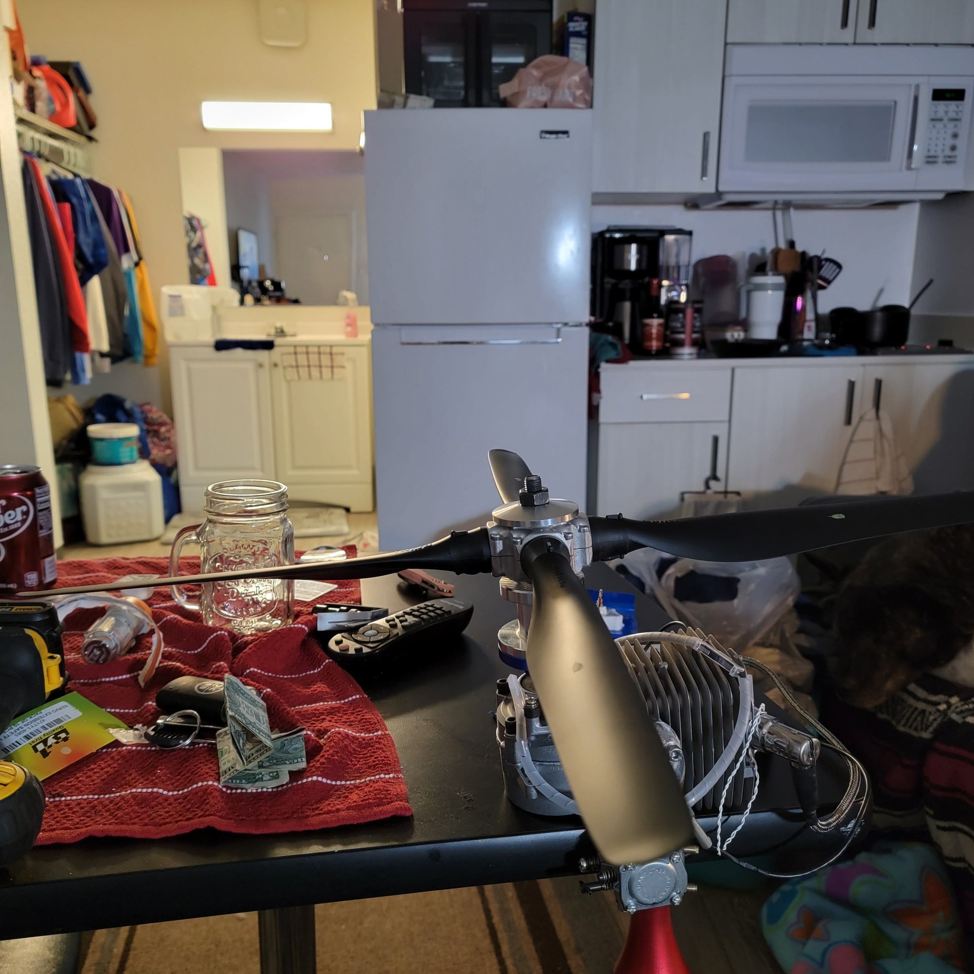

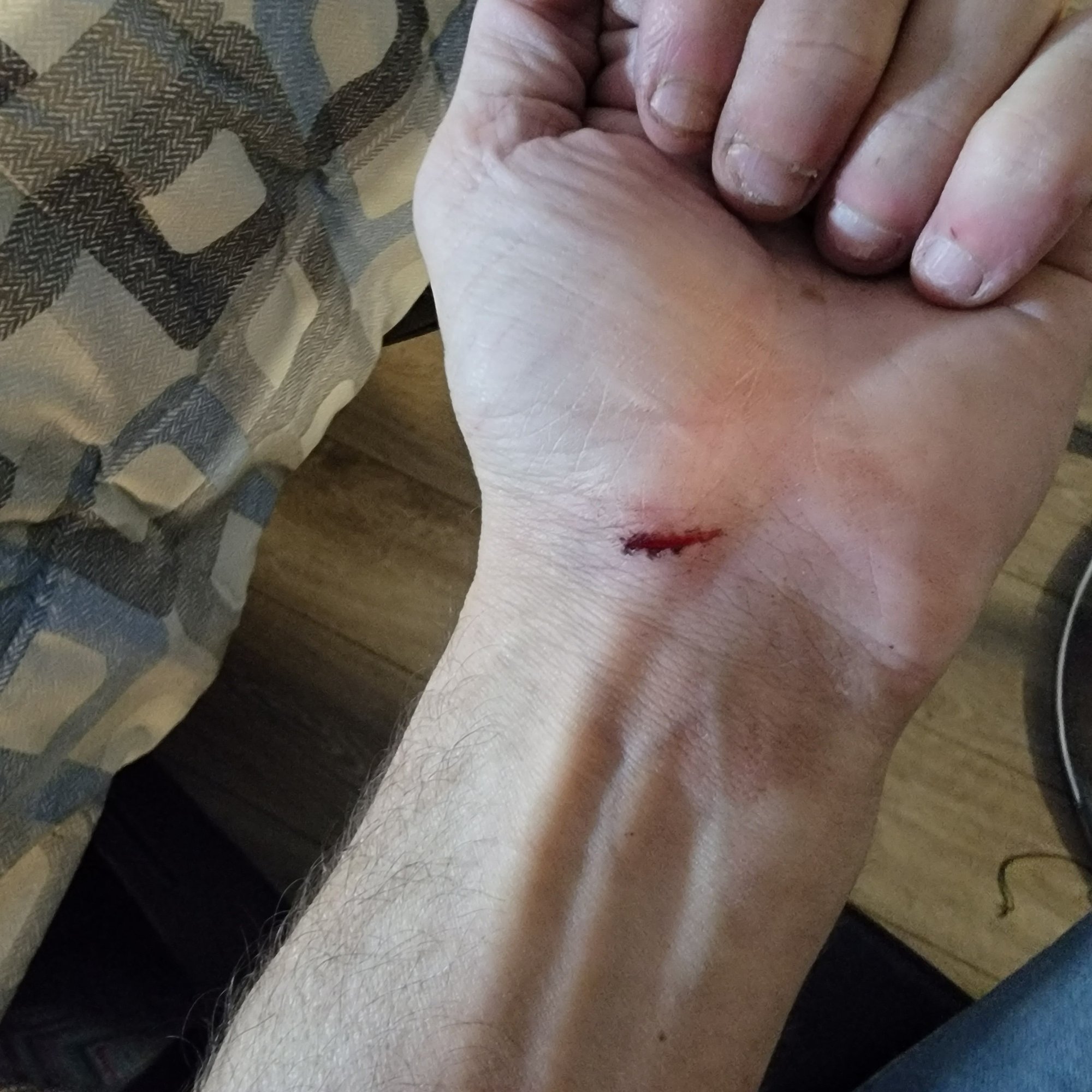

90 mm bolt has now been converted to a stud..but not without blood loss..the bolt slipped in my grip and the diamond cutter bit me..the mustang has now drawn blood..its officially mine.
Grade 8 bolts are freaking hard. Lol. Can't trim the anti rotation pins until I have the spinner

Sorry you had to spill some blood, but the RC Gods have to be appeased. That's one sweet looking prop and engine arrangement you have there. Your choice of colour gets my vote for your plane stand, and a happy New Year to you and yours when it comes.

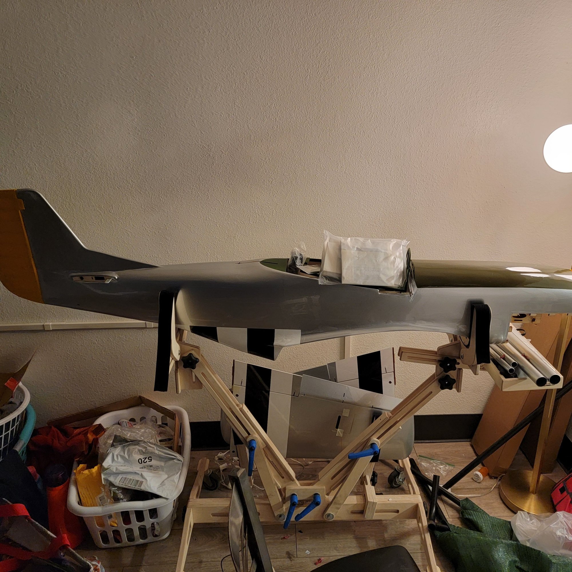

So, as some of you know, I've been puzzled over how I was going to cg this "monster" of a plane. I've had a lot of goid suggestions, from home built stuff to commercially available kits for balancers.
Tonight, I made the final decision, and it boiled down to 2 things.
1. The future: with the wife wanting to fly rc, the future holds 3 more planes, minimum all different sizes.
2. Space: mainly storing whatever I used. After a good month of reading, videos, etc, checking out all the different methods, I had to go with what would simply stash in a drawer or a case.
I pulled the trigger on the Xicoy. I hated to do it as the xicoy was almost 400 bucks, but, in the end, it is an investment and it will make making minute adjustments much easier, no matter the plane.

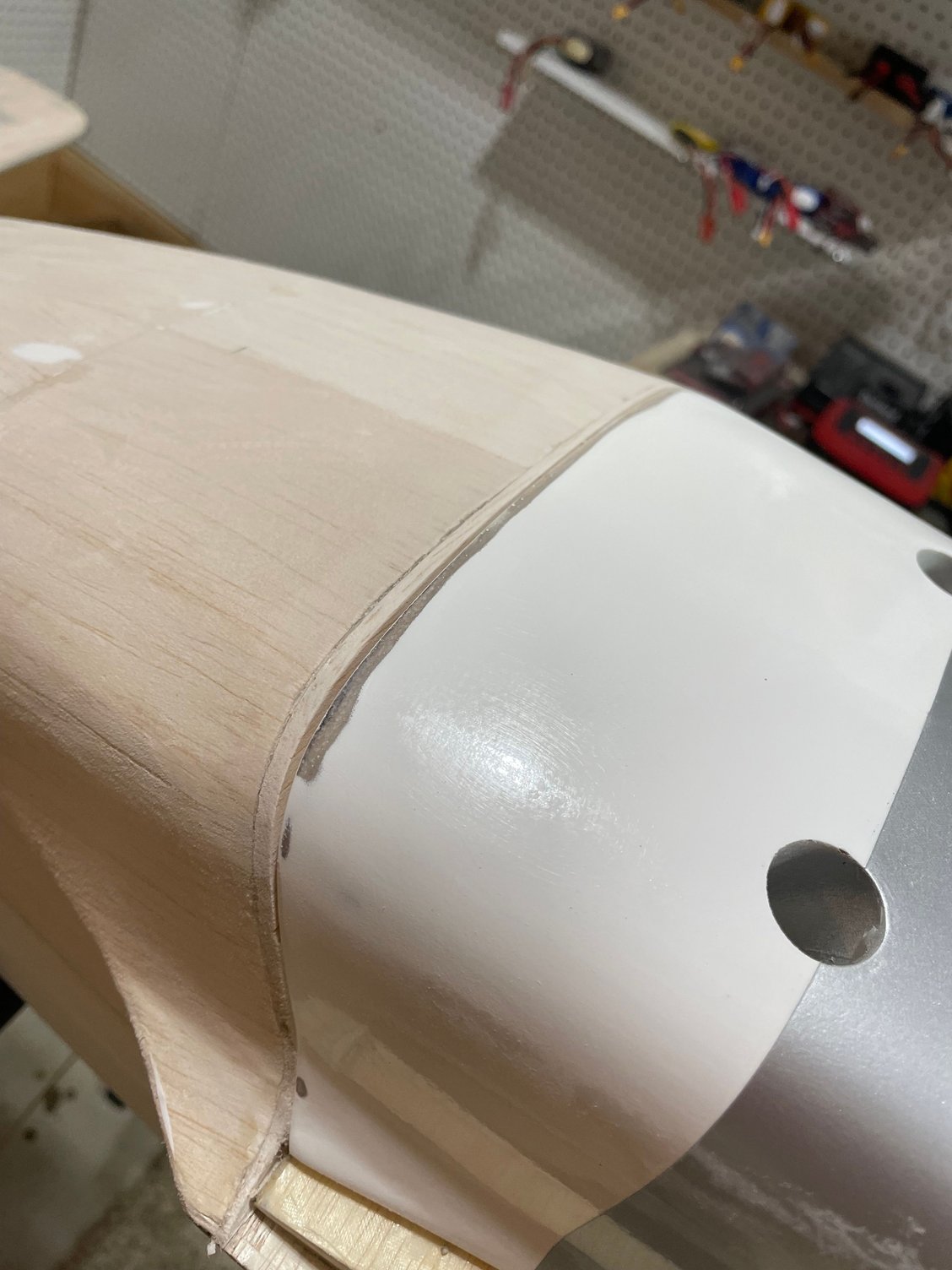

It has begun. Rudder has already chameleoned to cub yellow.
Going to have to do a bit of sanding to the wing tube holes on center wing starboard side, tuebes won't go in. Same with wing that side..that will wait till next trip home and can get some supplies to do so. Was hoping to avoid that one...
another hitch..whoever built the left wing fished the servo lead pull line through the fiberglass for the wing tube and out the wing tube hole...thats going to be a fun fix..

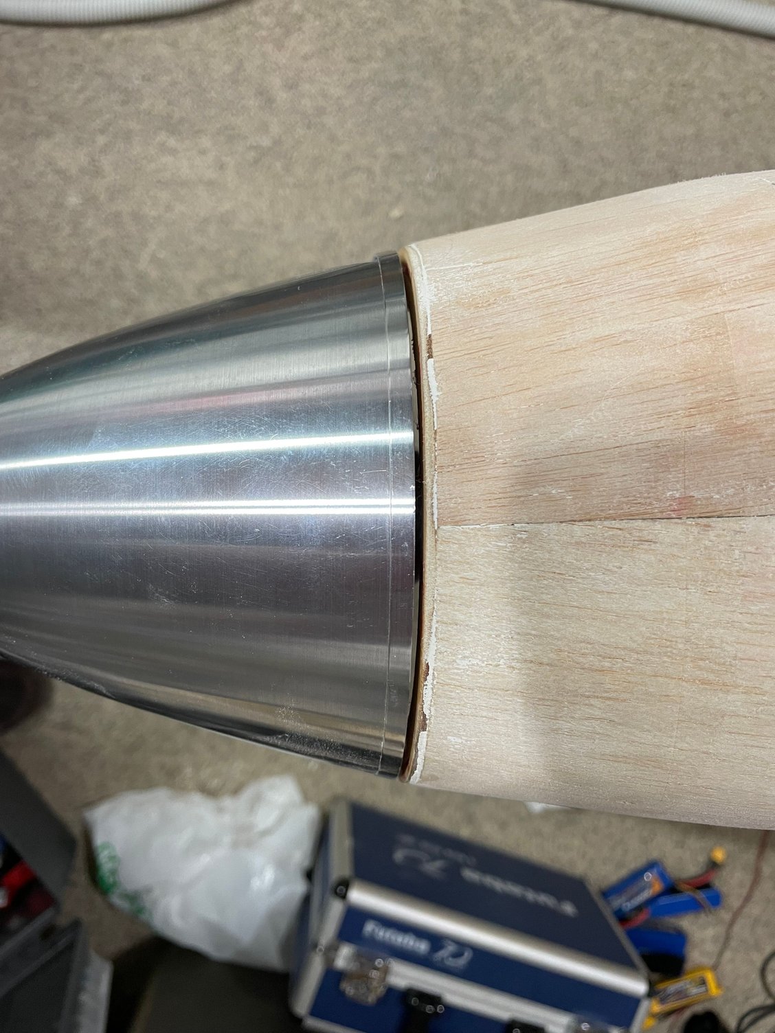

Nice to see a newer building thread on the H9 Mustang. I started on mine a couple months ago.
Some comments about what you're doing so far:
Your fuel tank seems a bit small for the G62. I like to have 8 min. flight time with some extra so I can fly at events. That's usually 24 oz. tank with a 60cc engine. I'm putting a DLE-65 on my Mustang, and I'll be using a 32 oz. tank. This P-51 is big enough that I believe I won't be happy flying around on lower throttle settings.
I commend your work to get a 4 blade prop on there. I would recommend you do the maiden with a two blade. I suspect you will have a big drop in performance with the 4 blade (even after the pitch is set right) when compared to the 22X10 that a G62 seems to work best with.
I'm stripping and glassing my P51. I also decided to make the wing a one piece. I didn't really like the fit of the wings, and didn't want to struggle with them every time I go to the field.
I went with a Dave Brown Spinner. The new place that took over production don't have any, but I found some at Meister Scale. The 5.5" Dave Brown spinner fits perfectly, and at $115 is quite a bit cheaper than a tru-turn.
Here's a photo showing my spinner fit.
So far I think I've worked past the issues I had with the kit. The wing fit wasn't great, but since I'm gluing it together I only needed it to slide in one time. The scoop fit was bad. It was off center so bad that I had to get another one from Tower. The new one was better, and with a bit of work I got it to match up nicely. I added some balsa to the fuse to get a better match.
I'll post some more photos and get the thread caught up on my progress.
