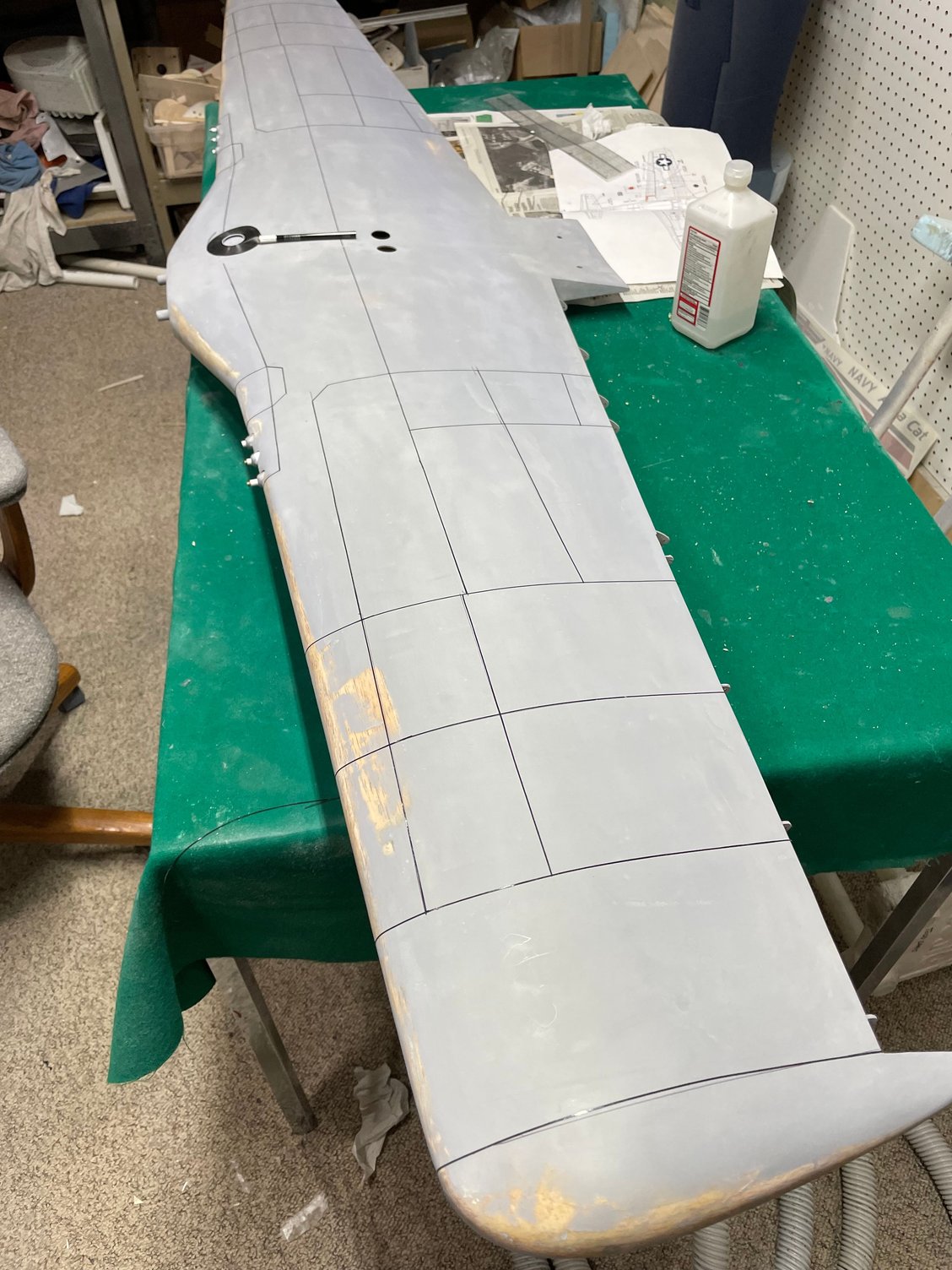

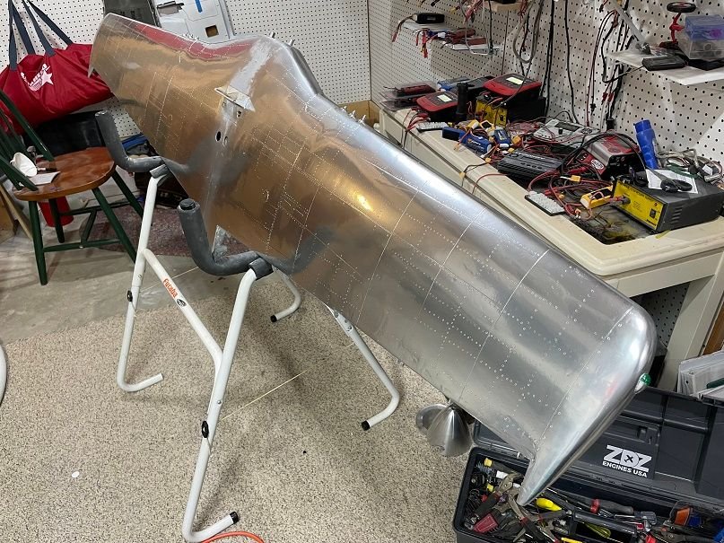

My P-51 is all stripped and has been glassed. I have the primer coats on, and am working on getting the rivet and other detail added prior to painting. Here's the wing prior to adding primer to get panel line detail.
I added some detail to the cockpit. The stock cockpit is not bad, and the sliding canopy actually fits well.
I'll be putting a "Best Pilot" that I had from another plane in there.

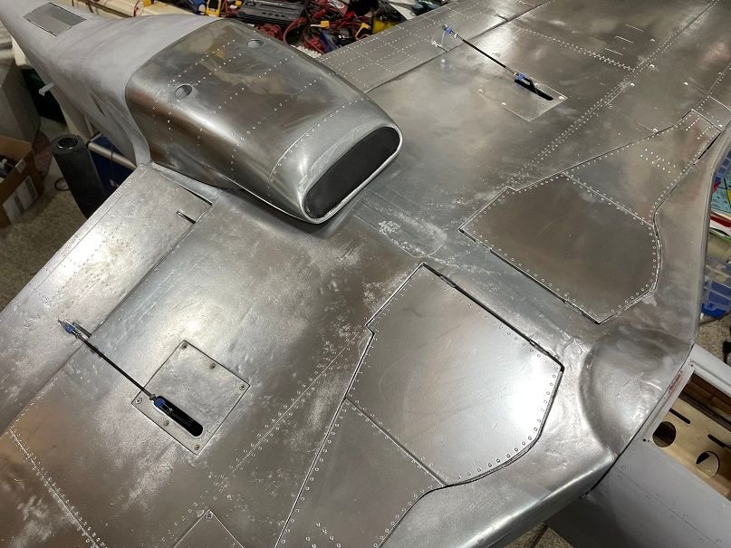

I'll be using some Restoleum Metallic finish paint. Should give a decent representation of a bare aluminum (shiny, not overly weathered). I painted my Horiz. stab to test it out. Not sure how much I'll scuff it, or how much weathering I'll do. Depends how well the paint stands up the masking process when I paint on all the graphics. I'll provide some more information as I progress.

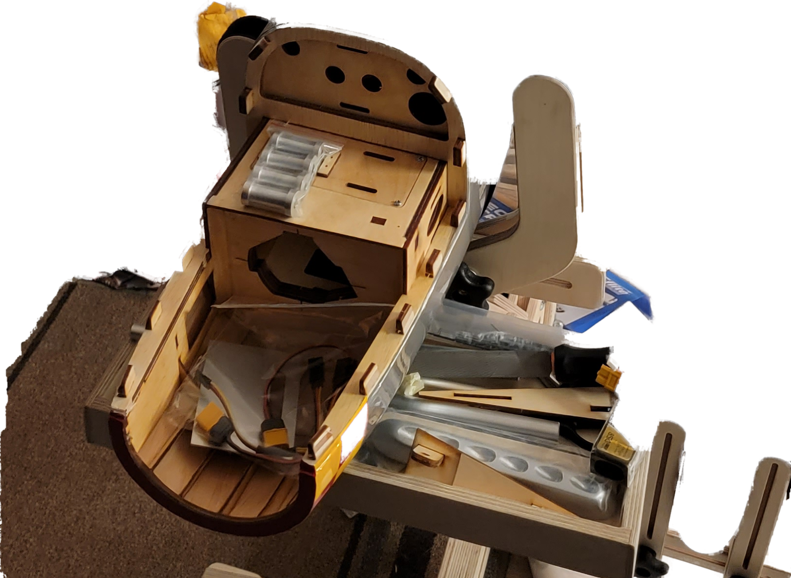

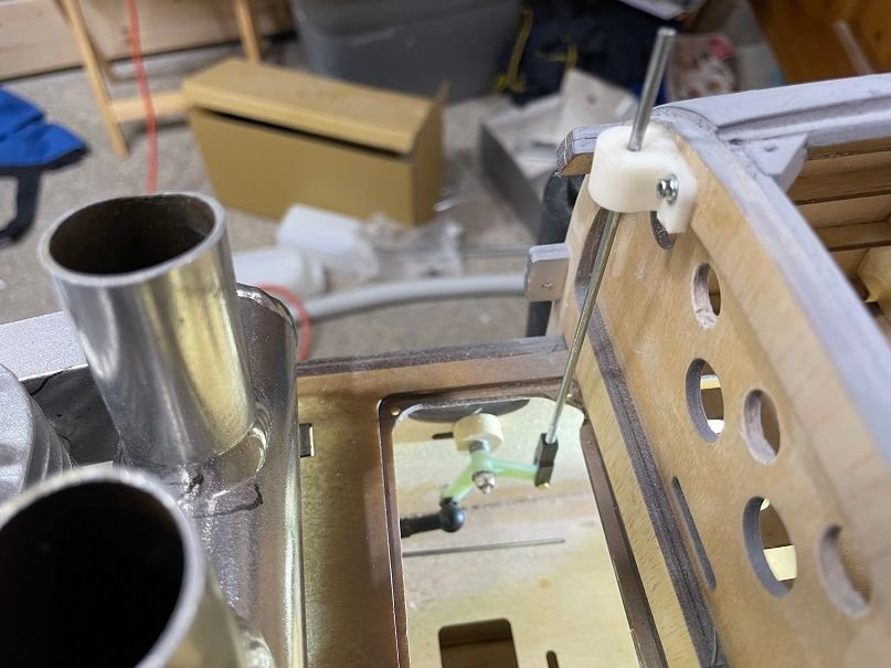

The big opening in the firewall is gpingbto cause issues with mounting the zenoah.
I've ordered some 1/8th inch birch ply to laminate and fill up most of that opening. Once its flush, I'll then epoxy a solid 1mm sheet of cf to both the front and rear of the firewall. I can then notch the right side of it to clear the carburetor, replace the light ply support pieces then dowel pin with 3mm cf rod cut to to length, restoring the strength in that area. Once that is done, the zenoah will mount.

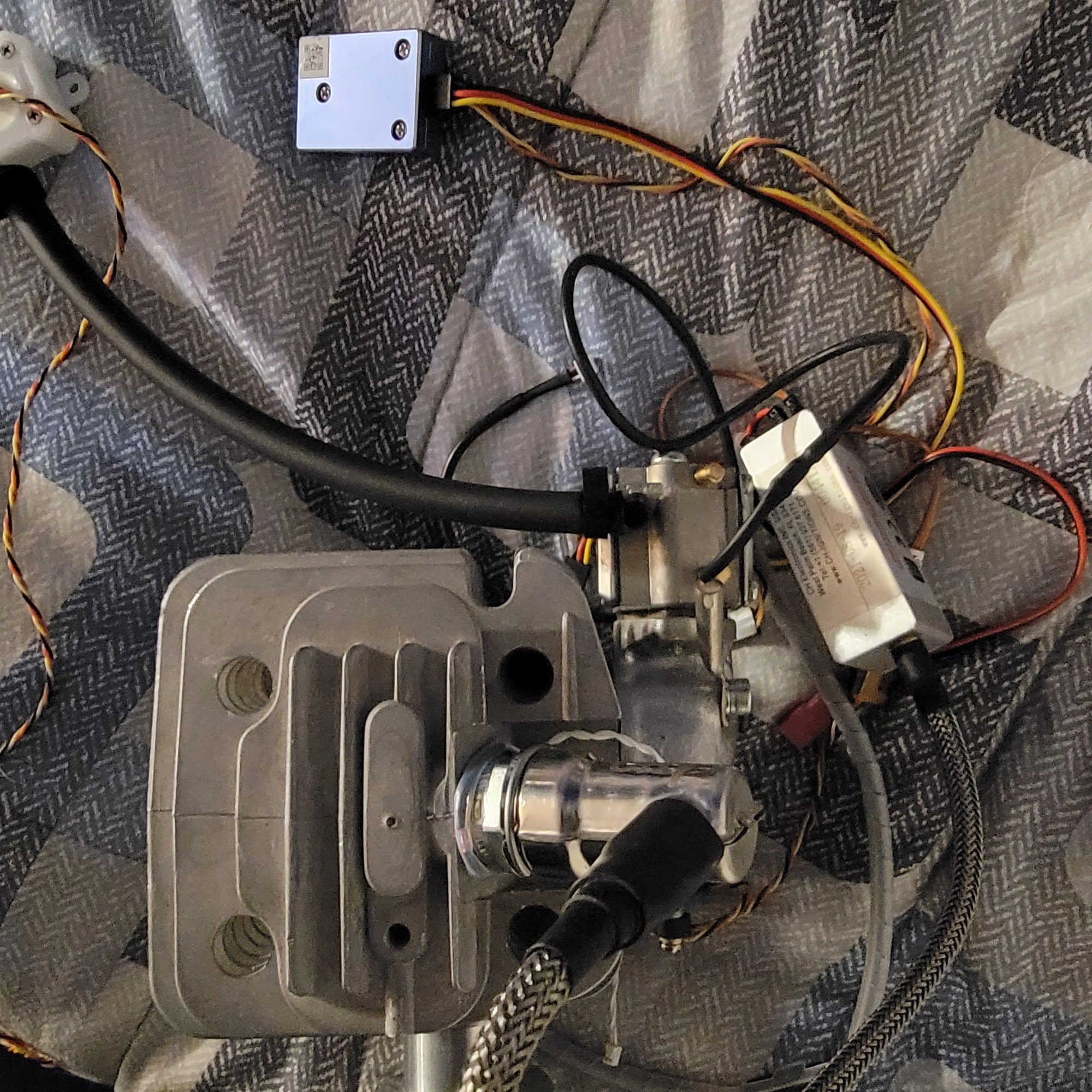

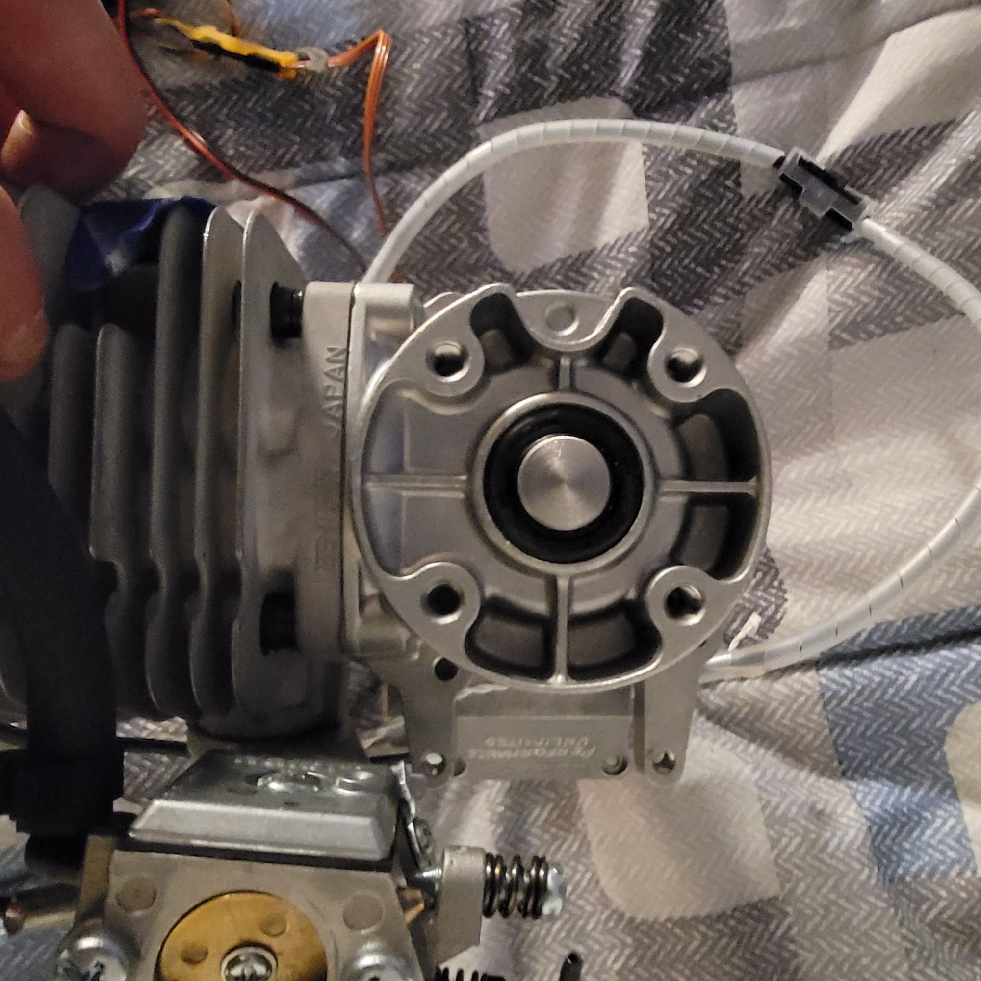

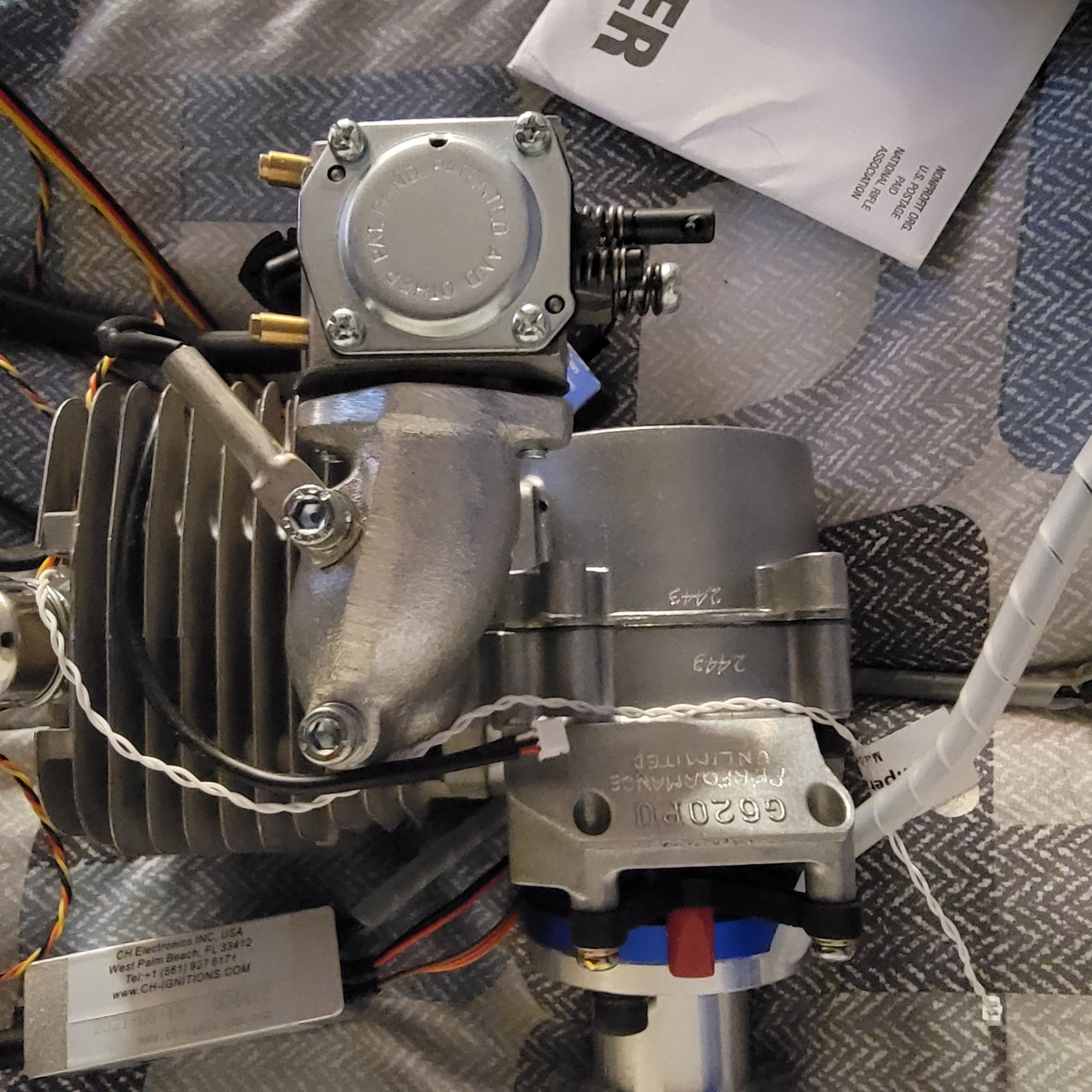

This week, my major concern is planning the exhaust. The jtec wrap around kit specific isn't going to work.
the easiest way to resolve would be a functional scale exhaust for exhaust side of engine, but nobody makes scale exhaust anymore. Whatever it is is going to be custom.
I'm thinking a small can exhaust or a wrap around pitts, almost.
reason: see pics.
the standard exhausts available will hit the carb.
also considering having a custom canister exhaust machined out of aluminum through emachineshop.com then using a flex header from exhaust port to the canister. Getting a quote on that just to get an idea on cost.
another option is some copper tubing frpm the local home depot and braze something up...then run a flex header to that.
final option...just straight pipe it.

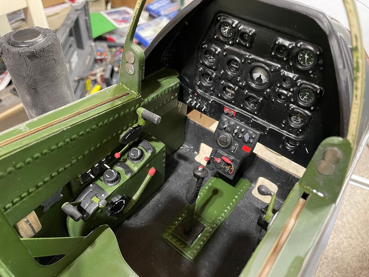

Cockpit all finished up by Jiri. He plans shipping on Monday. All I should have to do is glue on the mixture quadrant and install.
might take a trim here and there..but thats ok.

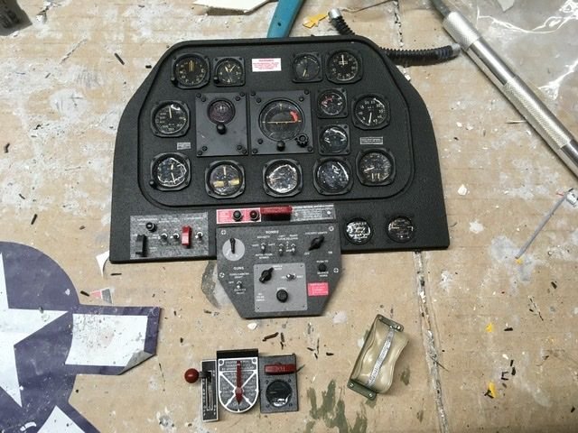

Jiri just finished these up in CAD. New cockpit storage bag for his 1/5 P51 cockpit. Hes sending one along.
Old 01-17-2022, 10:02 AM
  #92
Txmustangflyer
Join Date: Nov 2021
Location: Boerne TX
Posts: 881
Received 52 Likes on 46 Posts
Guys, if you are going full tilt yowards a scaled out mustang, you could do no better than JP warbirds.
This panel is just....art.
the updated cockpit storage bag is also in the picture. Tank selector panel all detailed out. I swear Jiri goes to sleep with a migraine every night from concentrating to do details like that. Even if they are decals, that takes some severe magnification to get exactly right.
Of course, what that means, is after this flying season I'm going to have to seriously study up on doing panel lines and rivets just to end up with an exterior that does that cockpit justice.
As you can see, this cockpit is as detailed as you can get. Gunsight, radios, side panels, throttle and mixture quadrants. They don't get any better. JP warbirds raises the bar.

So, I THINK I have resolved the exhaust issue. Its going to turn out that a Bisson muffler is going to be the best option, with one slight modification..clocking the exhaust flange just a bit more so it clears the front of the engine box and gives room for the linkages to throttle and choke.
Worst comes to worst, I have decided on an alternate course. If I absolutely have to, an RCGF 63 cc will spin the varioprop just fine. I hope the Zenoah can be situated, but fall backs are always good. The wife wants a DR3, so if worst comes to worst, the zenoah can go in that.
The new RCGF 63 cc single rear exhaust will be available in March. Trials of the prototypes (talking with one of the three owners of RCGF this morning) the 63 cc will spin a 23x8 two blade at 7800 rpm range. All three prototypes hit right near that mark from 7725 to 7810. Ample power to spin the varioprop.

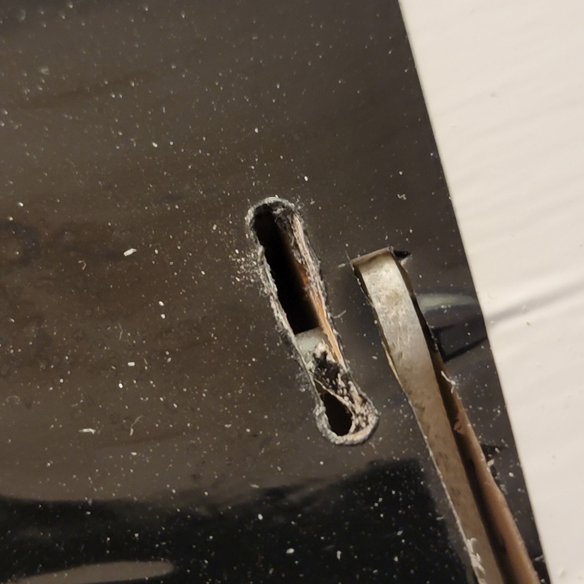

I have to clean up the ultracote here..this is in between the flap and wing.theres enough overlaped and loose exta covering that its actually binding the flaps some. Thats next..then install flap servos and control horns.
Another issue...the tube for the hinge wire rus throughthe slot for the control horn.
Two options...remove the hinge wire and cut the tube, or notch the horn for the tube.
I think I'll notch the horn, the tube rotates with the flap. By binding the horn to the tube I think it wil actually control the flap better.

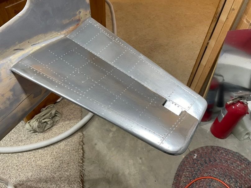

Making good progress on my Mustang. The wing and fuse are detailed and painted. I'll be applying graphics soon. The photo shows the wing with the all metal finish, provided by the Rustoleum paint. It looks nice when it's put on, but doesn't like to be touched much. Even the masking tape takes off some of the sheen. That's ok, most likely it'll revert to a more weathered finish over time.
I decided to go with a manual choke, so I used a bellcrank and some linkage to make it happen. I'm happy with the end result (see the photo). Just a small rod peaks out the bottom of the cowl.

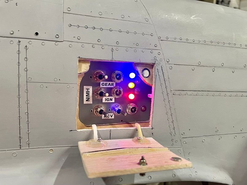

I decided to create a door to hide the switches. I'm using all Nimh batteries. I'll use a 5200 mah for the main power fed through two parallel switches. A 5 cell 3000mah for the ignition, and a 6 cell 3000mah for the Electric Retracts. Here is the switch and hatch that I made with charge jacks.
