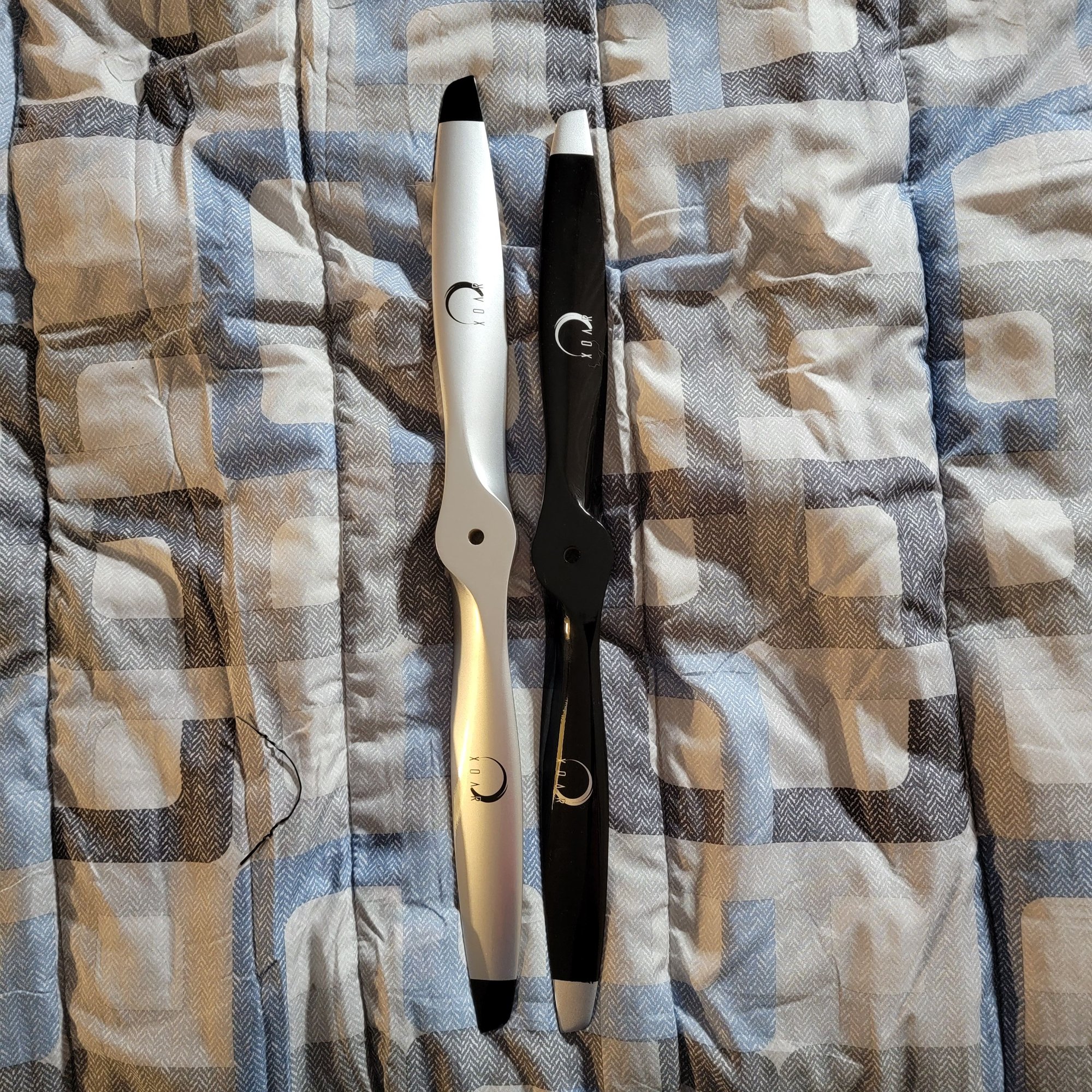

Another thing I need to put out there, the vario-prop on a gas engine has a max rpm of 6300 (unloaded). depending on how much it unloads in flight, may mean an rpm on the ground somewhere in the 4000 to 5000 rpm range. I do want to see if the engine/prop can hit 6300 on the ground to tune the carb with the vario-prop, but from there, I'll have to increase pitch to bring engine rpm down to 4500 for the maiden and adjust from there. It's going to take some tuning of the prop to get it just right, which means adjust, fly, land adjust...rinse and repeat as needed. The prop cannot go over 6300 rpm. The vibration from the engine above that can cause stress cracks, and ultimately, failure, of the blades. If it needs more than that, I may have to check into carbon composite blades for it.

So, all thats left to order is...the spinner and exhaust.
the proper sized prop bolt has been ordered, 20mm stand offs ordered, actual spacing needed is 23 mm, but, by the time washers etc are in place at firewall and engine that pretty much takes up some of that. Adjustment for proper clearance is just adding washers as needed.
Still waiting on the Vario-prop to arrive from Germany and, still waiting on the 10 spoke wheels from tower as well as the airframe.

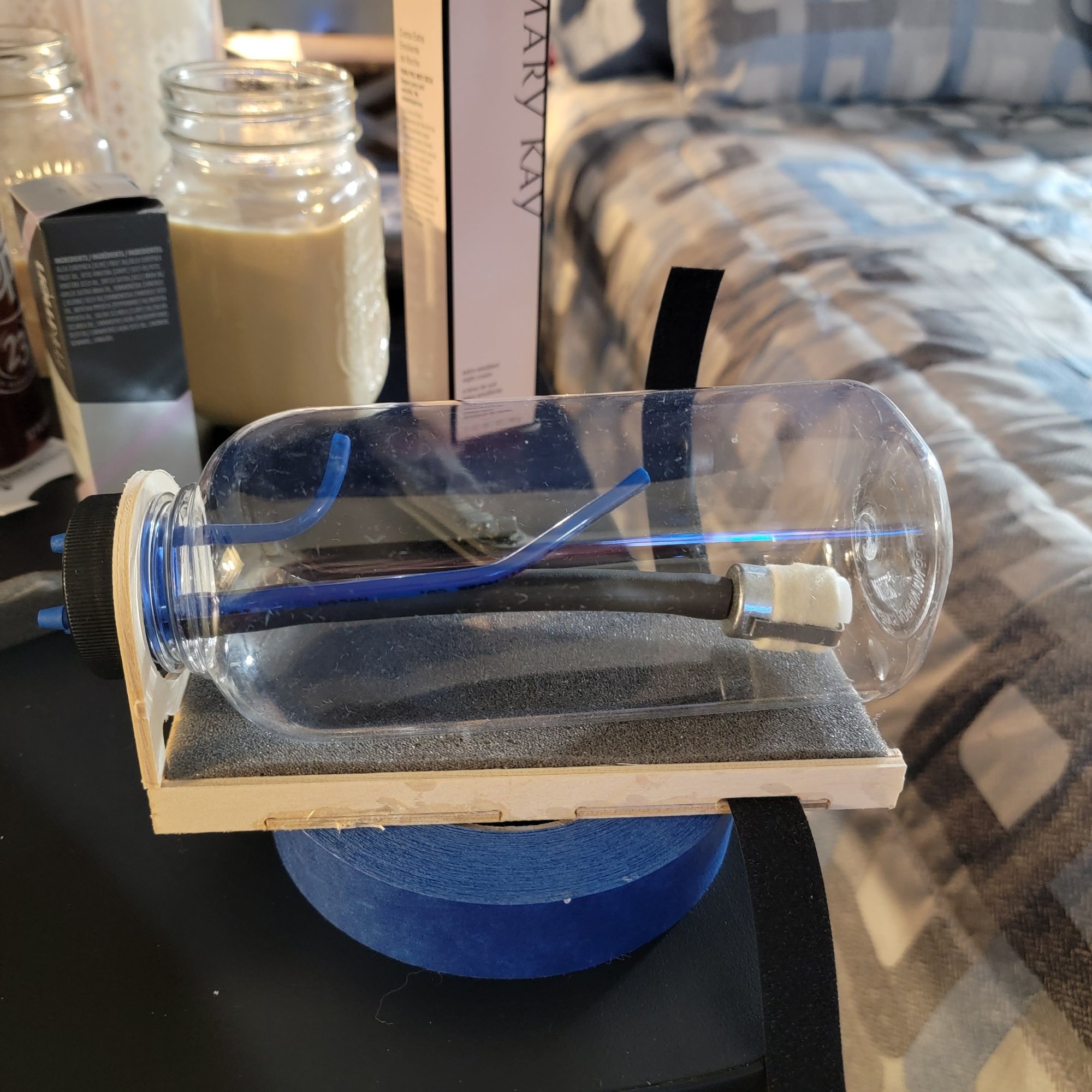

Choke servo is ordered, ignition bettery is ordered, reciever battery is here, it's a 2s 5400 mah at 7.4 v. That may be changed up to a 3s. We'll see how things balance.
all the servos are Spektrum HV's. The linkages are going to be interesting to the carb, especially if I have to clock the engine to clearance the carburetor.
So, some new hurdles have, potentially appeared.
In preparation of resolving those issues I have ordered a carbon fiber, 3 ply plate, as well as some 1/16th birch plywood from aloft hobbies.
the carbon fiber plate will be used, for a better engine baffle and to isolate the carb from the prob blast, if needed. Can fashion into a small scoop, that's light weight, using the mounting bolts of carb to mount. The ply will be used to make the prop patterns needed by truturn, and patterns for the baffle and scoop. Be a basic one, nothing fancy, but will be light, strong, and functional.

Fuel tank, fuel dot and fuel tank tray from Desert Aircraft
the fuel dot will be placed at the location for the center tank cap on the real plane. Don't think this is quite 1/5th scale but it makes sense to put it there.
DA makes it a pretty easy install, plywood mount for it is included. Nice package.

A quick test fit of the components. Fill and vent tube get glued to the cap insert on final. Their final placement will be towards top of tank as it sits installed.

Can't forget the Xoar propellers that will be used for initial tuning and run in of the engine on its return from Performance Unlimited.
Black: 22x10
Grey: 23x8
Black: 22x10
Grey: 23x8

If you still use Tygon in any part of your fuel system, it will be an eye opener. I did to, including my last mustang I built. As a result of his work in that area, the Hanger 9 will be plumbed from the clunk to the engine and all throughout with Viton. I ordered mine from McMaster Carr. Use the link he provides in the thread. It's a bit more expensive than Tygon, but will not harden, won't expand or swell, retains its internal diameter, even with prolonged exposure and complete submersion in fuel.
No drips, no leaks, and from the clunk to the tank, you won't end up with a kinked up fuel line in the front corner of the tank after an inverted dive, roll, or other maneuver. It will stay to the aft end of the tank like it should without having to use brass tubing to keep it there.
Edit: ghoffman has been running the same Viton for 2 years now...no leaks..no failures.
