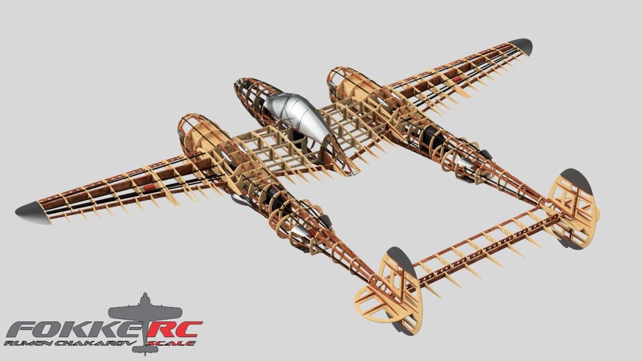

Fokkerc upcoming build...The P-38 Lightning.

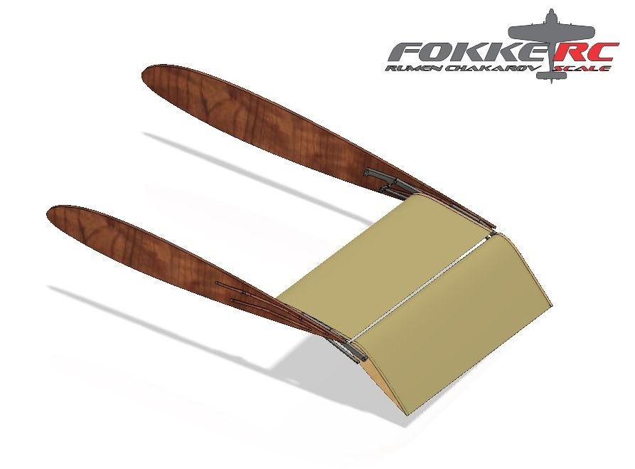

Hi guys , yes we work the last two weeks on this flap mechanism problem , I wrote in interenet many desitions abou the movement of the flap , but at last we made the original constrction as on the real plane . The plans to draw this scheme was to hard but the result is cool I think
The pictures and video of the flap movement
I hope you will like the result
Cheers
HEre is the 3d PRINTED DETAILS , i PRINT THEM TO TRAY HOW WILL WORK ON REALITY It seems work perfect
The idea is to put the drawing of the mechanism in the paper plans of the model , because I can't produce them by aluminium material
Here is the video
Cheers
Here is the video

Fowler flaps
Hi Rumen, I am blown away by your work.
I’ve been working on and off on a Ziroli P-38 for over a decade and I’ve never seen such an elegant Fowler flap mechanism. Would it be possible to obtain a dxf or cad file of the mechanism and parts? I would love to replicate this.
Thank you
Kyle
Thank you
Kyle

finaly we are ready with the Lockheed P-38 Lightning 1/6 scale model kit from our company fokkerc.com
I am so happy with the fokkerc.com team !

The vid 9f the flap movement I think, is begger in scale than what will be in the wing. Someone had made a comment about 5 inches of travel..scaled down to actual size in the wing, I think it will be much closer to what a servo can handle. Rumen can correct this if I'm wrong. In either case, there are solutions to every problem ;-)
one possible solution to actuating the flaps. Four of those would do the trick quite well
