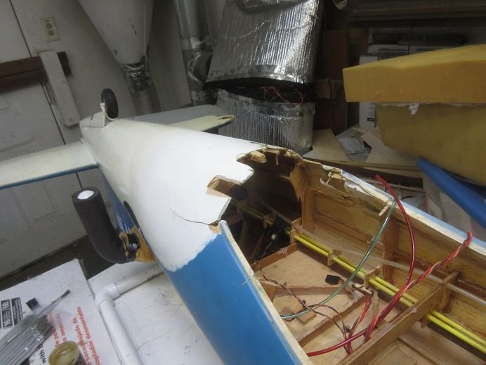

Ziroli F4U repair..
Idiot: while landing I got the plane too slow, about 500' away, and she crashed.
It's been decades since I let a plane get too slow and crashed!
Fortunately, she's not too bad and repairable.
Mostly the engine area, the center of the wing and the wing area on the fuse.
Engine area repair:
Motor mount loose and top of fuse damage.
Epoxy and clamps.
The ply for mounting the engine epoxied and clamped.
Wing area on the fuse:
Front and back 'ripped out'.
Front area epoxied.
Masking tape useful to hold all the 'parts' in place until the epoxy 'cooked'.
As usual: always pick up every piece of balsa at the 'field'!
Some 'bondo' will be needed to fill in the 'cracks'.
Back wing area of the fuse.
Made a paper template and cut a new ply former.
Epoxied and clamped.
The former holding the wing was salvageable.
Made a ply former to hold and strengthen the 3 pieces of the original former.
More epoxy and clamps.
Back of former with new ply added and paper template made.
Dry fit for now. Will not epoxy until the wing can be used to align the parts.
Center wing damage.
Both ends were damaged.
Front end:
Epoxied.
Back end.
Former epoxied to wing.

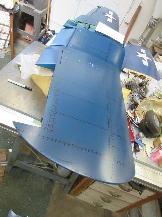

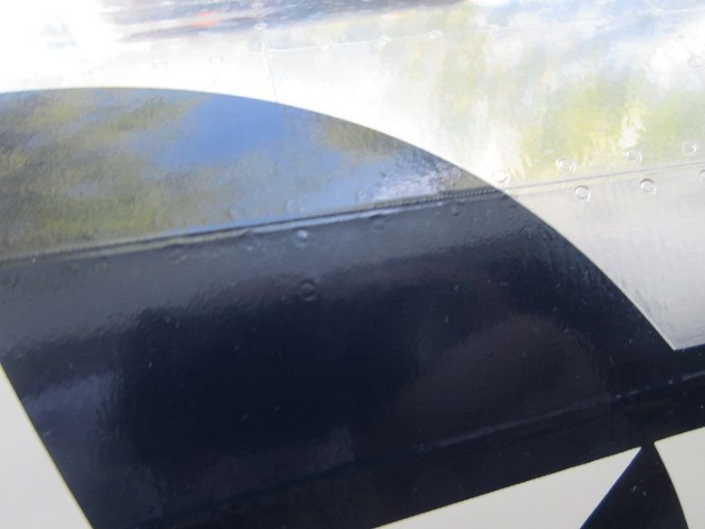

Here's the defects showing when I didn't use a primer to 'smooth' out the surface before painting a glassed wing.
Panel lines and rivets.
I 'changed my mind' and went the 'easy' route and added them via 'paint pens'. This is much faster than my, usual, soldering iron with a 'brass tube' method.
Still had 'printouts' that I used on my Carf F4U.
Bought several types of 'pens' as I wasn't sure which would work the best.
These are 'enamel' base.
Purchased them at Michaels.
This 'medium' pen seems to work best.
The tip is 'fat' enough to see on the plane.
Right half of the wing.
I used an 18" 'see through' plastic ruler for the 'panel lines' and just 'eye balled' the rivets.
Nothing 'great' but it gives the wing some 'pop'!

Left wing half.
NO: I'm not doing the bottom of the wing. No one will see it and this is just a 'week end' flyer.
One nice thing: the 'panel lines and rivets' hide the surface defects!
I put 'double' lines on the outer ribs to represent the cloth that was used in that area versus aluminum sheeting.
The fuse is next.

Clear coat.
Minwax polycrylic satin works well for me.
Only about 10% diluted with 'auto window wash'.
As with the paint, did the 'bottoms' first.
After 30 minutes, surface hard enough to 'flip' 'right side up' using wax paper for protection.
'Clear coat' still wet.
'Surface' dry after 30 minutes.
Blends the rivets, decals and paint into one 'matt' finish.

When removing the TF F4U from the trailer, I noticed the 'wing sheeting' was split. (see last post for repair).

TF F4U wing sheeting 'separation' repair.
Some epoxy fixed it.
