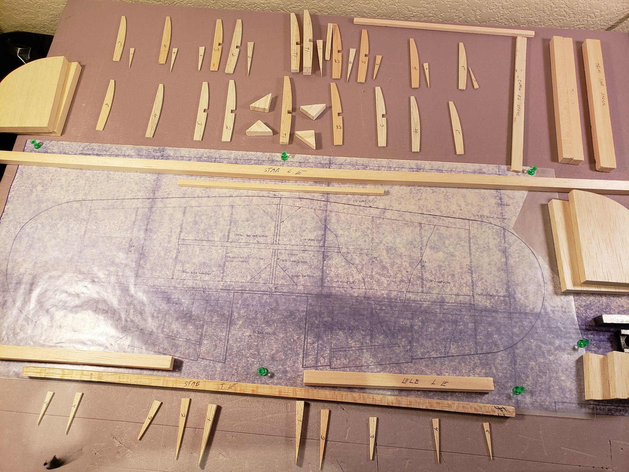

Here's the parts set for the Tempest. The parts were cut by "American Kit Cutters", who have been out of business for some time. The plans are quite old, actual blue prints that are significantly degraded, but remain usable ... just barely.

After laying out all the parts, found that one of the ribs is cut short (2nd pic). This needs to be fixed before assembly. Bottom #4 is short 1/16". Top is fixed.

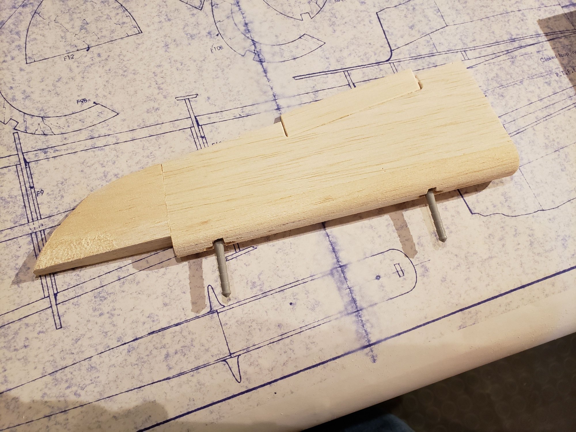

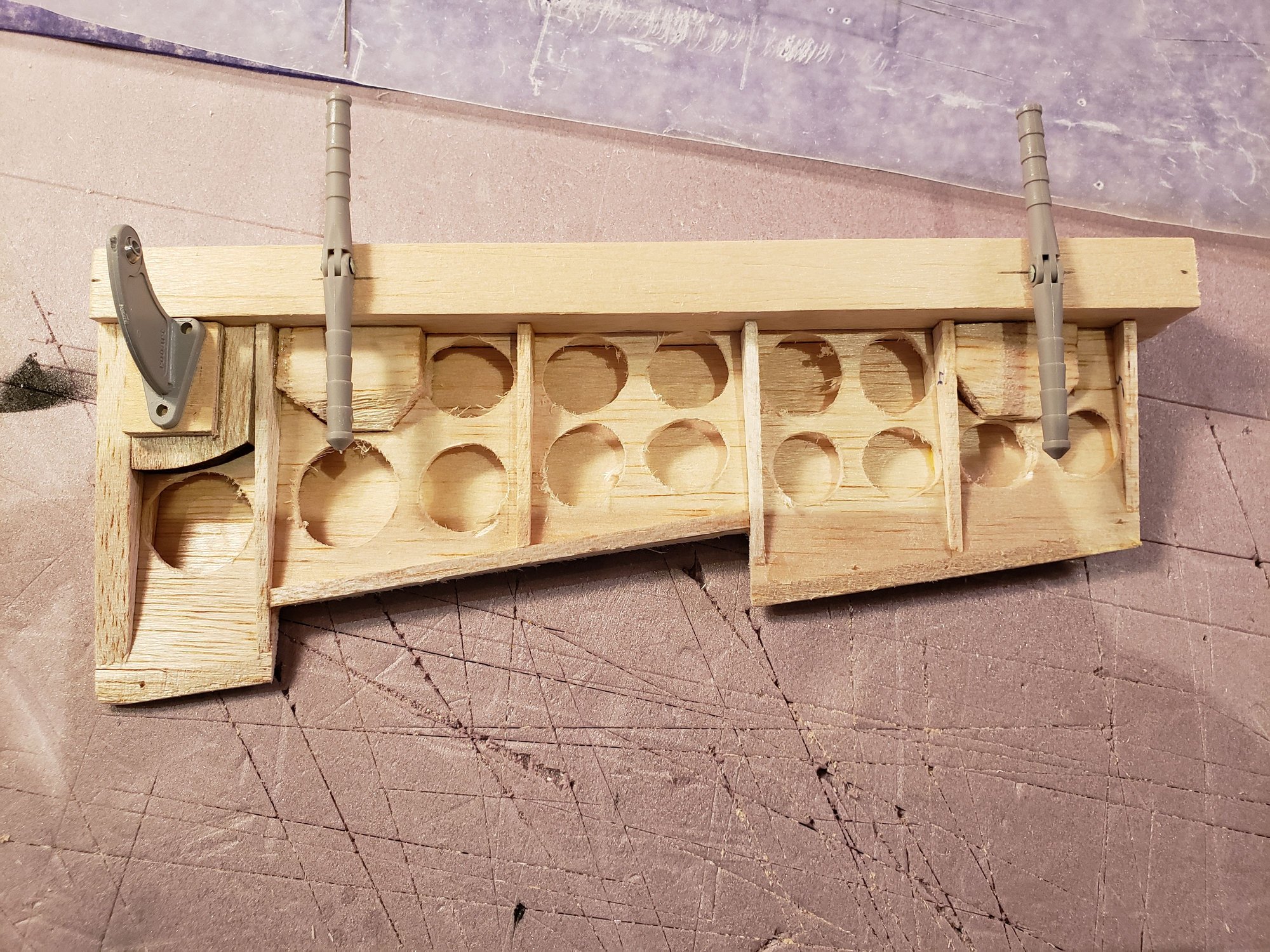

Picking up work on the elevator. First shot shows the insides. I will not be using the brass tube and piano wire hinge shown on the plan. Very scale looking, but Robart pin hinges will be easier. Also, I'll use 2 servos to drive the 2 elevators instead of making up a metal joiner. The control horn sitting on a ply plate. The hinges are shown in roughly the right position with hinge pivot point about 3/8" back from the LE.
Second photo shows the completed elevator, with the tip glued on as well as the sheeting. Note the oversized trim tab.

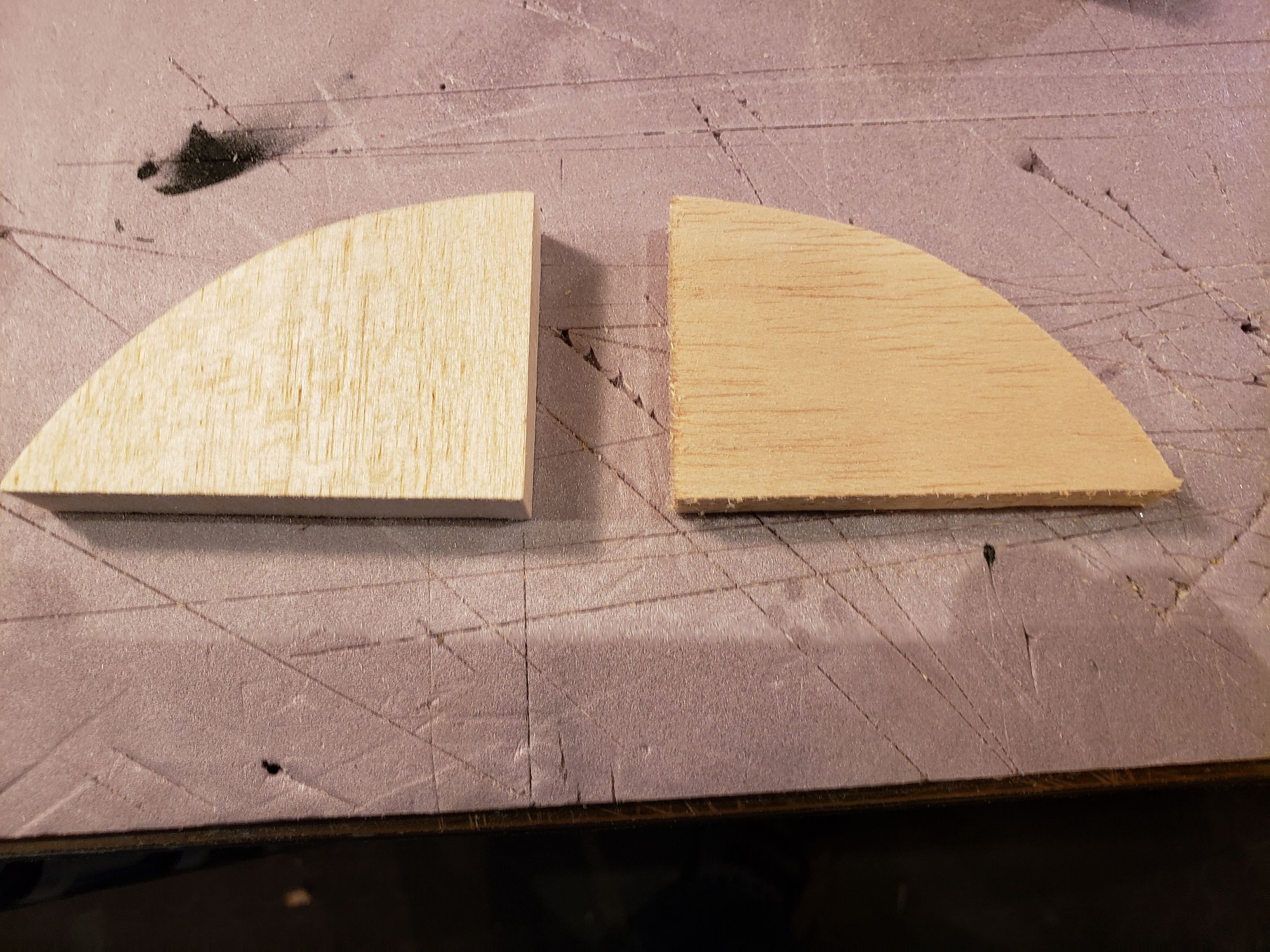

I do wish to thank the small businesses that cut parts for plans. It does save a ton time. But I DO wish they would have someone build the plane from their parts to correct the errors. There are always several. Most recent example are the tip blocks for the elevators. In the pict below the block on the left came with the kit. The grain here is going the wrong way. Once this part is cut down to size it will spit and snap into pieces along the grain. The one on the right is my recut part. Ah well.
