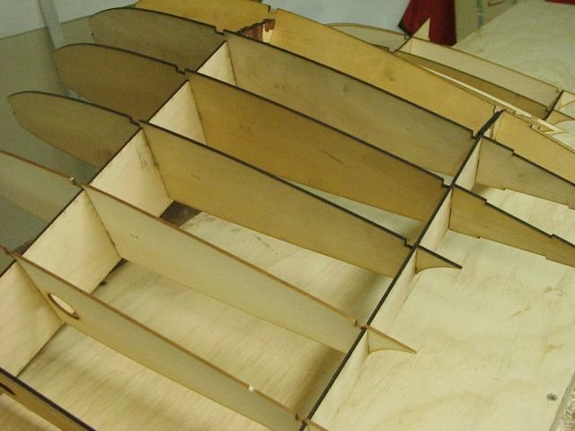

I then put the wing ribs in there slots but not glued.
I come to find I had to make some slots longer as they were not cut enough. By the way I am in touch with Kitcutters and tell them things I would change.

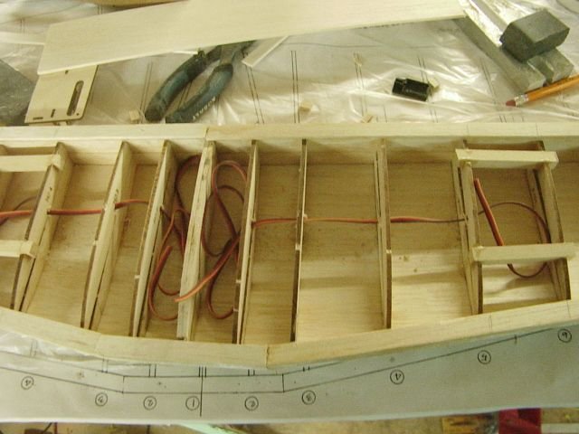

I have been working on the elevator section some. I found the ribs are at full length and must be cut for installation
I did it in 2 half as the plans suggest.
I installed the servo wire before closing
I put a old carbon wing tube in for wire and air line to the tail

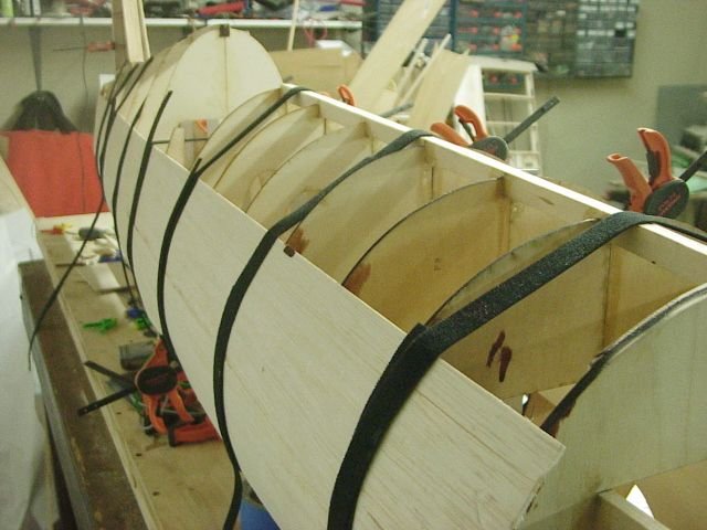

I am now starting to plank the fuse. I found that Velcro straps help hold it to shape. Getting CA to hold balsa to ply hard to do so I am using epoxy slow set. It takes longer but I know it will hold.
