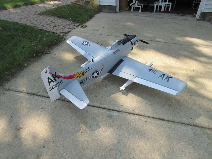

A-1 Skyraider final PM (hopefully!).
I used the shortest CG to be 'safe' at 5" from LE of wing with gear UP.
A little nose heavy so moved 2 batteries back a few inches (she has 5 batteries: receiver 2, ignition, gear and starter motor).
Final spaghetti interior!
Put a piece of clear plastic (from pastry) over servos to prevent wire entanglement.
Added just a small amount of epoxy on each dowel to secure the horizontal stab to the fuse.
With a 'wing tube' not a lot of epoxy is needed.
Glued and screwed a small lead weight just behind the tail wheel for the CG.
Some white lithium grease on the motor starter gears.
Ready to 'rock n roll'!

A-1 Skyraider; a few last items.
One tank pilon was loose.
Some epoxy on a wooden dowel that secures the pilon to the wing.
Drop tank servos.
Guns needed some epoxy.
Just able to get wings and drop tanks in one wing bag!
Will have to be careful as those rockets are fragile!

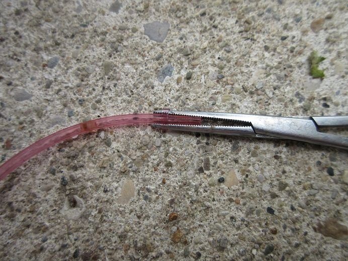

The battery wires going to the 'starter motor' broke at the connector.
The manufacturer soldered only 'tip to tip' instead of overlapping the wires.
I also used solder for water pipes as I, believe, it is stronger than solder for 'wire'.
Also, I used a 'plastic tie' on the heavy duty wire to the motor mount to reduce vibration.

13 year old Ziroli SBD Dauntless has an air leak.
I check the air 'fill' and 'gauge' and those were good.
I did replace the 'fill valve' since the inner threads are a little 'stripped'.
As usual, every thing is 'modular' so it was easy to test/replace parts without have to try to access these parts from inside the fuse!
After replacing the connectors and tubing found the problem being the air cylinder only in the UP position.
I tried some of Darrel's grease and 'AC' oil but no 'luck'.
Sent an email to Darrel for a new air cylinder plus some flat head screws since one was broken.
All new air lines and connectors.
Hemostats and AC oil are good for locating 'leaks'.
Can see the AC oil moving in the lines.
Homemade collars from air tubing to secure the tubing to the air cylinder.

Some flying and PM on the A-1 Skyraider.
One rocket 'fell off' plus PM the 'drop tanks'.
Fortunately the rocket fell off when landing.
Both plastic 'rocket holders' broke.
Used some aircraft ply to make new ones.
Glued the plastic parts to the new ply and labeled them front and back.
Used a Dremel cut off disk for the initial cut and a metal file for the final slot size.
Let the epoxy 'cook'.
The drop tanks fell off on the ground when I put the engine to 'full throttle'.
I rarely throw anything away!
Some 'semi stiff' white foam.
The manual had screws to put into the drop tank 'stabilizers' but the plastic seems a little weak for that so I used the stiff foam
and epoxied the foam to the front and back of the pilons.
That should work.
