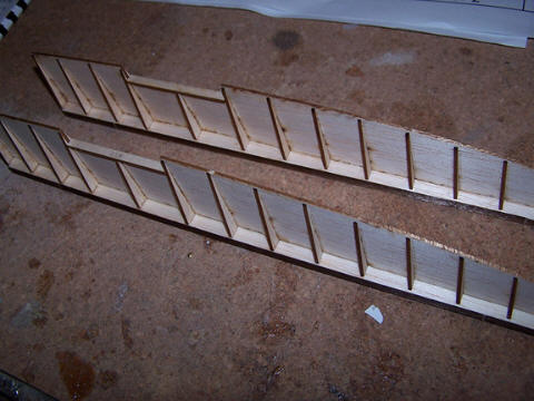

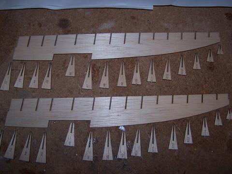

Here are the superb aileron cnc parts
ID:	71853   Click image for larger version

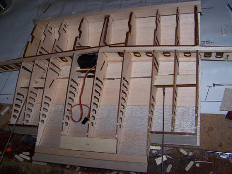

This is the Centre section of the wing assembly

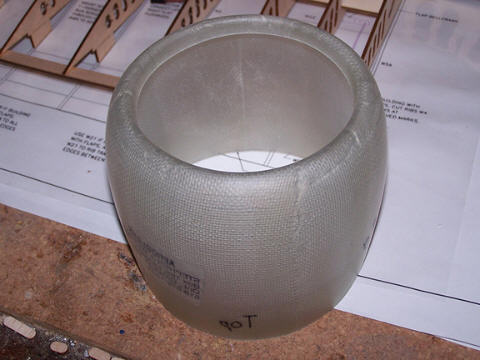

Terry this is the supplied cowl (F-Glass)

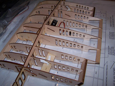

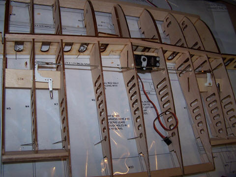

Finished the flap linkages and push rods, so I can start sheeting the centre section

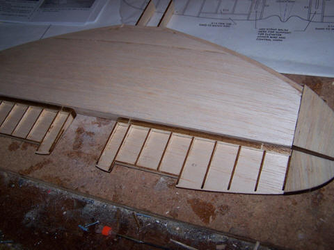

Added the top sheeting on the centre section, this comprises of 4 15 1/2" 1/16" sheets joined together, I used 2 soft for the front and two hard for the rear, this way I can bend the front sheets over the ribs, with the rear hard sheets laying flat. I now need to install the "Y" lead and extension leads for the outer wing aileron servos.

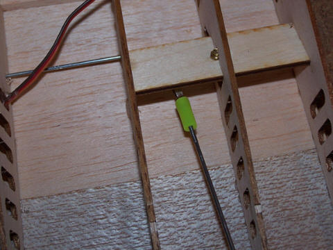

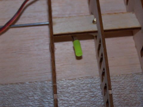

Before the bottom of the centre section is sheeted, it is recommended you remove the flap push rods (this makes sence), however I was a bit worried about having to blindly align the rods back into the wing, so I added short lengths of fuel tubing. This should make it easier.
ID:	72641   Click image for larger version

Thanks Craig, heres some pictures of the wing ribs, and the aileron ply doubler
