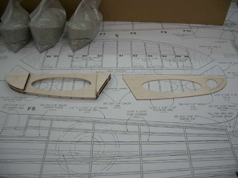

here is the elevator. the elevator core picture shows how TF has enlarged their lightening hole as compared to the plans which i assume shows their original design. you can see where i've marked out a little more balsa to cut out on the right elevator core and how is covered with the tips on the left elevator core. i even went so far as to hollow out the tips a little leaving about 3/32". have to be careful, though, on the ends because they will be shaped later.
also shown are the completed elevator halves. i modified the TF design by extending the tips in a more forward direction vs. the 45 deg. angle that TF uses. from what i can tell most MkIX's had this feature.

Still looks good so far. Remember that you still have to install the torque rod that allows the two halve to move together. If I remember right you have to add some additional pieces in there for that. [&:]

yeah, right now i'm playing with the idea of using a wooden dowel instead of the metal connector provided in the kit to join the two elevator halves. this would give it more of a scale look. however, i'm not sure if i can secure it enough to prevent an inflight failure. any ideas?

thanks for the suggestions. i would like to stick with the dowel idea because i want to conceal the control horn for the elevator within the fuselage. the rudder will have the control horn outside on the left side of the rudder (which is opposite the TF method....you would think that they could have at least put the control horn on the same side as the full size because it's really just as easy...but that's another topic). E*nealio, i think your idea of using fiberglass to reinforce the joint may be the way to go.

The dowel method will work good so long as it's a good hard wood. Some of those available will still twist a bit. So look at them carefully. I've had one suggestion out here to replace the brass torque rod wire with an aluminum one. They are available at some hobby stores, but the best place to check is some place that does welding. Depending on the alloy they can be reasonably stiff. And they can be shaped with light heat from a torch. I haven't looked for any yet, but plan to on the next TF model I attempt.
Don't think there's enough room for any type of dual push rods as E*nealio suggested, but it's a thought!!! [&:]
