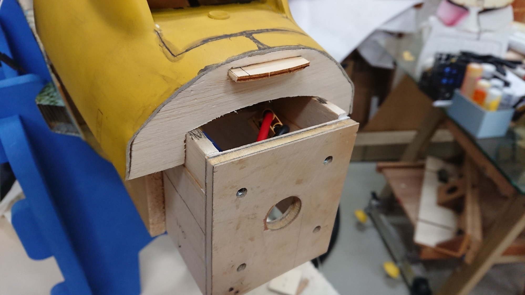

Have decided on the Eflite Power 90 motor using 6s 5000mah battery and probably an APC 18x12 prop. To prepare, the glow power accoutrements were removed and the some of the holes plugged.
The original firewall was removed and a new one was fabbed by laminating 1/8" balsa with 1/16" ply. Longer side wall supports were glued in account for the shorter electric motor and then the firewall was glued in using 3mm foamboard acting as the spinner backplate (will have to enlarge aluminum backplate to accept prop shaft and don't want to do that until happy with the P90).

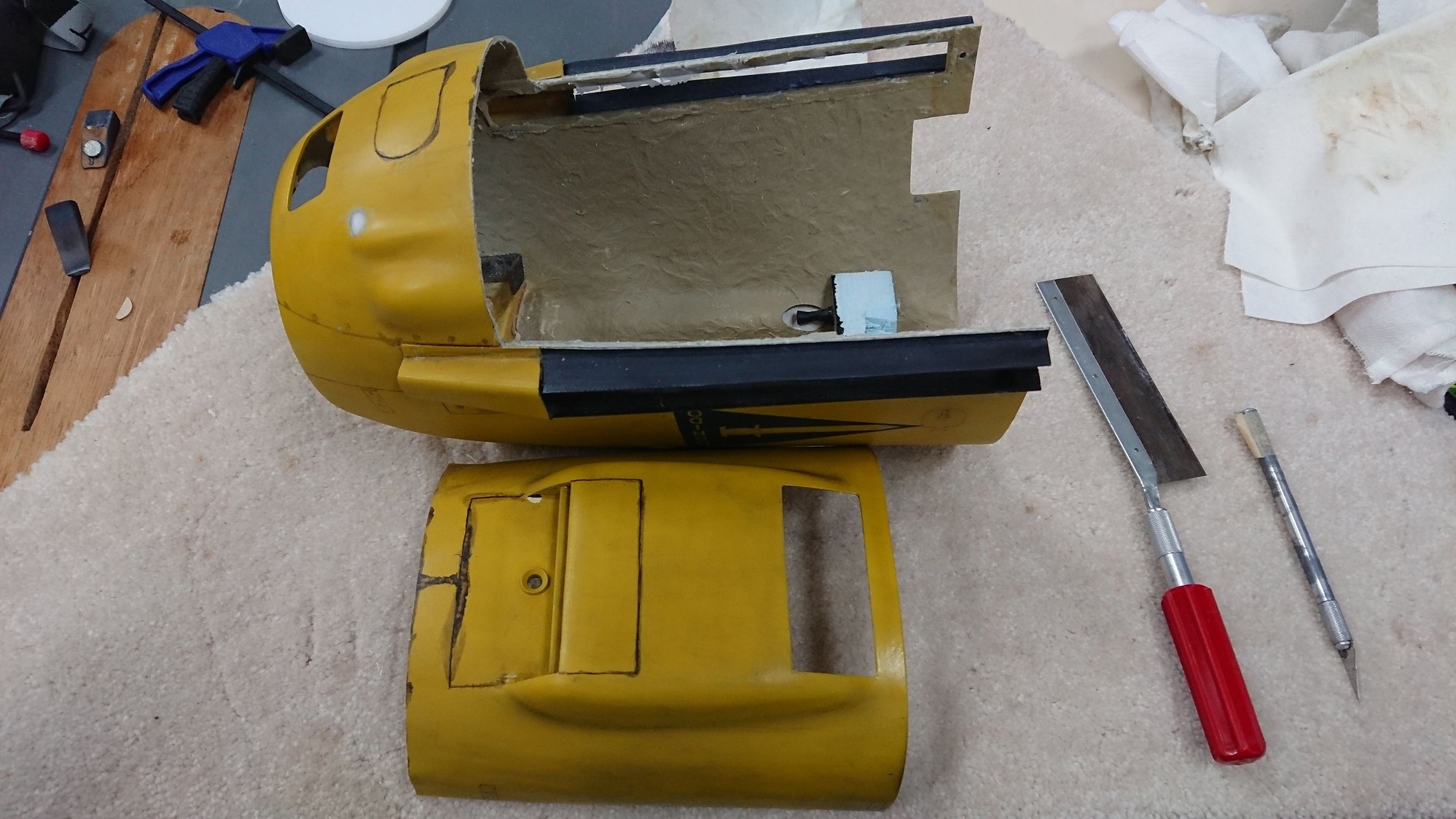

Then, the tedious process of separating the lower half of the cowl from the upper to facilitate battery access was done using a razor saw and back of an exacto knife blade.
A half former added to front for support. Cowl will be attached using tongue-in-slot in the fore and magnets in the rear.

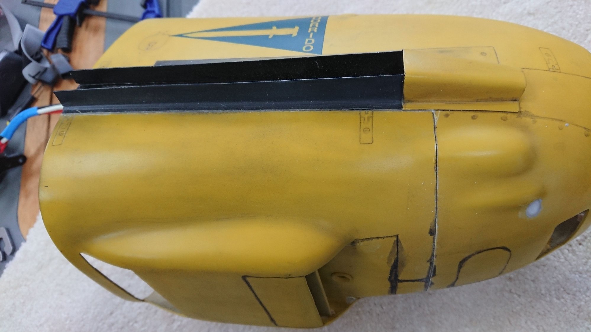

The tongue-in-slot wouldn't work due to the wing getting in the way of the cowl moving fore/aft, so went with plan B of using 4 sets of magnets.
Lower cowl attached with the 8 total magnets in place.

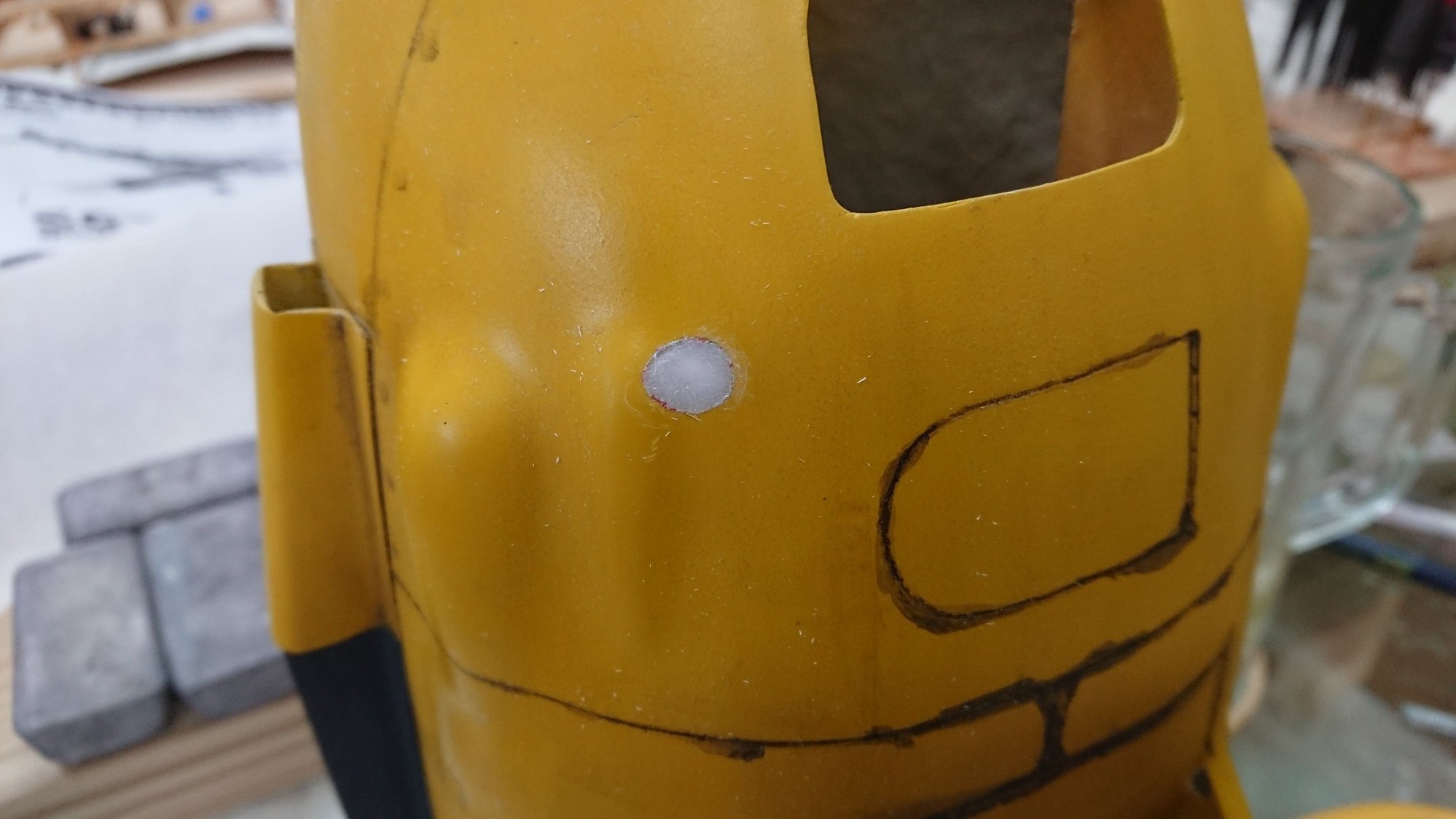

Cleaned up the areas that had been damaged earlier. Did manage to get the fuel dot out with no damage and filled in the hole with my usual ca/baking soda.
At this point, the model is flyable. The spinner still needs to be addressed but I would like to try my hand at a homemade spinner that I've seen a few modelers create but that may take a while. If a good day presents itself, I will try to fly the model as is. Clean-up will include touching up the repaired areas on the cowl and I may add just a little to the exhaust staining to give more depth.

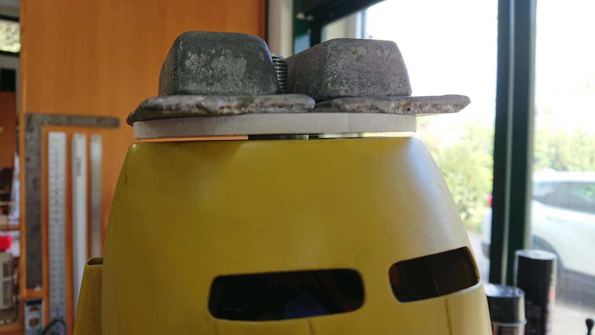

The last major effort to be completed was the weight/balance. Initially, a 6s 5200mah LiPo was strapped in and the cg came in about 1/2" behind the balance point shown on the plans of 3 7/8" from the leading edge. It took 276g (9.7oz or .6lb) to balance. So, a 6s 6000mah battery was swapped in and everything (battery, esc and 6v NiMH rx battery) was shoved as far forward as possible. Even so, 98g (3.5oz or .2lb) was required to balance. Once the spinner is completed the additional lead weight will probably be removed. The lead bar can be seen zip tied on the bottom front of the firewall below the motor. Total weight of 12 pounds (5443g)...a far cry from Brian Taylor's 10.5 lbs of his prototype. Now considering a 7s 5000mah battery which is close in weight to the 6s 6000mah.
