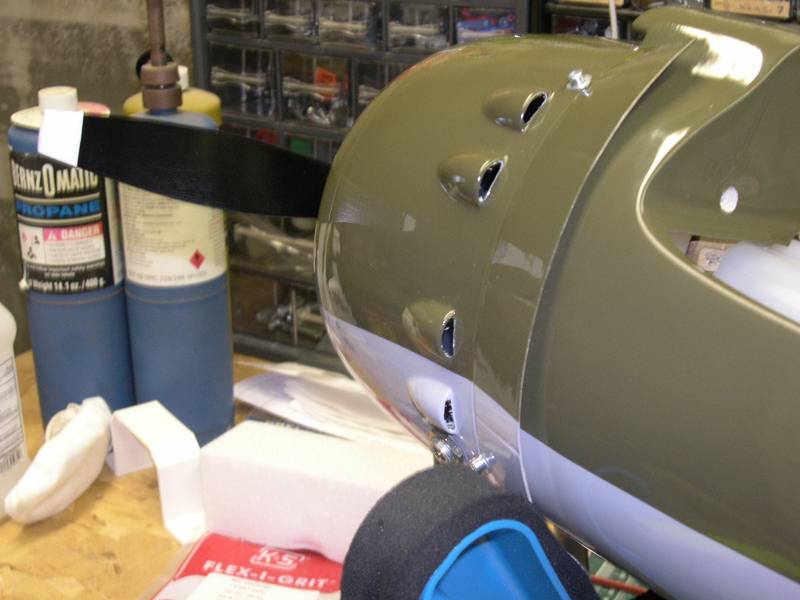

15) Cowl mods

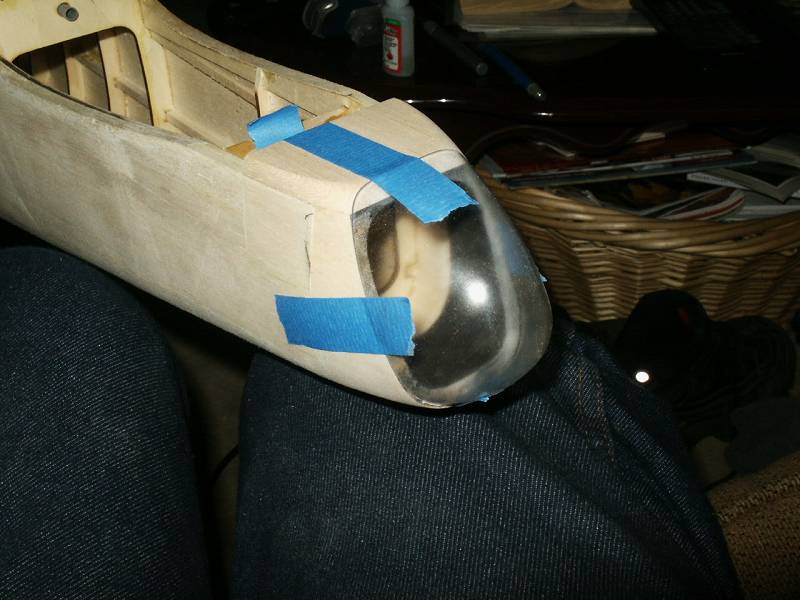

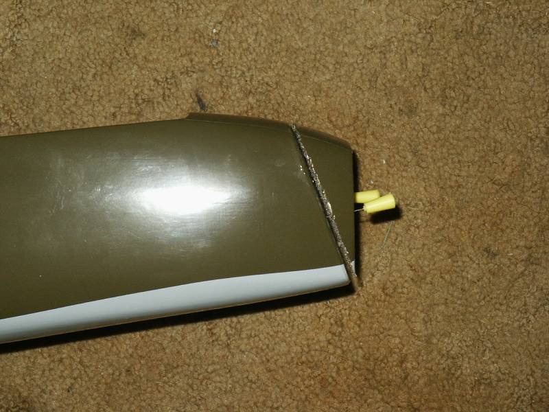

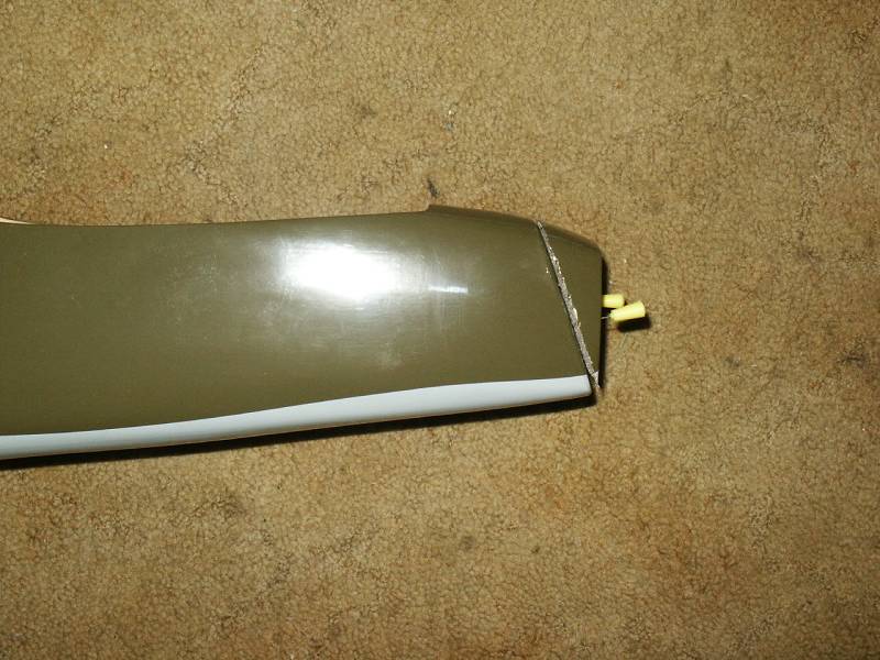

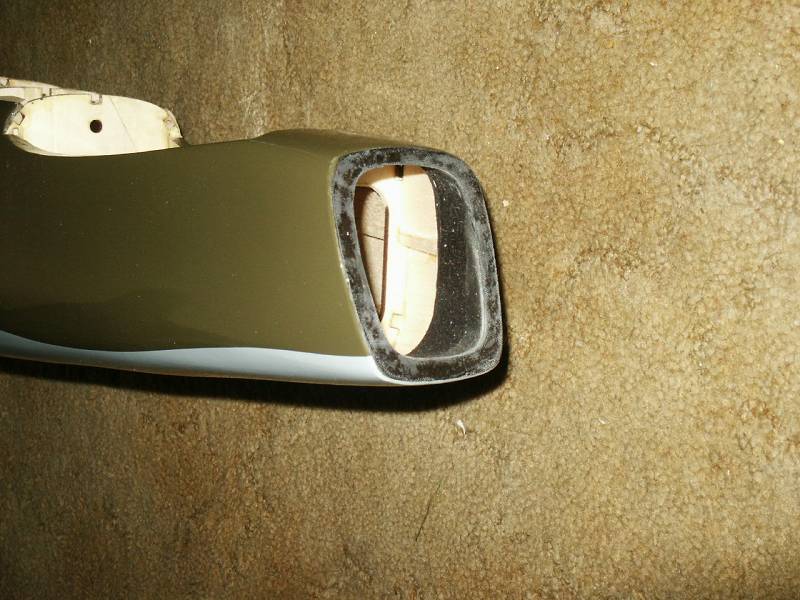

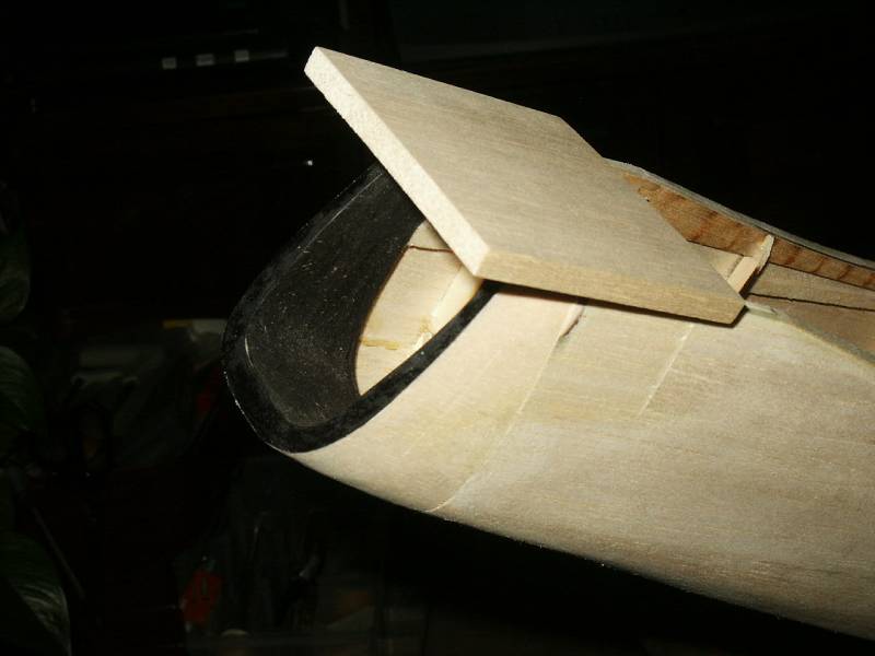

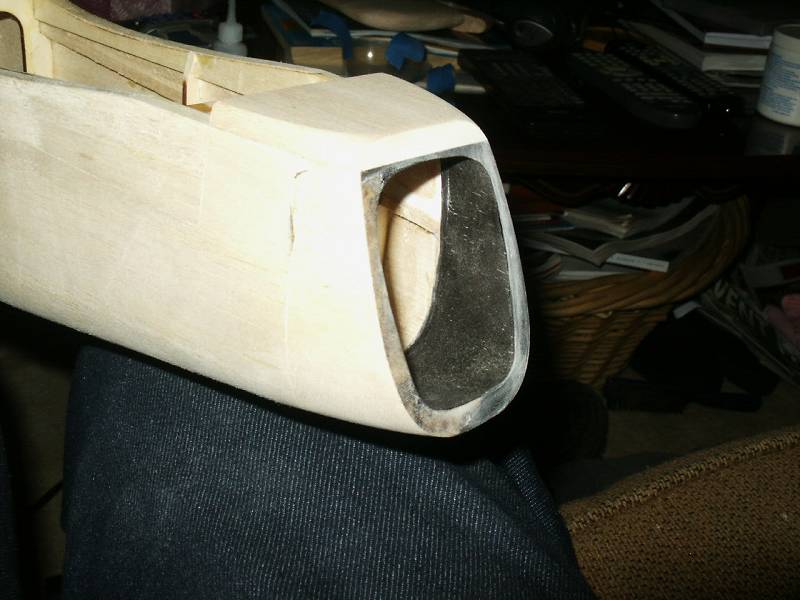

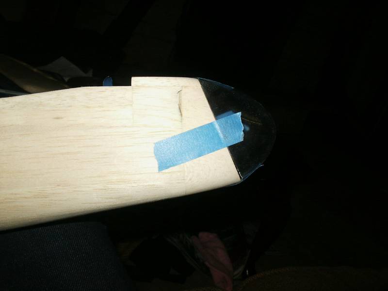

I intend to build mine as a B-25B/ Doolittle Raider. Since doing some research, I have discovered that the co-pilot of aircraft #14 (14th to take off from the U.S.S. Hornet), Lt. Jack A. Sims, was from my hometown of Kalamazoo, MI. That said: I intend to model mine after that #14 aircraft, which had the numbers "02297" on the tail.
Converting a B-25J into a B-25B (as flown by the Doolittle Raiders) is not that difficult. The most difficult step would be fabricating a tail-gunner/ tail-cone 'blister'
I have begun that process by removing some of the balsa block on the tail on my B-25, hollowing it out, and adhering 2 layers of .75 oz/ yd glass cloth to the 'former'.

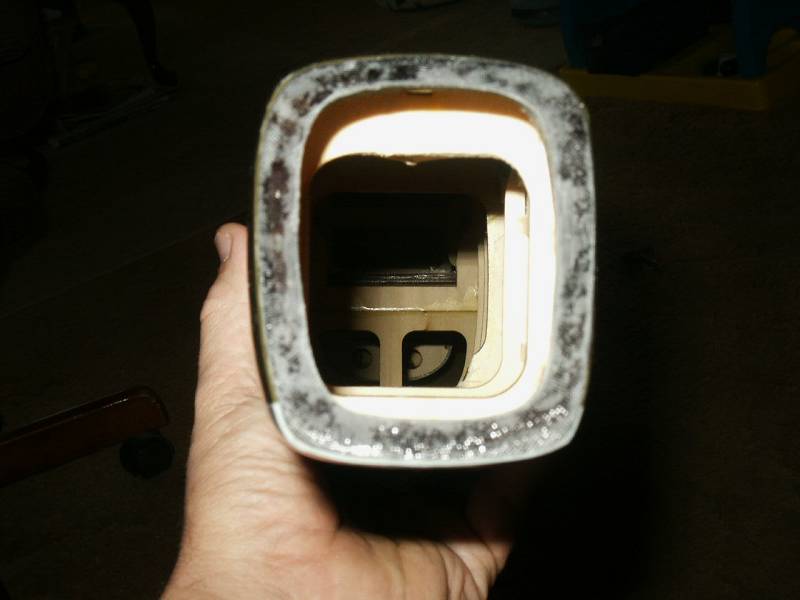

The 1st and 2nd pics show the part that I sawed off, held in position (with 2 pins) where it used to be attached to give a rough idea of how to saw it off.
The 3rd and 4th pics show the results, now waiting for me to fabricate a 'plexi-glass' tail-cone blister.
The 5th pic is an actual photo of one of the Doolittle Raiders while aboard the U.S.S. Hornet, showing the gun blister I intend to replicate. Note the absense of the tail-gunner 'greenhouse' which was located above the stablizer on later models (including the B-25J).
Actually tho, on the Doolittle Raider aircraft: these were not real machine guns. Jimmy Doolittle came up with the idea of installing broomsticks thru the plexiglass, painting them black (as well as the 'elevation slots'), to intimdate would be attacking Japanese fighters.

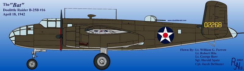

6th pic is a drawing of the #16 aircraft
For a follow up on this mod, go to post 21

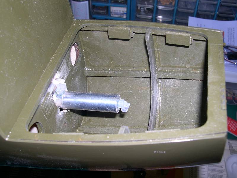

YES, I would like to be able to drop 4 bombs, as the Doolittle Raiders did. However, it looks like it will be difficult to drop 4, may have to settle for 2 (lack of room under the wing).

you can make a plug from balsa and heat clear plastic and pull her down to make the bubble. dont need a vacum forming device.
stick a dowl in the bottom of the plug and clamp in a vice then heat the plastic and pull! putting the clear sheet in a frame is better

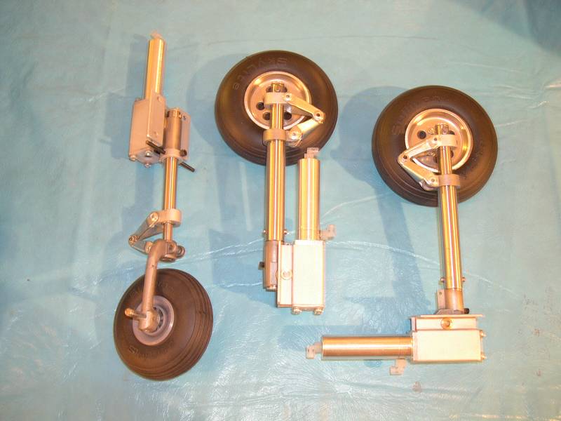

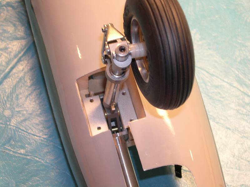

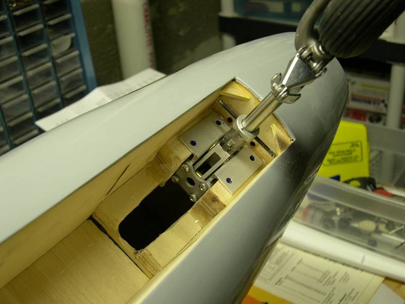

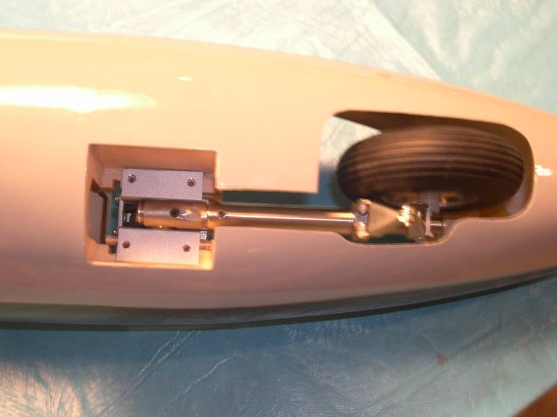

A few facts about this ARF: the full scale has a wingspan of 67 ft, 7 in, or 811". Adversized span ofthe H9 B-25 is 80.7", making it for all practical purposes: 1/10 scale.
I have determined thru measurements taken from a 1/48 scale plastic kit, and calculations that the correct scale wheel size should be about 4 3/8" dia for the mains, 3" dia for the nose. As the included mains are about 3 1/4" dia, I decided that I wanted to install larger (yet lighter) main wheels on mine.
I intend to install 4" mains on mine, and a 3" nose wheel on mine.
Doing so with the retracts that are especially made for this kit may cause problems, so I decided to purchase a set of Robart retracts and seperate RoboStruts so that I could cut the struts to correct length.
SO, I placed 2 seperate orders with Tower Hobbies (so that I could use $25 off coupon twice), ordering the "550RS 90 Degree Main Gear RoboStrut Ready" mains (which APPEARED to be the same ones that come with the B-25 retract kit), and a "560RS 105 Deg Nose Fire/Belly Mount RoboStrut Ready", as well as the RoboStruts
Main retracts arrived today, along with 1 RoboStrut.
Maybe there's something to be said for buying the retract kit made for this plane.
First off: those RoboStruts sure are a tight fit (even with paint sanded off) in the RoboStrut ready retracts. I'll have to cut them to proper length then force them in somehow.
Second: I ordered the wrong mains. The correct ones would be the 530 series mains, which are also known as reverse (so called because the cylinder is on the opposite side as the retracted strut). In other words: the cylinders are at the front part of the retracts, NOT the rear. The ones I have can be made to fit using 1 of 2 methods:
1) slight modification to the retract bays, involving removing some plywood. A spruce brace can be added later.
2) reversing the truinions on the retracts, alsth this may be more work than 1)
Either way, my advice is get the correct ones: the 530 series. They cost about $7 more a set, but will save building time.

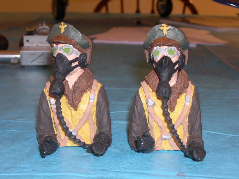

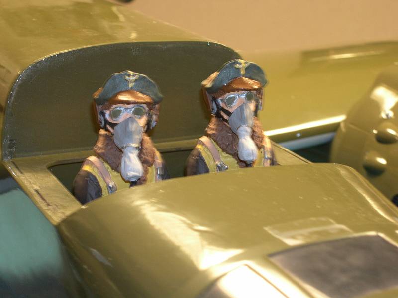

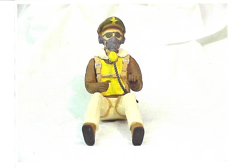

Ordered 3 H9 1/10 scale WW II US pilot busts from Horizon today: MAN are THEY EXPENSIVE! $9.50 EACH. Thats just shy of $30 for 3!
Williams Brothers busts are about 1/3 the cost, but they do not make 1/10 scale.

I started working on the engine nacelles and discovered that the vents around the cowl look pretty good when you open them up. They will also provide improved airflow through the cowl.

Here are the new Century Jet retracts for the B-25...this is a nice durable set of retracts for $365 and the kit includes everything. I threw the wheels on to get a little more pespective. Wheels are 3.50 mains and 2.75 nose. I also included the new bomber pilot busts that just came out. I know you already have purchased this stuff for your B-25 but I thought others might want to consider other options. These retracts are custom made for the H9 B-25.
Jim-
Here are pics of my CJ's ready to install. Had to build up mounting blocks to fit properly. Nose gear tank will share front compartment with SR 2200 ma flat battery pack. Also have started changing colors used on pilots.
Tim
Tim

1st order of business in the tailcone. I asked Dan Gipe (owner of Wing Mfg.) if he would assist me in producing a B-25B tailcone which could be used for the H9 B-25 as well as his Wing Mfg B-25 (which at 84" span is slightly larger). Turns out that Wing Mfg. ALREADY makes/ sells a B-25B tailcone, so the Wing Mfg. B-25J can be convereted to the B-25B. So, I handed $8 to him (list price) and he gave one to me. If YOU are interested in buying one of these, here is a link to the Wing Mfg. B-25 parts web-page, which has the blister listed (Part #PK1001-B):
http://www.wingmfg.com/Pages/WingPL1.html
Now for the hard part: that tailcone does NOT match the contour of the H9 B-25 tail. Probably the Wing Mfg version is more true to scale. In particular, in order for the Wing Mfg. tailcone to work on mine, I will need to:
1) round the bottom of the fuselage more (only at the extreme tail end of the fuselage).
2) flatten the top of the fuselage to match the aft of the horizontal stab .
3) Make the sides parallel (again, only at the extreme tail end of the fuselage).
To accomplish all of that: the covering will need to be removed in that area. Oh well, I had already decided to recover the entire airplane with FLAT covering (CoveRite flat olive and flat dove gray).
The covering has now been removed, and I am ready to begine sanding to the correct shape. NOTE: you do NOT have to remove ALLof the covering as I did for this mod: it is only necessary to remove the fuselage covering from about the elevators aft.
The 1st 3 pics show the tail without the clear tailcone. The first 2 show after intial sanding, and a piece of 1/4" thick sheet has been added to the top of the fuselage (AFTER sanding the top slat/ removing the top sheeting there). The 3rd shows after sanding the newly installed 1/4" sheet to match the contours of the rest of the fuselage.
The last 2 pics show the clear tail cone taped on, to show how it will look. It is barely visible in pic 4, but pic 5 shows it to good effect.
There is a lot of work/ sanding involved in this mod in order to make the Wing Mfg. tailcone fit properly. Some of you may find it easier to just make your own tailcone, to match the contour of the H9 B-25. Personally tho, I was not looking forward to fabricating the tailcone, and I am glad that Wing Mfg offers one, altho it IS a lot of work making it fit right. The tailcone itself also had to be sanded quite a bit to make it fit.
