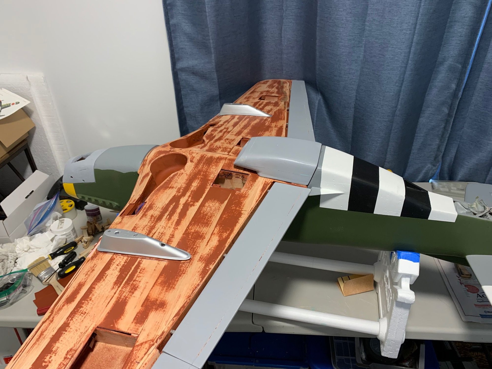

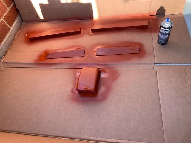

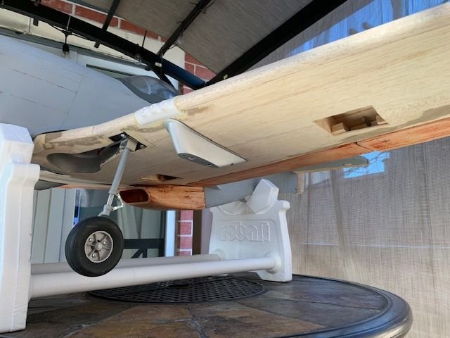

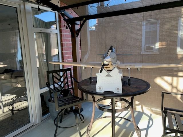

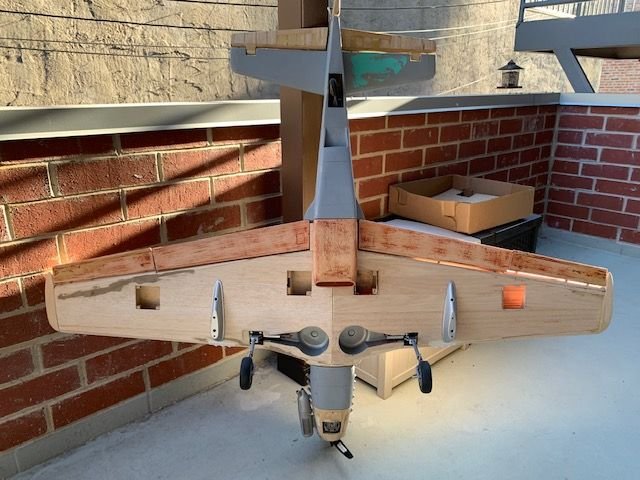

Another small update:
I glassed and primed the control surfaces and air scoop. I will add spot putty next followed by some more filler primer
. I also worked on the wing and attached drop tanks (actual drop tanks not pictured). They're off a Hangar 9 P-51 20cc ARF. They're not exactly flush, but they work.

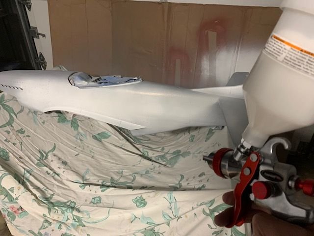

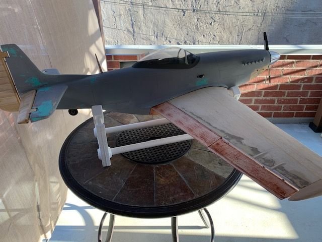

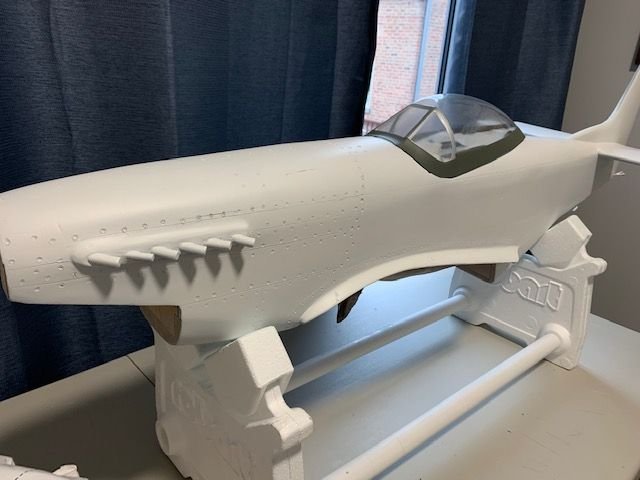

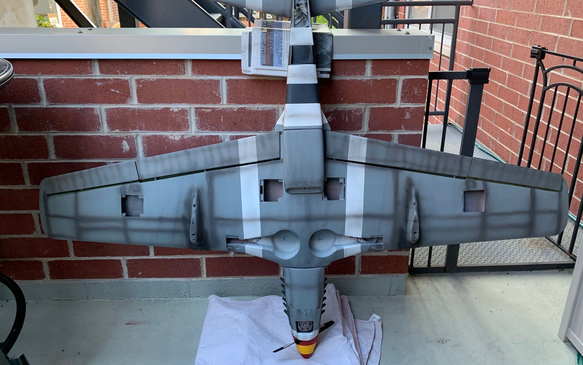

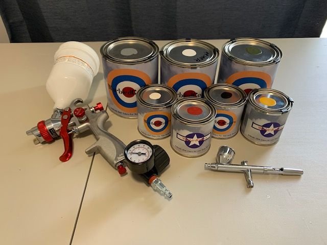

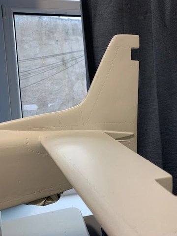

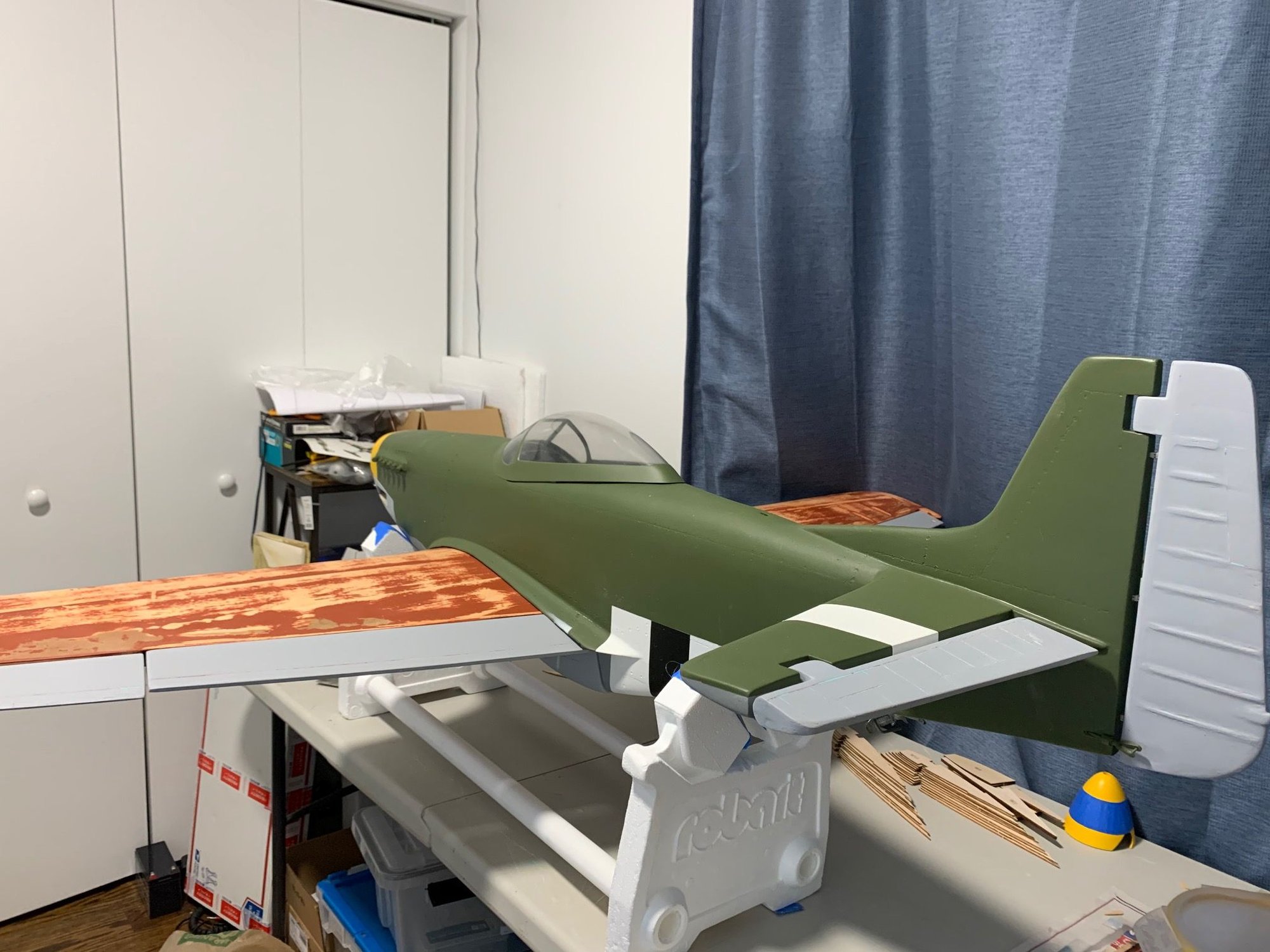

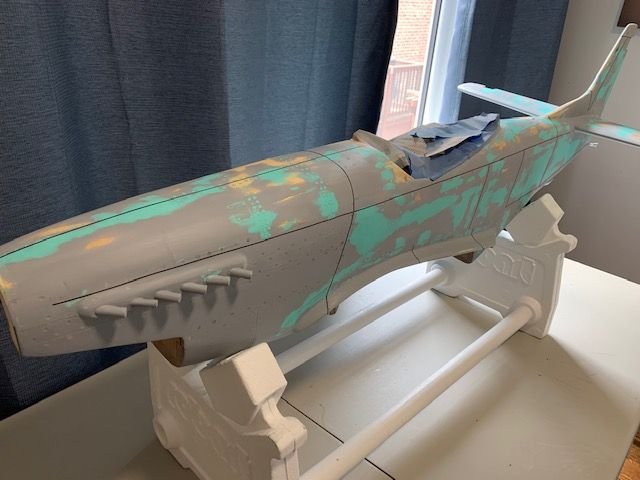

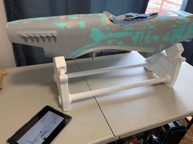

I put the wing aside and focused on the fuselage. After all, it deserves a new coat of paint after 11 years!
My Warbird colors came in and I decided to slap on the primer after a final sand, panel line adjustment and rivets.
The colors:
Dark Green 34079 - Fuselage
Medium Sea Grey 36270 - Under fuselage
Orange Yellow (aka Insignia) 33538 - Nose
Insignia Red 31136 - Nose
Insignia White 37875 - Invasion stripes
Flat Black 37083
- Invasion stripes
My target look:
Final sanding + rivets:
Panel line touch up:
Primer added:
Final starting to come to life:
Next up is to mask off where the invasion stripes with will be and add panel lines to control surfaces.

Where did you order the war bird colors from?
Old 05-03-2020, 01:31 PM
  #57
7aso
My Feedback: (27)
7aso's Avatar
Join Date: Apr 2005
Location: Chicago. IL
Posts: 302
https://warbirdcolors.com/

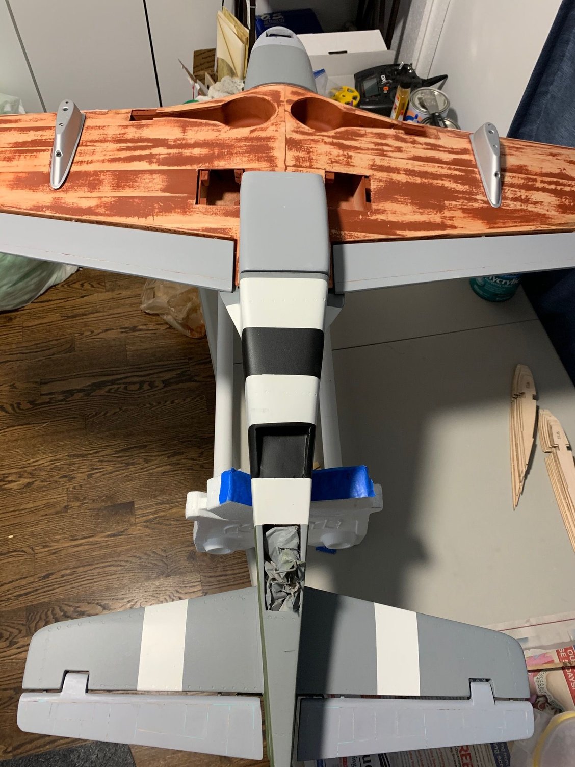

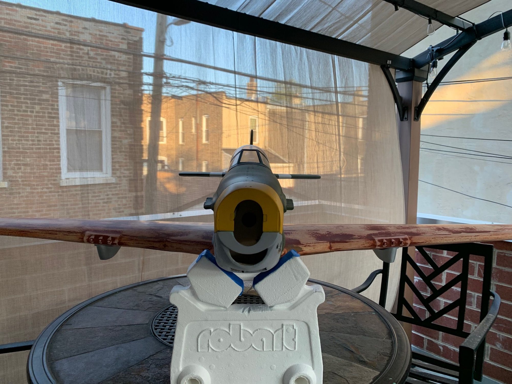

Fuse painted. Control surfaces are next followed by the wing
A few more touch ups and the checkered color nose
Old 05-12-2020, 04:58 PM
  #59
7aso
My Feedback: (27)
7aso's Avatar
Join Date: Apr 2005
Posts: 302

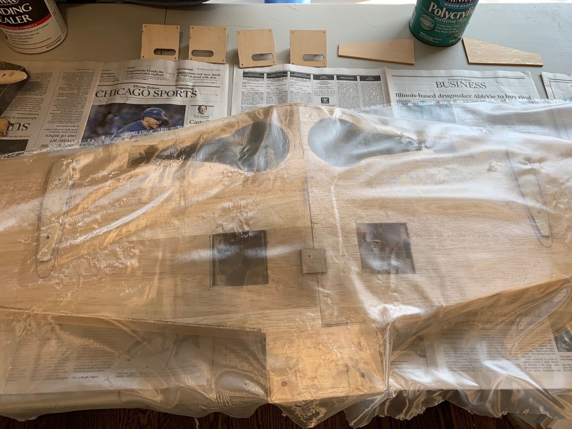

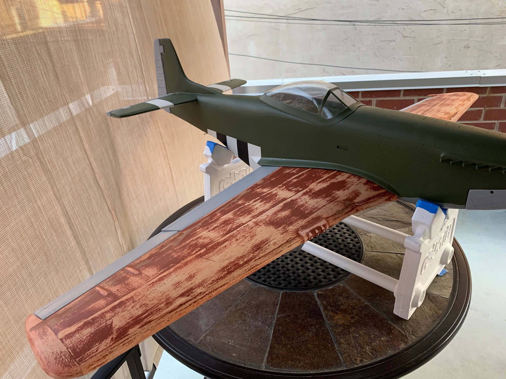

All control surfaces glassed, added panel lines and primed for final paint. I tacked them on just for photos.
Wing has also been glassed.
It's finally starting to come along:
I slapped the canopy on just for looks. I still need to work on the cockpit before I glue it on.
The wing still needs a lot of work. Spot putty will be added, primed, sanded, primed again and then final paint. Weathering is the final step, but that's still a while to go.

3M spot putty added on this rainy day

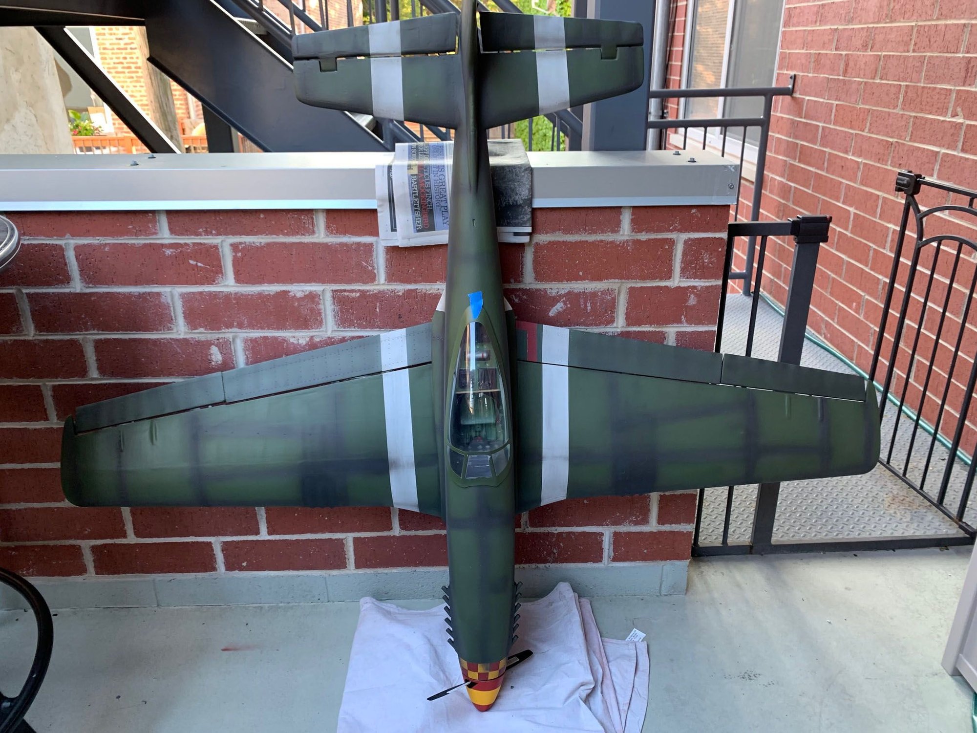

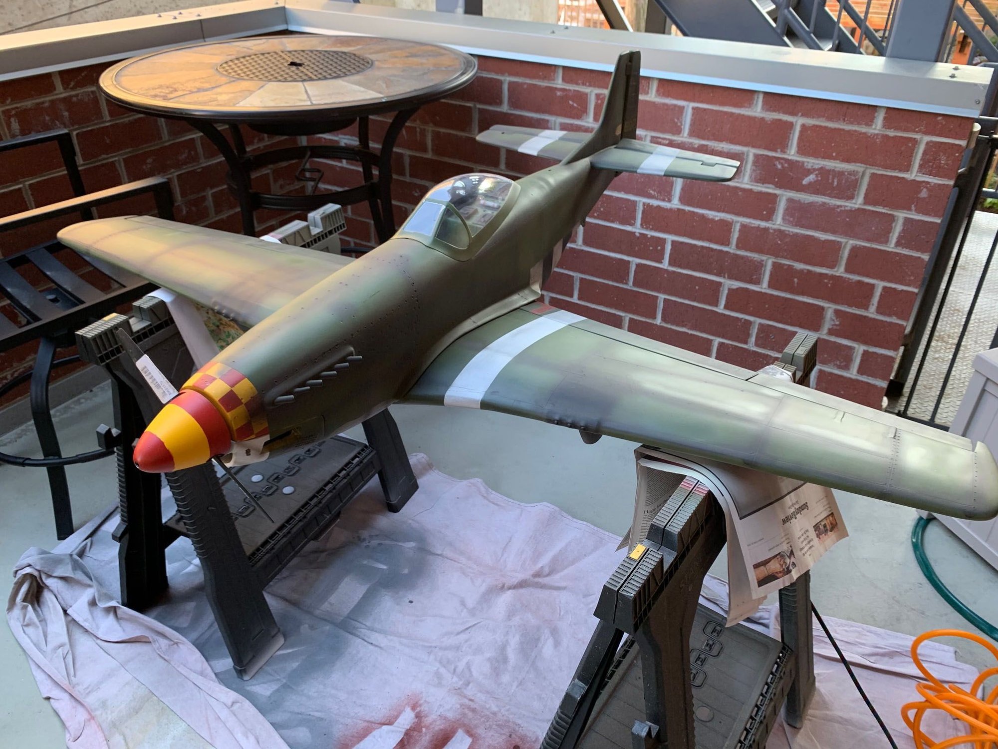

All paint done except lower nose. Checkerboard painting and masking is very time consuming.
Weathering is next!
Old 05-22-2020, 04:32 PM
  #64
7aso
My Feedback: (27)
7aso's Avatar
Join Date: Apr 2005
Posts: 302

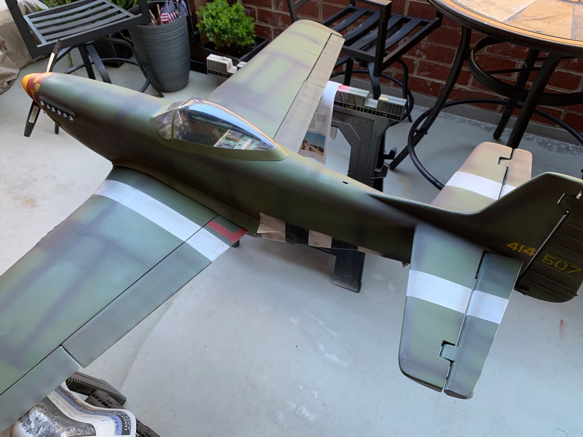

Weathering complete. Maybe a few touch ups here and there, but overall it's ready for the dreaded water decals.
I still need to complete the lower nose and work on the cockpit.
