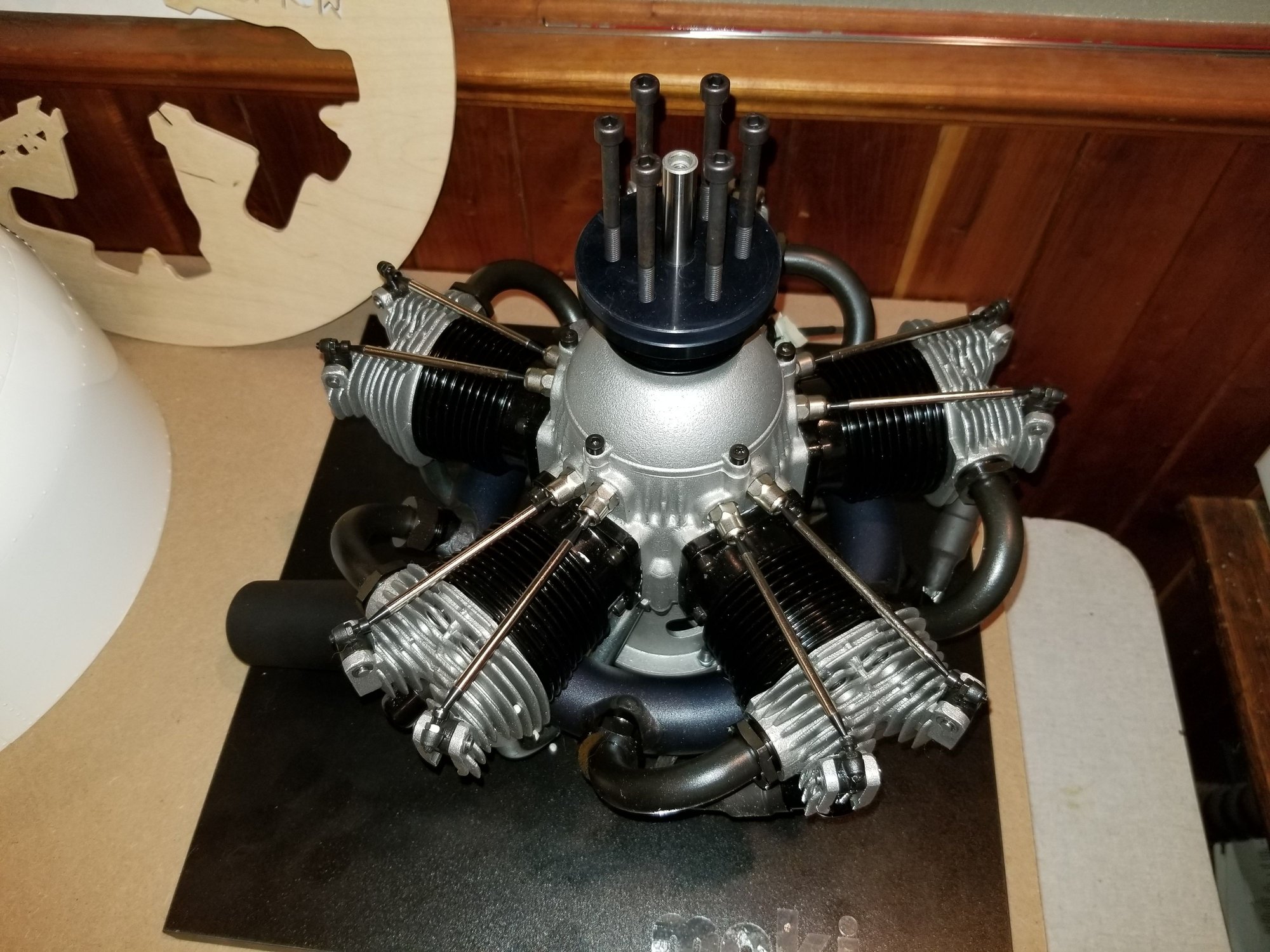

Question regarding fuel pump setup - after installing fuel pump I removed tube from air pump to carb bladder and installed a festo cap (see picture). Question is, what to do on carb end?
Attachment 2264027
I plugged the carb hole with a short 4 mm screw. Left tube open from the air pump. Very little grease leaking from the open tube. No problems after many hour of run time.
J Tab

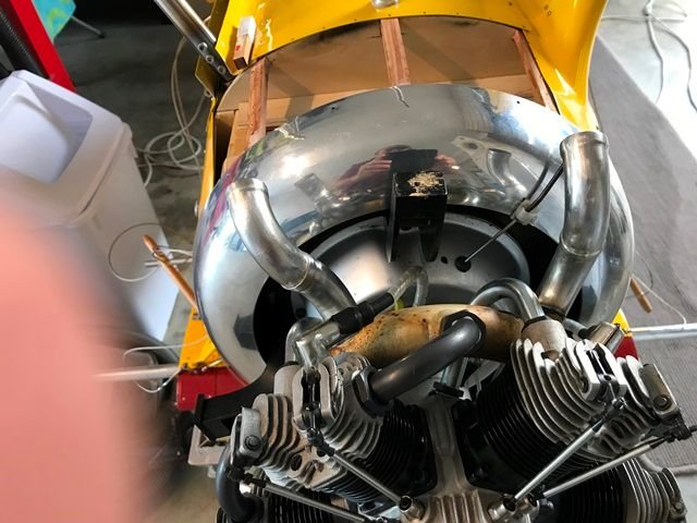

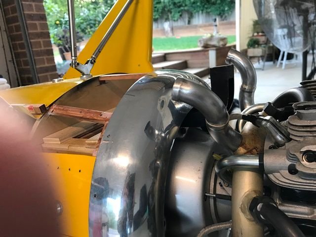

What is the best way to get an exhaust extension to stay put!!
tmac48.
Old 05-14-2019, 11:12 PM
  #4255
tmac48
tmac48's Avatar
Join Date: May 2006
Location: kangaroo flatVIC, AUSTRALIA
Posts: 584
tmac48.
Made these stainless
extensions and then realized that the collector ring is Alloy! What is the rest of the Moki owners doing for extensions. I found that the clamp on flex extensions kept coming loose and they eventually just broke off!
Regards tmac48.

Decided to use the clamps that came with the flex pipes, silver soldered to the stainless extensions, looks ok but just hope they don't come loose !

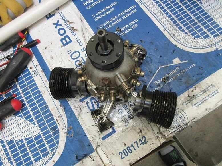

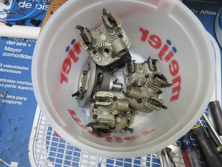

My Moki 300 damaged after only six flights!
Just after landing of the last flight it stopped suddenly. Trying to restart later it stopped after a short run with loud mechanical noise and is now blocked. The prop can not be moved anymore.
Is here anybody else with Moki 300 problems ?
Old 06-13-2019, 10:27 AM
  #4267
samparfitt
My Feedback: (43)
Join Date: Sep 2002
Location: West Chester, OH
Posts: 6,934
Bummer,

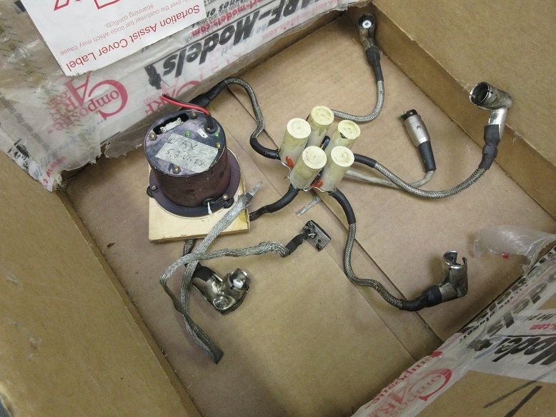

Last Fall, I lost my carf corsair after 8 years. Never had a gear up landing or a dead stick in that entire time. Balsa gods put an end to that!
Moki 250 not worth rebuilding so saved all the good parts.
Anyone interested in parts, email me.
thanks.
[email protected]
Couldn't get two damaged heads off so left them attached to the center mechanism.

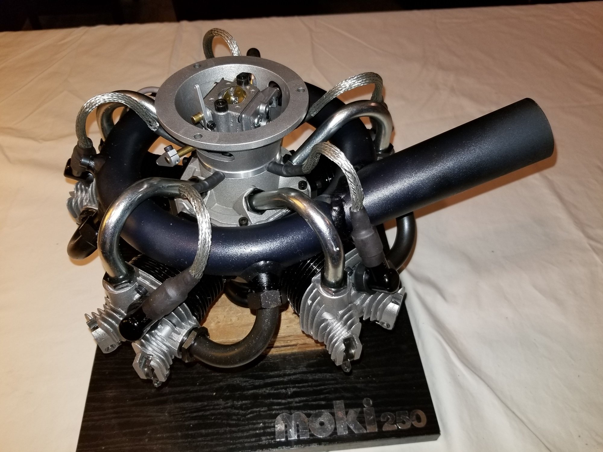

Reason #1 for using a fuel pump with the Moki Radial Engine.
I was adjusting valves on my new 250 today and noticed how much grease had collected in the air pulse tube.
Fortunate for me I use a fuel pump with the Moki.
Regards - Jaketab
