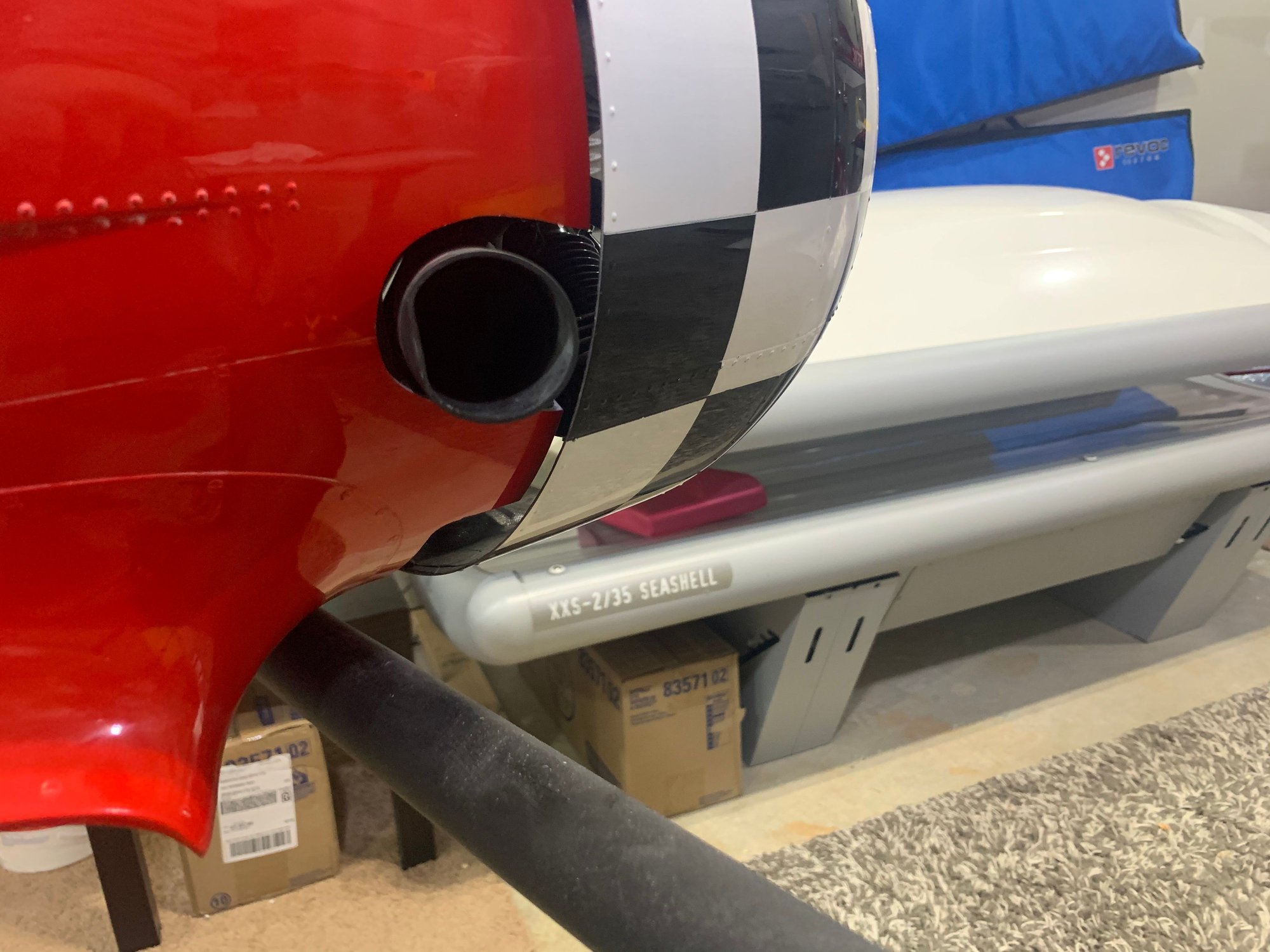

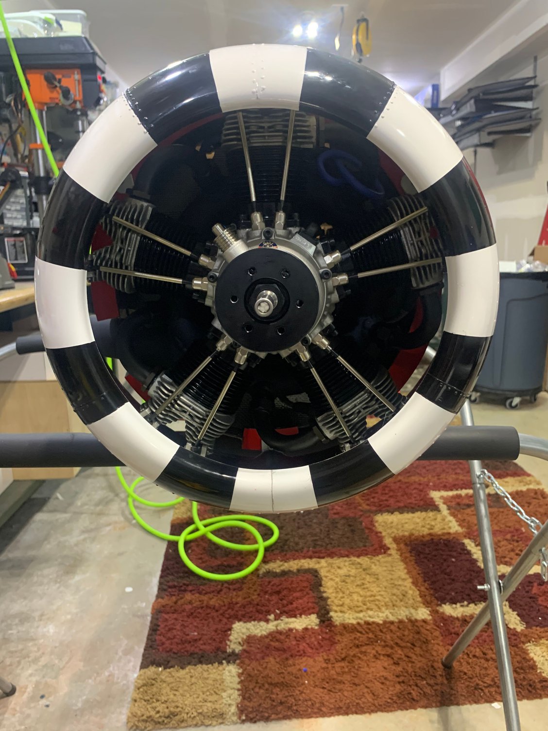

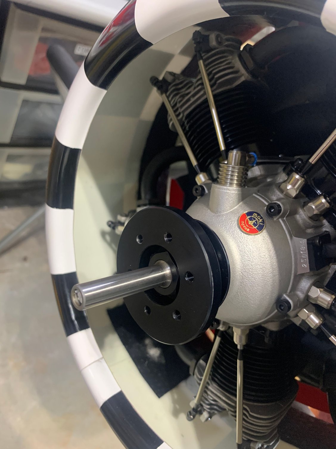

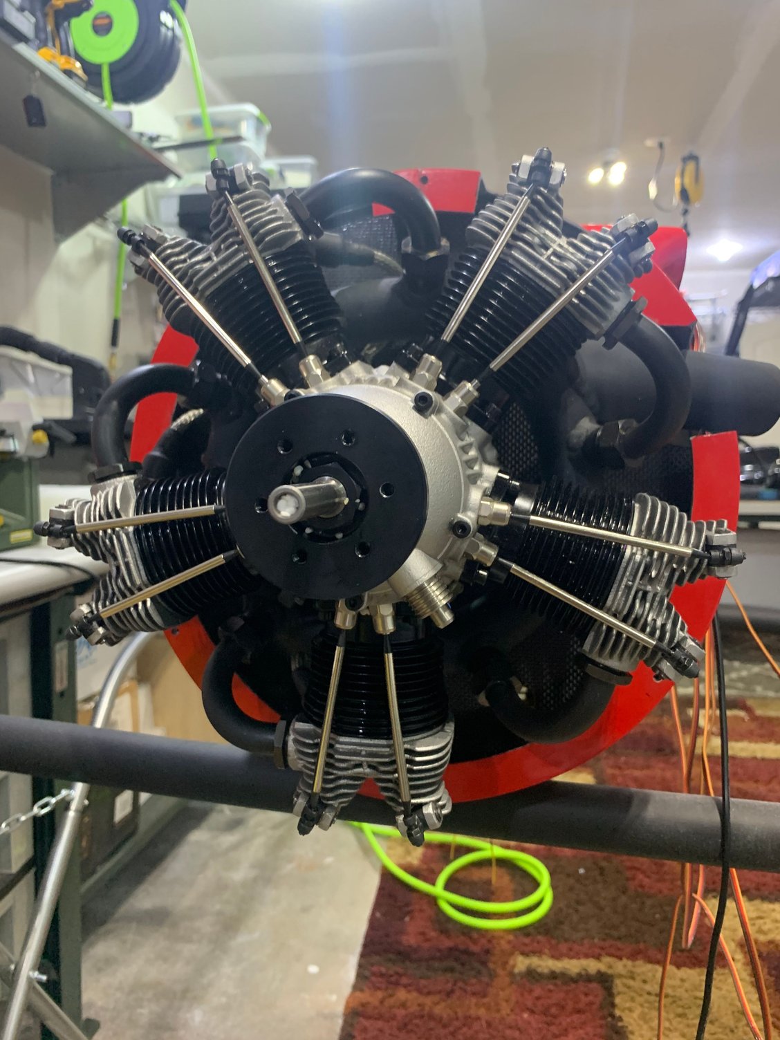

Hey everyone, first Moki build for me, on a CARF AT-6 Texan.
Anyone have any photos of how they mounted the Power box temp sensor to the motor? I assuming someone has to have done this..haha

MOKKEN,
Does your CARF Harvard AT-6 Texan look anything like this ? LOL

Yep! Looks good!
