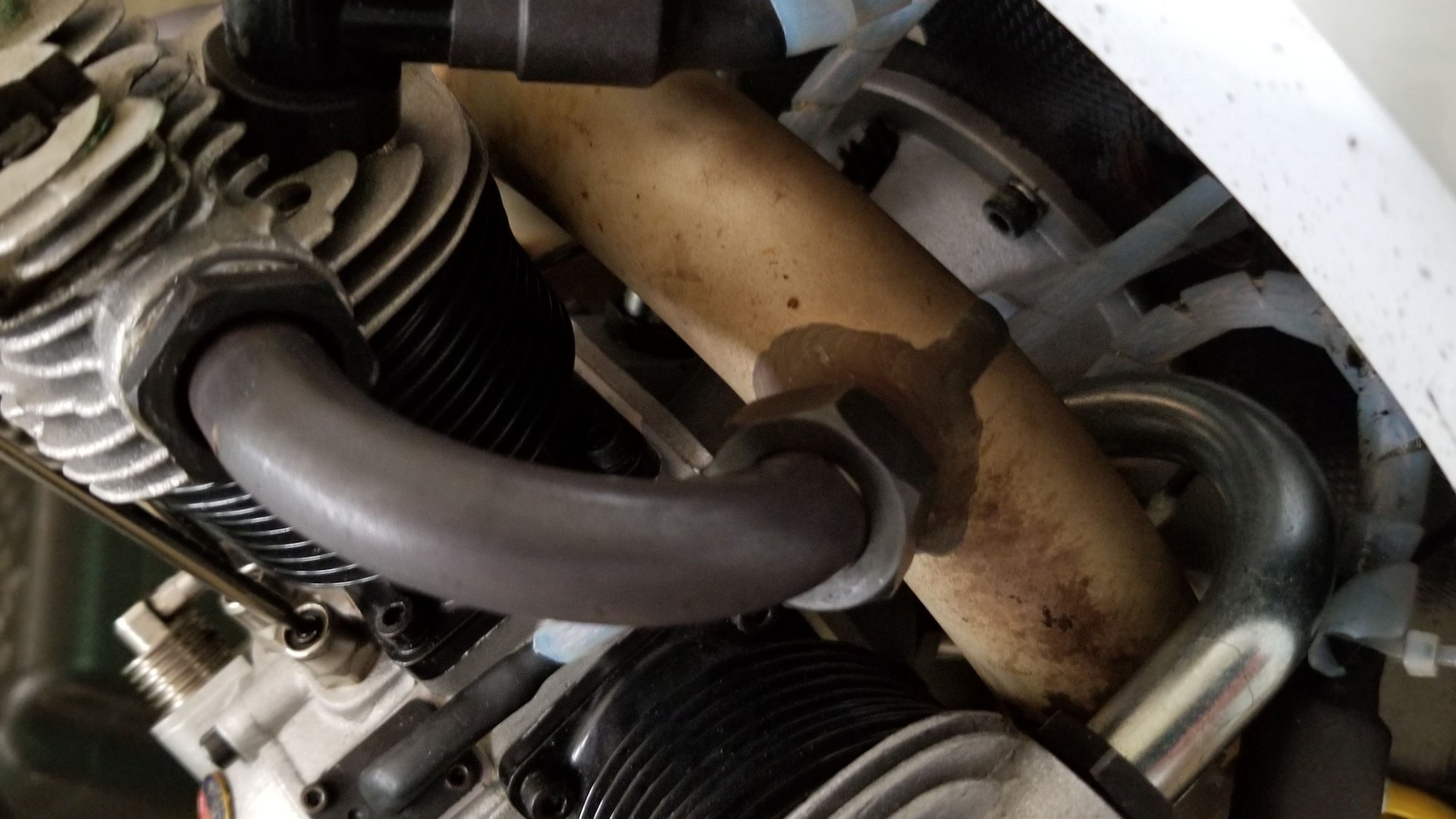

Default Exhaust Tube Nuts
Need help or suggestions on keeping the exhaust manifold nuts from getting loose on my newer Moki 250. (AT-6 exhaust version) Im guessing others may be having the same problem. The engine was purchased last May and has ample time that the nuts with the Teflon washers should have seated just as my older Moki has. The older Moki is essentially problem free and rock solid. Last year the (new Moki 250) exhaust tube nuts backed off during a flying session and caused the tube flanges to break off on the engine side. New exhaust tubes along with the Teflon washers and copper crush rings were replaced under warranty. It takes about 10-15 minutes of run time for the nuts to back off enough to cause the collector ring to move out of position. I've been careful not to overtighten the nuts and deform the Teflon washer. Has anyone had success with thread locker or thread sealing compounds ???
Old 05-04-2020, 01:46 PM
  #4372
tmac48
tmac48's Avatar
Join Date: May 2006
Location: kangaroo flatVIC, AUSTRALIA
Posts: 585
I do not the answer, I need to tighten mine after every 10 min run,the Teflon is squeezing out from under the the nut! Can't see lock- tight or anything similar working on exhaust.
Tmac - I discovered that tightening the nut when the motor is hot will cause the Teflon to deform and squeeze out the back side of the nut.
Tightening on my motor requires removing the cowl. PITA.
Taking a wild guess, could it be that Moki has changed to a softer grade of Teflon washers ????
I found some Teflon rings on the McMaster-Carr website. They list a hardness of 50D Durometer and rated for 500 F.
Regards - J Tab

My 250 has been flying for 8 years with over 100 flights. The Nuts still loosen up regularly. Not sure how you got your older one to stay tight, but whatever it was I would suggest you do the same!

I can run mine in the back yard for three minutes, next day I will need to tighten them up again, not sure how long i will be able to keep doing this before there is no longer any of the Teflon left!
