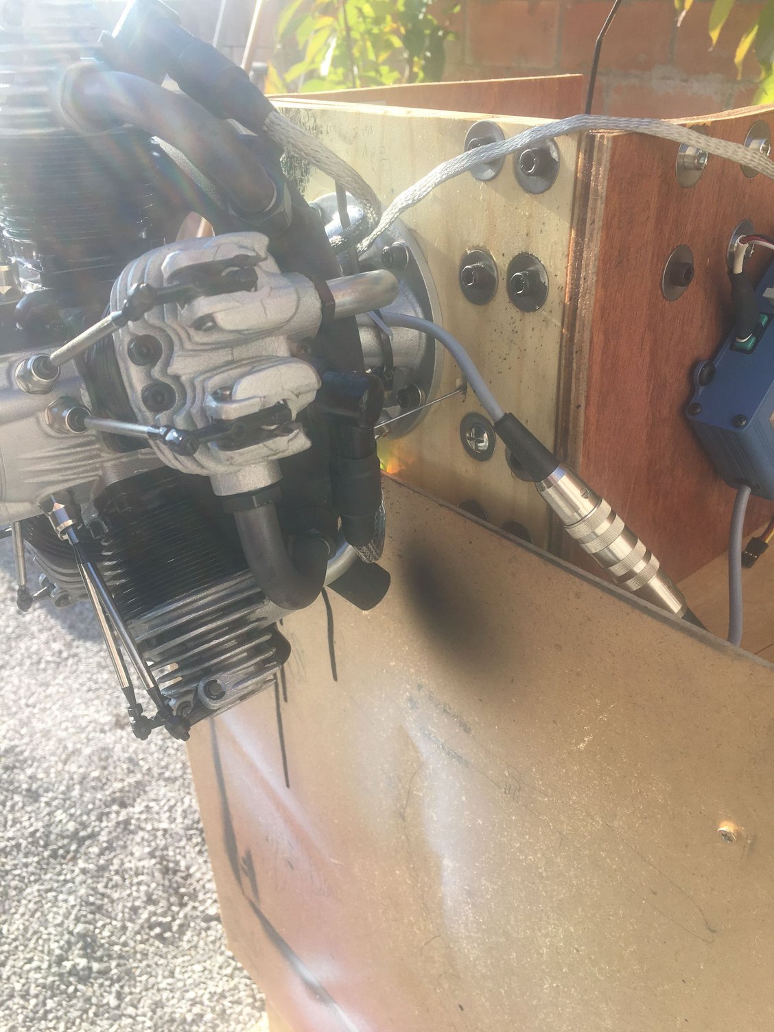

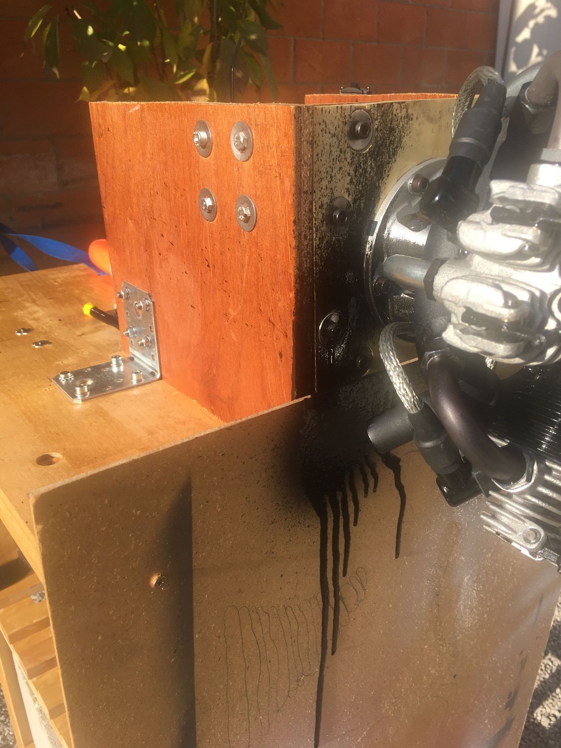

Hello,
i managed to start for the first time my 180s on the test stand. It took me a while to understand that it wanted a bit more throttle to start.
I have couple of findings that i would like to share.
The response of the throttle was slow with white smoke coming out of the exhaust. I have already made the throttle servo slower than normal. I do not know to what speed i should go.
I have leaned the Low needle and the response improved but still i needed to manage the stick a bit slower than the servo speed. The Low now is at 1rev from completely closed.
The idle revs are quite high i think at 1500RPM with the throttle completely closed.
The temperatures from the cylinders are about 120C except the number 3 (counting anticlockwise) which shows about 80C to 90C.
You can see at the photos that the exhaust side close to cyl 3 spits a lot of oil although the right one (when looking from the front ) seems normal.
I would appreciate any feedback since i am rookie on this kind of motors.
Thanks in advance,
Lawrence

Tziger,
A few tips I have learned over the past 9 years with my 2 Moki's.
1. Proper oil and ratio at 45-50/1. I use Amsoil Dominator.
2. Number 3 is always slow to come up to temp. Leaning the low side needle is mandatory. I tune while the engine is running. With engine running at slow idle, lean the low screw until the rpms drop, then open until you get the fastest idle speed with good transition.
3. The exhaust manifold nuts to the collector ring will work loose when the engine is new. Never, never, never tighten the nuts while the engine is warm or hot. Only tighten the nuts with minimal torque. The Teflon rings take some time to fully seat. Overtightening them will cause the seals to deform.
4. The black oily exhaust residue should cease after about 1 hour of running in.
5. Only run the motor for short periods on the ground to prevent overheating. Baffling and proper exit air in the cowl is a must.
6. The Moki is very responsive to the throttle input. However, slow the throttle with your transmitter to prevent slamming it open and closed. Much better for the engine to open and close the throttle slowly.
7. Did you remove the idle stop adjustment screw? It may be preventing your throttle lever from going closed all the way. The Moki will have a reliable idle at 1000 or less.
8. Lots of good tips in this forum, but different things work for others.
Regards - J Tab
