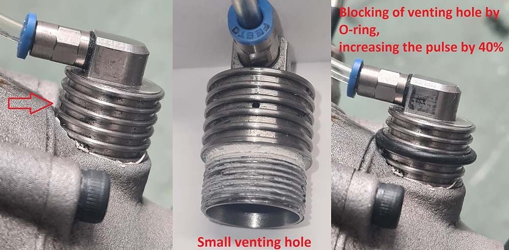

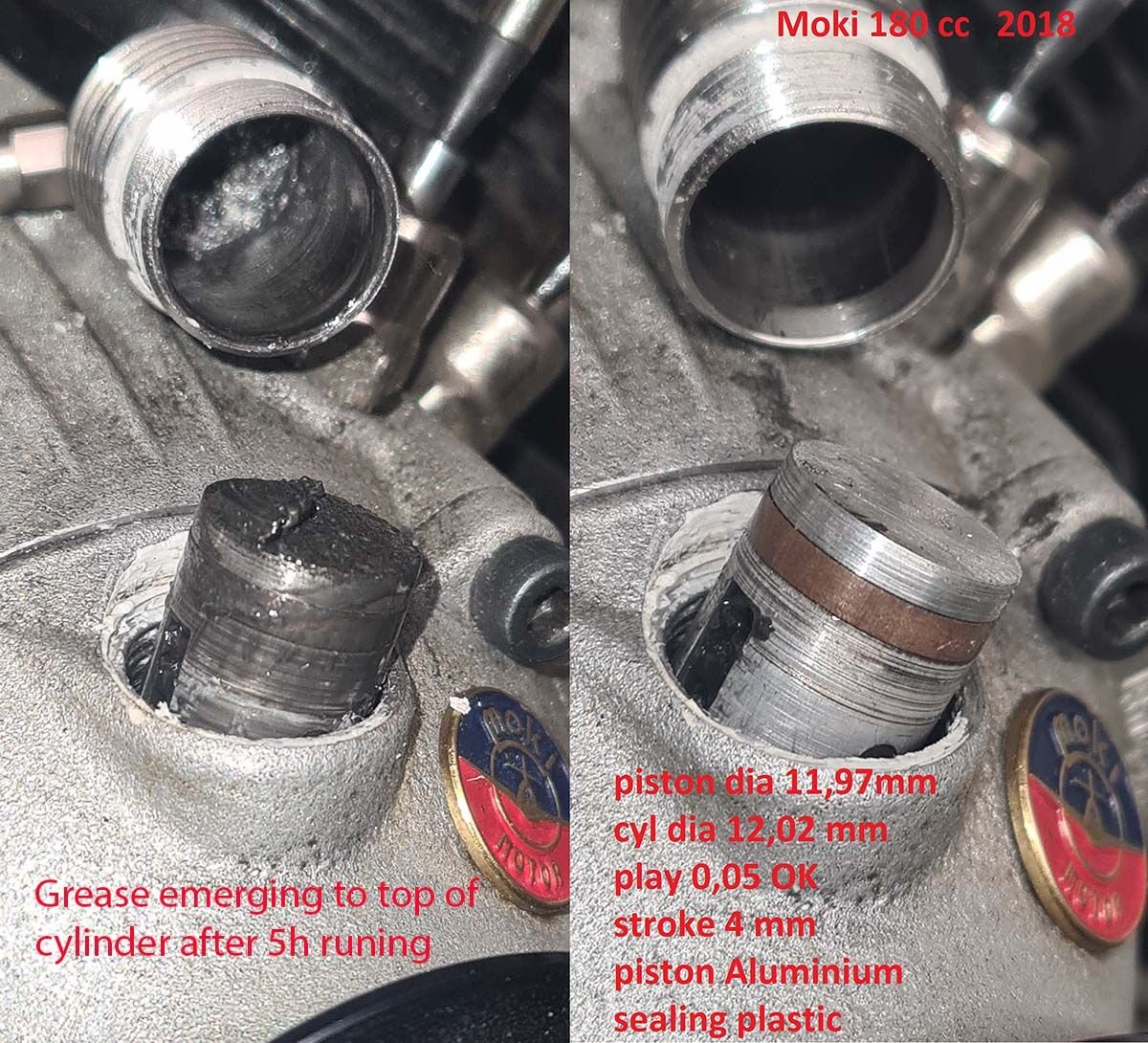

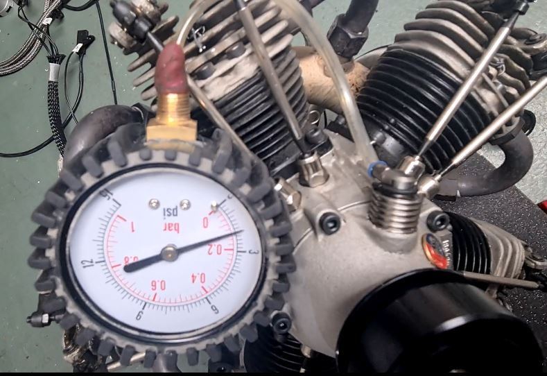

Hi, I would like to bring up the Moki “Pulse pump” topic for us who relies on it to drive the built in Walbro fuel pump. (using no electric pump or pressure system)
While doing my annual winter maintenance on my 180 Moki, I tested and disassembled the “Pulse pump” which have been running for 6h total.
It is important to know that it is working properly, so I think it is a good thing to test it’s performance regularly.
I took out all sparkplugs, disconnected the 3mm tube going to the carb and attached it to a 1Bar pressure gauge and run the prop shaft at slow rpm by a cordless drill machine on low gear.
And I could se it created pulses (+- 0,06 Bar up/down)
If you don’t have a gauge you could put the hose against you tongue, and feel a distinct air pulsating.
I disassembled the pulse pump to measure its cylinder-piston gap and clean out grease from top of piston. (so far no grease was visible in the hose)
The piston gap was, 0,05mm which should be ok, but there was a lot of grease on top of the piston, which is the weakness of this design, grease from cam area emerging up to top of piston, finally blocking the pulses to carb (this design could probably be improved by a better piston and sealing design)
I wish they had mentioned this cleaning, in the manual as a point of maintenance, ( se my image for amount of grease collected after only 6h)
While cleaning the pump house I discovered a small hole! bleeding out air and reducing the pulse strength!
I cannot figure out why this hole is there (maybe blead out grease?), are there anyone who know the purpose of this hole?
I could not resist blocking the hole, by a O-ring in the groove, and run the engine with the cordless drill and the gauge attached, and could see that the pulse strength increased by 40-50%
To around +-0,1 Bar up/down
I will test this in the air next season if not anyone comes up with a good reason not to block this hole.

The little hole is for venting. It improves the function and avoids building up pressure in the gerarbox. Pressure would help grease to pass the piston.
Early engines did not feature this.
Do not change it.
PS it was high time to clean the pump!
Do not change it.
So regarding the early engines without hole, What was the problem they wanted to solve by adding this hole? Because this hole makes 2 negative things, excess grease on top of piston and 40% less pulse efficiency. (this venting hole is placed above the piston head, at bottom dead center, so about half of the pulse goes to waste)
If the cam gearbox needs venting why not a separate venting arrangement.
PS yes I was glad I took it apart, I did not expected that much grease only after 6h runtime..

Posts: 32
Originally Posted by Detlef Kunkel View Post
Robert,
this conclusion of yours is not correct.
Just want to explain my 3 statements above further, and still, to me it is not clear why they added this hole!
-The hole in the pulse pump cylinder is just above the pulse piston head at bottom dead center, the stroke is 4mm, the hole reduces the effective stroke to 3mm!
-The 40% pulse reduction is from a reduced pulse stroke, and it is measurement with a pressure gauge, it can clearly be seen the difference with and without hole! (motor is run by an power drill at about 200 rpm)
-And regarding the excess grease coming out on top of piston is based on two situations.
Firstly the hole; your statement that there was a overpressure in the cam area that needed to be vented out, which would lead to a flow of grease and air taking this path ..? (if there really is a overpressure in cam area it seems better to went it out elsewhere.)
And the secondly; The piston has a play and there is a pulsating negative/positive pressure in the pulse cylinder, ant that by itself would also pull up grease.
It would have been an quite easy thing to design a better piston-sealing arrangement than the existing, using modern sealing rings, why not make it right from the beginning! Then the Walbro built in pump would have worked perfectly at all time!
But in the end, its quite easy to unscrew the pulse cylinder now and then to remove the grease… if you know about the grease..
Still I wonder why Moki added that hole in the pulse cylinder, which problem did they want to solve?
PS I also like the idea with cam lubrication by oil, In my latest design of a 2 cyl boxer I put the camshaft in a sealed compartment half filled with oil, works well.
it is also about the absolute pressure in the pulse line. Without a vent hole acting in the direction of the pulse line, pressure or vacuum can build up. One of the butterfly valves then works worse and worse until it no longer opens.
PS from 4 to 3 mm is minus 25%, not minus 40.
Better to have 75% working instead of 100% in a more critical situation.
This evolution of Moki makes absolutely sense in everydays use..
No you are wrong, the pulse pressure never reaches the butterfly valves, it stays in a separate diaphragm chamber
Also the 3 and 4mm 25% is from caliper measurement and the 40% is from pressure gauge measurement, I don't know why they don't correlate, but the sinus function is involved here.. crank movement..
Last edited by Robert-H; 12-17-2021 at 04:48 AM. Reason: After close investigation of the carb.

Originally Posted by tziger View Post
Hi Robert,
I know that the existence of the hole is to avoid a hydraulic lock in case the small cylinder becomes completely filled with grease. I would not block the hole. There is an explanation earlier in the thread from Stuart Mckay.
In case of an hydraulic lock there will be a carnage in the cam area.
BR,
Lawrence
Ok, actually once I saw a small pile of grease in the area where the hole are, but at that time I really newer understood where it came from, I'll search for Stuarts thread.
Still, this hole to me appears like a quick dirty fix, instead of designing a proper piston and sealing, that don't leak anything from below and if there are a overpressure in the came area vent it out elsewhere.
Hi Robert,
BR,
Lawrence
A hydraulic lock in a cylinder that is constantly open at the head ( leading to the hose to the carb?)
This is not a four stroke cylinder where the valves are closed any second rev.
anything that passes the piston is fed to the carb, I do not see a locking chance there. The diaphragm in the carb would suffer, but it is soft and not solid enough to cause the piston unit a damage.
This system works like it is. I do not say well.
In my eyes it works at the mimimum limit and that is no good, but it works if you keep a constant eye on it and check and / or clean it every few flights
the given space is limited and does not allow much to increase the capacity mechanically and significantly. We will not discuss that away.
I stopped thinking about the pulse pump long ago. If you see what Mr Walbro was facing when he createt the internally fuel feeding layout, he had the massive pulse of a 2-Stroke crankcase at hand.
Such a small ( or a bit bigger) pulse piston is miles apart from that and will always be.
Luckily, there is a pretty easy alternative; the use of an electric pump.
It is so easy to get rid of this dangerous issue, hard for me to understand why so many people have a problem with that. The prefer to operate expensive engines at the lean limit.
Many comparable engines are supplied with an e-pump today when they leave the factory, or al least the manufacturer recommends the use.
Nevertheless, this topic keeps on filling forum discussions. Immortal little favorite.
