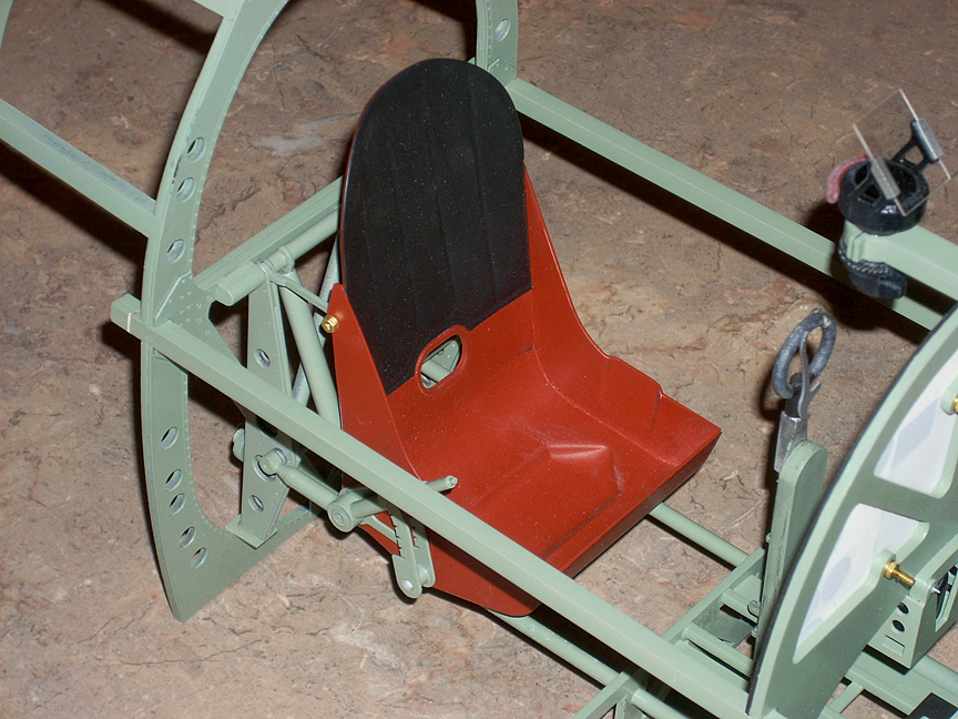

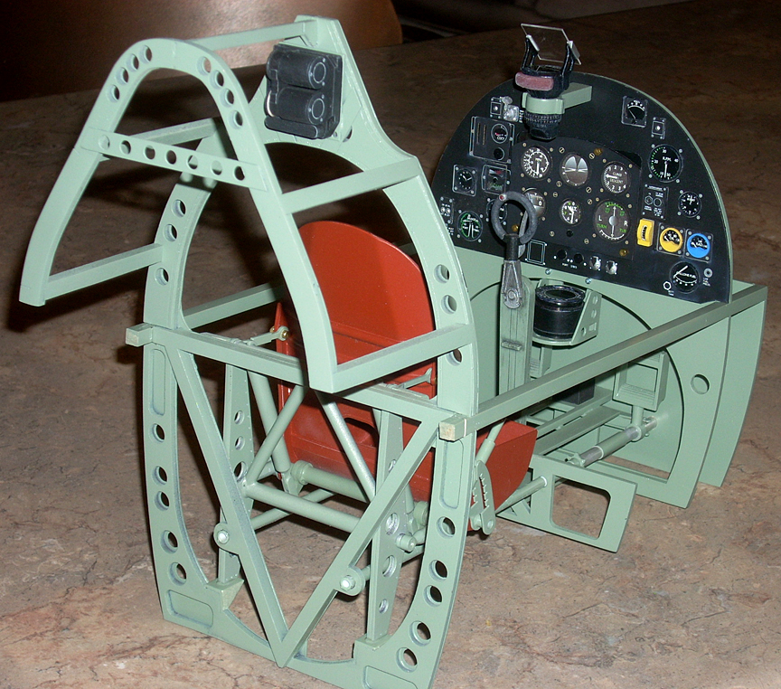

I will also be working up some new bulkheads for the cockpit area in order to incorporate my cockpit kit which is actually designed to fit the slightly smaller Taylor Spitfire.
Attachment 2235329
Attachment 2235330
