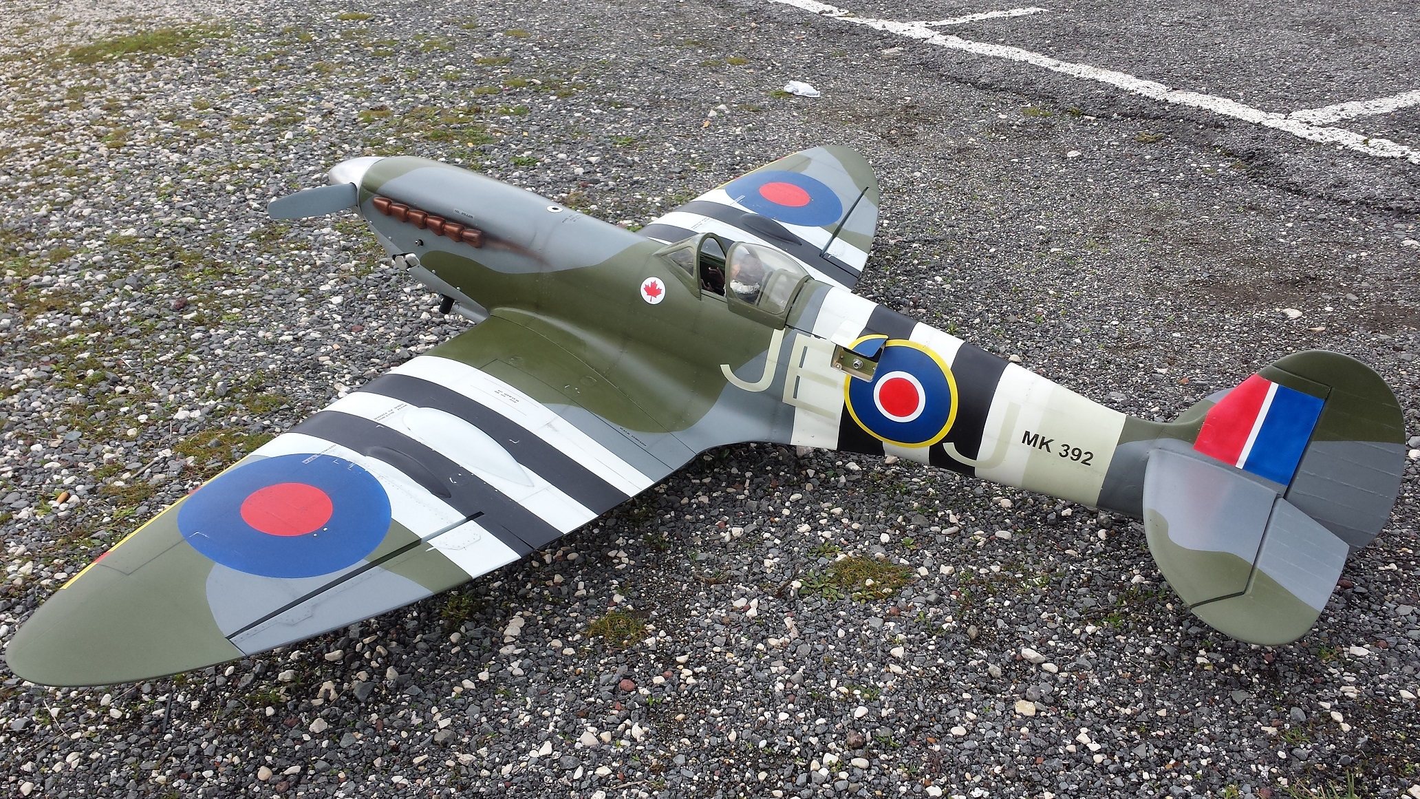

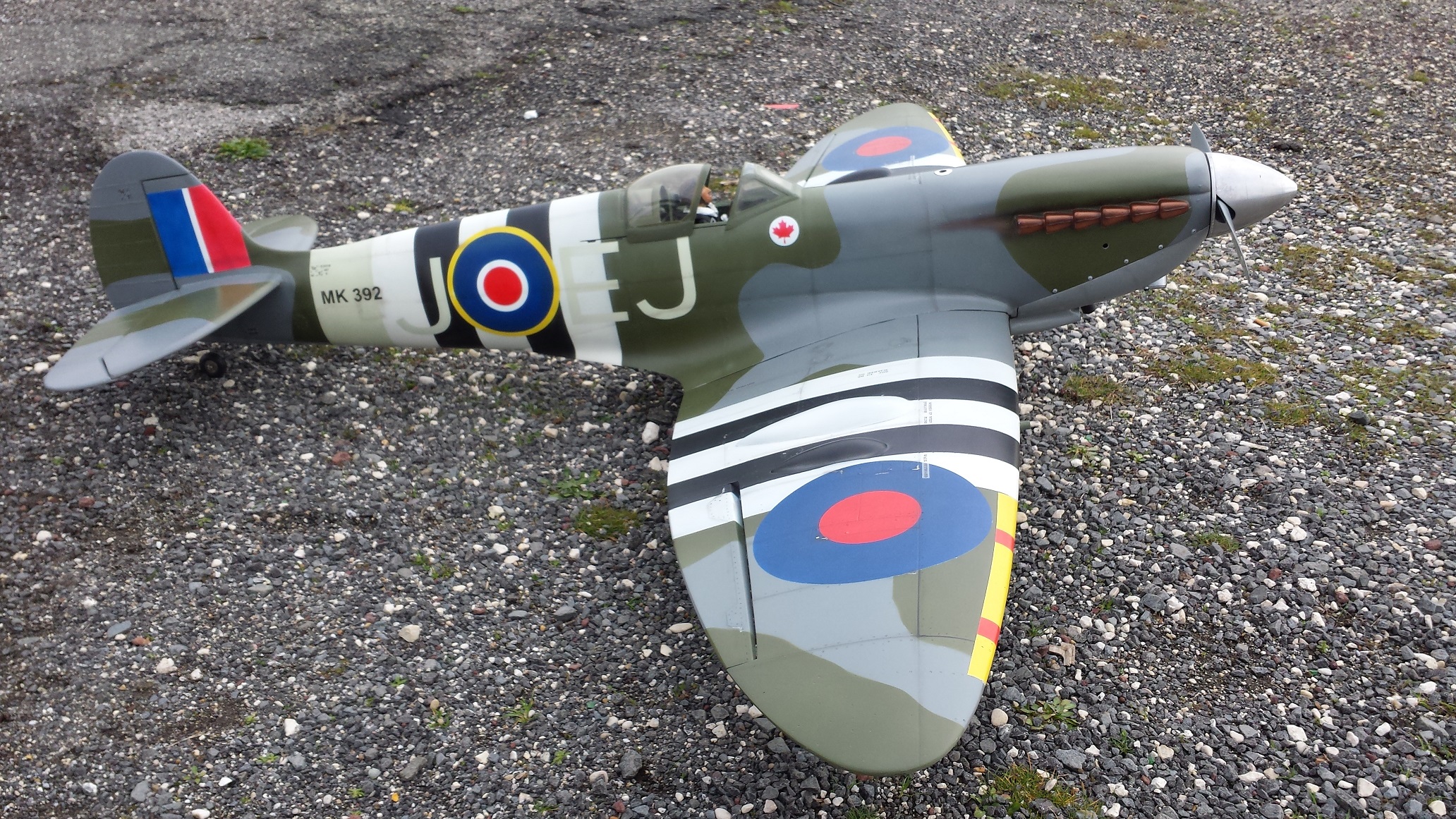

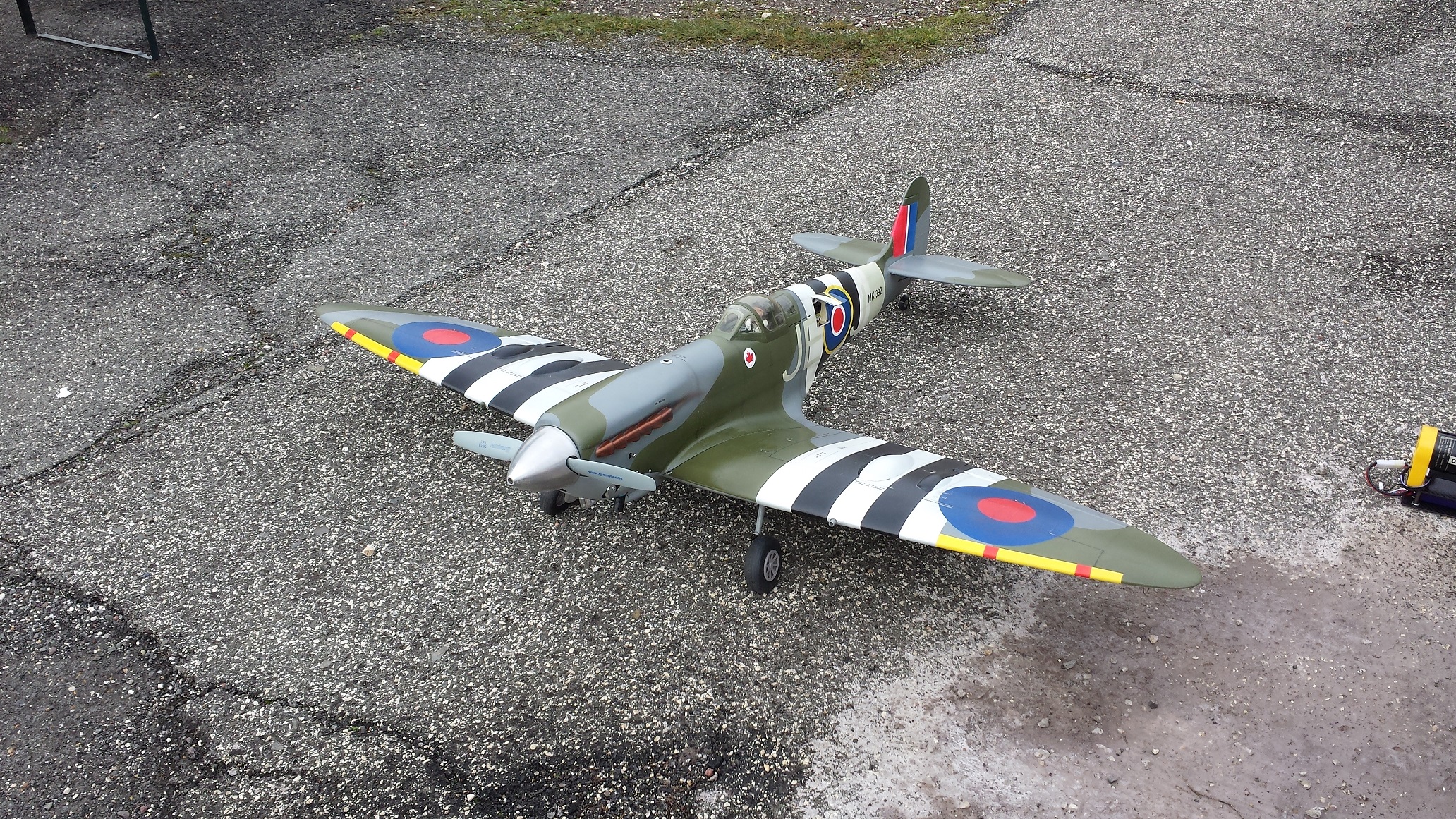

rluigi65 02-09-2015 07:21 AM
3 Attachment(s)
Originally Posted by paul0367 (Post 10740381)
Here goes, I have reduced the image sizes to hopefully enable me to post my attempt at making a spit look tired, I have uploaded successfully but where they are I have not the slightest idea, this may put on duplicates but hey 1st timer her
hi this is mine . what do u think?
http://www.rcuniverse.com/forum/atta...mentid=2071698http://www.rcuniverse.com/forum/atta...mentid=2071699http://www.rcuniverse.com/forum/atta...mentid=2071701
