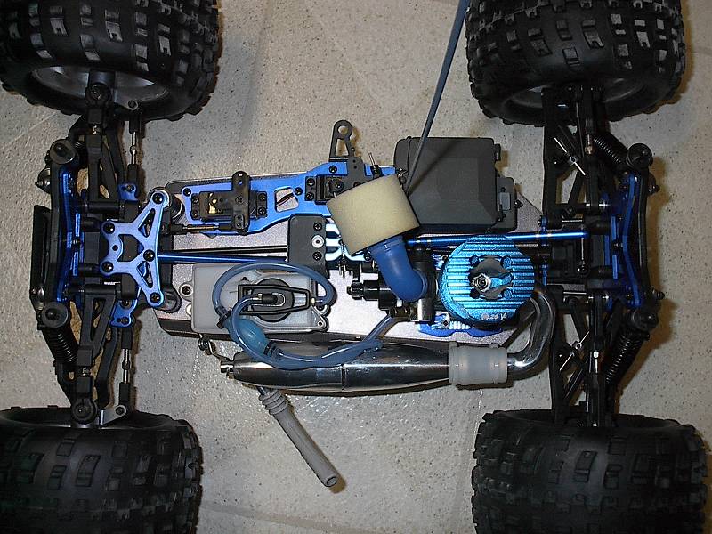

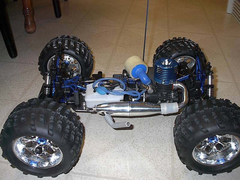

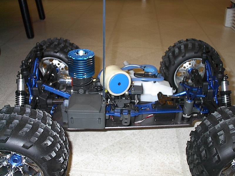

I figured since there is no official avalanche thread I would start one so here goes.
My first upgrades on my sons new Avalanche. A Sportwerks V2 engine, 3,40,10 diff fluids, primer and new air filter for now. I have not run it yet. Once I have I will give a full report, but how it is set up now with the new engine and diff fluids I can bet that its wicked fast. I also have 3 different size carb bowls to chose from. It has the smallest size 6.0mm. Then it goes to 7.5mm and 9mm. The 9mm would be sick but Im not going to go there yet. My son has not seen it yet nor does he even know I have it. He is going to be so friggin excited. What do you all think so far?

Wow!! that is sweet man. Is that engine really that much more powerfult than the SH .28? I mean the SH is crazy fast already. Lookin mean man!! If i were you I would stand behind your son when he first sees it on christmas morning, he might just pass out!
What is that diff oil setup intended for? Racing, regular setup, or for wheelies?

He likes wheelies so i made the center diff a little thicker to get better traction in the rear but yet he can still race at the track. The Speedwerks has alot more power and its a 7 port instead of 3 port. Its the same engine as the losi m427. One of the best low dollar big blocks you can get.

Sounds like the truck is more for him then his son! LOL Don't get mad when you son rolls over that thunder tiger[:@]

He has to catch me first I will look for a link and post it. I usually get my stuff on ebay. The Speedwerks v2, mach .26, losi 427 and mach 427 are all the same but the speedwerks has a better carb.

Nice ride! I bet your kid will love it.
I wanted to clear up a couple of things though. We are a Horizon dealer as well as a Redcat dealer. The Sportwerks .26v2 is a good engine, we have seen a better lifespan than the SH .28 but the SH has better power for a big truck like the AVALANCHE. The Sportwerks is not the same engine as the Losi Mach 427, M26SS or the Dynamite .26, M427. The Sportwerks .26v2 is a 7 port sleeve, the M427 is 5 ports and the M26SS has 3 ports. Not trying to be a know it all, just wanted to clear this up before some of you guys spend unnecessary $$$. When our RedCat customers need (or just want) a new engine we usually recommend the Axial .28 because of the low price, good power and excellent durability.

You are wrong about the V2 and 427 not being the same. They are the same and both have 7 ports. I can also tell you that with out a doubt the v2 is WAY faster than teh sh28. The sh is a great engine its just not on the level of the V2.
Defmeg,
The plastic cover on the air filter will restrict airflow so you will not get the full power that the engine is capable of. Get a filter with the pre filter and you will have to retune slightly and see the power increase.

Today is the first day my son has been able to run it. Let me tell you that this thing hauls major ***** with the sportwerks v2 engine and it handles better than any monster truck that I have ever driven. Almost impossible to flip around turns. He was doing jumps that I never saw him do and even bad jumps looked good. I had a e clip fall off so a pin came out. had to run for e clips. Then I got my Truggy out and we raced. This thing gives me a run for my money for sure. Very impressed with this truck. I think I would absolutely put this truck up against any of the big names for sure.
My brother inlaw and nephew were also over with thier new Monster gt's. I sold the sh.28 engine to my brother inlaw and broke it in for him. That engine is a power house for sure. Could not keep the front wheels down. It smoked the stock .28 mgt but they were no match for the avalanche. They lined up several times and as soon as the avalanche took off it was all over for the MGT's. Even with the single speed avalanche the 2 speed monster gt's could not catch it. Then they did an oval race. The avalanche hugged the turns and pretty much lapped the mgt's while the mgt's were rolling and flipping.
From a dead stop when he nails the throttle on the avalanche all 4 tires break loose and grass flies everywhere. Its so FN funny seeing it tear up the lawn. I really need to get video because it is sick fast. My son had a grin from ear to ear to whole time. Thats when he challenged me to a race against my truggy. If he were a better driver I would bet that it could take me with out a doubt.
Over all I am 100% satisfied with this truck. It makes a tmaxx look like a radio shack special.
