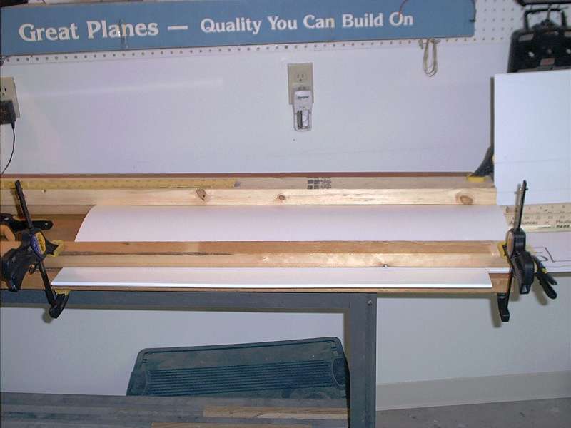

Let's start on the wing first. The wing needs to be completed before you start on the major fuselage stuff. This is not a weekend project. Since I use poly glue for nearly all of my coro to coro and coro to wood joints, it takes some time for the glue to set up. Most guys should be able to get her darn near completed in a weekend, and week of evenings. Plan on roughly 30 hours to complete.
Take two yardsticks, and rip 1/4 inch off length-wise. These 1/4" pieces need to be glued to the top of two other yardsticks, giving you two 36"X 1 1/4" yardsticks. These are the main spar. I put two inches of dihedral in mine, but it's really up to you how much dihedral you put in. After you sand or cut each main spar yardstick on the end for dihedral, butt join them and glue. Take one of the yardsticks that you ripped the 1/4 inch off of, center it over the butt-joint (18" on each side of the joint) and glue it to the main spar. With two inches of dihedral, it should just fit without hanging over the main spar. This is the main spar reinforcement. Here's a cheesy drawing to show what I mean. I hope I am being clear enough.

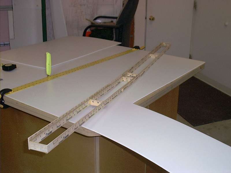

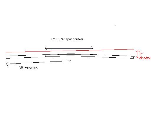

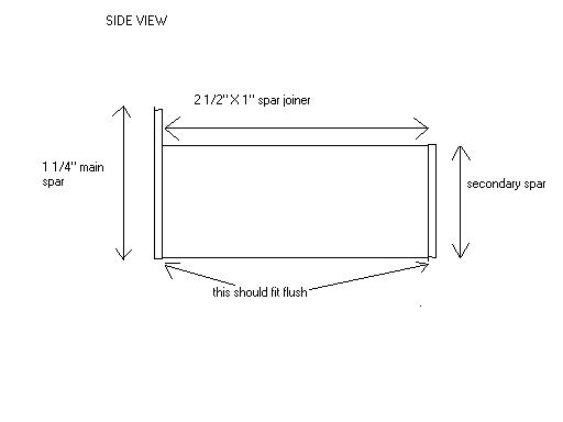

Secondary spar:
Take two 1"X 36" yardsticks and cut in the same dihedral as the main spar. Make sure it's exactly the same, or you will have a twisted wing. Take the other 3/4" X 36" (from the ripped yardsticks in the first step) and glue it on for reinforcment. You won't use all of the 36" length on this one, as it will hang over the edge of the spar. So cut it where it just meets the bottom.
You now have two spars. One 1 1/4 inch high, the other 1 inch high. The dihedrals should match exactly when you place the secondary over the main spar. Line up the bottoms.
Cut 6 2 1/2 inch strips from another yardstick, 1 inch high. These are the spar joiners. Using a square, glue these six strips to the main spar (make sure your spar doublers are facing away from each other, in other words, the main spar doubler faces TE, the secondary spar doubler faces the LE). They should fit flush on the bottom of the main spar. Glue the secondary spar to the other end of the joiners. Here's a top and side view pic for clarity. Please tell me if these are too hard to understand.

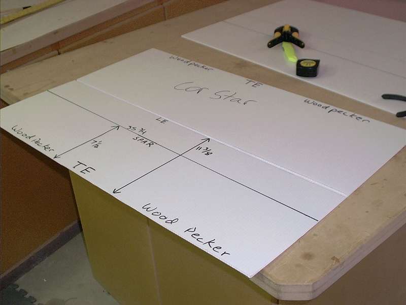

Next step, the wing panels. I always run my flutes chord-wise. The pic shows the majority of the dimensions. The strip at the tip of the 11 3/8 measure is about ½ inch wide. One side of the plastic was removed for the leading edge. Total width of the panel is 22 ¾. So you need 2 panels 35 ¾ X 22 ¾ . The 22 ¾ should run with the flutes.

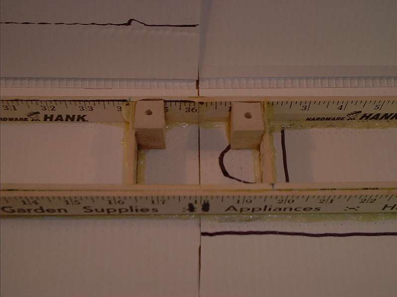

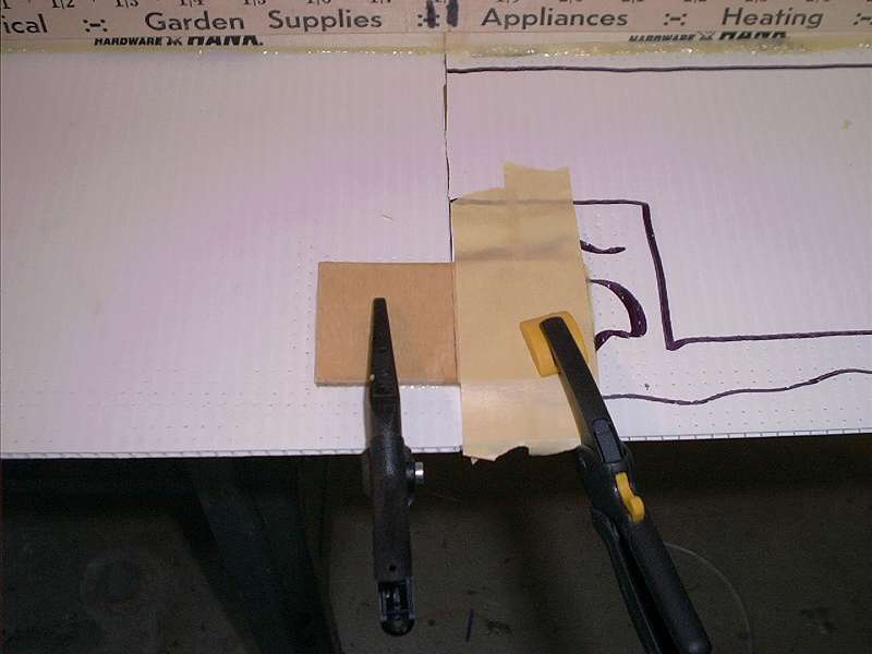

After your panels are cut, you need to prepare them for glueing with the spar. Set the spar on a panel, and draw around it. Make sure you are centered. Take your woodpecker tool, and center it along all of the lines and start peckering. It's better to pecker too much, than not enough. Extra woodpecker holes don't seem to effect strength.
Woodpecker detail:
Edit: I forgot to mention that you need to woodpecker the panel on the trailing edge.
Woodpecker detail:
RE: Cor-Star 60 Version 2.0 plans and pics
Prepare both panels this way. Don't worry about the top of the wing that will fold over at this time, we will prepare it after the spar is glued to the bottom.

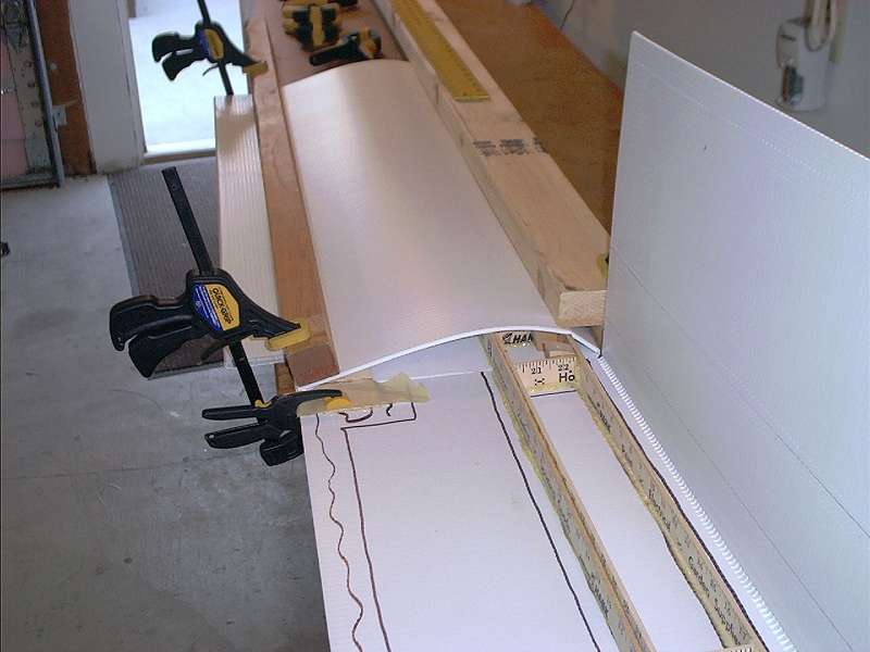

Mist the bottom of the wing panel with water. Be liberal. Also, mist the bottom of the spars. Lay a bead of poly glue on the spars (only one half) and carefully lay it flat on the first wing panel, keeping your main spar line lined up with the spar. Don't worry about the servo mounts in the pic, I'll get to that later.
Make sure you only do one wing half at a time. The spar needs to be clamped flat against each panel, and due to the dihedral, you can only do this one side at a time, and only on the bottom of the wing panel. While you wait for this to dry, make some servo mounts. These can be of any design you want, and some may opt to just SPAD them in (use cable ties or the like). I cannot vouch for this strength-wise, as I have only used wood ones.
Do the other side of the wing just like the first side. You should now have a full wing, with only the bottoms of the wing panels glued to the spar. Take your servo mount, and center it between the end of the wing, and the center. Mark where the servo will go, and carefully cut your hole in the bottom of the wing panel with a utility knife.

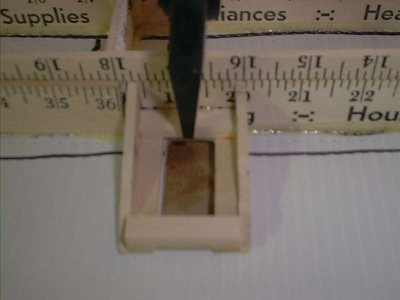

Glue your servo mount to the spar. Make sure you can get a servo in and out of the hole you cut in the coro. The mount sits flush on the inside of the coro, then simply attaches to the spar. Now we'll work on the front wing mounts. I used 1" square hardwood, that is at least the heigth of the spar (grain should run height-wise), so two 1X1X 1 1/4 inch cubes of HARDWOOD will do. Drill a 1/4 inch hole in the center of this block. You will have to curve the top part to fit the airfoil. Once you have it the way you want it, epoxy it to the spar, and poly glue the side that mates with the bottom coro piece. Your holes should be roughly 2 inches apart, or 1 inch from center.

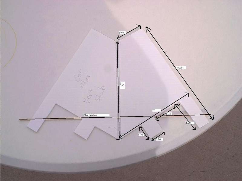

The vertical stab is one piece, folded over. Cut per the pic, and don't forget to woodpecker the ENTIRE coro mating surfaces. There is also a 1/2 strip removed from the center. These flutes need to be opened a little with a razor, and try to keep it straight! The straightness of this cut determines how straight the vert stab will be. Remove the inside skin, and try to bring the halves together, if it's to hard, remove some of the flute. A dremel with a sanding drum on low-medium speed does a nice job, just be careful not to burn through to the other side.
The rudder still needs to be cut , so don't fold and glue yet. I need to see if my measurements will show up for the vert. stab.

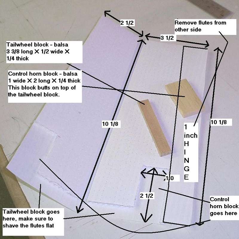

Deadeye, what is the dimension on the elevator where the flutes are removed and the fold is done? i see the 11 3/4, but it looks like the fold length is smaller distance to make the angle.
Whoops! I forgot that measurement. It 9 7/8 inches.
