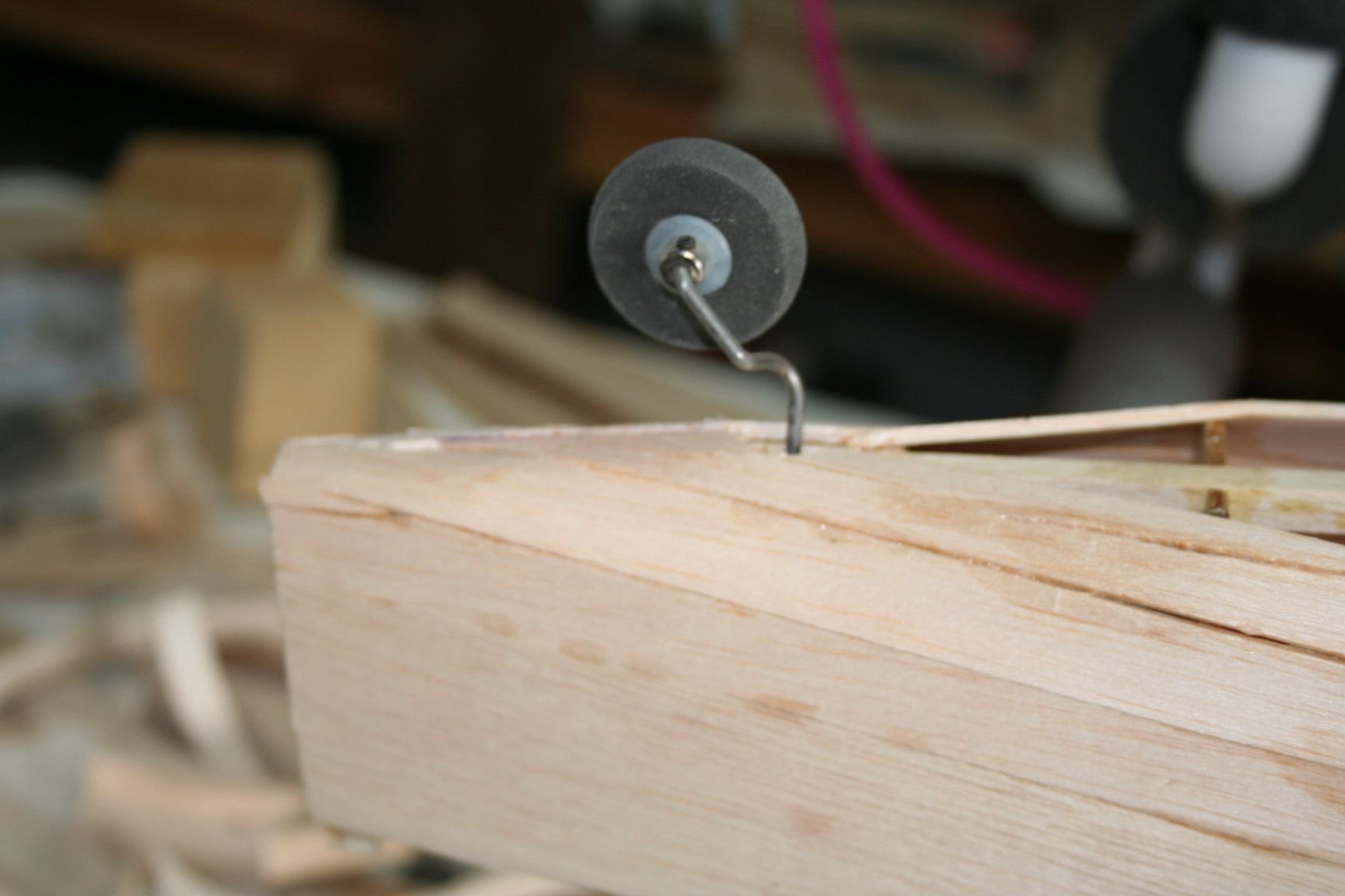

I am going to take you back to post #234. We had already installed the tailwheel assembly, and ran stringers from the last fuse former to then back of the fuse. Now, we are going to fare it all in, in preparation for sheeting the bottom of the fuselage. Scrap pieces are glued in-place, as pictured. Note that the blocks match the width of the side stringers, to allow for the thickness of the sheeting/strip planking.
Tim's rear fairing block.
Here the author (Ollie) carefully checks fit and alignment of the block, prior to gluing.
Another angle
Two lengths of scrap stringer material installed; and, started sanding to "round" the bottom.
Sanding roughly completed.

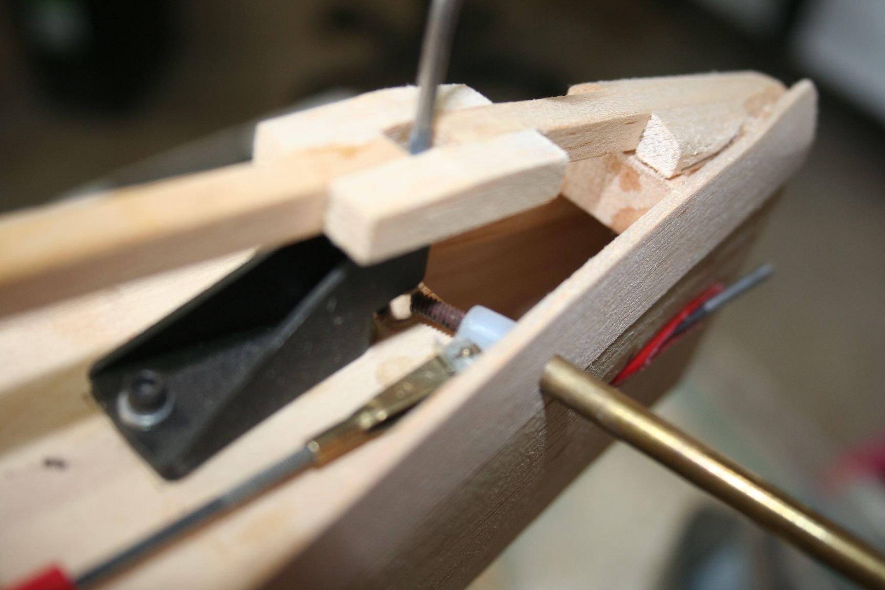

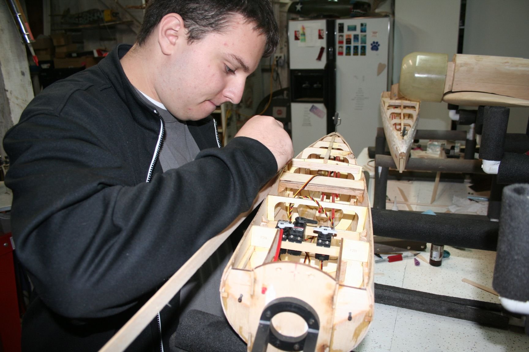

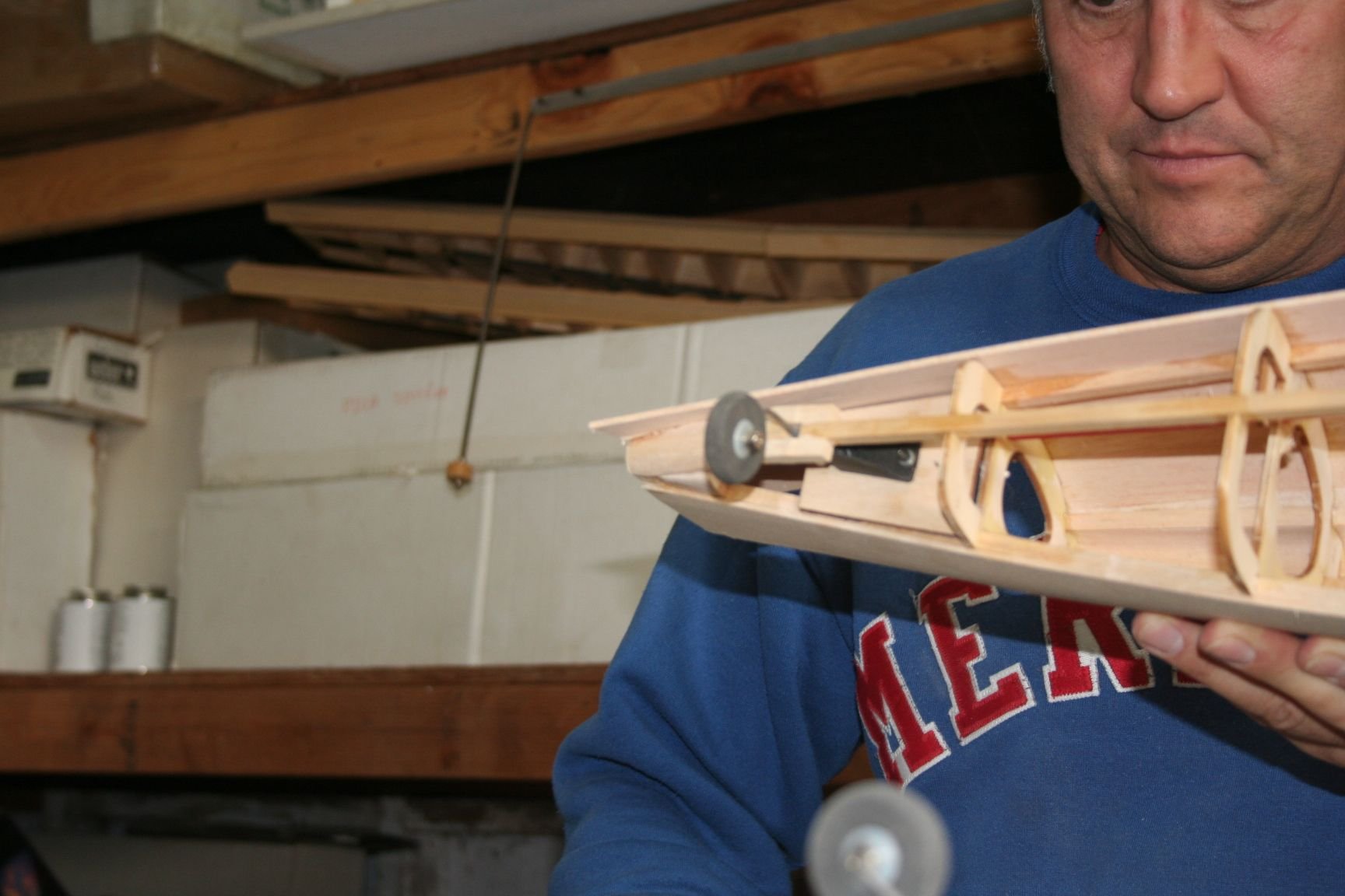

The first of the bottom strip-planks is glued. Before going further with additional sheeting -- and before we enclosed the tailwheel assembly, Eric and I used a piece of sharpened brass tubing to cut a hole wide enough to insert a hex wrench. This allows us to be able to easily adjust the tailwheel alignment.
(Tim enclosed his. I guess he is choosing to take his chances.)

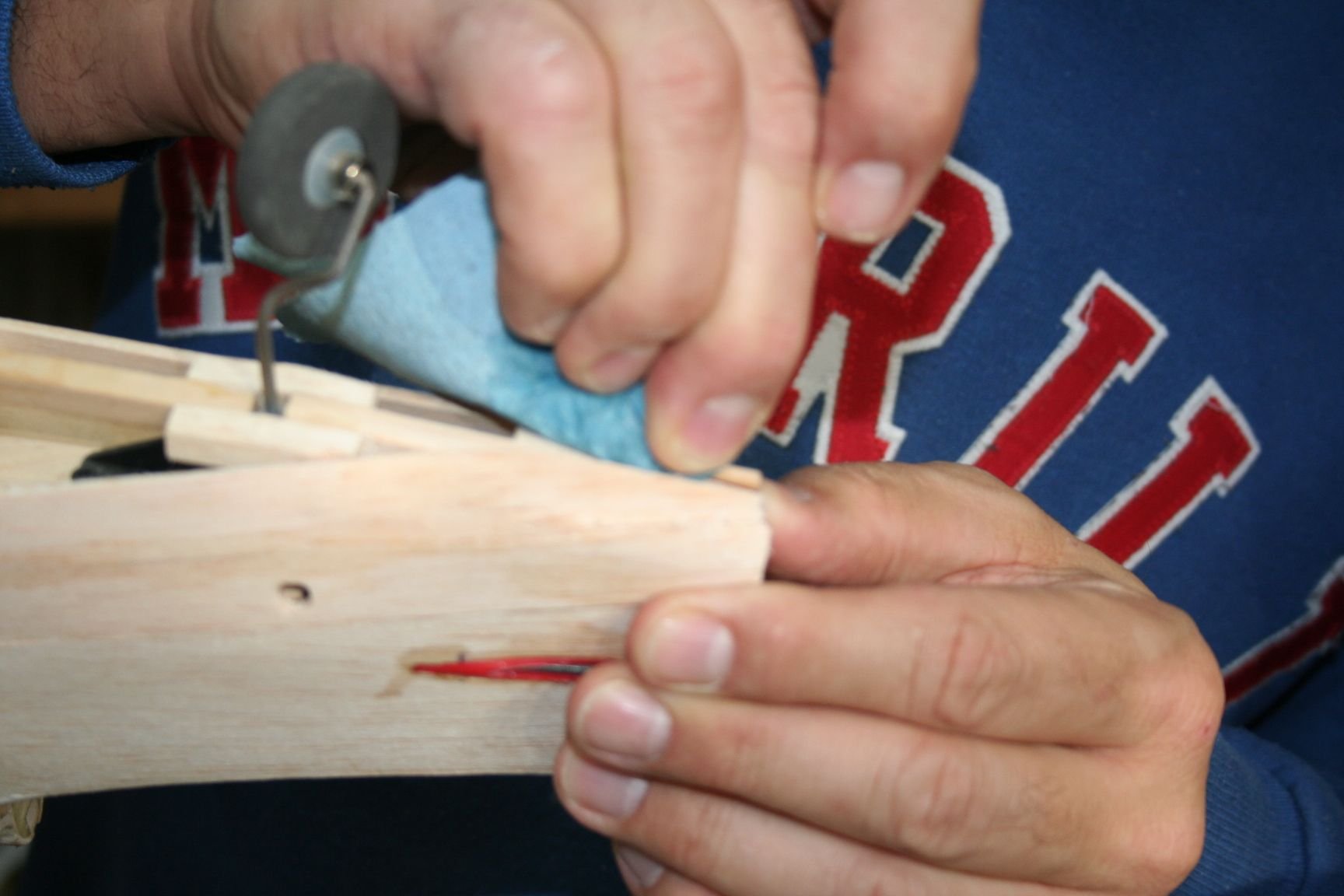

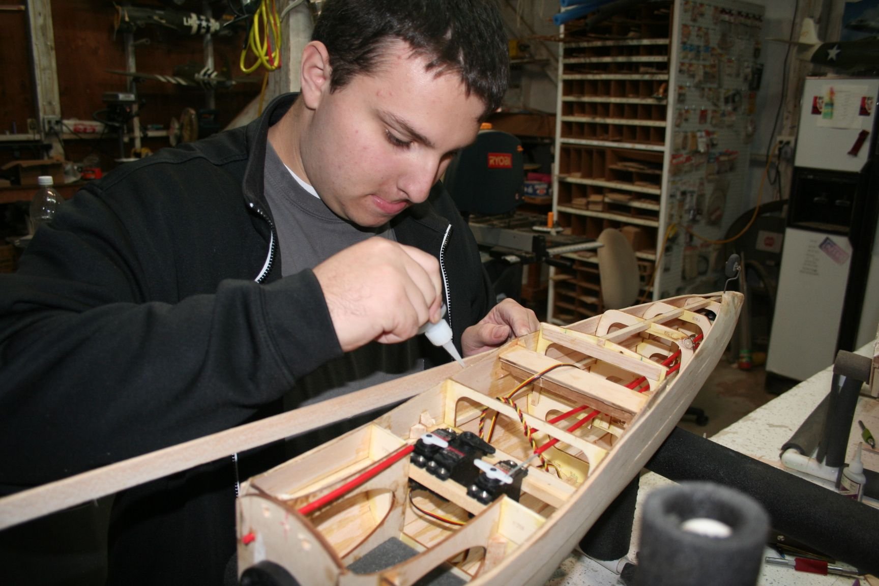

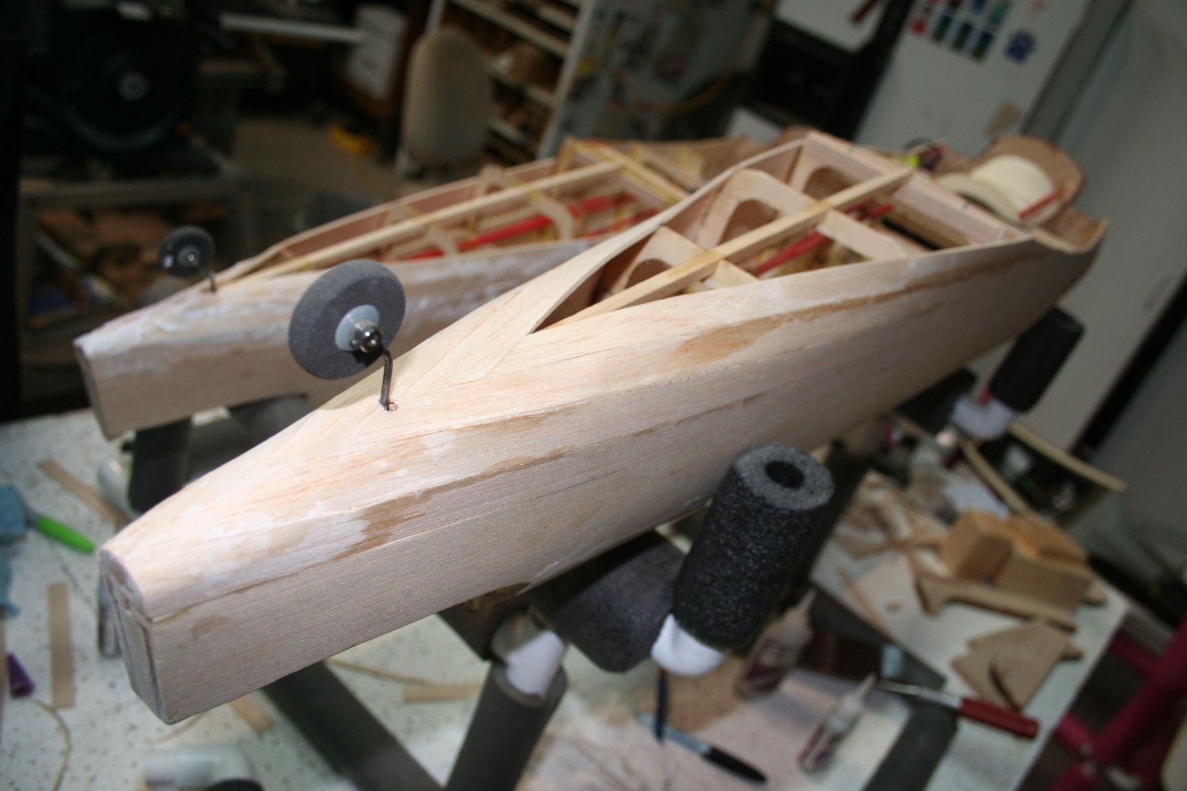

We continued sheeting, bending each strip plank to match the contour of the fuse. We were sure to use the softer, most flexible pieces of material, and wet the balsa to allowing it to bend, without splitting; and, gluing gradually, to ensure the more forward sections did not separate as the rear portions had to be contoured more sharply behind the tailwheel assembly.
2nd strip plank adhered with thin CA to the first.
Once dried, I began bending the strip plank to match the fuse contour. Gradually gluing the bottom of the plank to the formers and other existing structures.
Here, a dampened shop towel is used to moisten the balsa, allowing it to flex even more, without splitting.

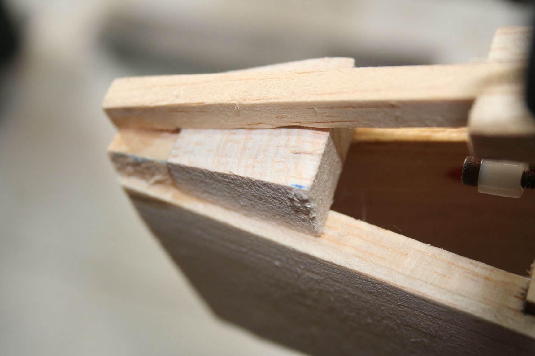

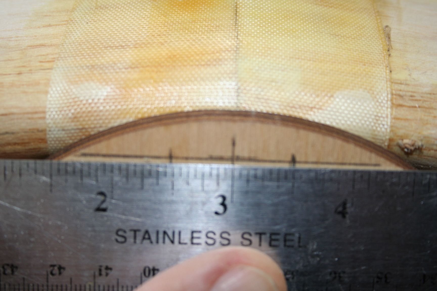

Before the last part of the strip plank was glued, it was folded around the rounded scrap blocks and held in-place with a metal ruler. The ruler's edge began at the tailwheel wire, running back, aligned with the centerline of the bottom of the fuse. A #11 Exacto blade was used to trim away the extra material. Then, the strip was glued to the rounded filler blocks.
The sheeting on the far side has been trimmed, and the matching piece on the near side is trial fitted, before gluing.

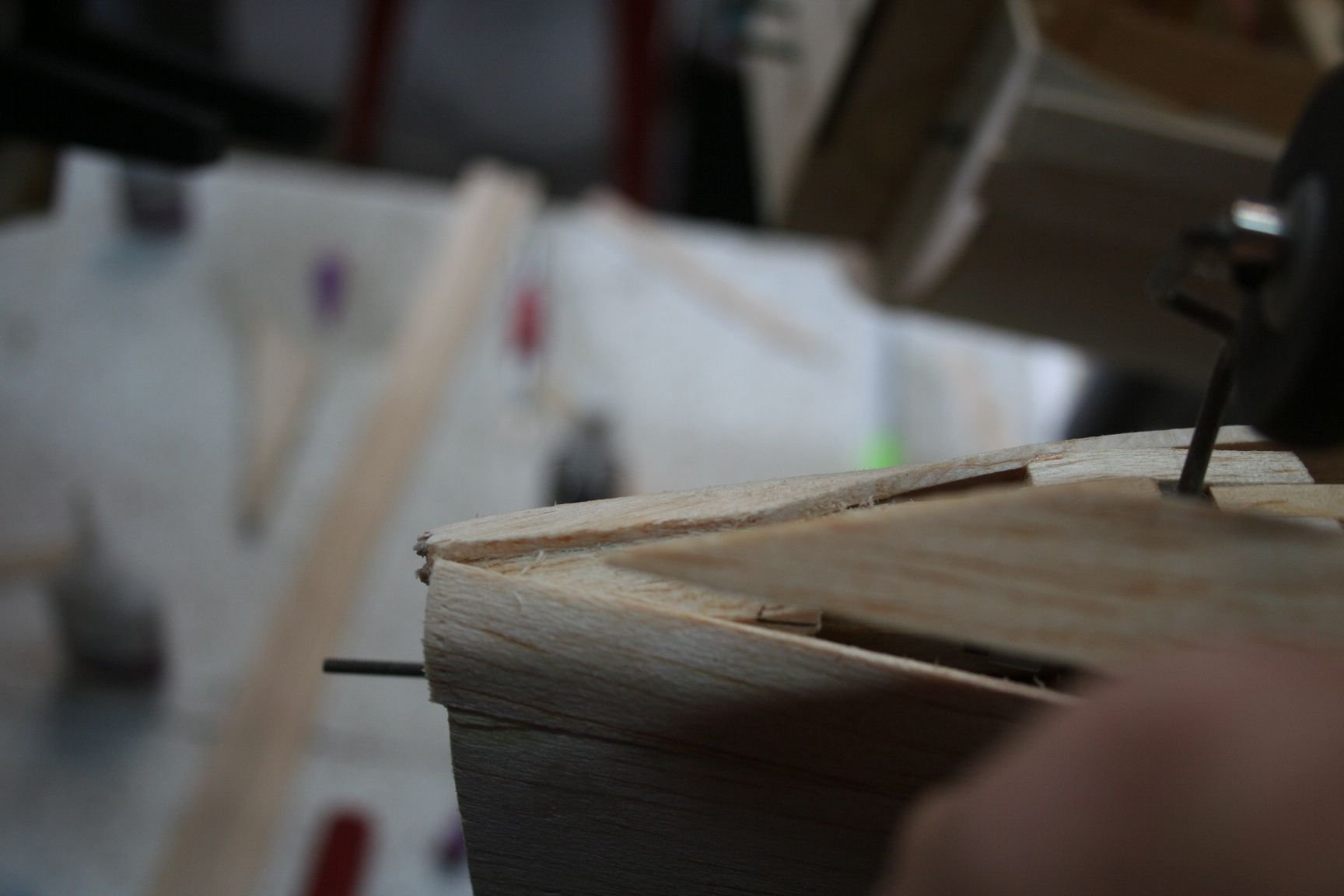

One piece of strip planking resisted the attempts to manipulate it into an even curvature. If you look closely, you can see the split. It will be CA'd, filled, and sanded.

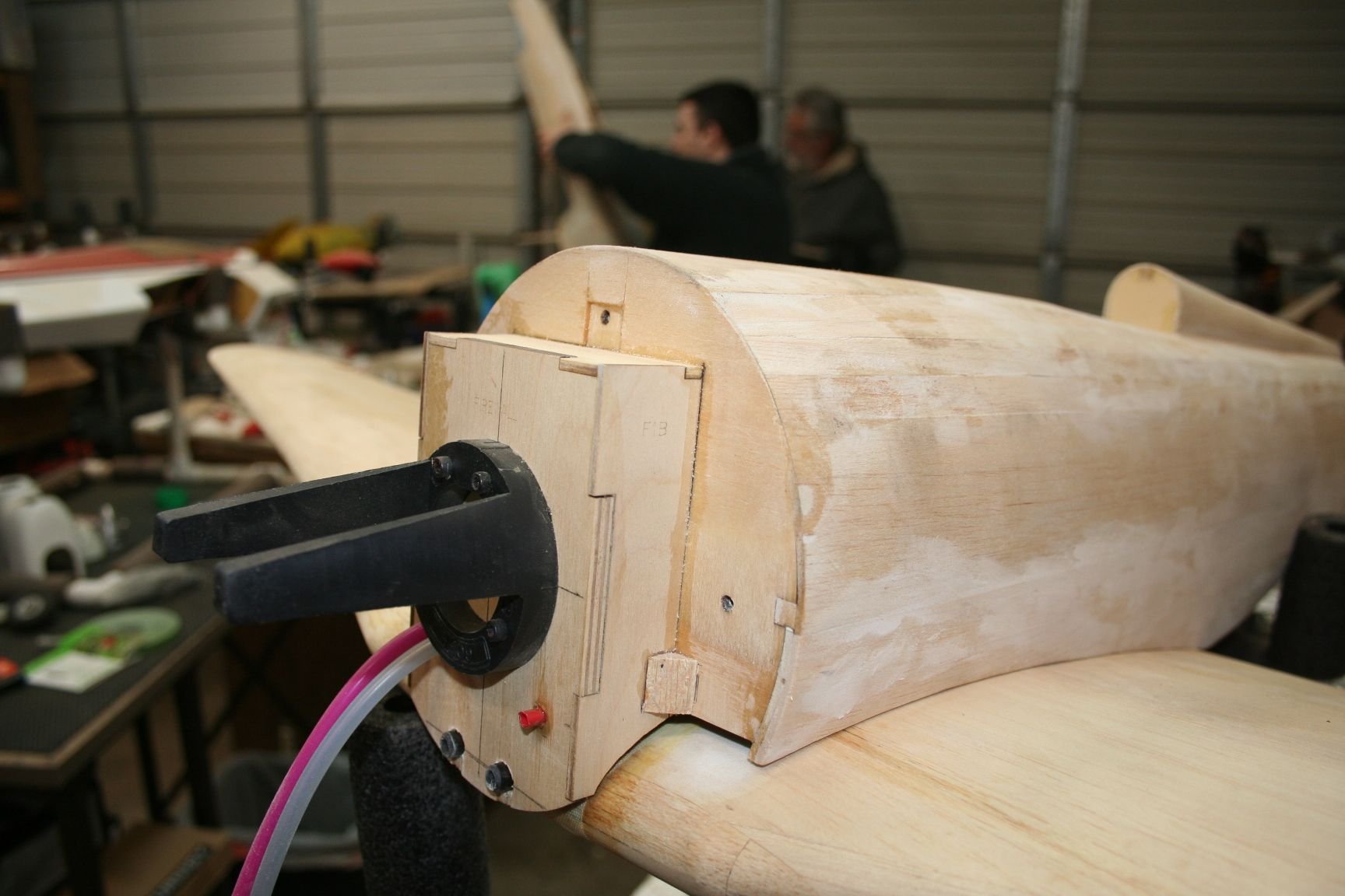

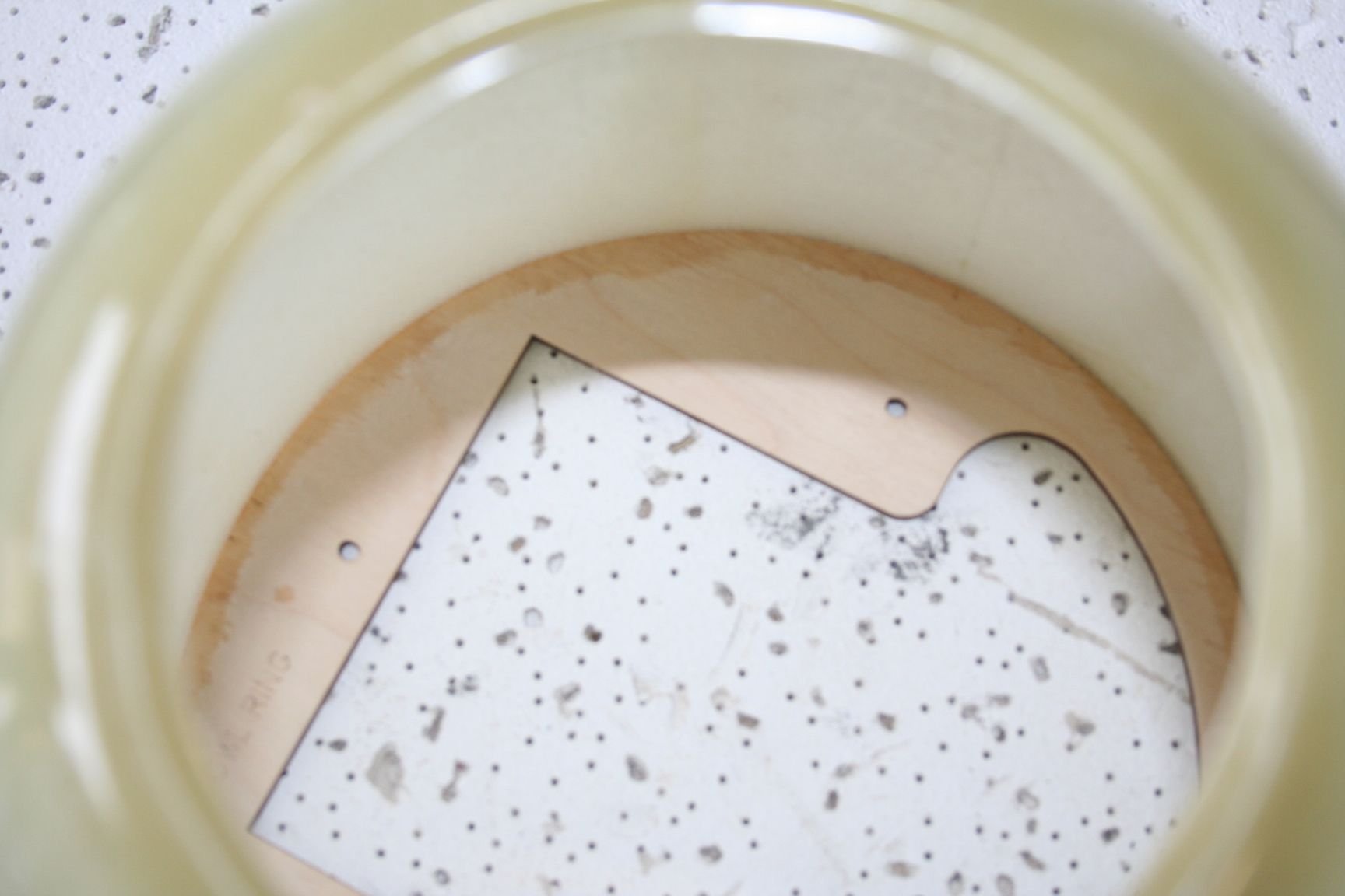

Tim states that before the bottom-most layers of planking can be applied, we must fit the wing to the fuse, and mount the cowl. Recesses in the cowl must be trimmed away, in order to fit it around the leading edge of the wing.

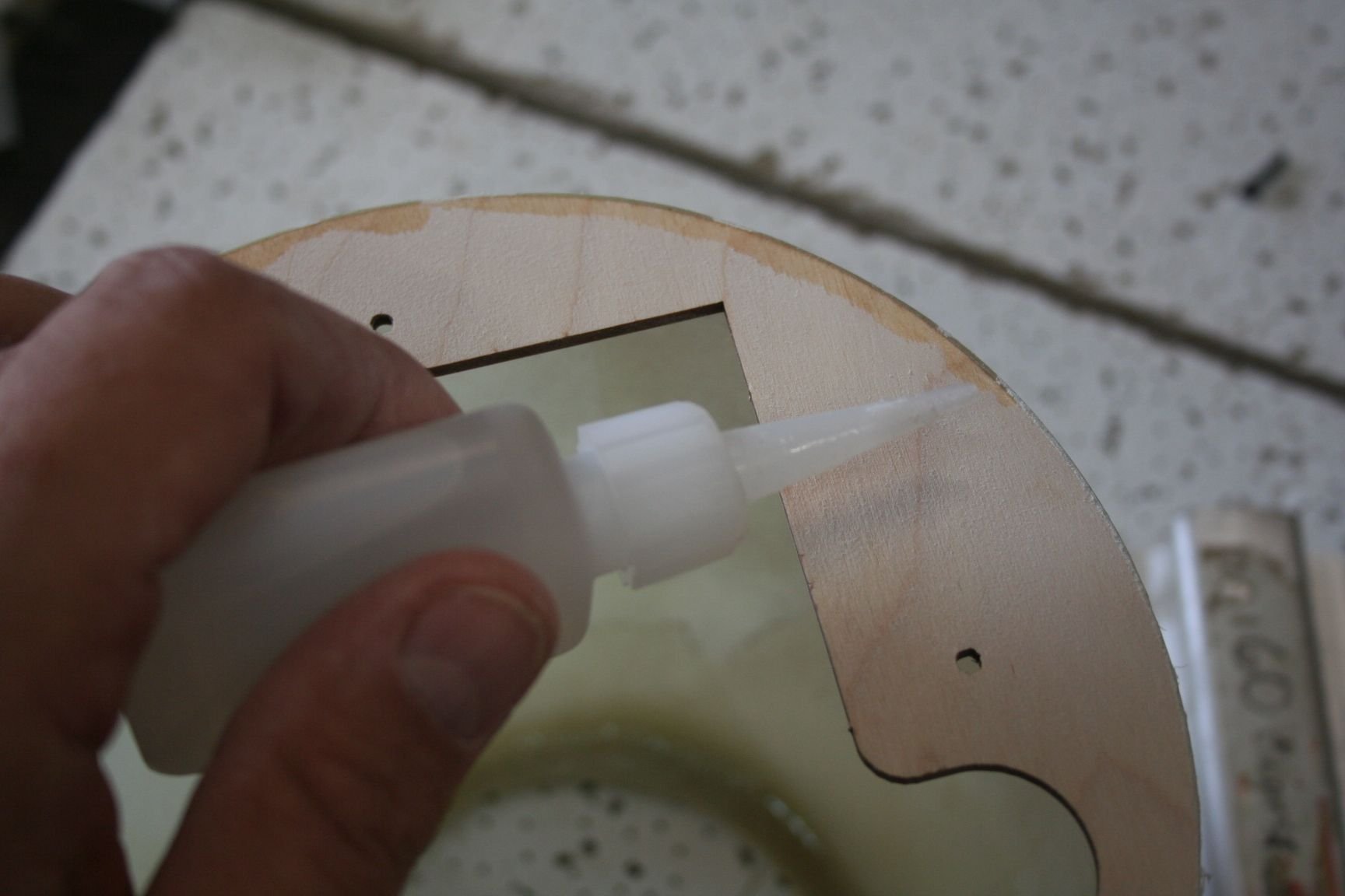

I sanded my cowl ring slightly to fit snuggly inside of the cowl. I placed the cowl's trailing edge down on a flat work surface, & pressed the ring lightly to ensure it lined up perfectly with the edge of the cowl. In the next picture, you see me with the assembly flipped over, tack-gluing the ring to the cowl from the bottom. I applied the thin CA very slowly & carefully, just inside of the edge -- ensuring CA did not run over the edge to the outside of the cowl. Then the inside was glued.

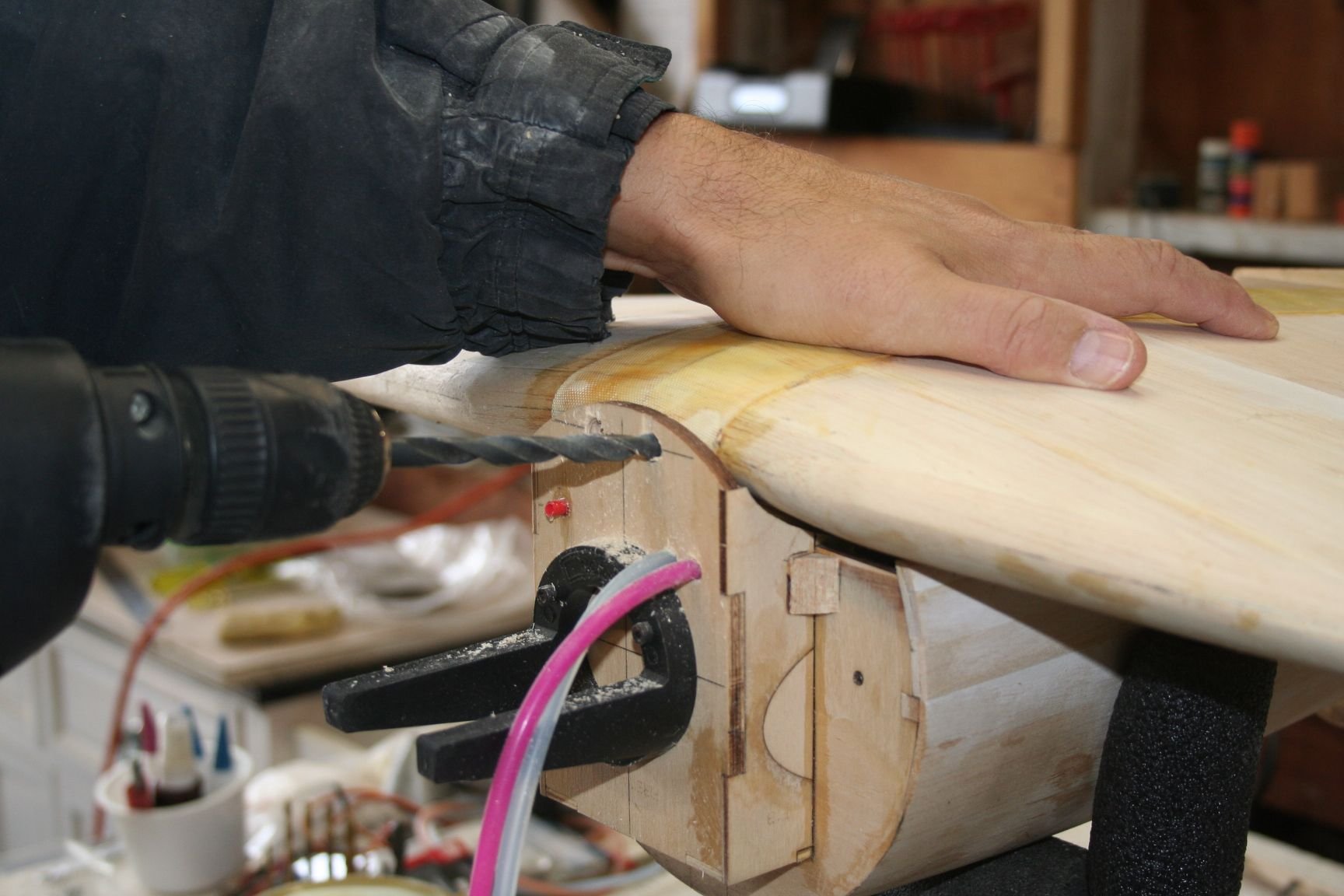

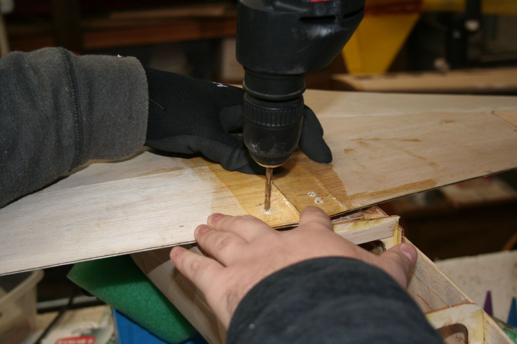

The fuse was set upside-down in a cradle. The wing was set onto the wing saddle and centered. One of us held the wing tightly in-place as another drilled two 5/16" holes through the firewall and into the leading edge of the wing. The holes were spaced 1" apart, each a half an inch from the centerline; and will accommodate leading edge wing dowels.
Eric holds Tim's wing in-place while Tim drills.
I hold the front part of the wing and drill my wing dowel holes, while Tim holds the rear of the wing secure.

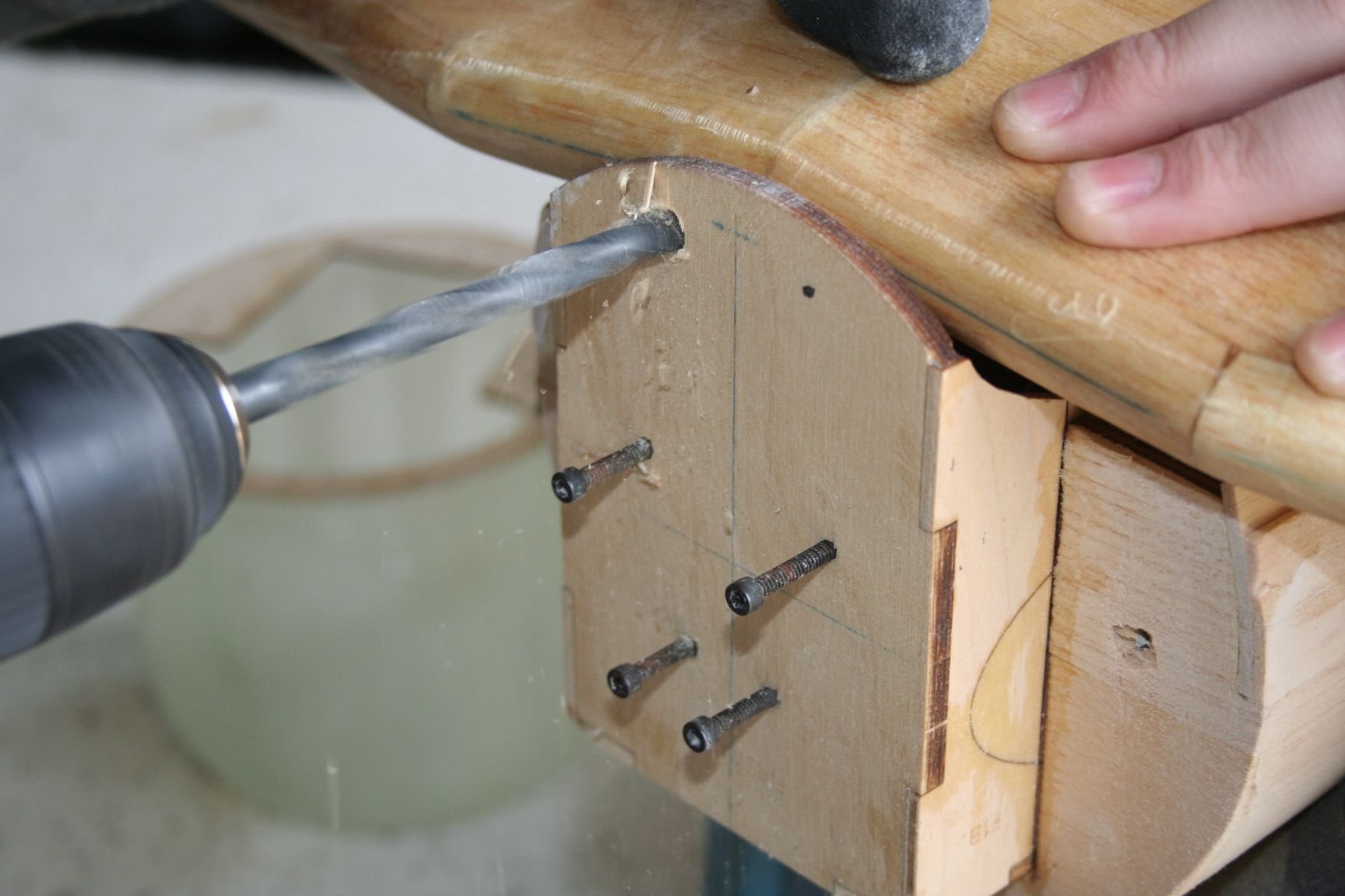

5/16" diameter dowels were epoxied into the leading edge of the wing; and, then we broke for lunch. After lunch, the epoxy had cured well enough for us to finish installing the wing.
The wing was put in-place, with the front wing dowels inserted into the firewall. We took turns, with one of us holding the wing securely, while the other carefully measured from the end of the fuse to the inside corner of the aileron, nearest the wingtip -- re-adjusting and re-measuring as necessary, until the measurements were identical. Thus, ensuring the wing was square to the centerline of the fuse. Then, we drilled 3/16" holes through the rear center of the wing, and into the wing mount blocks. We did mine first, but no one took pictures. Eric was next, so I took pictures while Tim held his wing. I held Tim's wing; so again, no pics -- sorry.
We advised Eric that he should hold the drill perpendicular to the angle of the airfoil, to ensure that the heads of the wing retaining bolts would be flush with the wing's surface, once installed. But this being his first time, he unfortunately started his hole slightly too forward, and exaggerated the forward angle necessary; so, did not get sufficient "bite" into the plywood wing mounting block. He was completely successful with his next two holes, but will now need to fill and sand the original hole (forward, right).

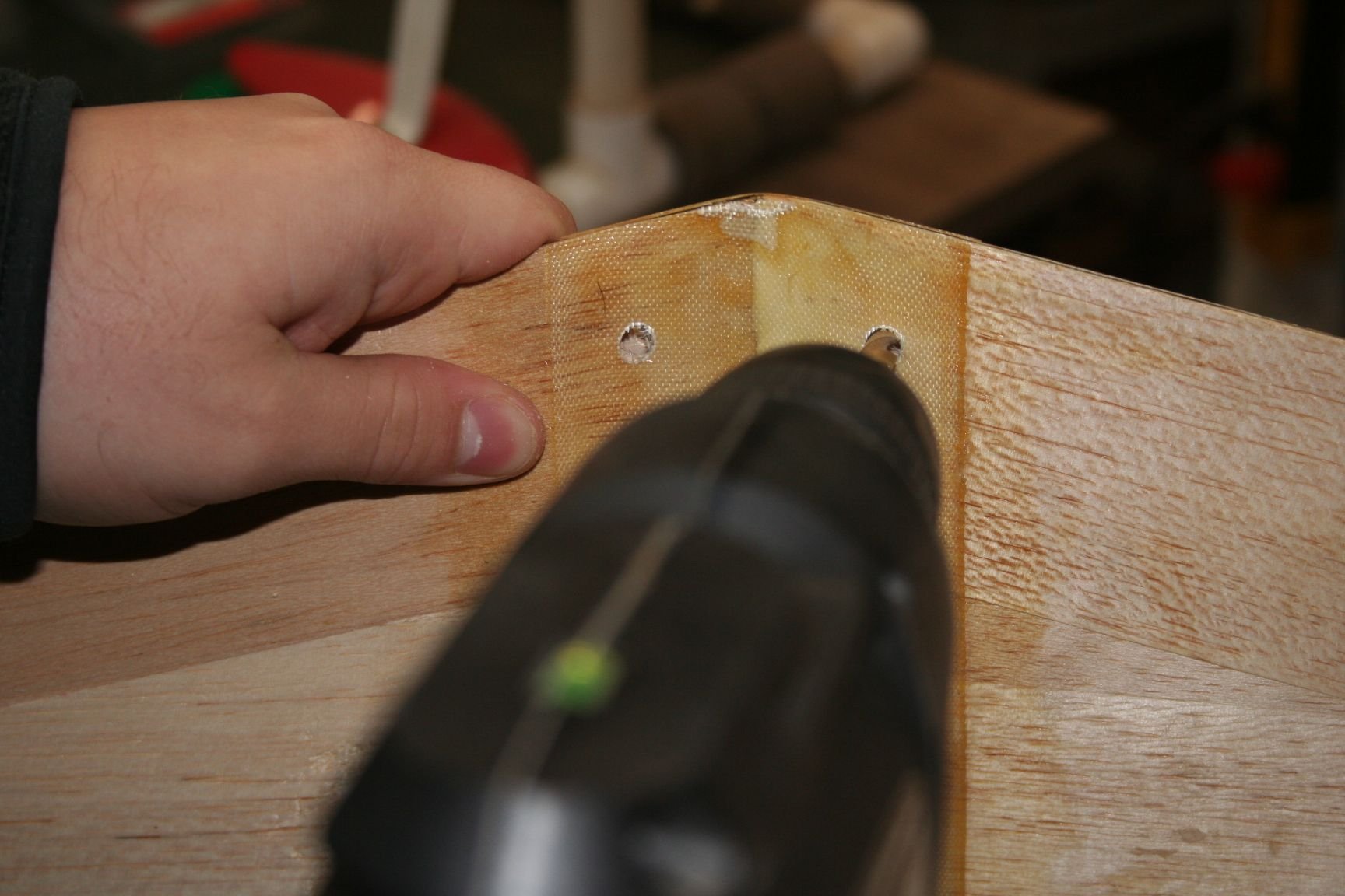

Old 12-07-2019, 11:09 PM
  #297
Iron Dog

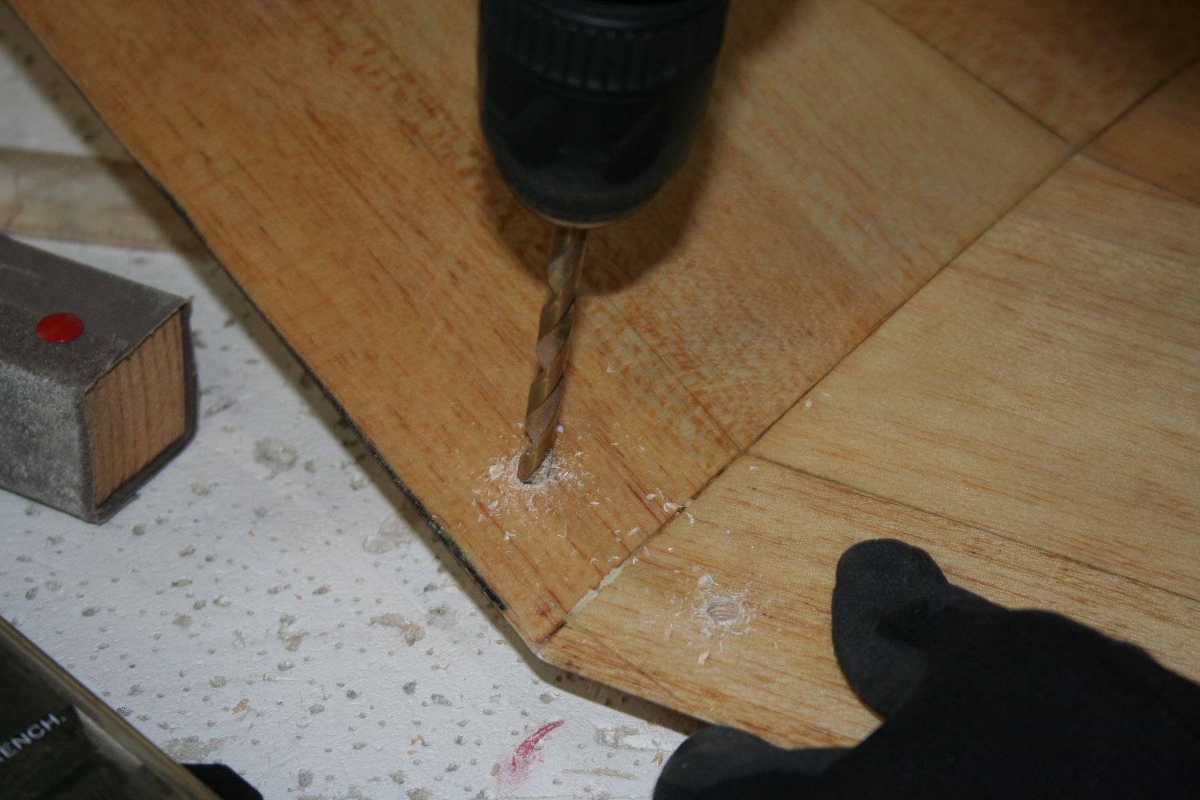

The 3/16" bit was exchanged for a 1/4" bit, and holes that would clear the threads of the nylon 1/4-20 bolts were drilled. Pictured below, Tim enlarges his holes (probably drilling into my work surface! ). Then, Eric does the same -- thankfully, no threat to my workbench.
