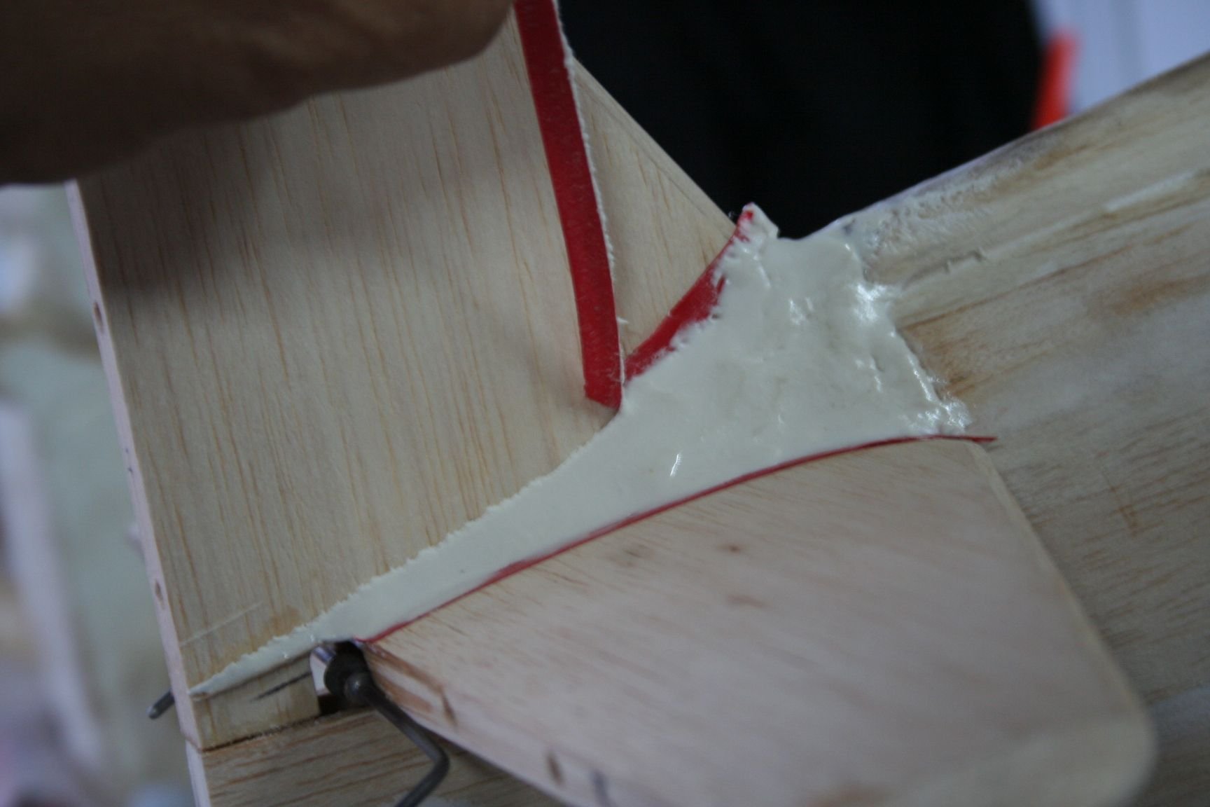

Referencing pictures of CzechMate’s tail section, I outlined the curvature of the fin fairing using 1/4” red vinyl tape — top and bottom, and on each side of the fuse. Tim and I mixed-up micro-balloons and resin until we achieved a “peanut-butter” consistency, and slathered-it-in to completely fill-in and more accurately shape the fairing.
Tim taped the top (at the fin), opting not to tape the bottom (at the stab).

When I was happy with the top stab to fin area, I used the leftover filler to fair-in the bottom of the stab, and the leading edge to the fuse side, too.

It takes a while for the micro-balloons to begin to “set-up,” so we broke for dinner. (I can neither confirm — nor deny — if there may have been adult beverages involved.)
After dinner, the micro-balloons were starting to firm-up a little; and, we were able to remove the vinyl tape. If you time it relatively well, the filler is still pliable enough to cleanly and easily remove the tape -- pulling-away any excess filler and revealing a clean "panel line."

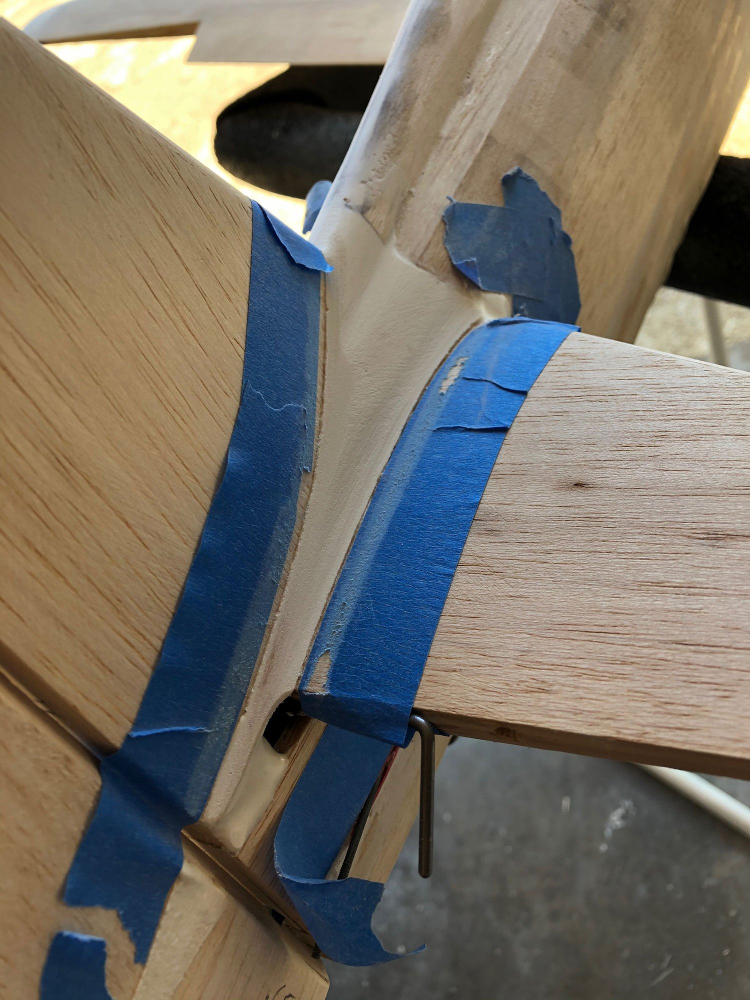

As most who have used micro-balloons before know, the cure of resin, mixed with micro-balloons, goes through stages throughout its cure. At the middle stage, it has thickened, yet is still quite pliable. One can smooth it out and/or help it along towards finer contours. Just wet it (or your finger) slightly first, then smooth it out with your finger. (Many prefer to wear gloves.)
Once it cured, I was able to begin masking around the filler. Anytime I found a moment in-between other specific tasks as Tim was working, I would sand the filler a little at a time.
I have found that using different diameters of sanding drums greatly simplifies this task.
A narrow diameter drum gets into the tighter crevices, easily and uniformly rounding the fillet.
The masking tape reduces the chances of inadvertently "cutting-into" the sheeting. If you sand through the tape, remove and reapply another piece; then continue sanding.
