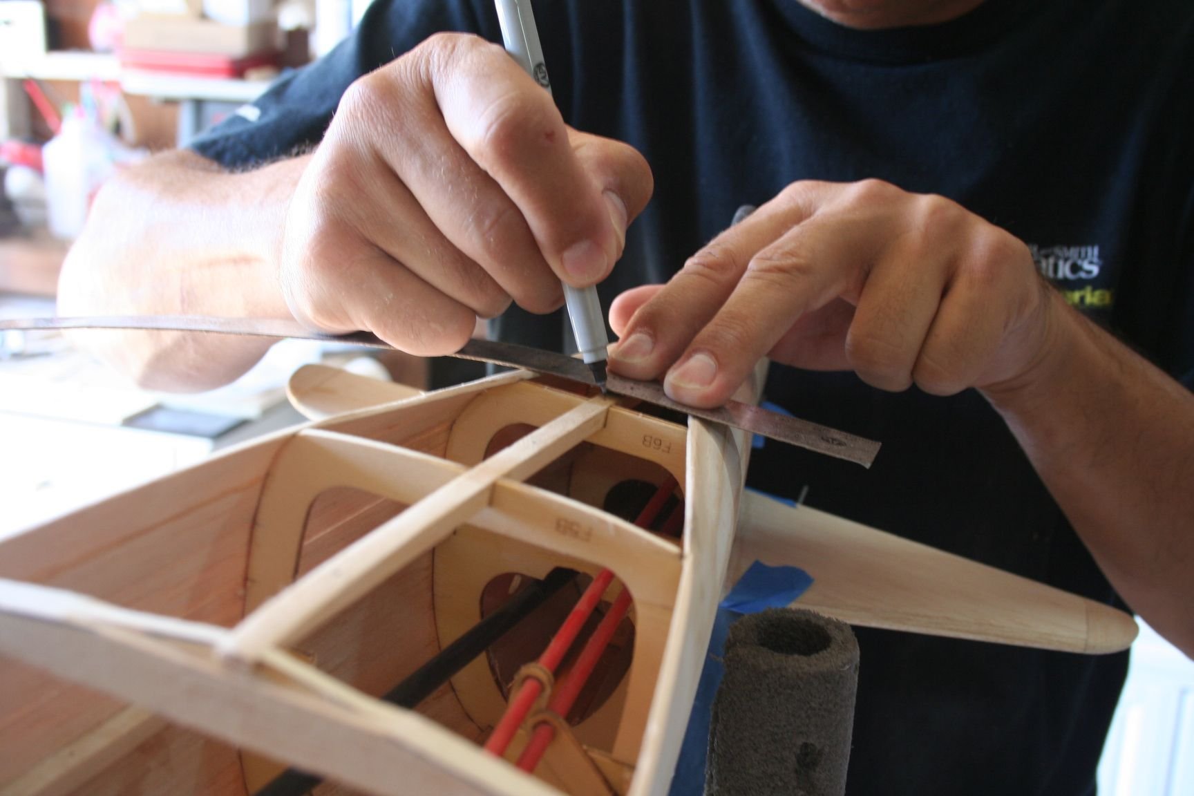

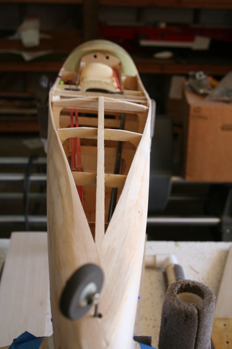

Our next step was to finish sheeting the fuse -- more specifically, sheeting the bottom:
Just as a reminder, this is what it looks like, at this stage.
The first thing I did was to mark mid-points along the length of the exposed keel.
A ruler and extra-fine tip Sharpie were used for this task.
If you look closely, the mid-point marks are visible.
Because the bottom of the fuse is relatively straight, there is no further planking. Instead, the bottom will be sheeted with two solid pieces of 3/32" balsa sheet.
Place the edge of one sheet of 3/32" balsa at the midpoint so it extends beyond the side planking. Trace where the sheet intersects the outside of the planking. Repeat this step for the opposite side. Trim both sheets just outside of the traced lines.

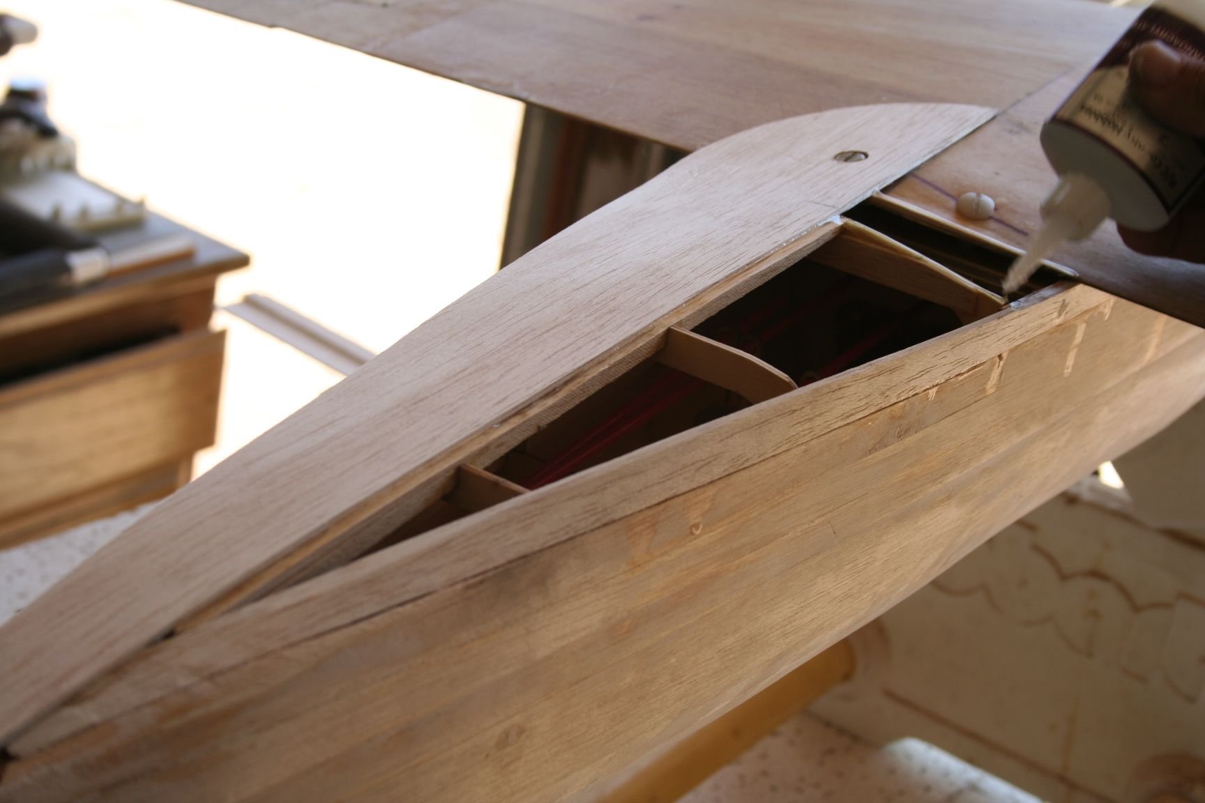

The following series of photos detail the gluing of the left and right sides of the bottom sheeting. This sheeting will later be cut at the wing outline, simultaneously making a wing/fuse fairing Tim already glued the starboard side's bottom sheeting before I was able to pick up the camera. So, the instructions will have to incorporate visuals from application of the port side's sheeting. (Because the plane is upside down it will appear on the right side.)
First, trial fit the piece and note all contact points with the sheeting, where CA will need to be applied.
Next, spray a thorough misting of accelerator to the inside portion of the 3/32" balsa sheeting/fairing and set it to the side.
Quickly, run a thin bead of medium CA more towards the outside edge of the half of the keel that this particular piece of sheeting will be applied to; as well as to the beveled balsa at the trailing edge of the wing. (Keep the CA away from the keel's midpoint on the first half, or the glue may squeeze out onto the other half and harden before it can be wiped-away. Thus making it more difficult to apply the other side.)
Note that the CA is applied to only half of the keel -- the half which will come into contact with piece of sheeting being glued at that particular time. I was unable to capture images in which we used the mid-points marked in the earlier step for reference when applying glue for the first piece of sheeting. Therefore, in this picture, glue is being applied much closer to the centerline, than should be the case when gluing the first piece. Once the first piece is glued down, CA can now be applied into the corner so that the second piece of sheeting is glued to both the keel and the first piece of sheeting, for a more seamless bond.
Now, quickly run a thin bead along the outer half of each of the fuse formers; and finally, along the bottom edge of the side planking that will contact the balsa sheet.
Tim hastily, but methodically, applies medium CA to all edges that will contact the bottom 3/32" sheeting.

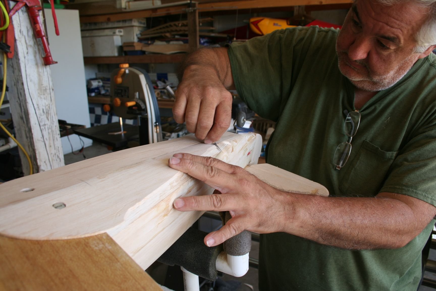

Tim considers how he wants to attack blending the excess bottom sheeting into the contours of the fuse.
He's a "cutter," and so like a true surgeon, he calls for his #11 "scalpel" and starts slicing away. (With a new blade, of course!)
Tim is channeling his inner Edward Scissorhands . . . The hands are a blur, and balsa furiously flies away from the fuse in all directions, like leaves flying from of one of Edward's topiary masterpieces!
(Okay, admittedly I exaggerate in simile for dramatic effect because it fits the imagery of the picture. Tim is a craftsman, after all.)

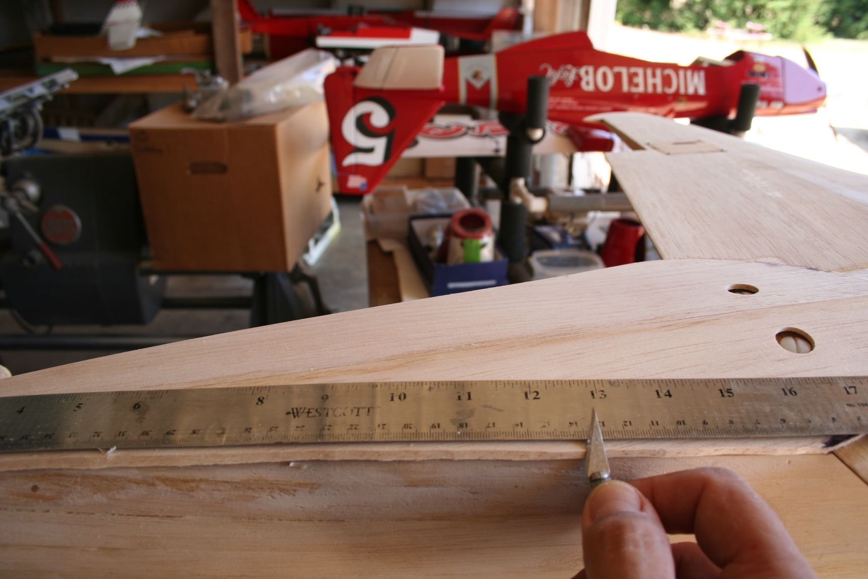

Tim's skill as a professional woodworker pays off. He has clean cuts and does a beautiful job!
I however am an amateur woodworker, and have occasionally encountered issues in the past when slicing balsa in this manner -- especially when cutting into the grain. So my approach was more like a 5-year-old using training wheels to avoid crashes on a bicycle:
Beings the grain is running parallel to the keel, but I am forced to trim it at an angle, I used a straight edge as a guide -- resistance to help my knife better avoid following a potential split or other weak spot, and accidentally cutting too deeply into the sheeting. I also cut from the front, towards the rear of the fuse, so my knife won't "detour" into the path of least resistance and "bite" into the grain; thus slicing side of my fuse or accidentally splitting my sheeting. I don't know if I am being effective in wording this clearly and accurately or not, but in this way, I am essentially trimming off the un-needed tips of each fiber, rather than cutting into them more towards their base. All I can say is for what it is worth, "It works better for me." As always, you should do what works for you.
Note I am trimming at a bevel.
The alignment of the cut-outs for the wing bolts are also visible in this shot.
I trimmed the sheeting "close," with an Exacto knife. But will finish with a razor plane and sanding block.

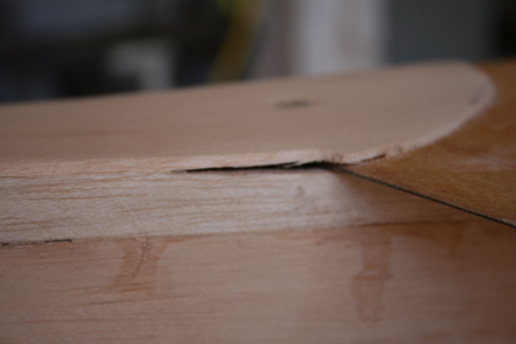

Back about the time captured in Post #331, when I was trial fitting the bottom sheeting, I noticed a gap -- the thickness of the wing's trailing edge. (Tim's CzechMate is pictured to illustrate, below.)
I chose to close this gap by gluing-in some scrap balsa, and sanding it to a bevel, before attaching the wing.
Okay, with that oversight now corrected, "back to our regularly scheduled program" . . .

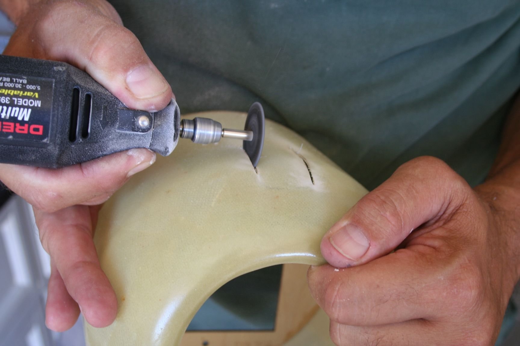

Next, we mounted the stock exhaust pipe. Tim cuts a 2" piece of brass tubing, slightly smaller than the inside diameter of the exhaust pipe; and places it so that it will just clear the inside of the cowl.
The exact position of the angled exhaust can now be seen and marked on the inside and/or outside of the cowl, and an accurate clearance hole is cut.
Tim begins by tracing the front of the opening on the inside of the cowl.
And, finishes on the outside of the cowl.
Dremel bits are used to cut the opening, and Tim trial-fits his cowl to ensure proper clearance. (Note that he is able to extend the brass tube through the center of his clearance hole.)

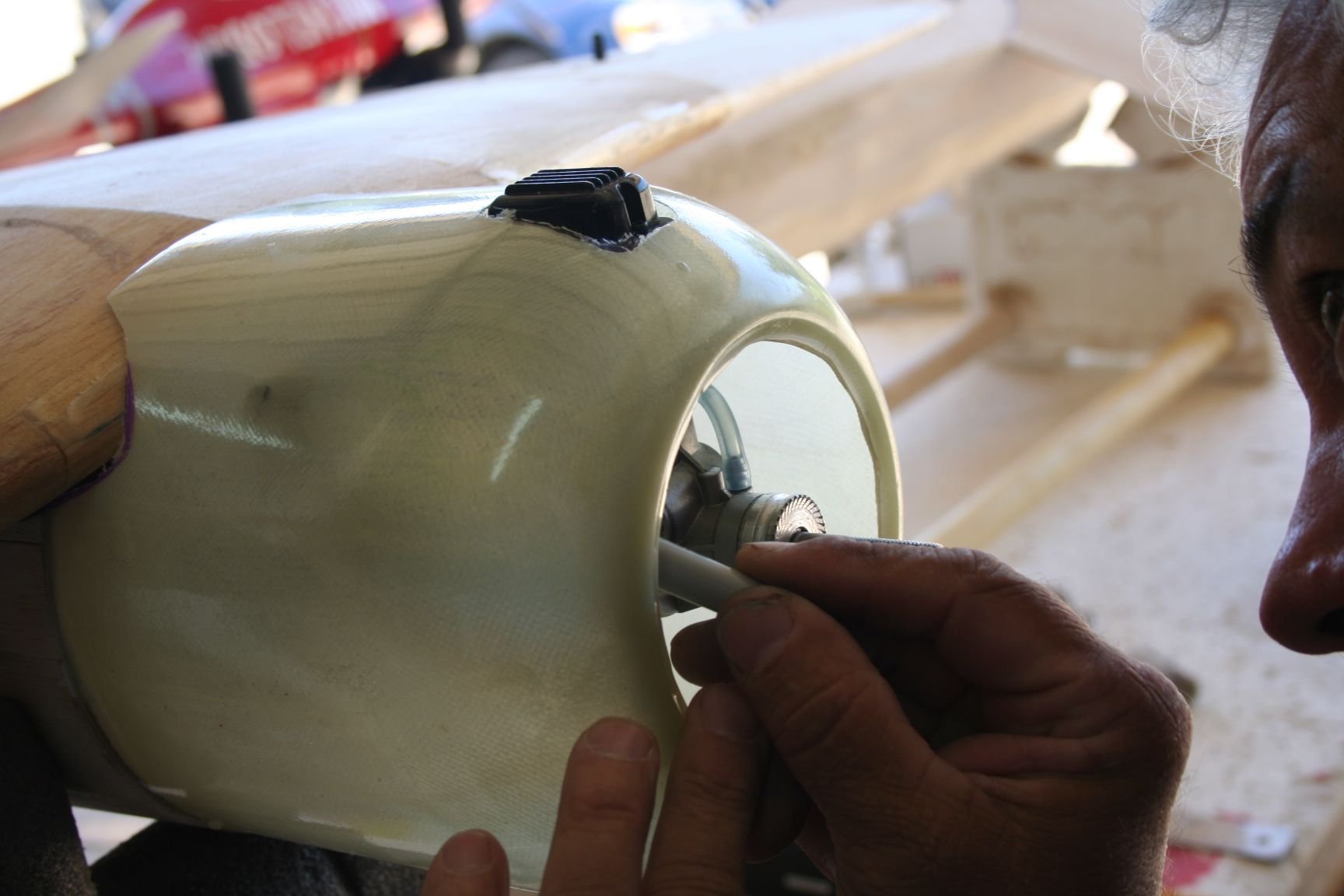

Now we need to cut a clearance hole for the needle valve.
Music wire or pushrod is inserted into the needle valve. Tim aligned a straightedge/ruler to the outside of the fuse in order to mark where the cowl will come into contact with the wire. The wire was cut at this mark.
Tim then reinstalled his cowl, and marked where the needle-valve extension wire will exit the cowl.

An appropriate bit is selected and mounted a Dremel, and the clearance hole is cut.
Tim is done with his.
