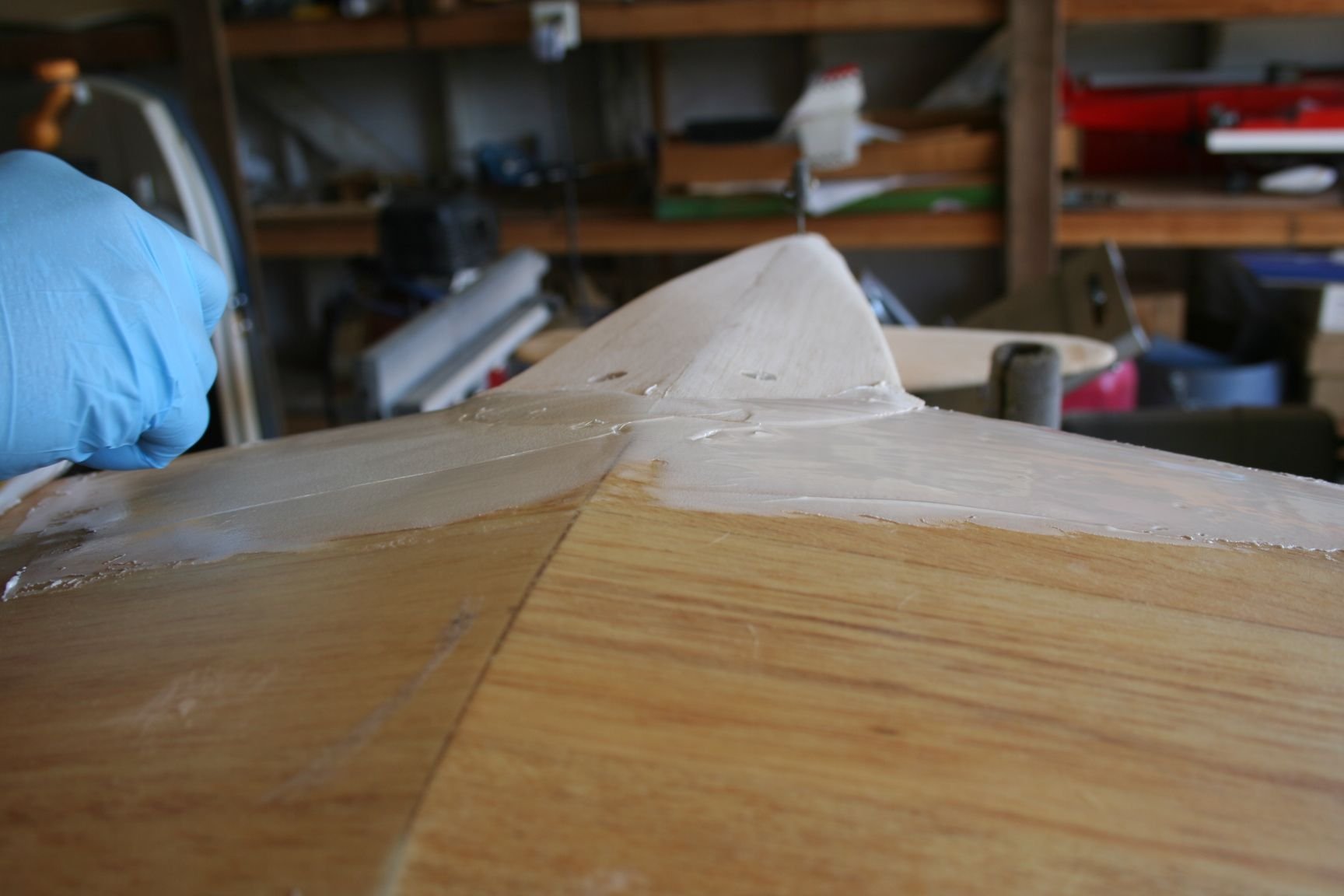

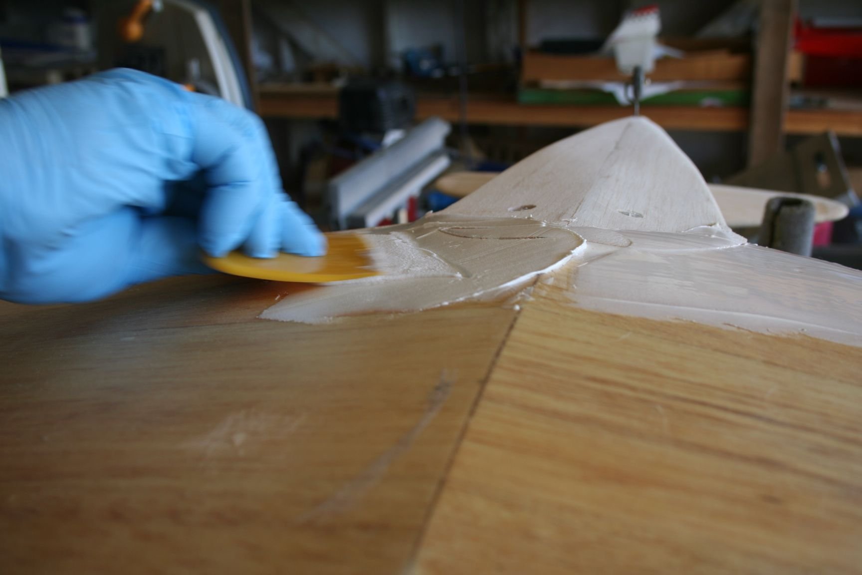

To make the fairing to blend the wing into the rear of the fuselage, Tim and I each used one metered pump of West Systems laminating resin in a wide, shallow 3 1/2 oz. soufflé cup, and mixed-in micro-balloons until achieving a "peanut butter" consistency. This mixture was poured onto the center section at rear of the wing; then a "Bondo" applicator/spatula was used to smooth and even-it-out, blending it into the balsa sheet that formed the bottom fuse sheeting and overlapped the rear of the wing.
Tim pours the micro-ballon mixture onto the rearward center-section of his wing.
Using a Bondo applicator he works to smooth it out, and fill-in the "low" spot between the leading edge of the bottom fuse sheeting and the main wing spar.
Here in Sacramento, CA we had the hottest August ever on-record, so there isn't much time to work before the epoxy begins to set-up. Gotta work fast!
A-l-m-o-s-t there!
Okay, he's happy with it.

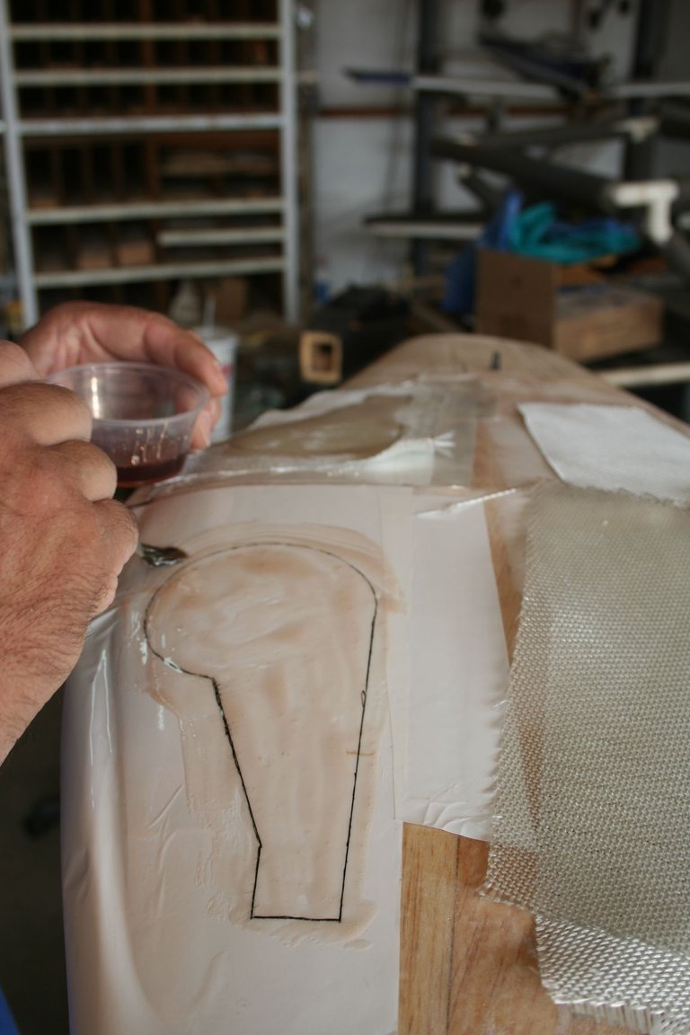

Once each of our fairings were sanded to our liking, the next step we took was to make fiberglass main gear doors:
I made a photocopy of the outline of one of the gear doors, as drawn on the plans. I was careful to also include the line representing the wing center section within the photocopy. This aids in proper placement and alignment of the template. Tim cut the paper template out with scissors, while I cut several layers of fiberglass cloth (3 layers of 6 oz., and one layer of 2 oz. cloth, for each gear door).
Layers of 6 oz. cloth cut and ready to apply; with the photocopied template, underneath.
I have aligned the wing center section on my template and wing LE (all photocopied from plans on one 8 1/2 x 11" sheet of paper) with the actual wing center section and LE of my plane. Each gear doors' outline is then traced directly onto the balsa.
Tim does the same.
Both planes showing the door outlines traced.

1. Iron-on clear Monokote (or similar) plastic covering material -- pieces large enough to extend well beyond the outline already traced on the wing.
2. Align the paper template back over the Monokote, carefully aligning it with the first gear door tracing. Re-trace the outline of the door on the top of the Monokote. (The Monokote is a parting surface; and when the part is removed, the ink will adhere to the fiberglass part, supplying a perfect outline to the finished part. The finished part will then align perfectly with the line previously drawn on the balsa sheeting.)
3. We each used one metered pump of West Systems Epoxy. Start the lay-up by brushing a layer of epoxy over the outline. (Tim's plane is pictured here -- easily recognized by the white covering material.)
4. Lay the first layer of 6 oz. cloth over the outlined position.
5. Tap it down very lightly to smooth it out and begin wetting-out the cloth. Using the brush, apply more epoxy to completely wet-out and seal the part against the Monokote. (Here, Tim has applied the first layer on one side, and has just set down the first layer on the other side.)
6. Continue this process for the remaining 2 layers of 6 oz. cloth. (Tim's wing with 3 layers of 6 oz. cloth applied to both gear door outlines.)
(Ollie's wing with 3 layers of 6 oz. cloth applied to both gear door outlines.)
