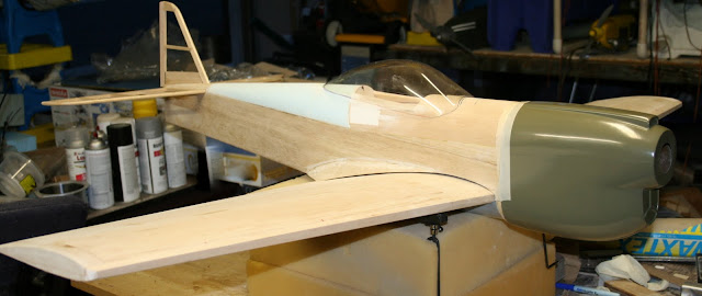

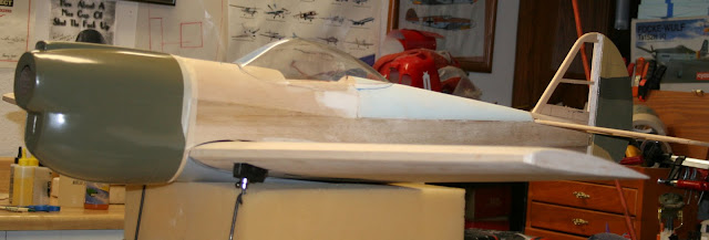

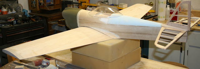

Tommy_Gun 06-01-2010 03:00 PM
What it was, what it is, what it will be..
A warbird racer plane ID game for you to burn time with.
SAMs members that saw it are not allowed to play.
http://lh4.ggpht.com/__oBJS-RBlL8/TA...0/IMG_0990.JPG
http://lh6.ggpht.com/__oBJS-RBlL8/TA...0/IMG_0993.JPG
http://lh6.ggpht.com/__oBJS-RBlL8/TA...0/IMG_0996.JPG
Mluvara 06-01-2010 03:26 PM
RE: What it was, what it is, what it will be..
Looks like it will be a P-40 in the end...
Tommy_Gun 06-01-2010 03:57 PM
Details man, details!
What P-40 to which P-40 from what origins?
Mluvara 06-01-2010 04:12 PM
XP-40Q?
Tommy_Gun 06-01-2010 04:33 PM
Well at least you're willing to play.
Yes that is the goal. Still have a ways to go. Cutting the canopy and reshaping the cowl.

Tommy_Gun 06-29-2010 11:00 PM
1 Attachment(s)
Progress.
I need to correct the shape of the nose inlet a bit. But it is getting closer.
pjakew 06-29-2010 11:23 PM
Super-Slick T-Gun!
Is this a Gold bird by chance? Hope you are not going to shelf the 190.
It does look like you are going to have to use a P-51 spinner on this mod ;)
Tommy_Gun 06-29-2010 11:43 PM
Funny you mention the spinner.
After review of these pics it became more obvious to me that I need a spinner with a bit more diameter to keep the nose shape correct.
Thank goodness for light weight vinyl filler!
